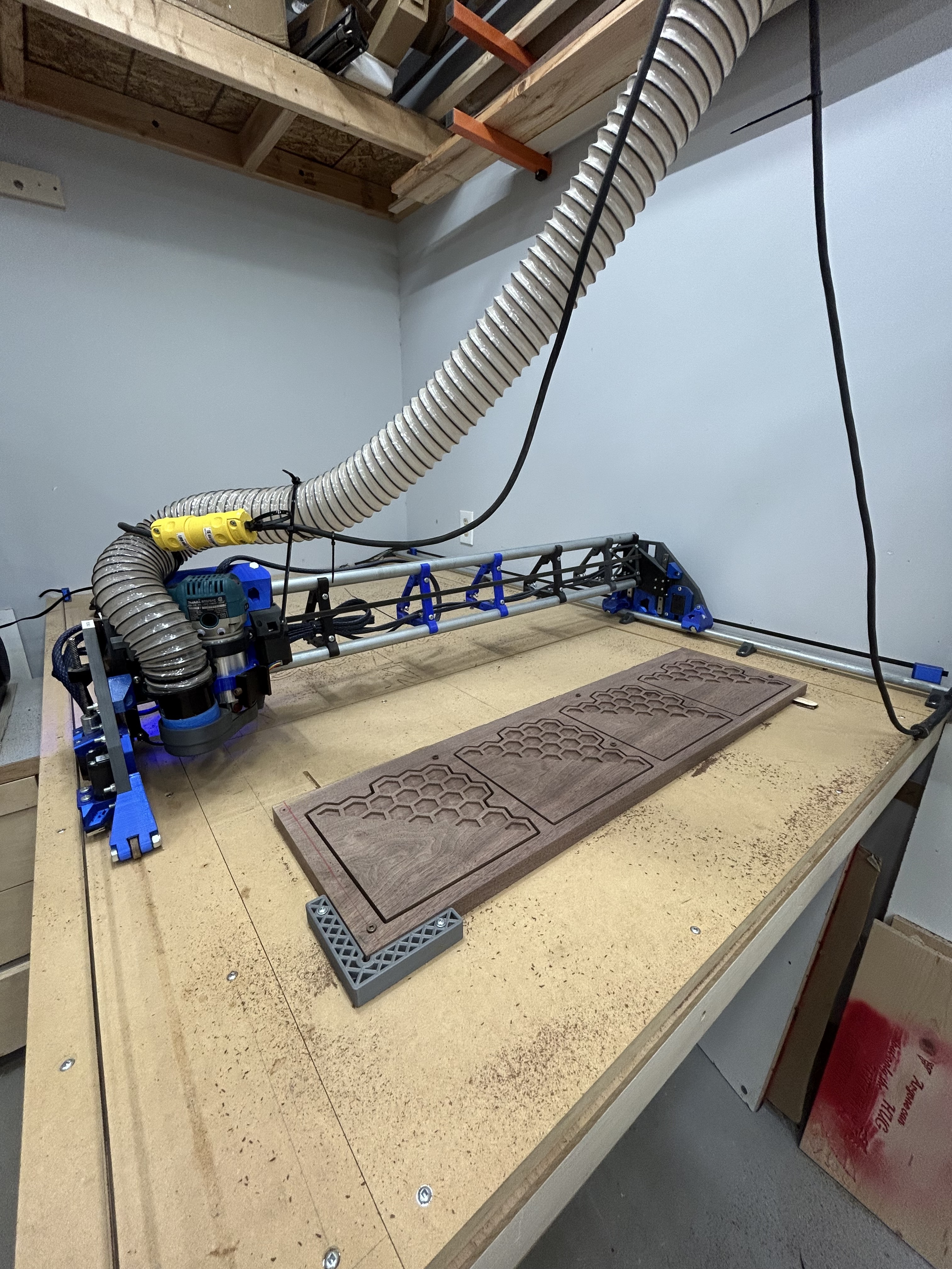

Having a little issue with the Lowrider 3 stopping mid cut.
Im batching out these awards, and im doing sets of 4. Doing set 3 (boards 9-12) and the LR3 has just stopped dead twice now. Nothing damaged, just stops. The web interface is responding, i can control the LR3 - raise Z, move to X0 Y0 etc, and restart, but then stop after a few minutes.
SD card isnt falling out- its still readable on the interface.
Power connection is fine, No crazy noises or anything.
I took an IR thermometer to the motors and they are in the 98-104 oF range. After sitting ON, but not moving, the temps dropped to around 95-98. is this considered high and would it cause a stop?
I really don’t want to power off, as I have the origin zeroed out and Im literally half way through a profile cut. Unless there is a way to figure out the absolute coordinates compared to the end stops, despite having set G92 for my Origin (if that makes sense.) but I assume G92 resets the coordinates to whatever I tell it and overwrites that info.
Any advice/ help appreciated.
I also noticed some oscillation in my left side belt, and found that my front bracket is splitting. I superglued it and hope itll make it though the day and ill print another tonight.
Ill need to give the whole thing a check over, hopefully the core etc are still in good shape.
Thanks!
