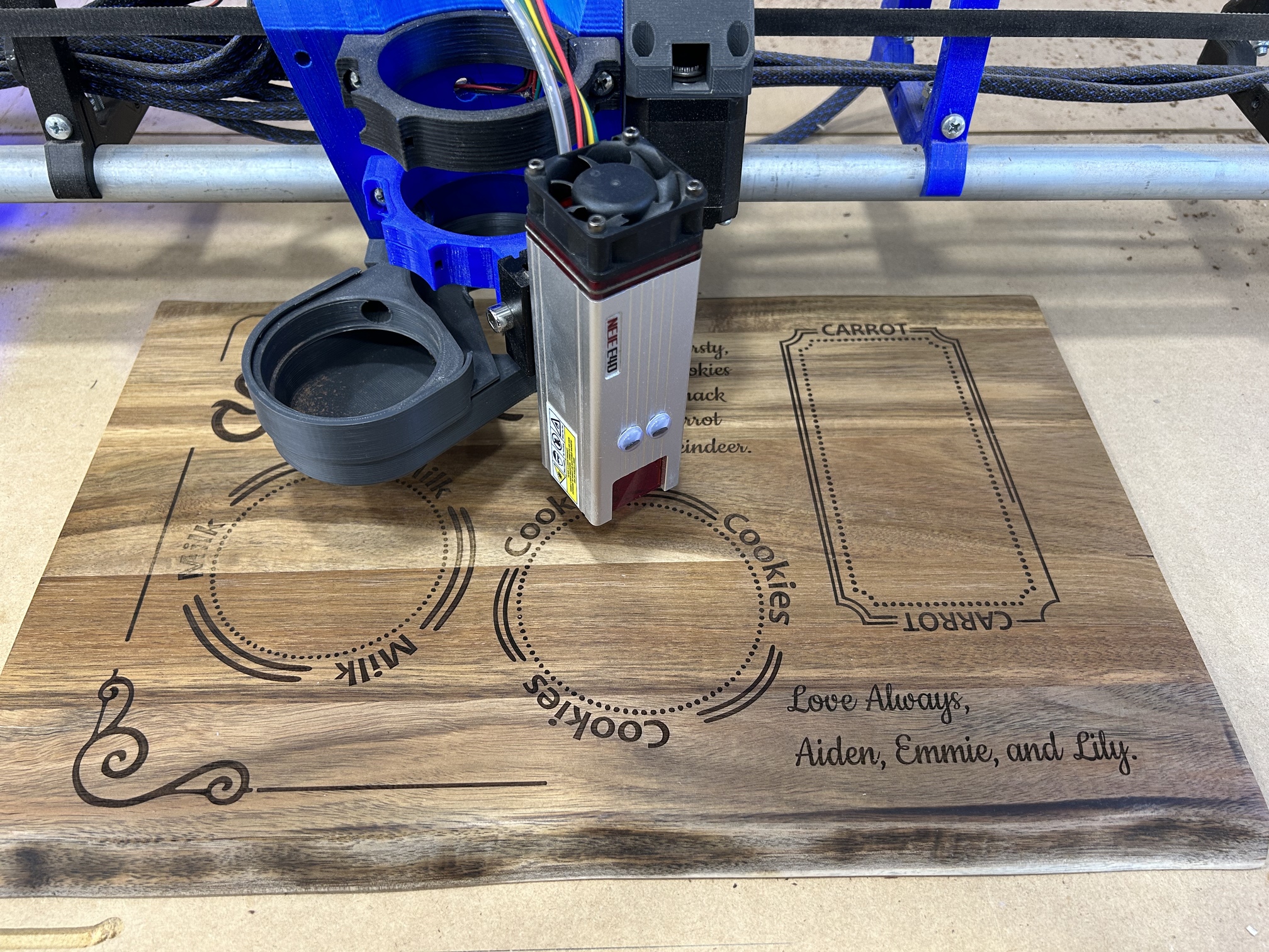

Been running a bunch of vcarve and epoxy boards and a few laser engravings

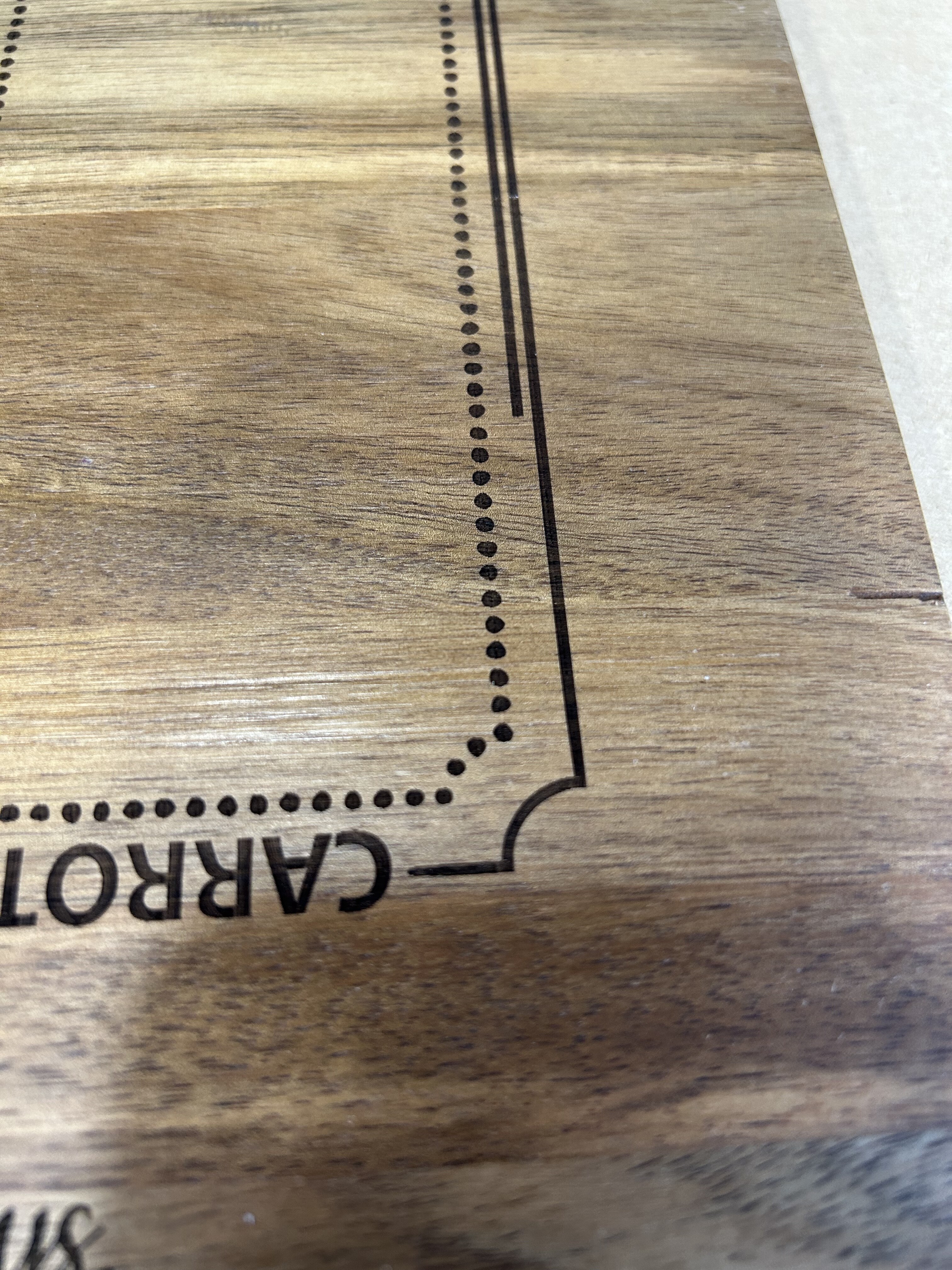

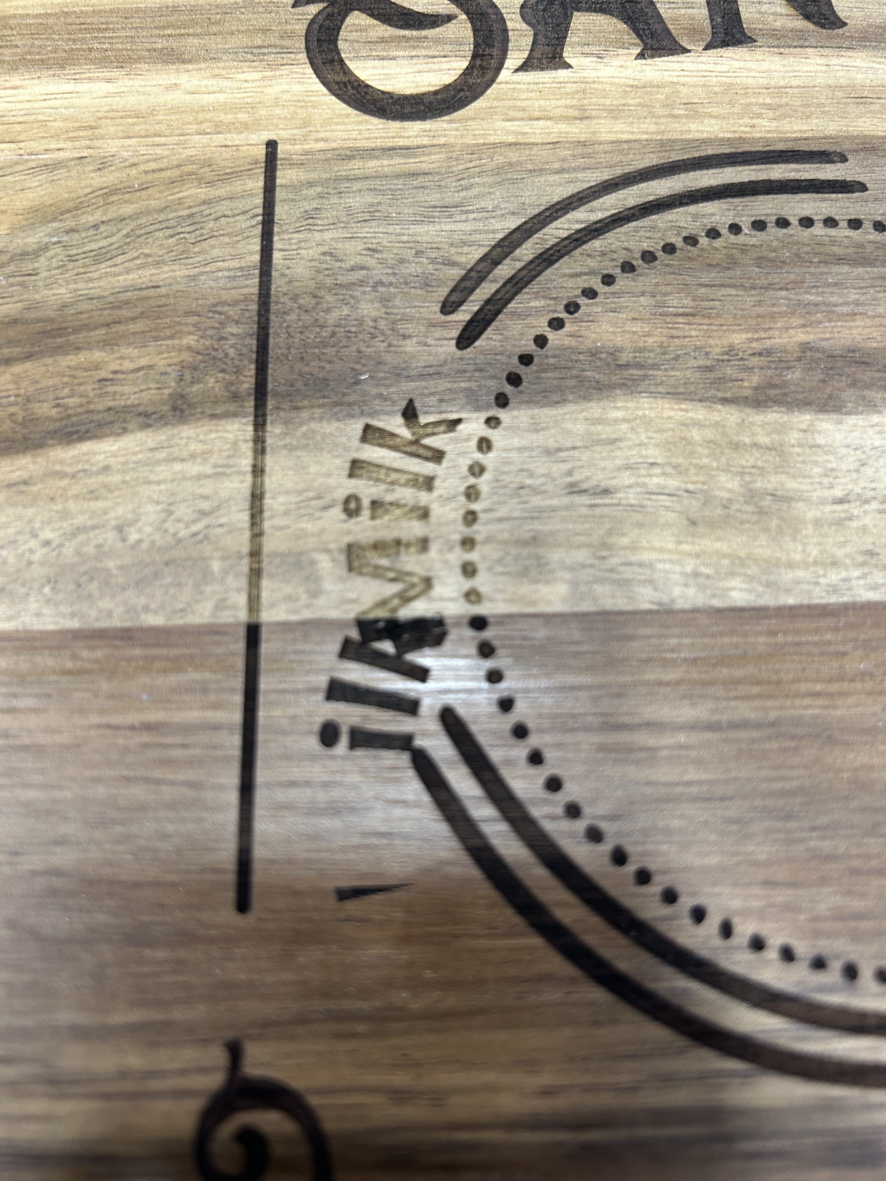

They are turning into a headache- mainly because I got talked into doing a bunch (8) Santa platters for teacher gifts and friends. Each one is 12x18, lots of elements, and I’m running the laser at 30mm/s 100% power. Ends up being a 4 hour session, each. Faster than that, it skips, so I’m kinda at the limit.
Then, today, I had a situation where the control wire popped off the board 3 hours into an engraving, but I caught it after like 2 minutes. Plugged wire back in and it went back to pew pewing the photons.
So a little bit missing, but it was a visible part of the engraving. And a lighter engraved area because the wood was sapwood vs heart (light vs dark).
No worries- I’ll let the job end. Without turning anything off, I’ll send it back to zero coordinates, and make a lightburn file with just the missing elements. Load up the new gcode and it should add them in seamlessly.
Except, it didn’t. Ended up about 1/2ā€ off, ruining the whole thing, and now I need to start again
No biggie, but losing 4 hours with what could be a 20 minute job is frustrating.

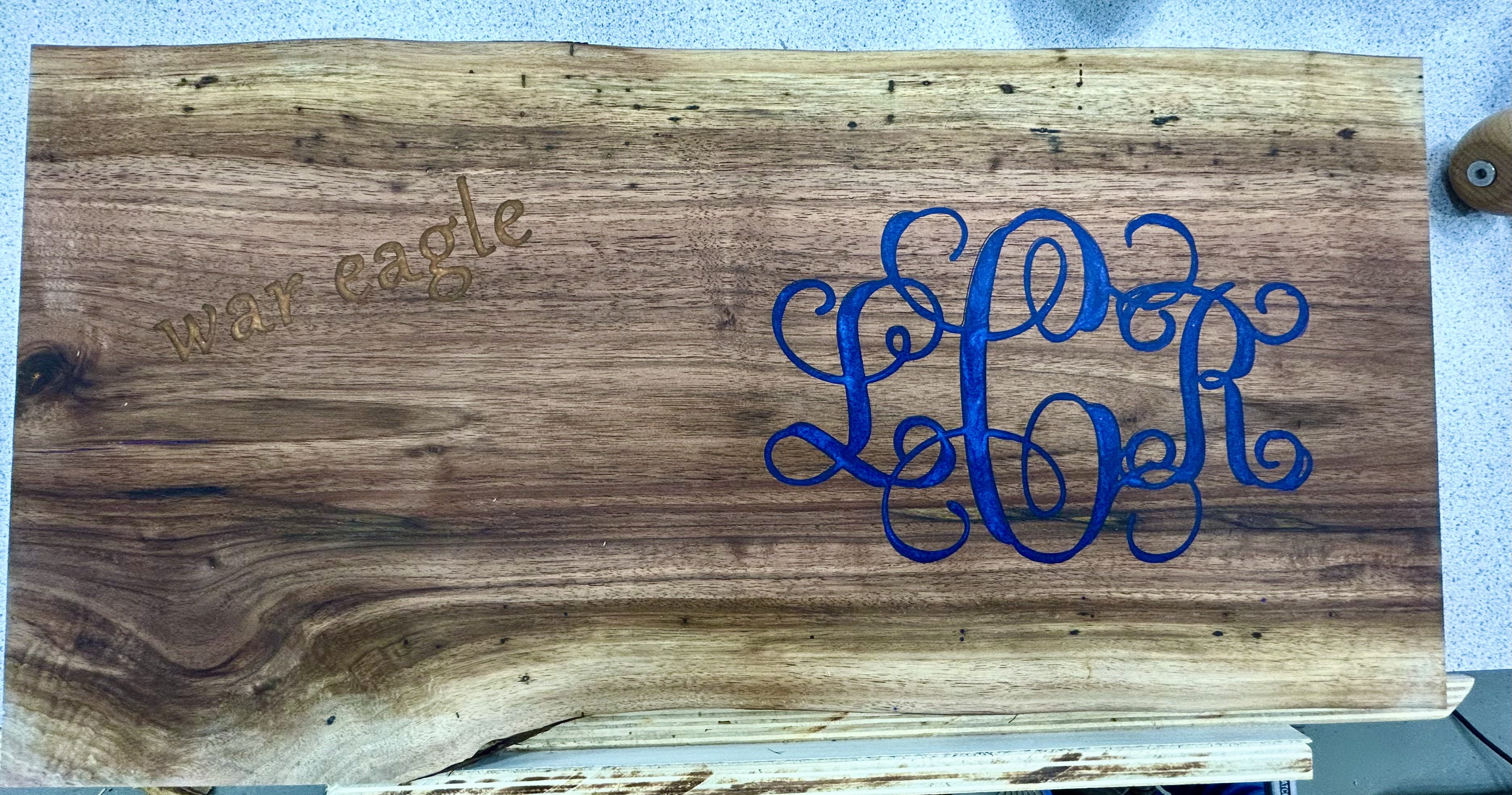

Recent vcarve and epoxy fill… for a football fan in the South…
