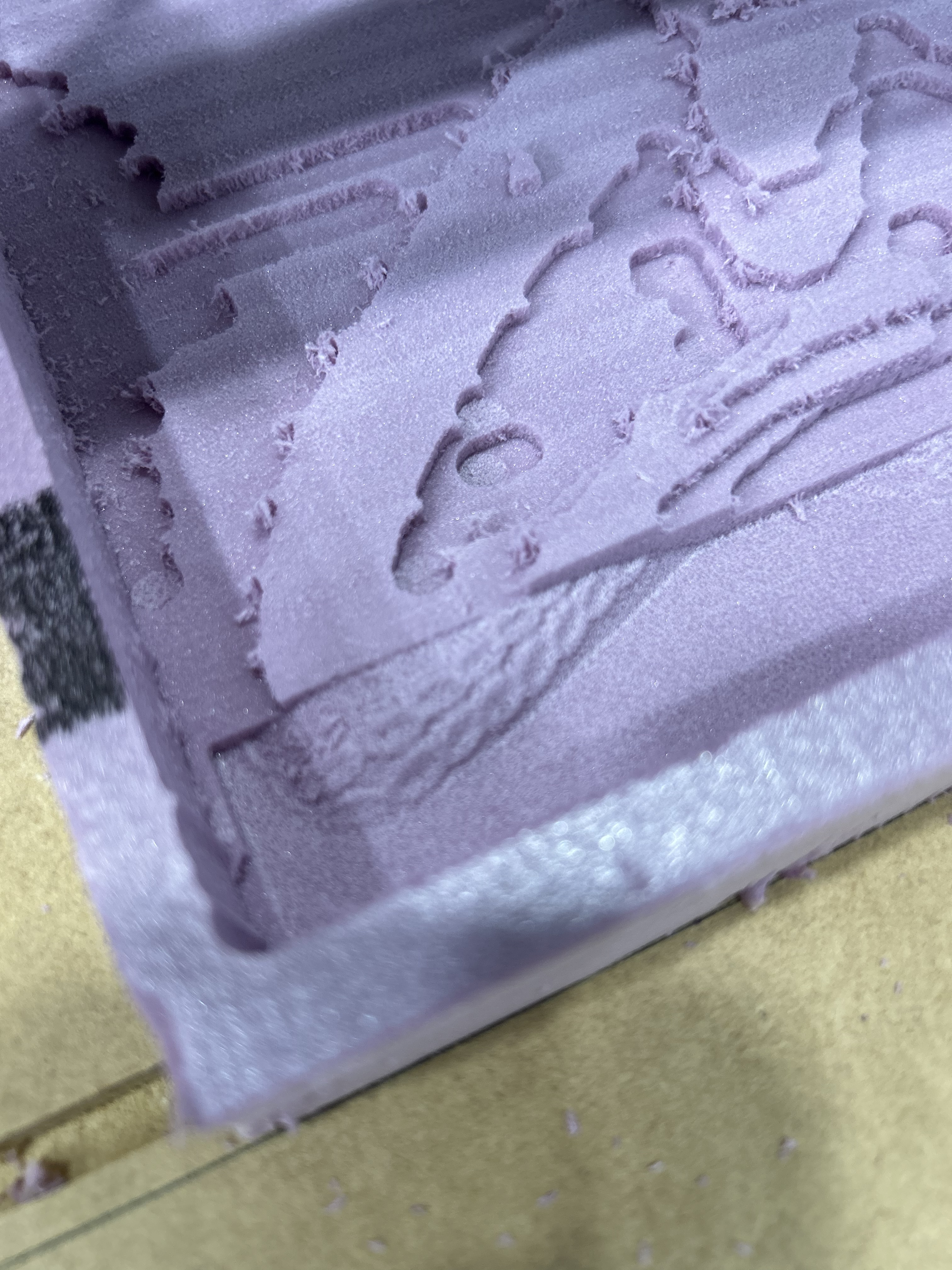

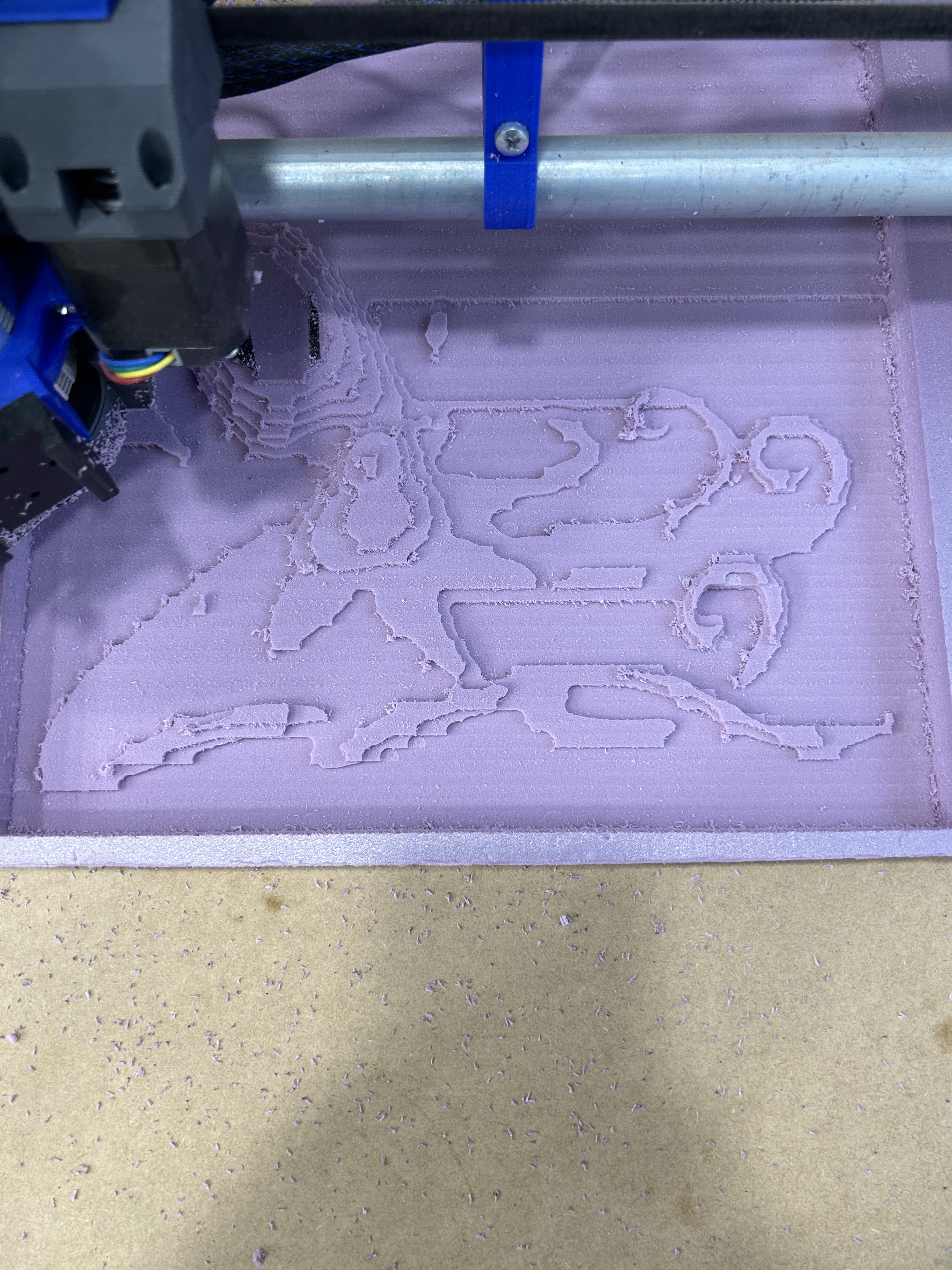

Halloween obsessed spouse means I’m making spooky props…
1” xps, 1/4” straight rough, 1mm ball finish.
I’ll profile this guy with an exacto knife and stick him on top of a fake gravestone for Davy jones
