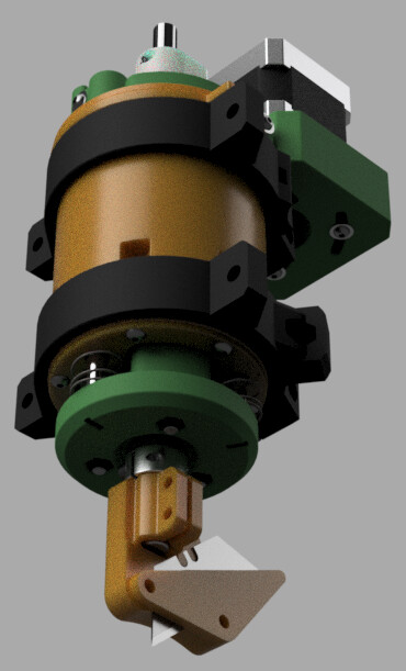

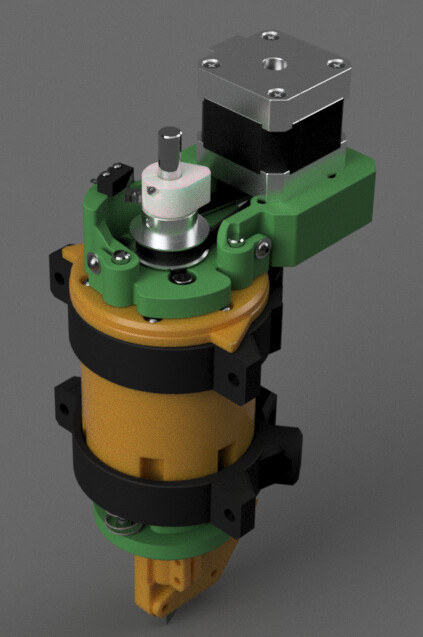

I’m slowly putting together an LR4, I’m in the printing phase… Next the table, then the tool !
While printing, I’m working on a tangential oriented knife tool, not just a drag knife. It’s kind of a middle ground between the drag knife and oscillating knife. For my purpose, I think it’s gonna be super fine for cutting cardboard, and other soft thin materials.

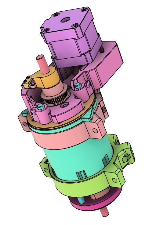

It’s really hard to design and stay in the DIY class and available hardware (no machining). I think I’m doing pretty well, I will soon have something to print and test. The knife tool is spring loaded, has a stepper with belt and pulleys for rotation axis (1:3 ratio), an homing switch, it fits in the Makita tool clips, has a trust bearing for axial load, and more…
Hope it will get the job done !

Ok it looks good on paper now, mostly down all the tolerances fitting and hardware selection. Hope this would not end in a not usable design ! My main concern is the axial motion, I’ve 3 small linear rods axis in bushings. I made the constrains fit for 2 axis and little looser for the 3rd one, but still… Well I will order hardware and keep you update later !
I have borrowed and remixed the blade holder from https://www.thingiverse.com/thing:2661474.
Im looking forward your build. Would live to build one myself
