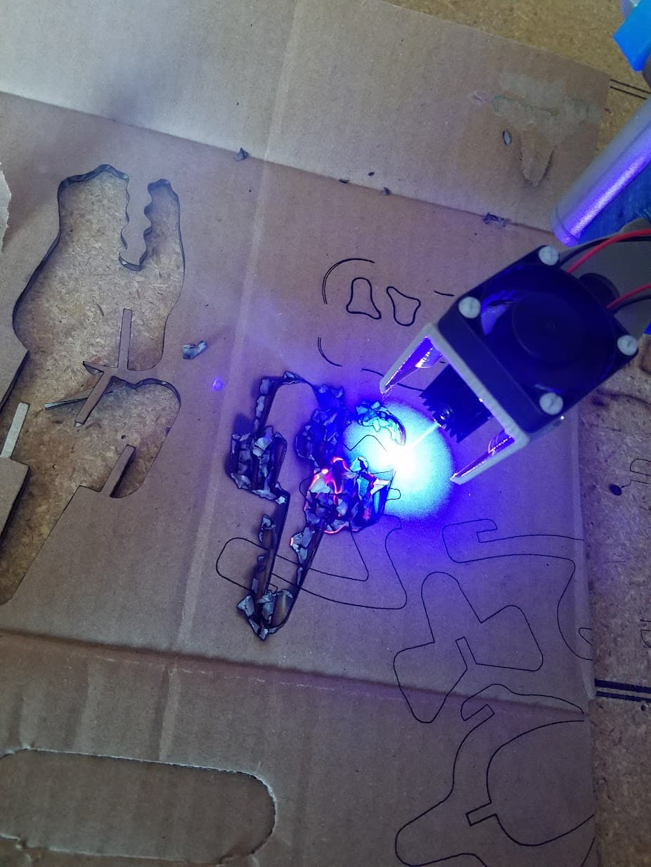

One thing about using a laser on cardboard - there’s a LOT of variation in cardboard.
When I was experimenting with a diode laser on my old machine my daughter was a girl scout - so I had a lot of empty cookie cases to experiment with (not the boxes you buy as a consumer - the corrugated boxes those ship in.)
I found that even just box to box in the same shipment of cookies there would be large variations and settings that worked great on one box wouldn’t cut the next one or would sometimes go the other way:
This was an extreme example - I was watching closely with a bucket of water handy and a fire extinguisher just to see how out of control it could get. This particular cardboard wouldn’t really burn it would just smolder. Even when I tossed it in my fire pit it wouldn’t burn well.
But others would go up in flames even with very low laser power.
The way different boxes in the same shipment would need totally different power levels was pretty shocking to me though.

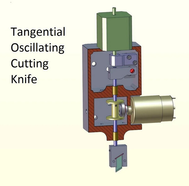

Ok back to tangential oscillating cutting knife, I’ve found this model on Thingiverse : https://www.thingiverse.com/thing:1436870
This look a promising budget solution. Last comments/message was back in 2022. Maybe there is new development on this model…
I think I will build my table for both laser and TOCK cutting. I will begin working with the TOCK for safety and budget reasons. If things get serious, maybe I’ll jump to laser for speed and reliability…
Yeah - that burning cardboard in my photo was while it was moving and cutting. That particular test I was doing multiple passes because of how poorly that cardboard was cutting - and after a few passes it started to slowly smolder and burn.
Basically just a reminder to take caution so you don’t burn things down. Never leave it unattended and don’t assume settings for one type of cardboard will work for others without testing.

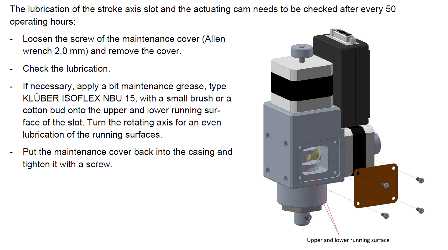

Well the designer of this knife replied to me it was too noisy and not durable, so he dropped the project.

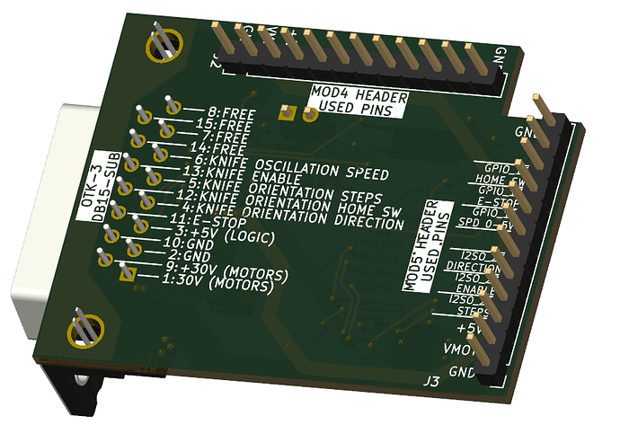

I was looking at the Stepcraft OTK-3 manual, I found that it is really similar to the TOCK 3d printed model. Here are pictures from the OTK-3 manual and TOCK 3D printed model :
This is the pinout for the OTK-3. So I’m quite new to LowRider, do you think it’s possible to hook it to a Jackpot controller ? There are pins for the direction, but I don’t know if thet are compatible for the 4 axis step motor driver on Jackpot controller…
From ChatGPT, I can’t relate yet if exact, but OTK-3 would not be a plug and play device for Jackpot FluidNC controller. I have asked if both devices where compatible. A circuit would be needed to have the raw direction/pulse for the fourth axis at 5V (ESP32 is 3.3V logic) and another circuit for speed control to convert Jackpot PWM to voltage signal.
BUT from Jackpot specifications, drivers are UART driven, not by raw signals, SO STEP/DIRECTION SIGNALS COULDN’T BE READ FROM THE “C” DRIVER HEADERS.
It maybe easier to use another CNC controller board, like the FluidNC 6 axis or Corgi controllers who seems to use raw signals to drive drivers.

From the OTK‑3 manual §6.2, pin 4 = “Direction 4th axis (blade position)” and pin 5 = “Pulses 4th axis”—i.e., standard DIR and STEP inputs. So in principle they can be driven by any controller’s fourth‑axis step/dir signals. (stepcraft-systems.com)
On the V1E FluidNC Jackpot board, the socket labeled C is just another on‑board stepper driver socket; it does not expose raw step/dir on screw terminals. The board is designed to plug TMC2209 modules; the STEP/DIR lines are internal. You’d need a way to break out those signals (e.g., via the expansion/6‑Pack style modules or a custom tap on the board) to feed the OTK‑3’s DB‑15 pins. (docs.v1e.com)
A few concrete compatibility notes:
  1. Electrical lines you must provide to the OTK‑3
  • +30 V on pins 1 and 9, GND on 2/10, +5 V on pin 3 (for its control electronics), plus your STEP (pin 5) and DIR (pin 4). The OTK‑3 expects those rails at the DB‑15—Stepcraft machines provide them; Jackpot does not. You’ll need an external 30 V supply and a shared ground. (stepcraft-systems.com)
  1. Signal level & availability
  • The OTK‑3 doesn’t state input thresholds, but it’s clearly designed around 5 V logic from Stepcraft. Jackpot’s ESP32 logic is 3.3 V and its step/dir lines aren’t brought out. If you do break them out, plan on a 3.3 V→5 V level shifter (or test if 3.3 V is accepted). (stepcraft-systems.com, docs.v1e.com)
  1. Oscillation‑mode control (pin 6)
  • The manual shows a “PVM/PWM” analog level: 0 V = grooving, ~1 V = 1300 spm, ~3 V = 2000 spm. Jackpot has two 5 V PWM outputs (~25 mA) you can repurpose; you’d low‑pass filter to DC and scale to ~0–3 V (simple RC + divider or an op‑amp). (stepcraft-systems.com, docs.v1e.com)
  1. Safety & homing
  • Wire pin 11 (E‑stop) and pin 12 (4th‑axis reference switch) into your FluidNC config so the OTK‑3 stops with the machine and can home its blade angle. (stepcraft-systems.com)
Bottom line
  • Conceptually compatible: OTK‑3 pin 4/5 will work with a “C‑axis” step/dir pair.
  • Practically not plug‑in on a Jackpot/LowRider: you’ll need
    • an external 30 V supply,
    • a way to break out STEP/DIR for the C channel,
    • likely level shifting to 5 V,
    • a small PWM‑to‑voltage circuit for pin 6,
    • and wiring E‑stop/ref per §6.2.
If you want, I can sketch a small interface: BOM + wiring (DB‑15 → breakout, 30 V PSU, RC filter + divider for pin 6, 3.3→5 V buffers for pins 4/5) and a sample FluidNC config block for mapping a “C” rotary/tangential axis and the E‑stop/ref inputs.

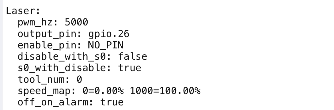

I’ve looked specifications for this laser, can’t find if PWM signal is 3.3V, 5V, 12V or 24V ???
Do you know what voltage is this signal ? Thanks !
The laser is powered by 24v. I run it and the jackpot on a 10a PSU. I then take signal and GND from the jackpot on a GPIO port.
Not 100% sure of the output voltage of the GPIO - 3.3v probably? But with PWM it’s the duration, or relative proportions, of high and low in a pulse that matters anyway. I think the manual is indicating it’ll take PWM input voltage of between 3 and 12v.
I have the following in my config.yaml

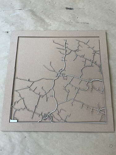

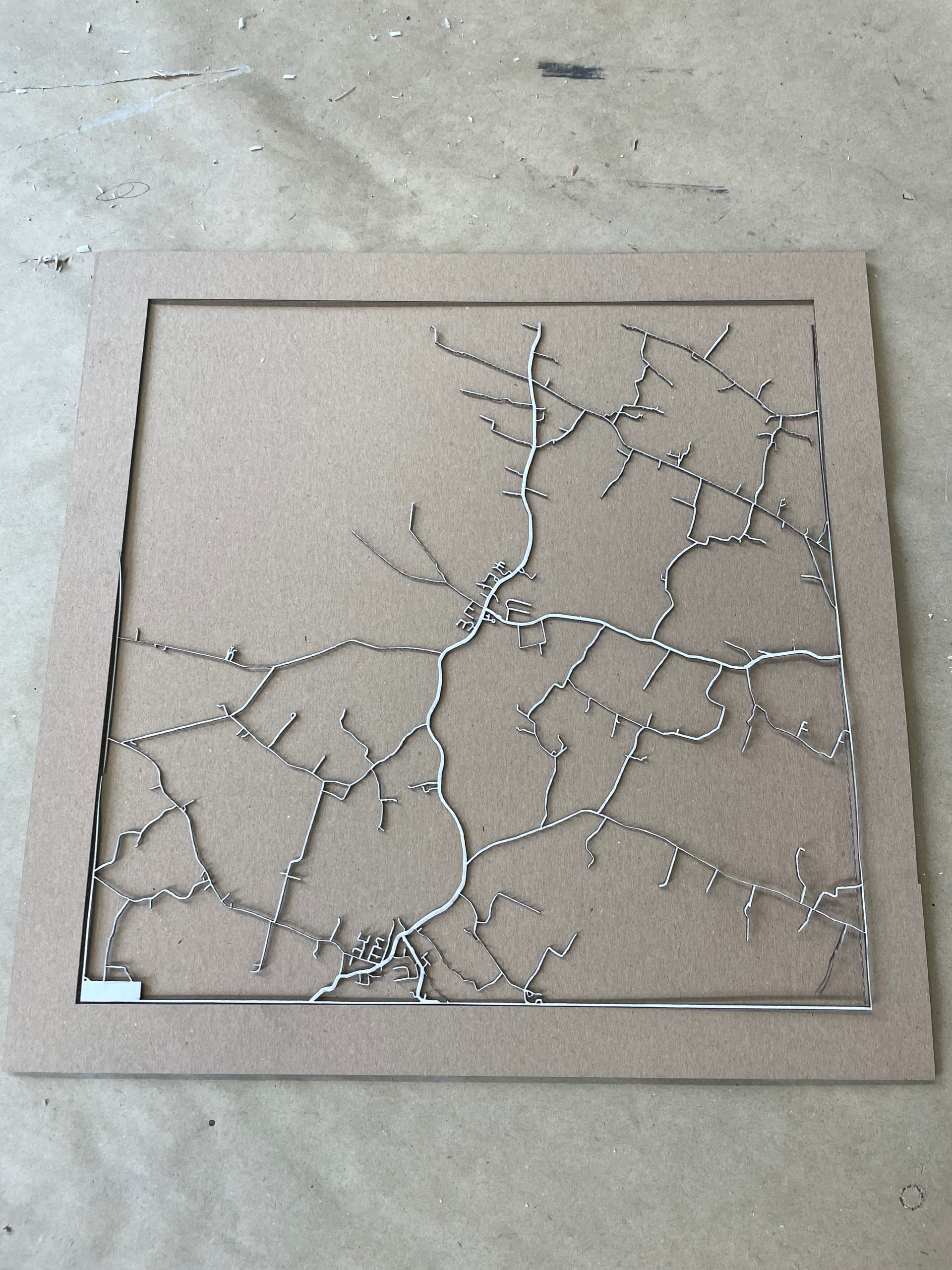

I did some more messing about with card to see how fine the lines can be:
This was exporting map data and tracing it in lightburn, the results were okay-ish. That’s a 300mm x 300mm square, for reference.
When you set a zero offset in lightburn you can also engrave with the laser then cut with a router with the 2 aligned, which is neat.
If using GPIO26 straight from the Jackpot Controller, then you are pulsing 5V.
Ah there you go then. I don’t know what I’m talking about and even I can make it work :grin:

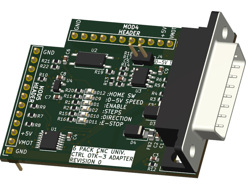

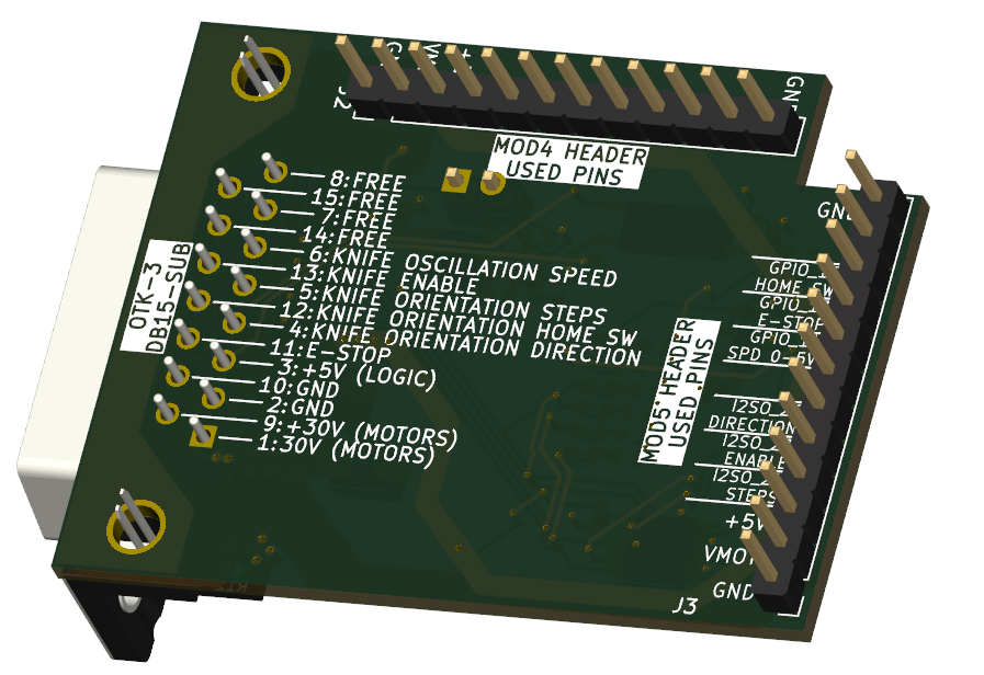

Well after starting a new thread on the controller category, it appears that external drivers and Jackpot controller are not mixing well. Someone suggested me to use the 6 Pack Universal CNC Controller with modules to reach my goal. This was a good idea but I need a lot of modules to fulfill all signals requirements for the OTK-3 TOC knife. So I’ve started designing an adapter module to hook relatively easily an OTK-3 TOC knife to the 6 Pack CNC Universal controller. It’s a work in progress, but it should look like this :
In the end, for cutting cardboard (and other stuff) both laser diode and TOCK knife seem promising and similar in budget since with diode laser, you need to manage smoke, fire hazard and need a special cutting bed, and with the TOC knife, you ideally need a vacuum bed, so a fan/vacuum system is needed too.
Both tool head are about the same prices : Laser Tree 30/40W and Stepcraft OTK-3 are around 500$USD.
Laser is probable more polyvalent and easier to setup, but I have to address safety issues (fire and laser flashes) with a big machine as a LowRider and people can be around this machine while working.
TOC knife is probably harder to setup in the firmware, but you can leave it work with minimum supervision and nearly zero fire risk. Of course you can cut yourself, but there is no flash of blazing light that could burn your eyes…
In the end, with the 6 Pack CNC universal controller, it would be possible to fit both head too…
