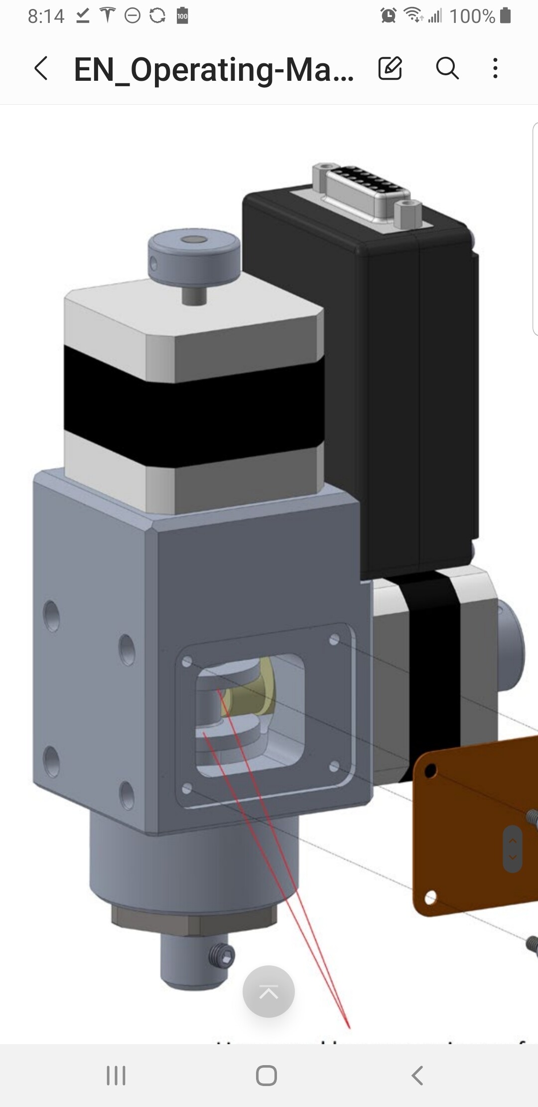

I have found this StepCraft OTK-3 tangential knife, I will look on how I could fit it on a LowRider. It’s cheaper then the industrial type, but still a lot cheaper in time for R&D for knife development.
StepCraft OTK-3
I’ve also found this light industrial head with mounting plate. It’s about 3kg. Is it too heavy for the gantry ?
It would be a wonderful tool, expensive but wonderful !
Looks like OTK-3 has 2 open loop steppers, am not seeing any load sensors for precise pressure control. Maybe has a limit switch to home knife angle, but not seeing inbuilt way to home oscillator stepper? Guessing the manual adjustment wheels attached to the dual shaft steppers are used to manually fine tune pressure when oscillator is not being used for cuts. From OTK-3 manual
From section 6.2 pintout, it does seem like there is a home switch for blade orientation. There is also a speed signal and a job status signal (pause/resume oscillation I guess).
There is no pressure adjustment, both knobs are for manuel positioning of blade…

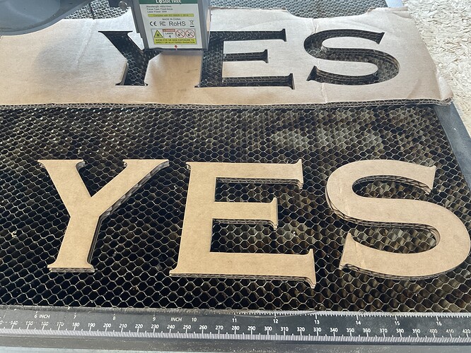

You can cut trough corrugated cardboard with diode laser ?
Very tempting solution !
Nice, how about speed ?
Could you use saw dust like caption, like with the router) for smoke ?
What kind of diode laser are you using ?
Use a dust extractor for smoke you mean? I don’t see why that wouldn’t work.
I haven’t done any material tests so that was a guess at settings
1000mm/m with air assist in 7mm cardboard.
As far as I know you can use lower power and multiple passes to reduce soot.
using a 30w laser LASER TREE K30 30W Optical Power Laser Module
(i got it for less than $300 - still, it ain’t cheap). I can cut a lot with it though - even 8mm MDF with patience and even very thick wood (this was in 2 passes, one from either side.
