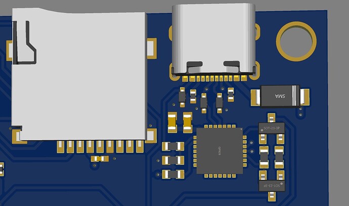

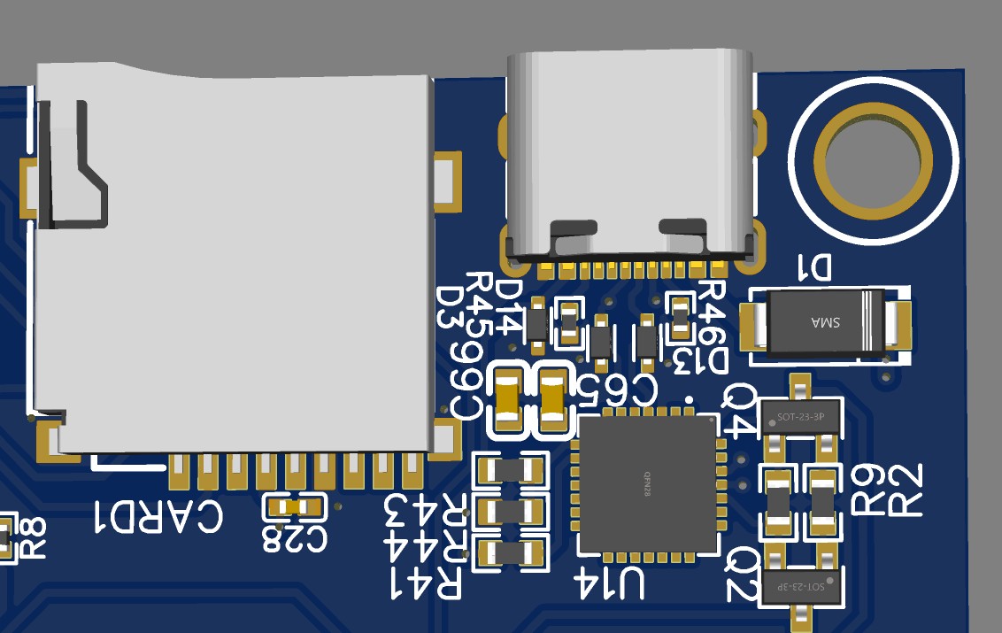

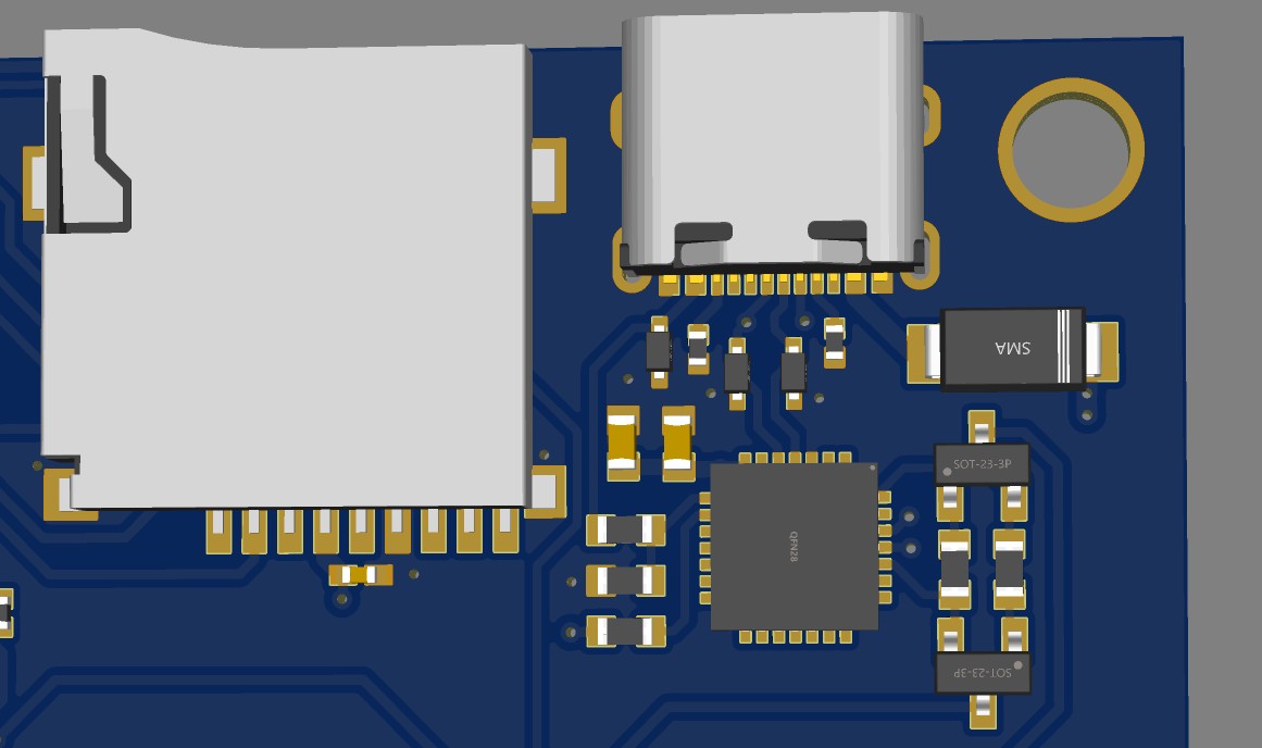

So another EE question. Since this is open source and easyeda is free software, are prefixes really necessary? If you are doing anything to the board, you will have the complete source open and available to figure out what a component is. It is so much more clean without them.
PS I know these are not all facing the right way yet, but…why bother if we don’t show them.
Leave the silkscreen and the designator is my suggestion.

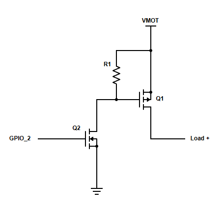

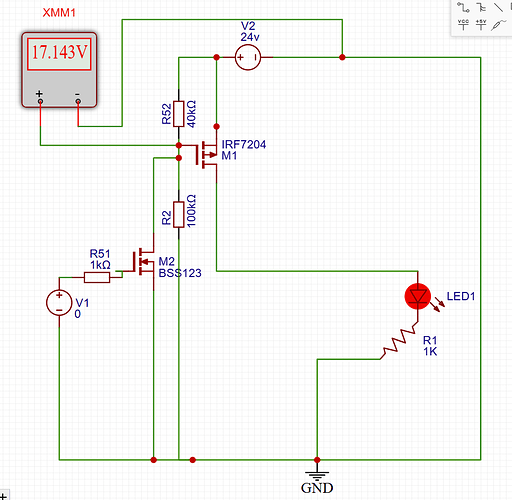

The 10k - 100k resistor divider by itself would put about 91% of VMOT on the gate if the GPIO were not connected. At 24V this would already be 2.1V below source and it might turn on by itself.
When connected to GPIO_2 and GPIO_2 is low, the gate will be dragged down to near GND and it will turn on even if the high voltage is 5V.
When GPIO_2 is high and you’re using VMOT, the resistor divider will try to feed it backward since 91% VMOT is higher than VCC and it could kill the ESP32 or in the best case there would be an internal diode to let it feed back to VCC with about 2 mA. Or you could add your own diode to prevent GPIO2 from being driven too high.
But either way, in the best case, the gate voltage will be only a bit higher than VCC and much lower than VMOT and the MOSFET is still on.

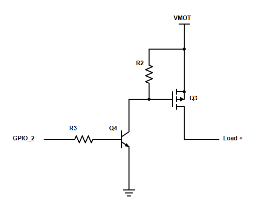

I think you might need something like this as a starting point:
Or you could also do this:
Dangit. I did see that as an example somewhere and almost went that way because it makes more sense to me to switch both lines.
Thank you for checking that for me.
I was so focused on Vgs, I did not even consider the voltage divider happening. EE is not simple. I assume R1 doesn’t really matter, 10k is fine?
Yes, 10k should be good.
A motherlode, as it were? :smile:

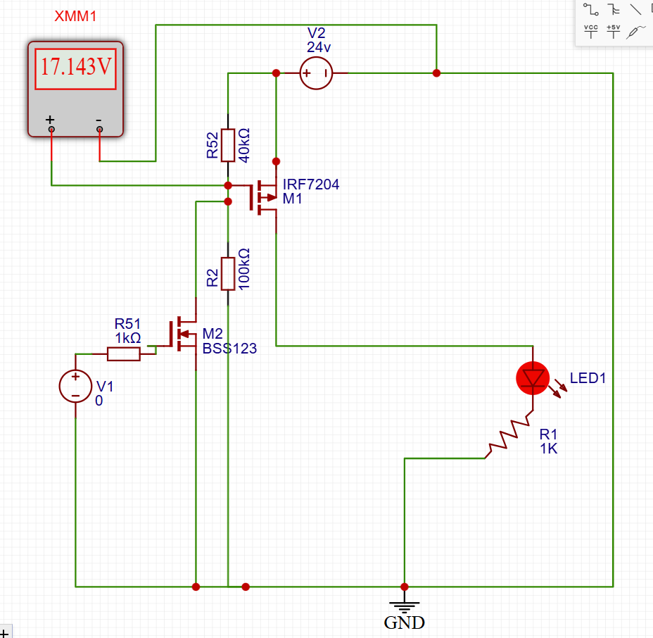

Okay thank you Jamie. That got me nearly there but I could not find many mosfets with a Vgs higher than 20V so I had to use a voltage divider. Looks like I can get 17v or 3.5V that should work just fine with a Vgsth of <2V.
Thank you for the nudge!

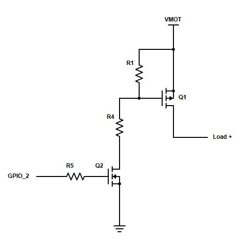

Oh, I didn’t realize the Vgs(max) was an issue but I see what you mean. I suspect that your circuit may still have a problem because when M2 turns on, the gate of M1 will effectively be shorted to ground and you’ll have 24 volts between source and gate. (Your measurement is between gate and ground, not gate and source of M1.)
I think what you meant might have been this:
When Q2 is off, the gate and source of Q1 are the same voltage, and so Q1 is also off.
When Q2 is on, the gate of Q1 is not short circuited to 0V, but is instead divided down by R1 and R4 for a fraction of VMOT.
Unfortunately, 24V and 5V are quite different and 40k / 100k will produce 40/140 * 24V = 6.8V for VMOT=24 and only 1.43V for 5V (between source and gate of Q1).
If you swap them so 100k is between source and gate (R1 in my diagram, R52 in yours) and the other one is 40k, then you’ll have 17.1V when using VMOT=24 and 3.57 V with 5V supply.
If you needed to handle 48V and 5V then we might need something more sophisticated, but as it is now, I don’t see a reason it wouldn’t work.
Dam you are good. that actually leads to a question I do not understand. That part is why I made it that way…but I do see you are correct now. So In your most recent diagram, I do not understand how R1 is a pull up. If Q1 is open, AND Q2 is open where is the ground coming from. Or does this mean with no load on it there is no pull up so this is all a waste as the is 24V at LOAD+?
I get that it is the difference between the two pins but there is no difference if there is no path to ground??
The other way to think about it is if the difference in the pins is 0v and 24V what the heck is R1 doing in your diagram?
So I guess that shows I don’t know how to use a sim. How did I get that backwards?
While doing all of this they do make a single chip for this exact thing, high side driver, mostly used for auto stuff. They are not too pricey either. IT is basically all this built in one with a few features added, some even have a tunable output.
The voltage drop happens due to the current flow. When there is no current flow, there is no voltage drop.
So, no current- no divider .
Okay, that part I get, but if there is no current flow either way what is that pull up resistor doing? In my head I see it as there is now 24V on the gate and source, so it is still Zero?
Nothing.
In fact, q1 should be always on.
Q2 should be on the high side with R1.
Edit- scratch that, note the FET types. It would work
