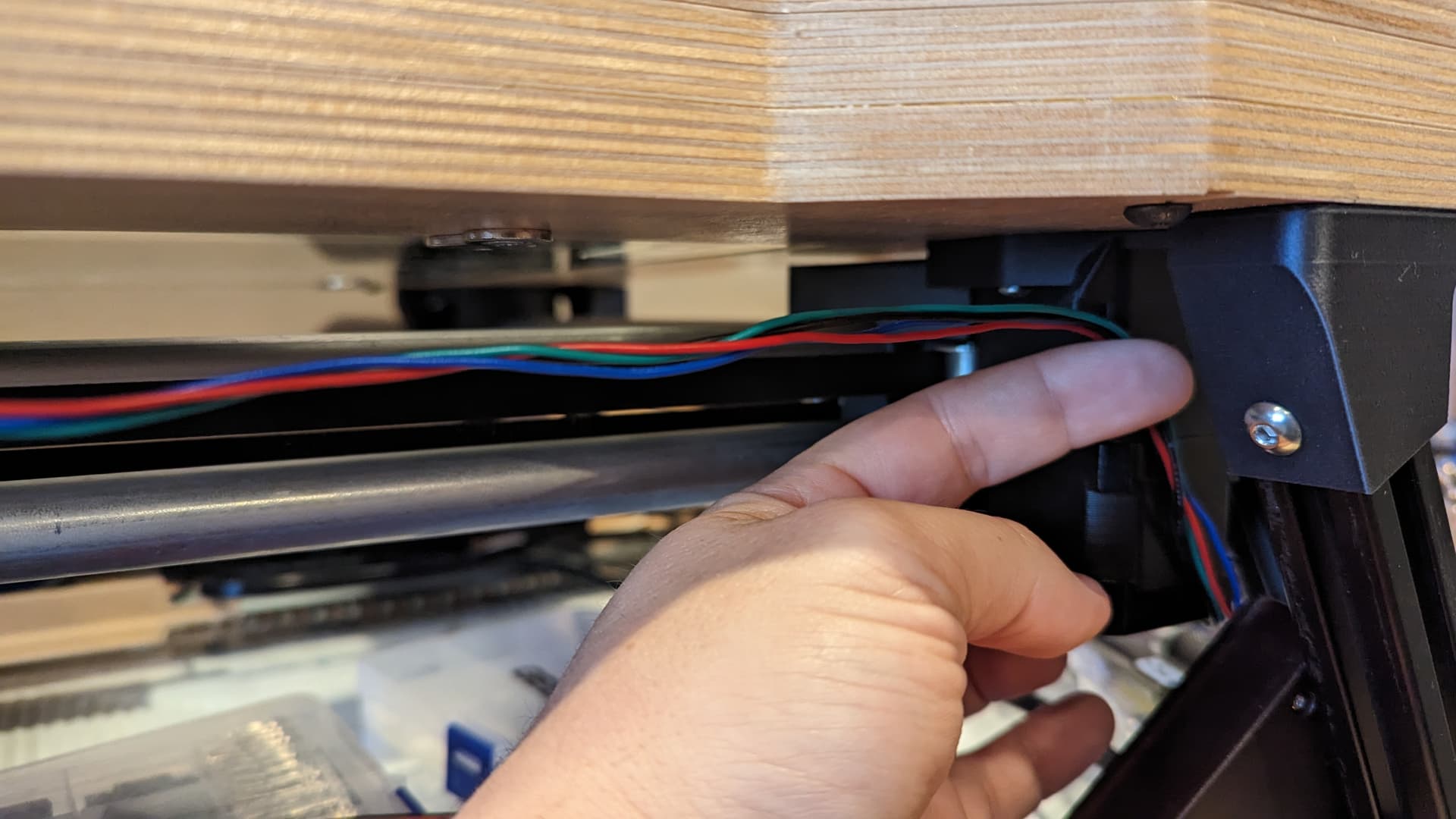

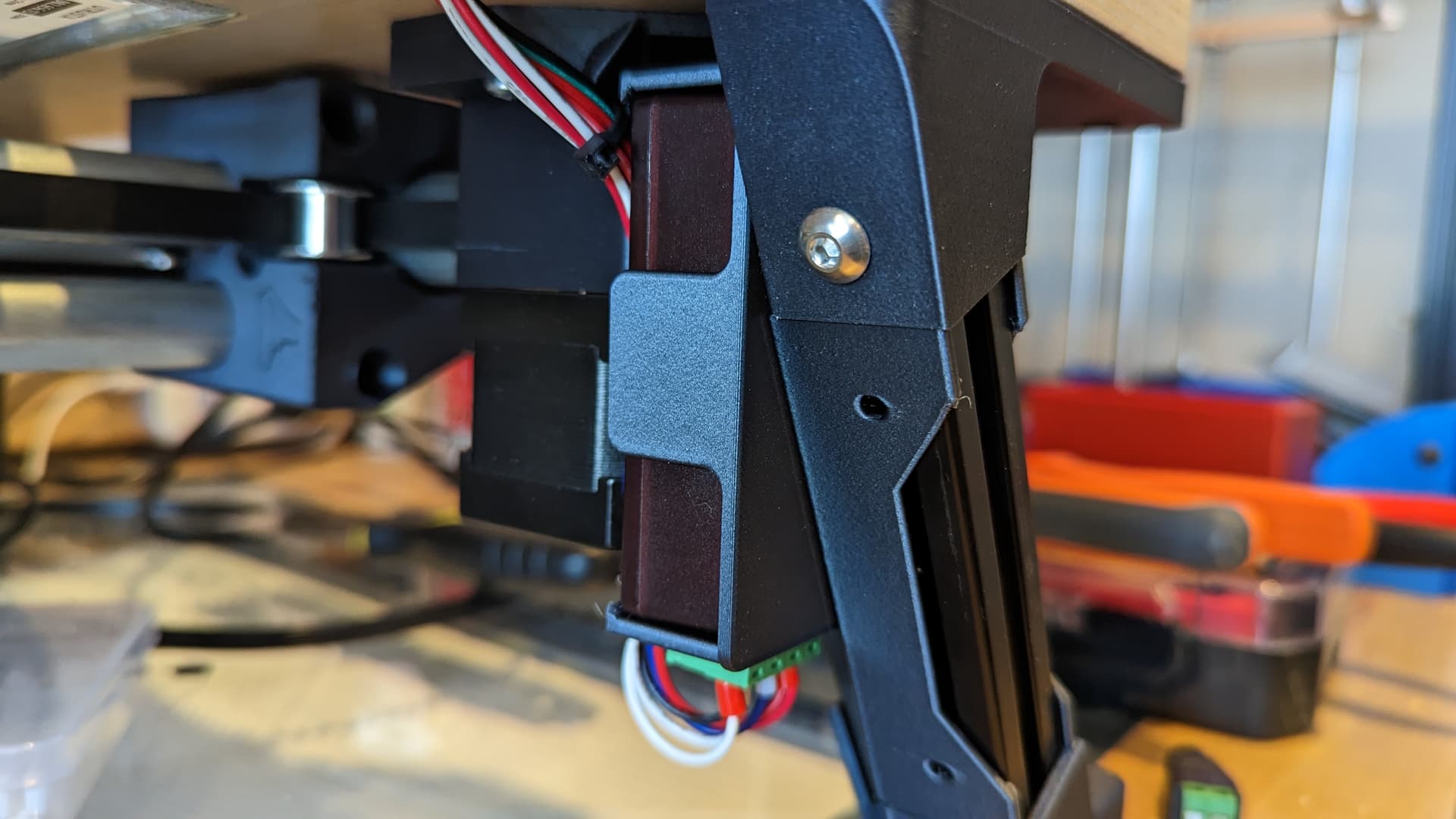

I am trying to decide how to route the second stepper motor wires. And the power for the LEDs.
There are these little zip tie spots, which seem like they were meant for this. But they are just a tad low. They would work, but they aren’t extra fancy.
I could dress up the cable a little by adding some of that accordion wire wrap stuff. Or I could print a little part to lift the cable a little higher. It is about a half inch below the surface.
Or I could cut into my table and route the wires in front of the LEDs in the middle layer.
I could design and print something I could glue to the bottom to manage the wires.
Thoughts?
If I hear nothing, I think I will try to add some wire wrap. If I hate it, I will add some glue on clip to lift it up.

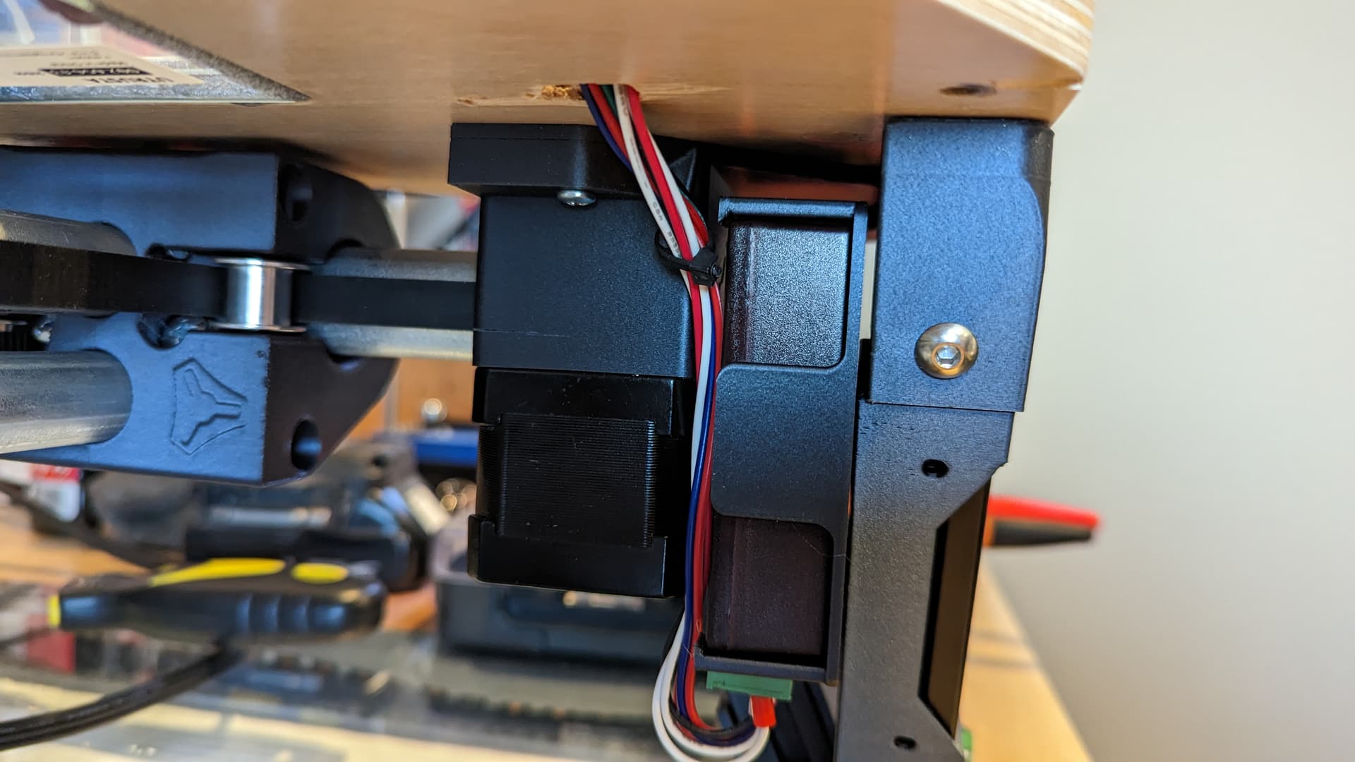

A pic with just the zip ties:
Like drill a little hole on each side, that seems easy?
If not I can model up some small screw in clips for you.
The middle layer is 0.5". The led strip is about that size. I was thinking I would have to route in a channel, but maybe they would be fine just hot glued down.
I have to make one hole already for the leds.
I can model some clips too. I have the machine sitting in front of me.
I’d cut a groove in the bottom of the table deep enough to inset the wire in it. Then use silicone blobs to hold it in place.

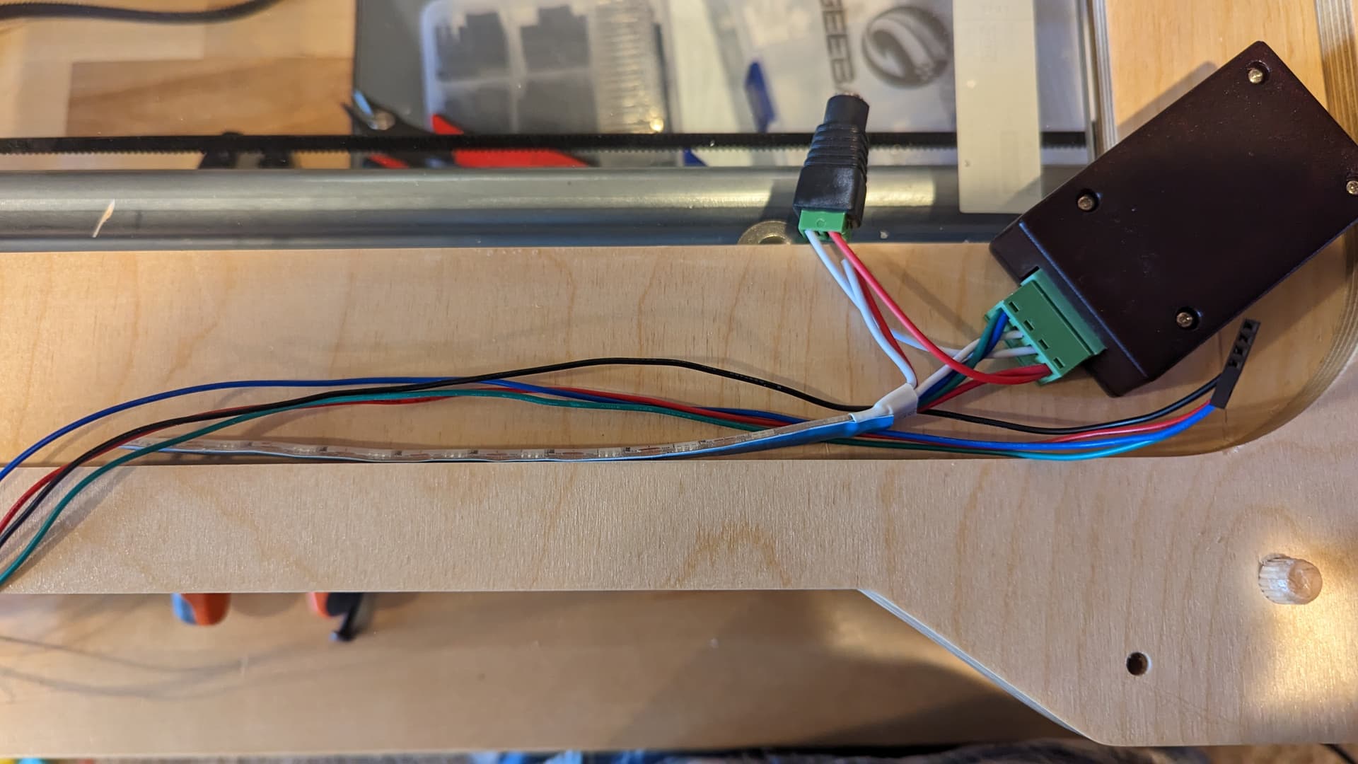

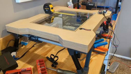

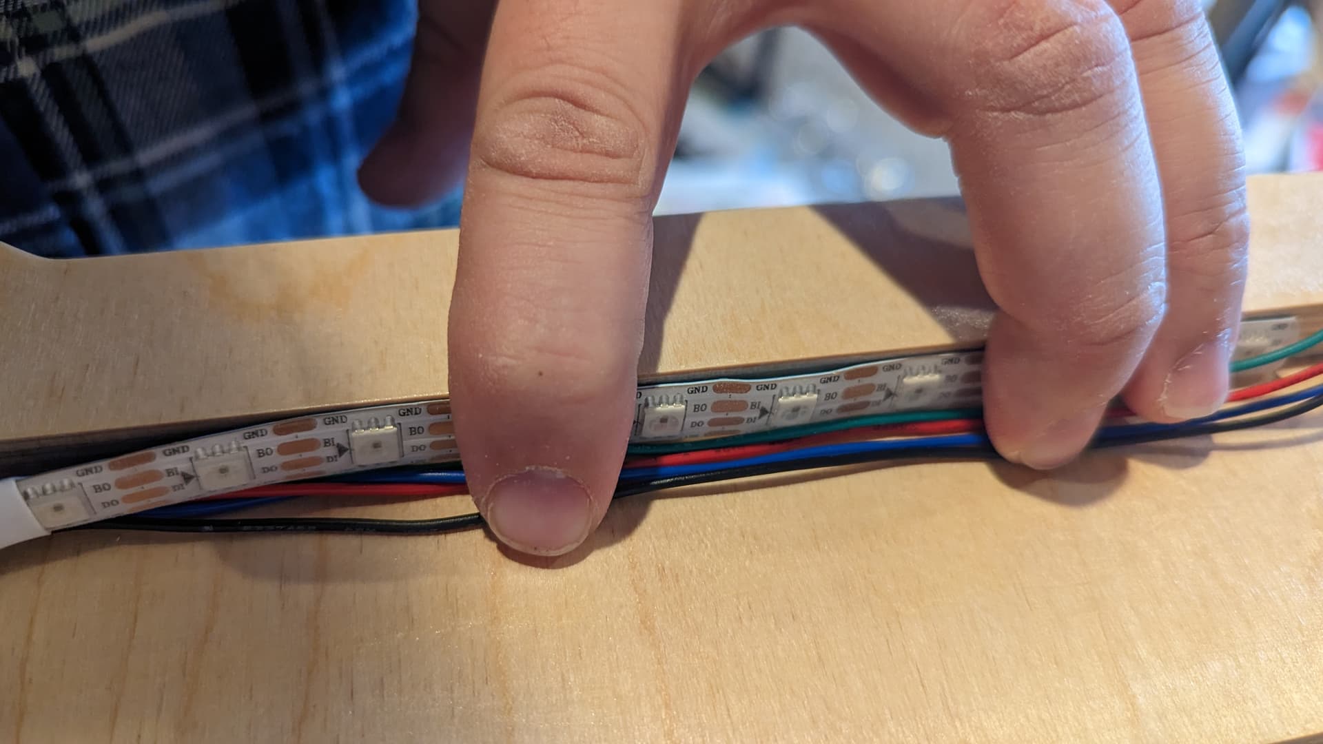

I took the top off. I might as well work on the leds while the electronic mounts are printing.
Here I have the 4x stepper wires. I need 2x more for the led power.
In this pic, they are crumpled down, but not flat. That might be ok. You won’t be able to see the leds or the wires directly. Just any shadow that the wires might cast.
Here I have flattened them out. I have some 4 pin ribbon cable, but I might just try hot snot to hold these down here.

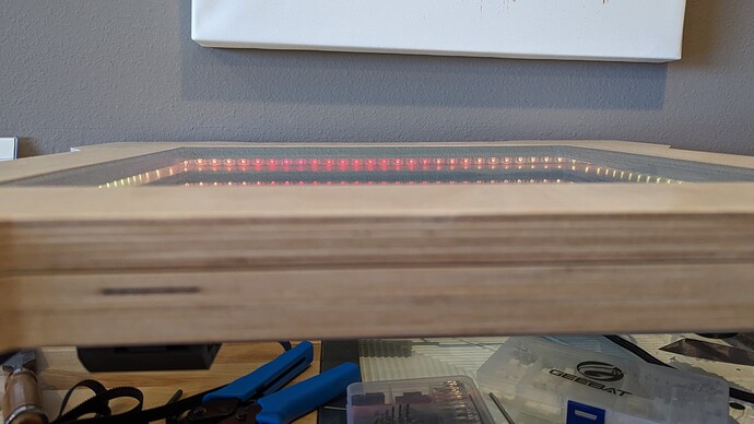

This gives you a sense of the scale of the led cavity. The top opening is a touch smaller than the bottom. So I don’t expect many people to be able to see the leds, just the lit up baking soda.

Leds installed. I am going to try to just hot glue down the wires. That should work fine.
If it doesn’t look good, it will be a fun group project :slight_smile:
That round corner inside looks great with the LED’s
LEDs are wired up. Getting power from the esp32 board. The wiring and mounts ended up reasonably tidy.
The LEDs are visible at one angle. The wires don’t seem to have an impact. Still, I will add a channel in the design for them.
