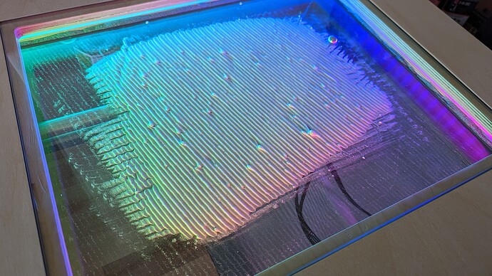

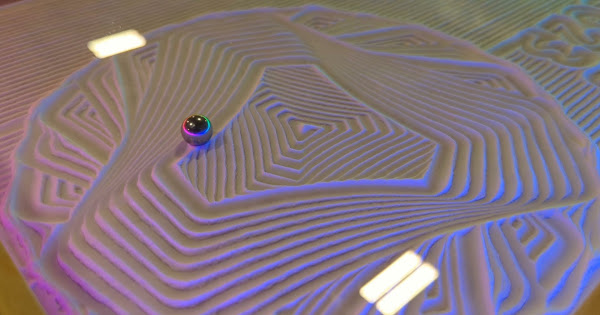

The colors on those LEDs looks really good. Is that your camera or do you really get that nice of colors? The pink and teal are really standing out to me. Maybe I have always just got janky lights in the past.
I find LEDs really hard to capture with my cell phone camera (pixel 6 pro). They look good to me IRL.
You can judge for yourself in 6 days :smiley:

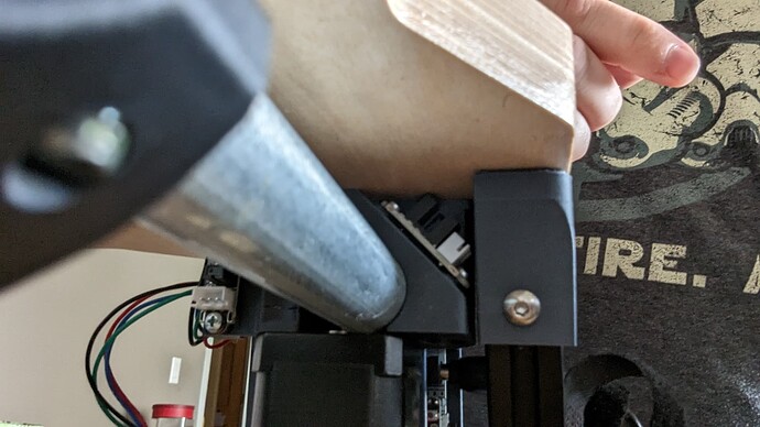

The wiring is all done. The endstop wiring was a little tricky, because the legs are in the way:
I might cut the endstop wires smaller and recrimp the ends, but it is working, so I am going to just run it for a while.

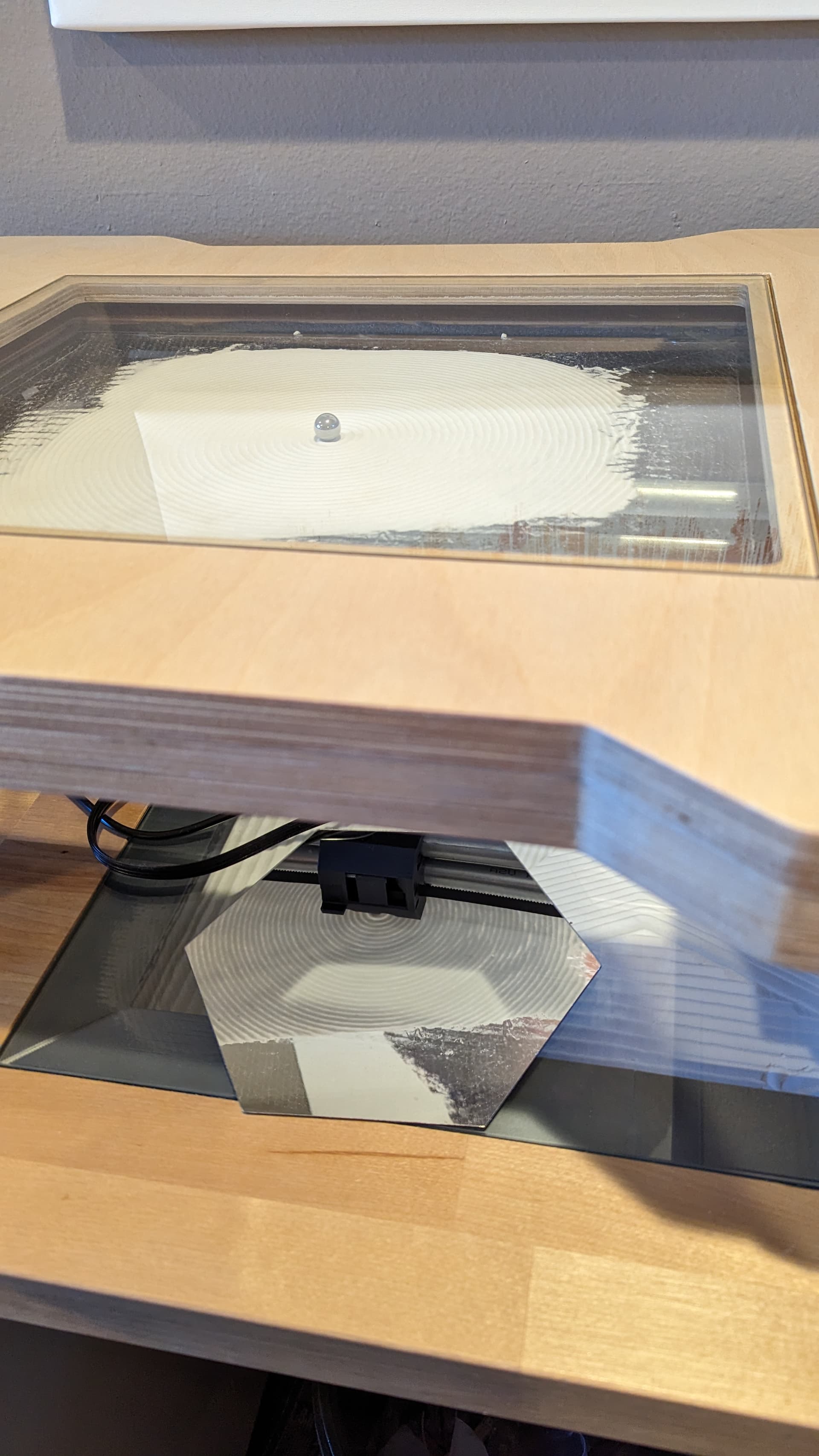

I didn’t find a cheap mirror that was the right size, or that I could easily cut. So I bought some plastic hexagon mirror tiles. I plan on putting several of these under the table so we can see what is happening under there. They are cheap, and feel/look cheap, but they will work.
Thanks for the idea, @Waspjr
That actually sounds super cool and even more stylish…look at you, all fancy and stuff.
I think I have 20 of them, or something. They came in a big pack. So if there is any use for them by the repeat or the LR, we can toss them there too.
Need to lay them out in a honeycomb grid so that the bottom of the machine looks like the fancy cars at '90’s auto shows.
A little under-cabinet lighting and a smoke machine would help seal the deal.
Maybe some pneumatics so that table can ‘jump’ a little… would help reset the board for the next drawing.

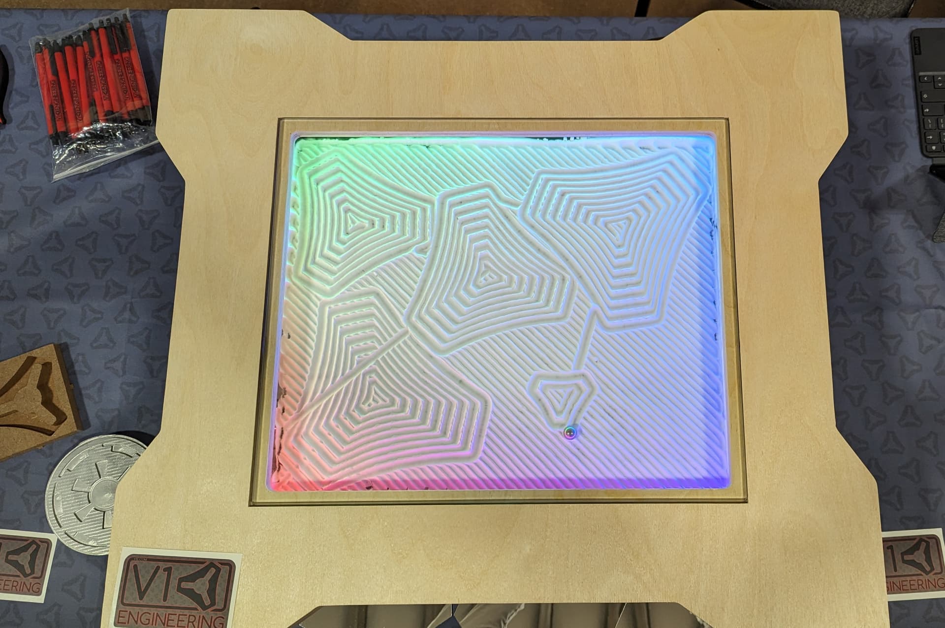

That table was great to see in person at RMRRF.
I heard lots of “that’s cool!” type comments as I was hanging out around the V1 booth.
So much talent amongst the community members…
It was very popular. Such a great conversation starter. I heard so many people say, “I am gonna make one of these”. And several people said, “I sent a picture to X and they said I need to build one”.

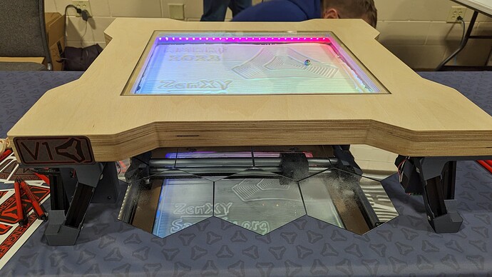

Unintended consequence, the writing was still legible in the mirrors.
A mirror image of a mirror image…
