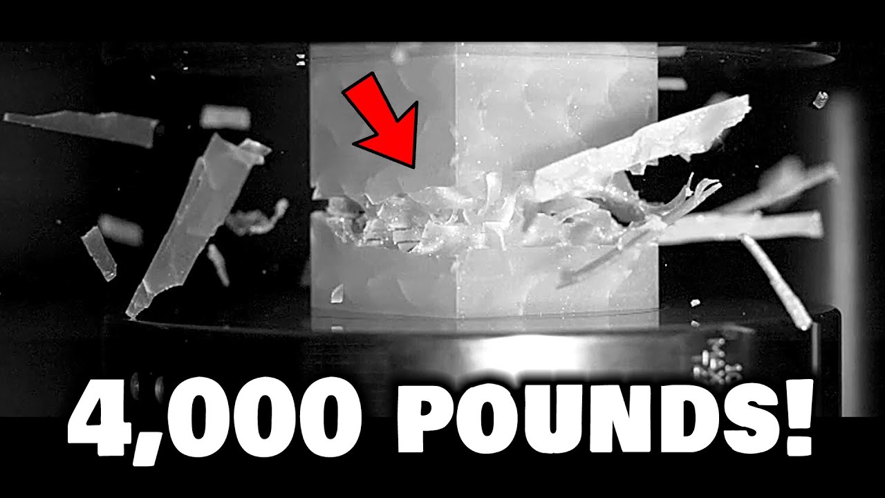

This video just got posted. Thought you’d find it interesting to see how strong plain old PLA is. I’m curious what people think of the infill type. Gyroid seemed to be the strongest.

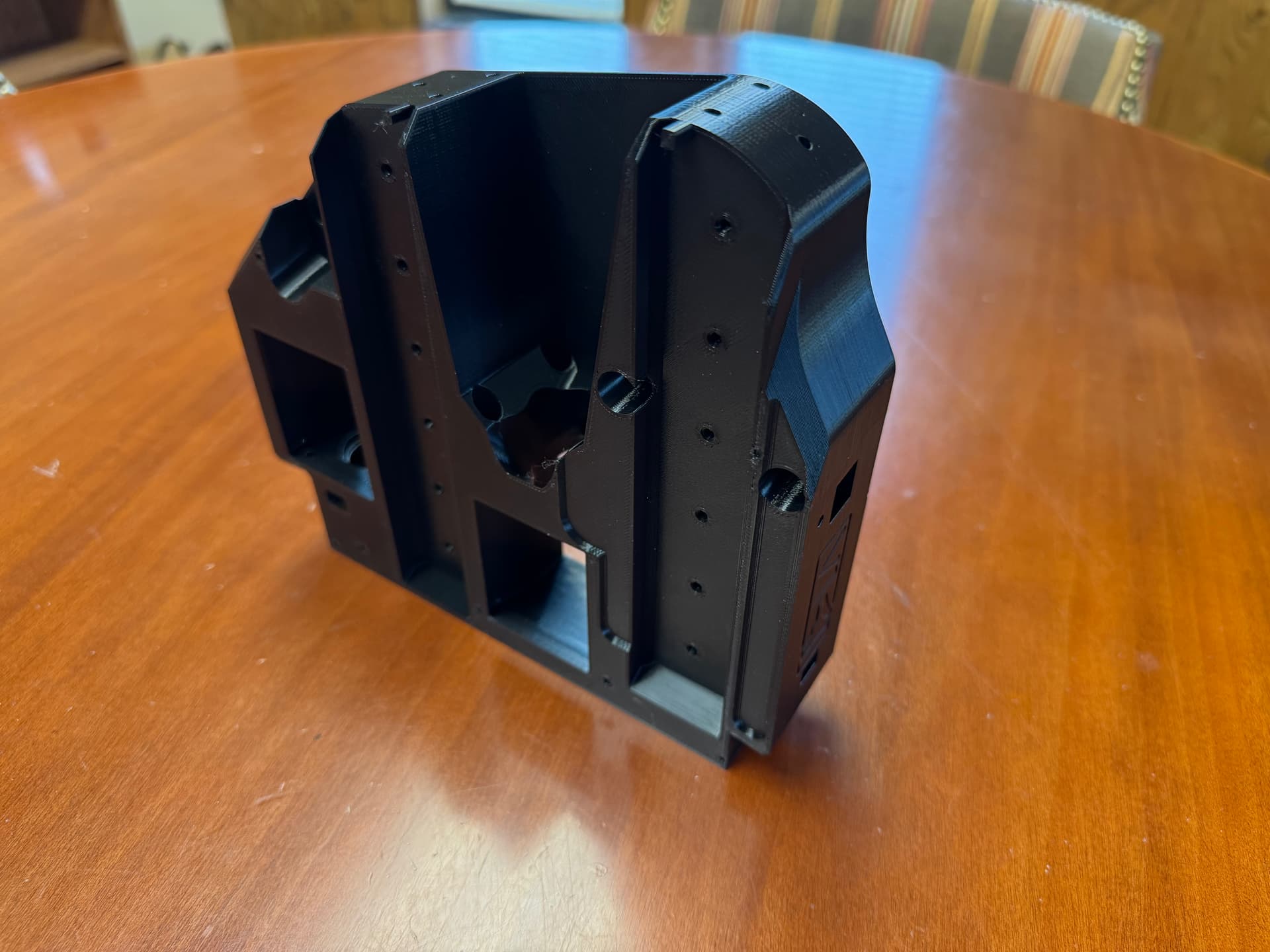

Just off my MK4 - Looks Fantastic… Should have most of the parts completed early next week.

Compressive is the least useful spec for us. Me use the forces with the layer lines, so even interlayer adhesion is a distant second to what we care about. So a loop pull and creep test is more relevant.

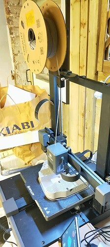

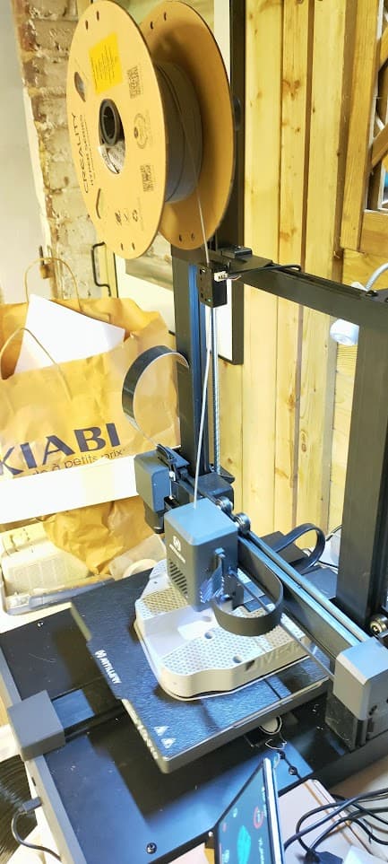

Mmmmmmmh… I think this filament roll is not going to make it… >_<
Need to order a new one real quick :stuck_out_tongue:
