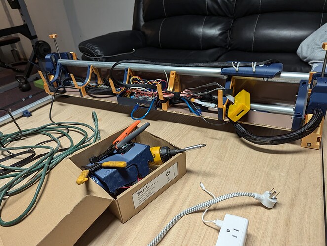

So you want to see the backside? This is mid build with the printed case lid not attached.

My build thread for the LR4 is now public, thanks to Ryan. It is a Beta/RC2 build (second Beta build in the world, only @Jonathjon was faster), so my Z homing/side plates are different, besides that the changes are marginal.
