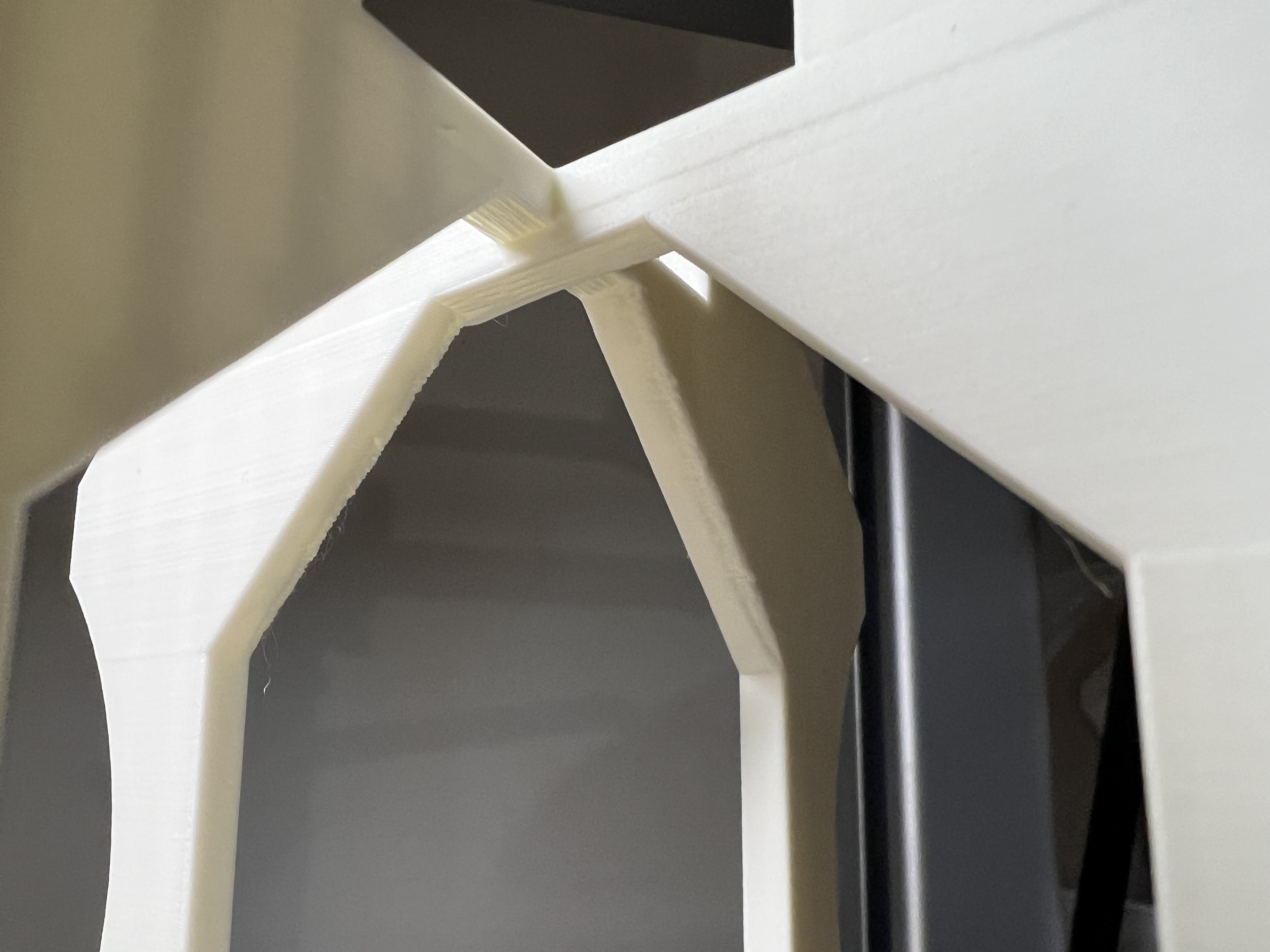

I design my own (more simple) skew test, my bambu A1 is almost perfect in every direction, 0,3% max error on each axis And the bridging of 20mm isn’t a problem at all.
The only thing I notice is a lil’ undersize of the same 0,3%, but i think is due to material shrinking (overture Matte PLA)

Regarding perfection, my printer was over extruding. Bolts were too tight. Parts of close tolerance would not fit. I did the calibrations and now not only does it make close tolerance high quality parts, it just works now. My calilantern was a D+ rating, but it was vastly improved and it has proven to be reliable. Bolts fit now. Close tolerance parts slide as they should.
Test print the ymin belt min f and the y min belt lock and see how they fit. If the lock easily slides in and the belt passes through, then you are good. Another check is the z nut and the z stub. They should slip fit together and not require tools to press in. I did the orca slicer calibration tests and the calilantern and my prints went from reasonable to amazing and much faster as well. My beta experience was really learning how to print these parts from what I thought was acceptable to truly quality parts that look and perform well.
Taking the time and extra filament to calibrate is worth it.
