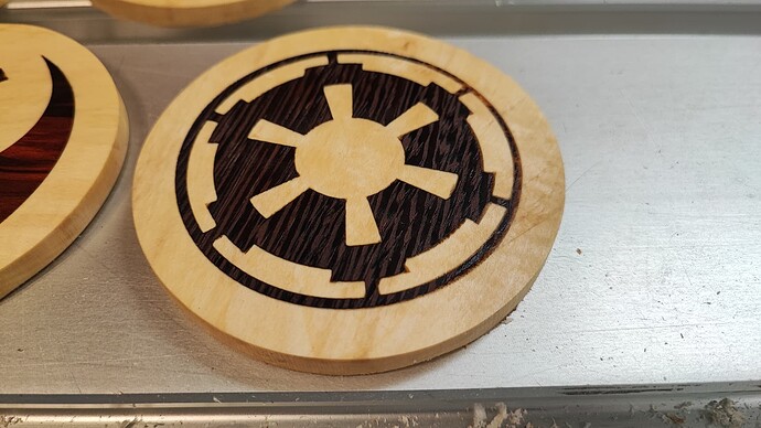

Star Wars Coasters
Best friend is turning 40 and is a big nerd, he definitely needs some Star Wars coasters.
Chestnut wood with red heart, purple heart and wenge inlays.
Can you guess which one was replacement I eyeballed? :joy:
He’s getting it nevertheless. For the unwanted guests… :yum:
Logos Coaster Starwars.dxf (302.0 KB)

Comparing this to your lego piece? Is inlays or epoxi fastest?
Epoxy is way easier than wood! I have done a few epoxy ones, but have yet to try a wood one. One day…

These looks flawless, by the way. I think you have it dialed in
These are awesome and inspire me to ask a clarifying question. Did you use a V-bit to create the mating design? Some of the corners are so sharp I’m trying to understand the technique.
My bandsaw isn’t really up to resawing at the moment, so perhaps that a project for the weekend.
Likewise. Love the product, would like to know how to make my own designs using this technique.
Generally it works like this:
Just don’t do three toolpaths but one.
The most important parts (example):
Mirror the motive to create the plug, give it a border.
Depth of the cut of the ā€œholeā€: 2mm
Depth of the cut of the inlay: 1.5mm (that’s what is not going to be in the wood) and starting depth 1.8mm (that’s what’s going to be in the wood, 0.2mm for glue).
Clear with a 3 or 6mm endmill depending on size (3mm is often faster because it can reach more corners), then swap to a 30, 60 or 10.4° v-bit.
Use completely even wood or it will look like the one imperial coaster, use a touchplate.
Added the DXF for anyone that wants to cut some him/herself to the first post.
