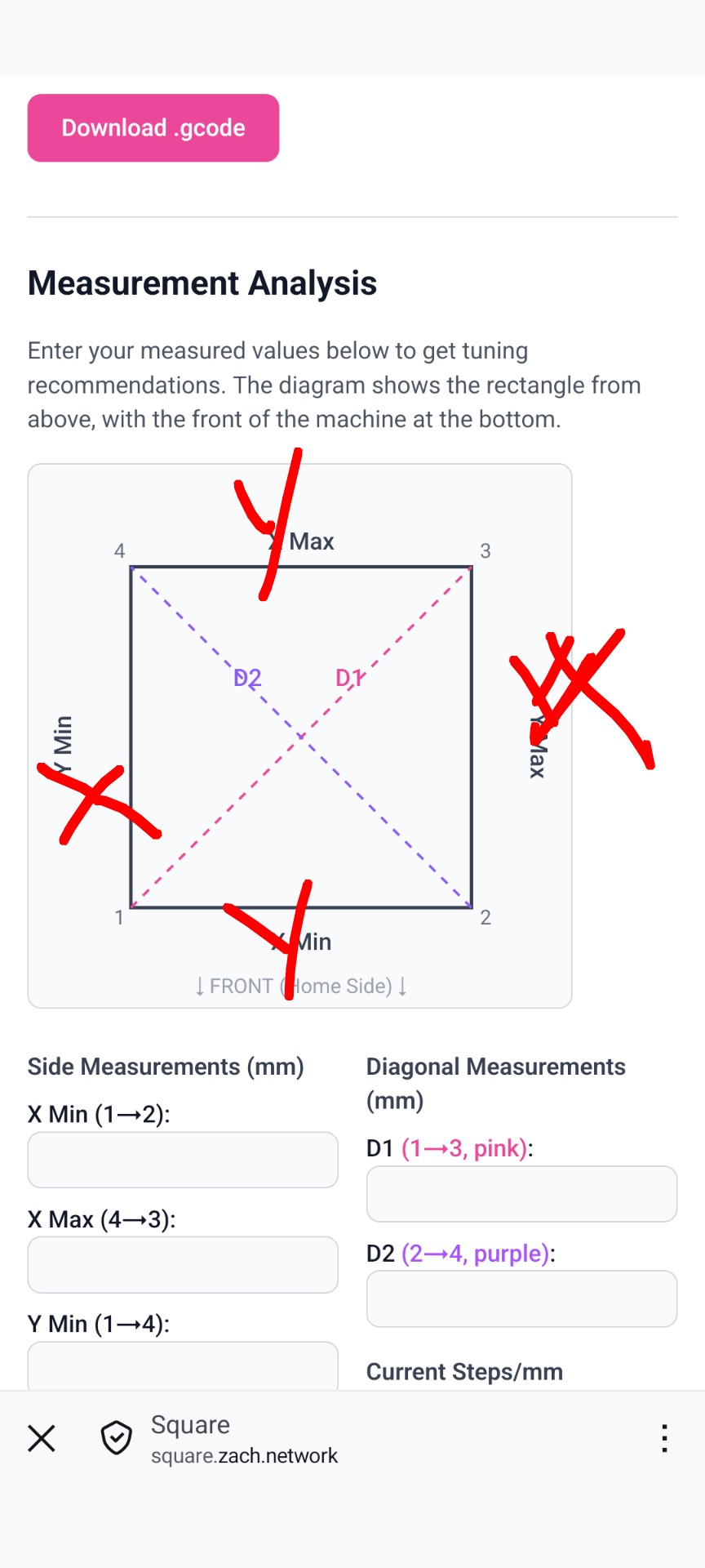

Now that I’ve built my fifth table, I get to square the damn thing. I finally got tired of manually jogging the machine around, taking (and re-taking) measurements, and then trying to calculate offsets.
So, I (with some robot help) built a tool to:
  • generate gcode that drives around in a rectangle and pops down to pierce the table
  • accept your measurements, let you know if you have broken the laws of physics, and suggest tuning.
I haven’t tested this yet (but will have by the end of the week). Feel free to poke around at it and let me know if you see something off. Thanks!
The default LR configuration should be this: Xmin at the Left, Xmax at the Right side, Y min at the front of the table, and ymax at the end.
Others may get confused

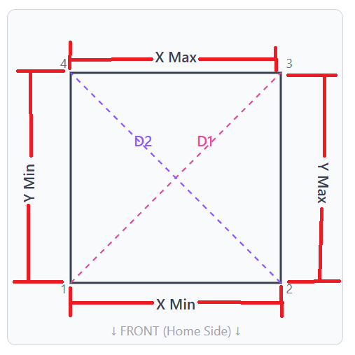

The gcode seems to have X/Y correct but I agree the axis labeling seems off.
I like the idea and analysis.
I debated this a bit. I thought it would be confusing to label the Y axis with ‘X min’. But with two votes to the contrary, I’ll change it.
Can you explain? I think you need to measure both diagonals.
I see your perspective. Maybe you’re right. Those labels are for the lines and that is what the measurement is for.
Maybe showing them like CAD dimensions would help?
Or changing the labels like “Y @ Min X”

Personally would expect corners to be labeled for orientation, e.g. Xmin​,Ymin​, the numbers 1..4 are useful if guide is instructing to move corners to correct Squaring.
Sides are what Users measure, e.g. Front, Back, Left, Right. That seems more human friendly than asking to measure edge distance between numbered vertexes.
Consider input fields labeled with Side name. Users are just measuring distance along a side or diagonal.
Some people may use different orientations and labels for their machines, that’s fine, and it’s also fine for them to figure out the mapping for their setup that strayed from yellow brick road.

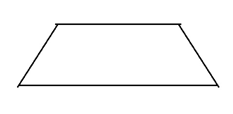

Measuring only two things is insufficient, you also need to make sure that opposite sides are equal length. This is an extreme example to make a point but, the diagonals in this figure are equal and clearly it’s not square.

The vast majority of squaring issues are when the 4 points create a parallelogram (opposite sides are equal and parallel). The likelihood of creating an isosceles trapezoid (opposite sides equal, only 2 sides parallel) is extremely unlikely, unless your machine has some serious issues.
Yes, it is a good idea to measure the distances from XMin YMin to XMin YMax and compare them against the XMax YMin to XMax YMax distance (and against the expected movement), but the likelihood is that 99.9% of the users won’t see a difference (or maybe a couple of mm at most), while a fairly significant number will find differences when measuring the diagonals.
You certainly are free to measure your build however you wish, I just don’t think that encouraging new builders to diverge from the YBR and follow you into the weeds is a great idea (IMO).
If your machine is misconfigured/misbuilt to be trapezoidal, that is uncorrectable with pull-offs alone. Pull-offs don’t shorten any side, and a trapezoid’s angles can’t change without side length changing (keeping the parallel sides parallel.)
This machine is a parallelogram in the ideal non-corrected case, but belt tension and build errors can lead to sides being different lengths. Since the X gantry won’t change size (…hopefully?) this means there’s no physical possibility of perfect squareness.
