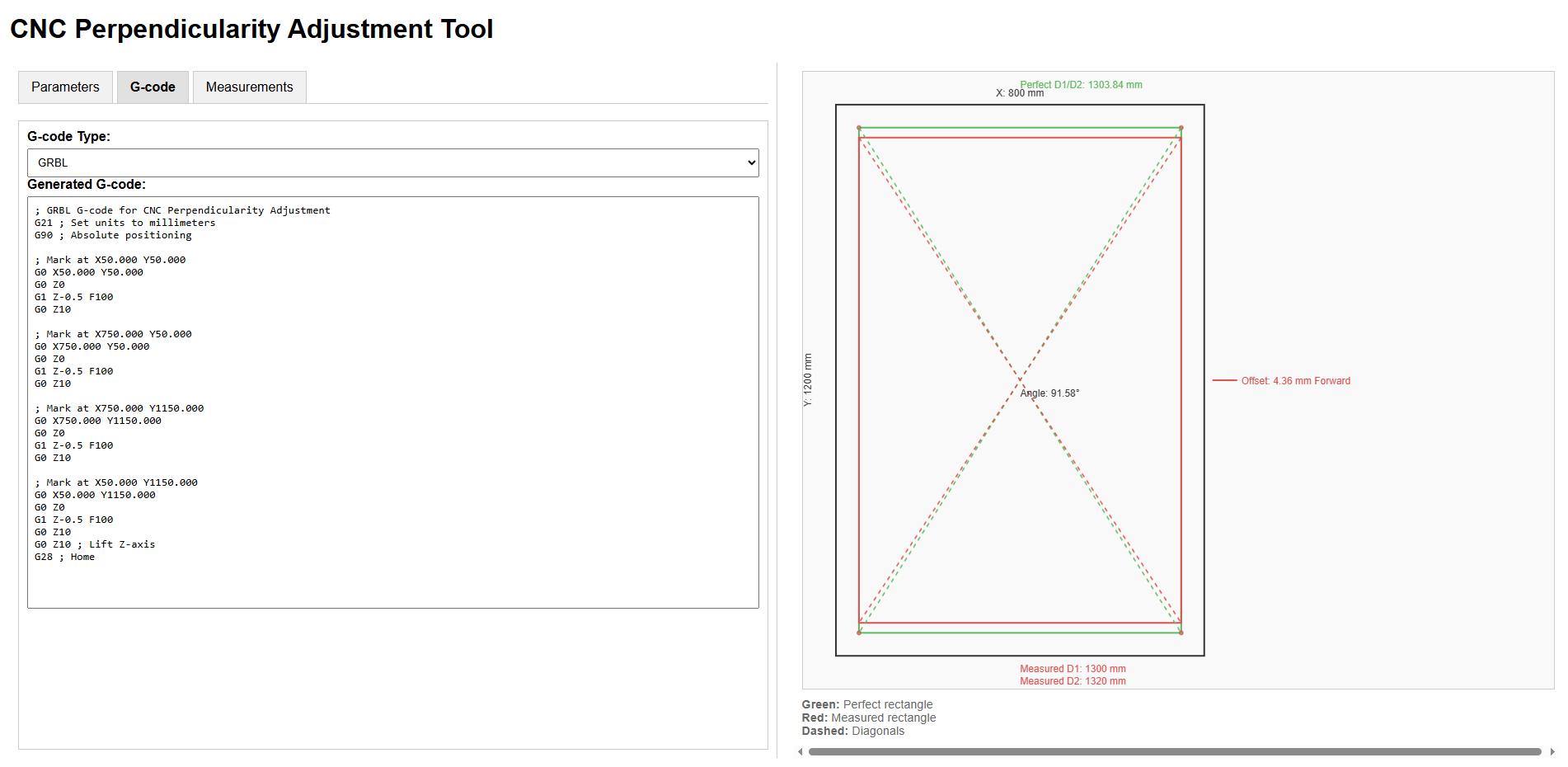

Squaring helper
Thanks for making this.
If it had a ‘fire laser’ option in lieu of plunging a tapered bit that would be cool. :innocent:

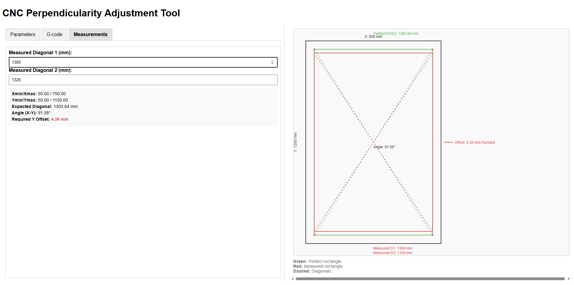

How would you go about cutting pieces like this most easily?
I admire your build carefulness. My pull-off always needs adjustment after a new table and I still struggle with square-enough-for-cabinets!
Not exactly, if you move y axis 800mm and x axis 600mm, the diagonal should be 1000mm, this is known as the 3-4-5 rule in the construction world, 8ft-6ft-10ft. If something is off you move the y side to adjust.
Of course, you square your machine after verification of your belt tension, to avoid one side moving more than the other.
Sorry cant explain more. But there us a lot of videos about this (also, you can thake this with any measurements units. )
This can not happen with a LR.
Most of my builds come out really close definitely under 2mm diff on the diagonal test. Then I dial it in to under what I can measure.
After that though, it does not move. If you are not able to hold you square there is another issue with the endstops or screws moving.

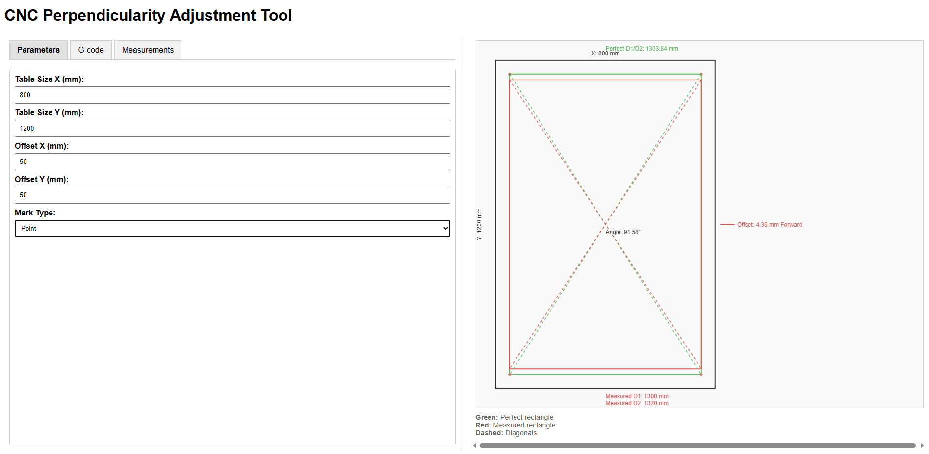

I love the idea, this is handy. Easier than my instructions code for sure. I need to look at it more and see if it is suitable for a brand new CNC user.
I did not test it but how did you account for the offset from the end stops to the test point?

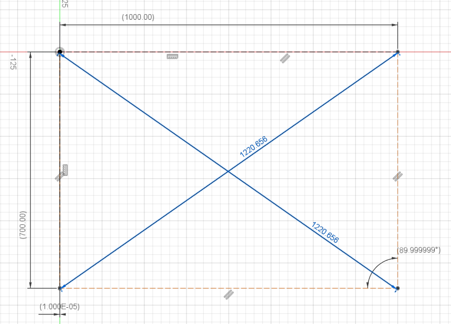

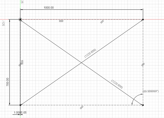

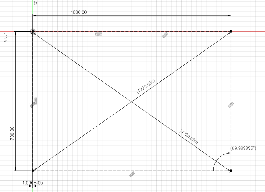

In my case, I have a similar “tool” in the form of a Fusion3650 design
  • I made a Fusion360 sketch with a rectangle roughly the size of my table
  • I have a laser attached to my toolhead so I used it, but you could use a pen
    • Exported the design to Lightburn
    • Drew a small cross at each corner
    • Put some blue tape on the table where the crosses should land
    • Laser-engraved the crosses on the table/tape
  • Measured the diagonals between marks
  • Went back to F360, switched the side Y side dimension to “driven” and the diagonals to “driving”
  • Put the measured diagonals in F360
  • See the Y offset and adjust (capture is just a pretty extreme example for vizualisation…)
  • Rinse and repeat
Design attached below…
LR3 squaring.zip (109.5 KB)
Just to be clear, having something similar in a web interface is just great and maybe a lot simpler :slight_smile:

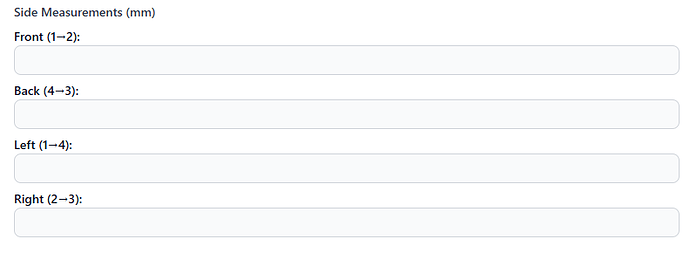

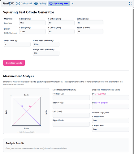

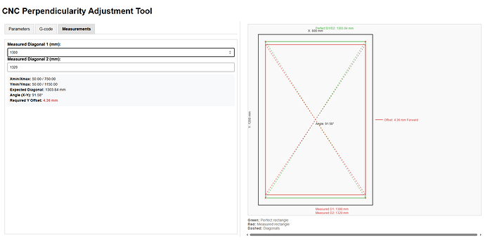

I tried the one linked above really quick and I find it a bit confusing:
  • There’s no need to measure actual X vs expected X or actual Y / expected Y on this machine, it’s a bit redundant
    This whole block could go away, or may be optional/hidden
    If anything, make a second tool (although this test should be conducted first) to measure actual movement vs expected
  • Clear vizualisation of expected diagonal dimensions vs actual and their effect on squareness is critical for comprehension, maybe adapt the graph to reflect those, and display expected values next to the actual measurement input
    See my diagram above…

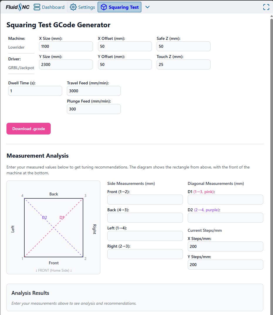

I’d love to have this as a FluidNC plugin too, this would be the easiest for new users…

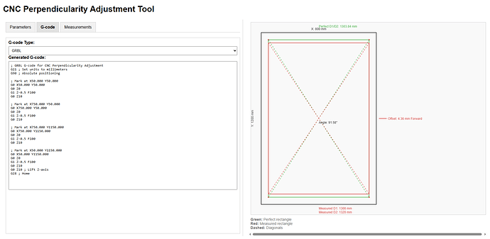

A few prompts later…
Caution, not tested, AI genreated….
index.zip (4.9 KB)
If interesting in making it a real FluidNC extension, I can help if needed.
I think I modified my FluidNC to get around CORS, but this works for me. Also, only works if FluidNC running in STA mode.

Can an extension read/write the machine config? That could make this all pretty automatic. If there’s documentation on writing one, I can take a crack at converting it.
This is not true. Adjusting the pulloffs precisely (and tuning steps/mm or tension) requires you to know how much you actually moved, not just how much you tried to move.
Yes. Same as you would do to update it via the terminal:
$/axes/y/motor0/pulloff_mm=123.456
$/axes/y/motor1/pulloff_mm=123.456
Here is some limited documentation I have that also points at the official.
ESP3D-WEBUI-Mods/Docs/Development.md at main · jeyeager65/ESP3D-WEBUI-Mods
And these are my extensions. The HoldMonitor is a really basic example and Joyjog at least reads values.
ESP3D-WEBUI-Mods/Extensions at main · jeyeager65/ESP3D-WEBUI-Mods

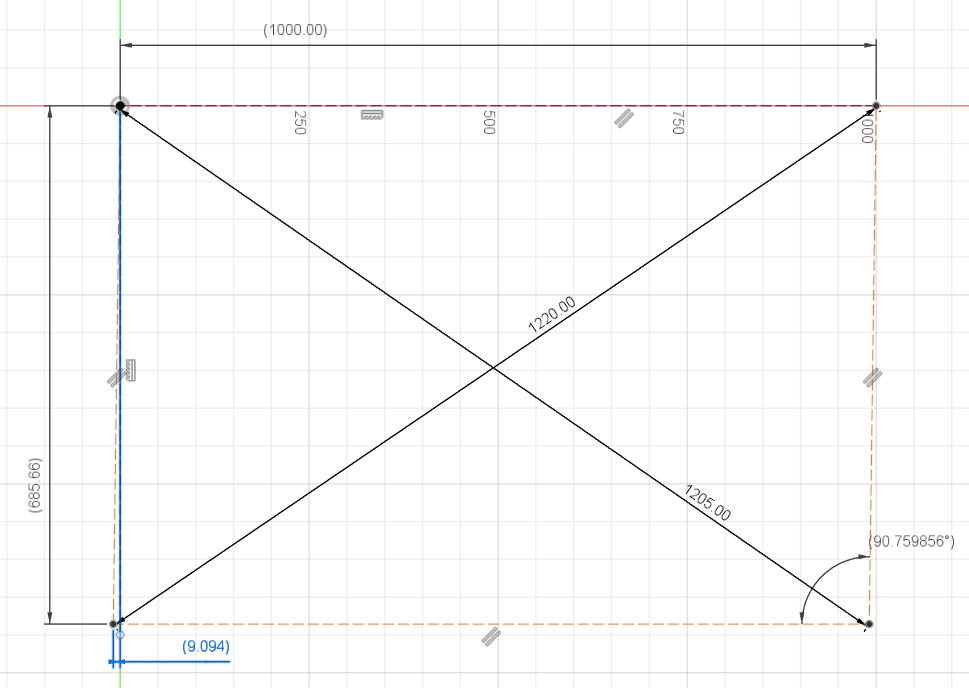

LowRider Endstop Adjustment v1.zip (40.0 KB)
I did this fusion project up some time ago to calculate endstop offsets.
The sketch lines on the sides represent the belts, and use the Belt_Width parameter. I didn’t parameterize the sketch all that much though, because the rest of the parameters just assume that you commanded a square, and got a parallelogram with equal length sides. (This may not be exactly true, but is probably close enough.)
In the sketch, you enter the 2 diagonal measurements, and the calculated offset is on the lower right.
Edit: LOL, I knew that I’d put a topic out there… Square your Lowrider by adjusting endstops
