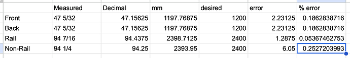

This points to the machine being out of square. I drove it to all four corners (by homing, then entering manual instructions: G0 X0, G0 X1200, G0 Y2400, G0 X0.
Here are the distances I measured:
So one side is moving 3/16", or just over 4.75mm, over 2400mm. But honestly, none of the dimensions really make sense. I’m telling the machine to drive 1200 / 2400mm, but each distance seems off by a different % error.
I repeated the measurements 3x with the same results each time, so whatever is happening seems to be a problem with accuracy, not precision. I also don’t think that the diagonals mathematically work with the edges I’ve measured, so maybe my measurements are off?

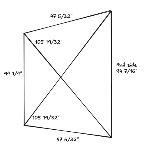

Your hand sketch shows an equilateral parallelogram, but is this born out with actual measurements? (E.g. at one extent of travel are the +/- Y tangential to the X, or are they truly as your figure shows? That would be very unusual indeed)
Jackpot
I took these across three repeats. Each measurement was within 1/32” or 0.79mm.
It’s a trapezoid. These are the four points I marked at each of the corners of my machine when driving around. It’s like the non-rail side Y stepper was running a bit short (or the rail side long.)
When your machine completes squaring, the Y endstop sides of +X / -X are not tangential to the Y rail?

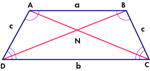

The math doesn’t add up in your drawing. Simple geometry dictates that the “X” section of the drawing (the two diagonal lines, not the X axis) cannot measure exactly the same if the opposing vertical lines and/or the opposing horizontal lines are measuring differently.
Are you sure that there wasn’t some measurement error (tape measure moved slightly, parallax, etc.) when measuring the diagonal lines as you squared the build?
I’m not sure this is true. An isoceles trapezoid has two equal-length diagonals. And since the LR4 X-axis can’t change (except due to measurement error, blocked movement, or skipping steps), this is a valid configuration.
Unless I’m misremembering my geometry? Very possible, it was a long time ago!
But the whole issue I’m trying to debug is why this is a trapezoid and not a parallelogram. The two Y-axis should be the same length, but they are repeatedly measuring differently on the board.
I agree that the math lines up with a trapezoid being able to have the same diagonals. The perplexing part is why a and b aren’t the same length. Are the belts from the same roll? If not, I’m questioning if they have the same number of teeth.

The other weird thing is that, geometrically, my diagonals are almost 4mm too long for the trapezoid I’ve measured at the edges. This is one datapoint towards a measuring error…
Yes, you are correct. I was assuming that at least on of the angles was 90 degrees. If all of the angles are not 90, then a trapezoidal would give the results seen. I withdraw my earlier comment.
In this diagram, let’s say that a & b are lines that are in the direction of the Y axis, and that c & c are lines that are in the direction of the X .
In that case, because the gantry angle in relation to the Y rail should never change, angles C and D should always be complementary (should add up to 180 degrees). Similarly, angles A & B should also always be complementary. That is not the case in an isosceles trapezoid, where angles A & D are complementary, and angles B & C are complementary.
You mention that the LR4 gantry is a fixed length, but the gantry angle with respect to (wrt) the Y rail is also fixed, as long as the Y motors are moving the same distance. If they are NOT moving the same distance, then that might explain things, BUT they would need to be moving at the exact difference needed to make angles C & D to be equal (and non-perpendicular), and to make angles A & B equal (and non-perpendicular). This seems strange. Loose grub screws perhaps?
The car that runs along the rail can twist off the rail slightly. This angle doesn’t have to be 90’, they don’t have to be complementary (indeed, if they always were, we wouldn’t need to do any squaring in the first place.)
I think that is what’s happening. Or at least that’s what my current measurements indicate. This thread is all about trying to figure out why!
I’ve already had that problem before, and fixed it. I even double checked it before making the post:
If they were PERPENDICULAR, then squaring wouldn’t be necessary. But unless the Y motors aren’t moving in sync, then they should be always be complementary, regardless of perpendicular. If they are complementary but not perpendicular, then the diagonal measurements would be different, which is why we use that method to achieve square (perpendicular)

This is an interesting problem and you seem to be careful with the measurements. 0.185in/94in is 0.2%
