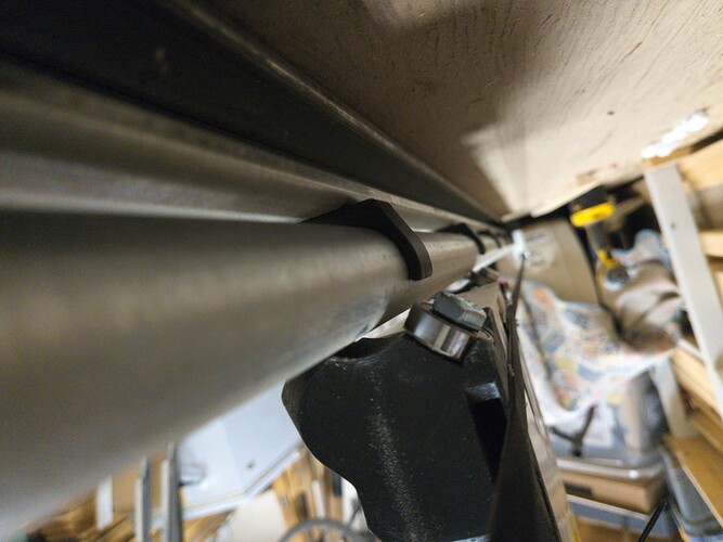

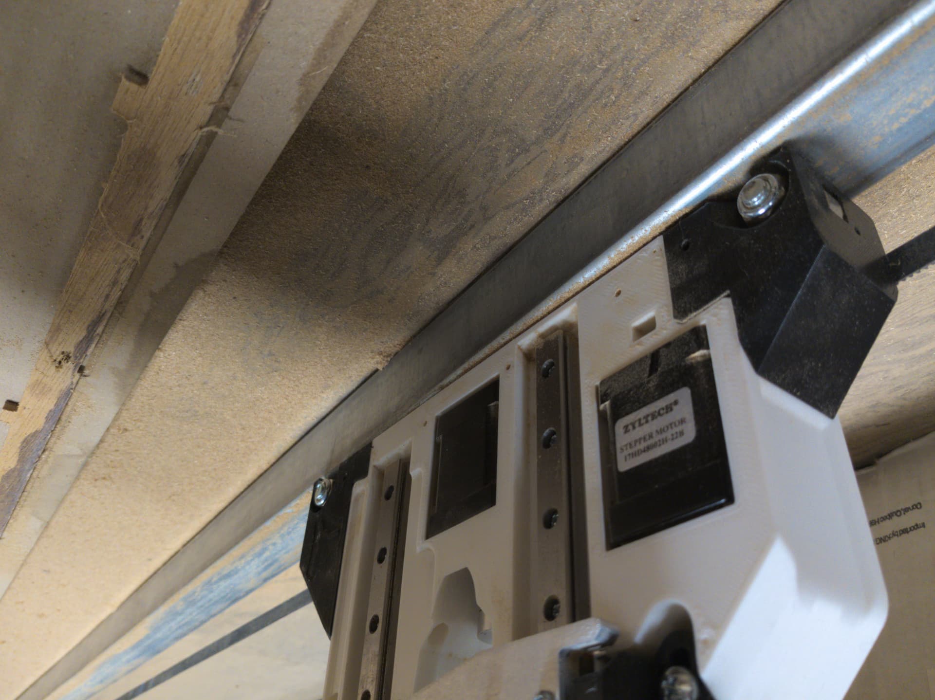

After cutting the struts, switching out the temp ones and reassembling, the gantry is no longer tracking straight. The further away from home the worse it gets. After about a meter of travel, the rail side is lagging behind the other side fairly badly (see pics). I thought this may be due to the strut plates being not being tightened in the correct position, but after loosening off all the screws, it’s still not tracking correctly.

I dont know why the images are upside down, but rest-assured, it’s actually on the floor!

Are you sure you printed the right parts for your diameter pipes? I think the bearings should be flat on the tube. In the picture it is only making contact with the corner of the bearings. Edit; or are you tilting it? Difficult to see from the picture.

That picture is showing how it gets so skewed that it’s pulling itself off the rail!
