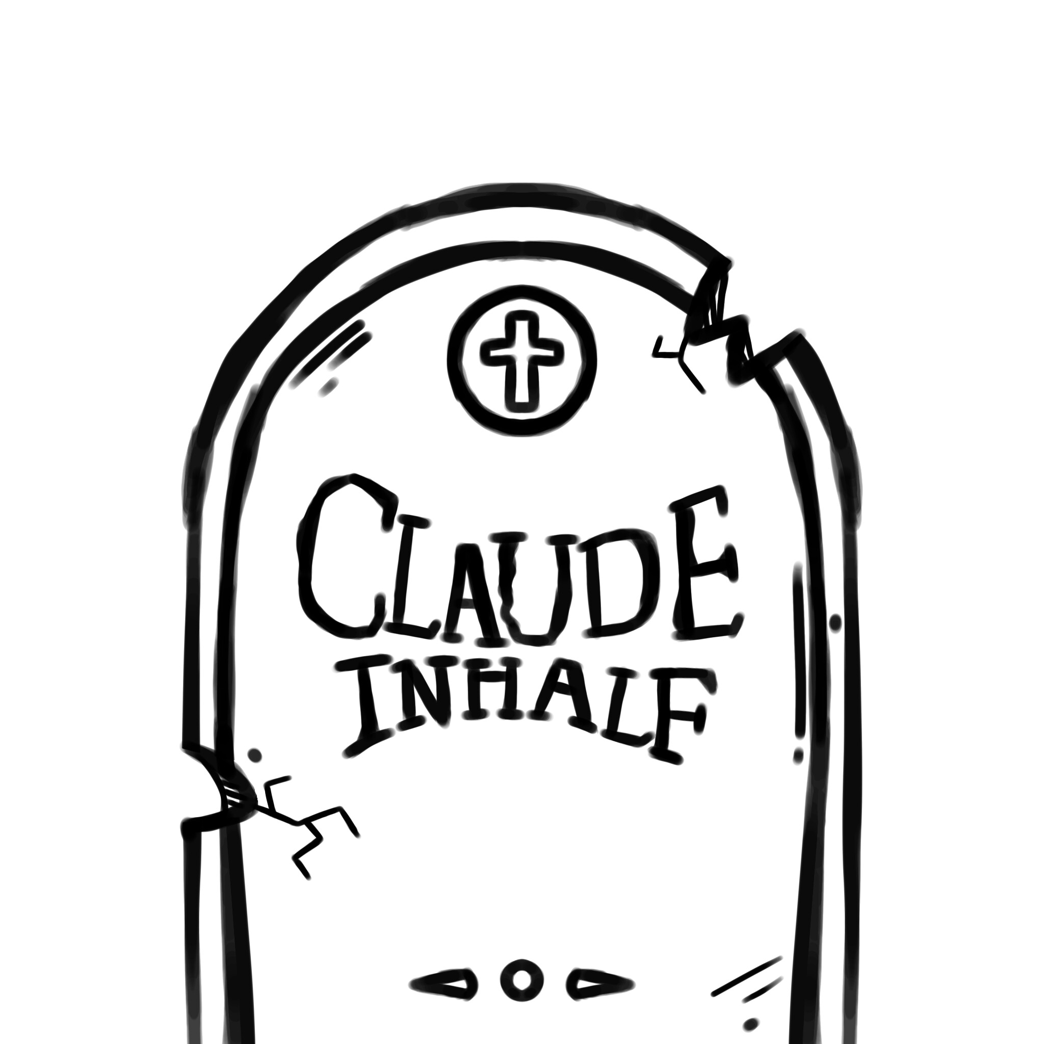

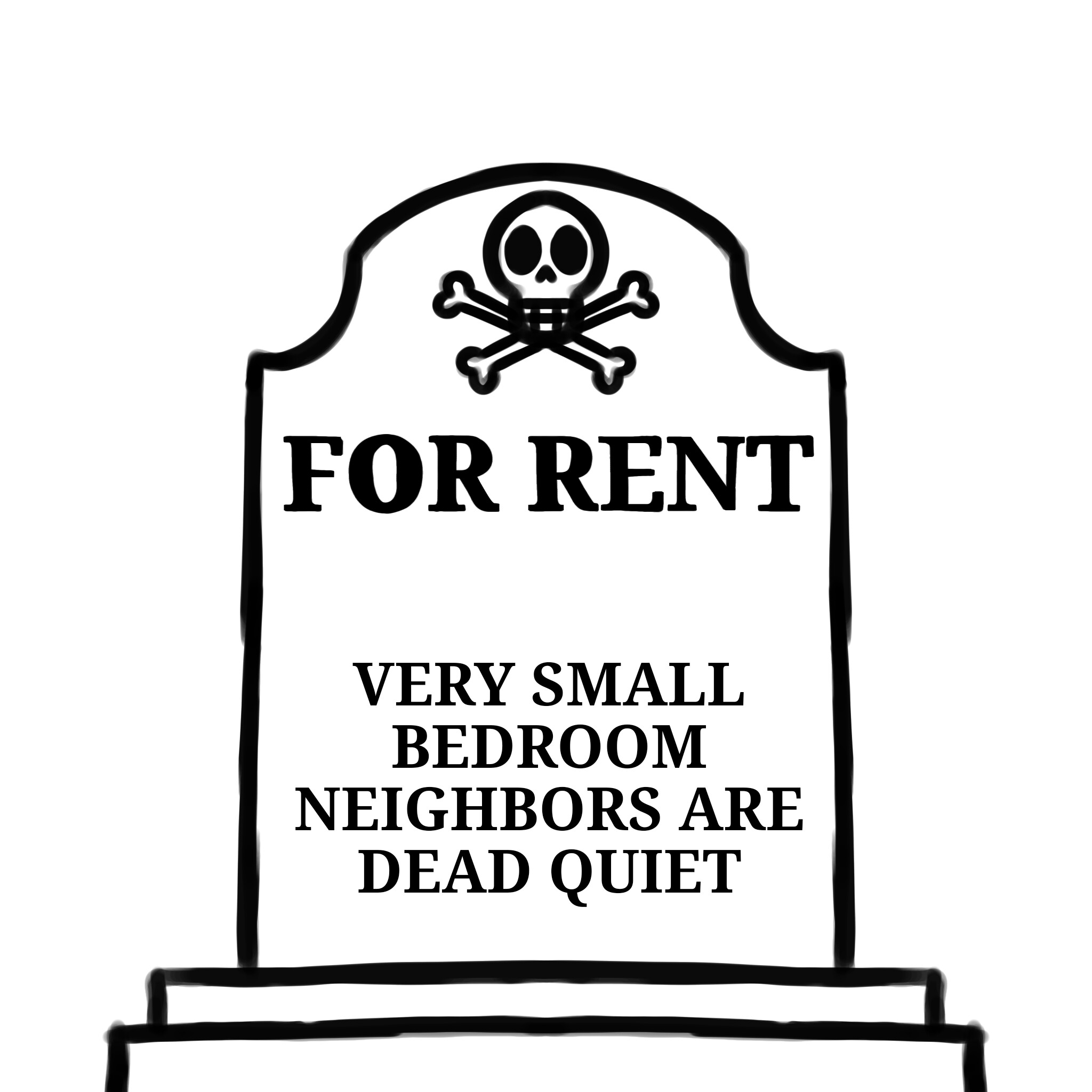

We started by tapping my daughter to design them. She’s really artistic and we wanted to get her involved. She came up with some nice designs…but they were bitmap - she’s not very experienced with vector art yet:

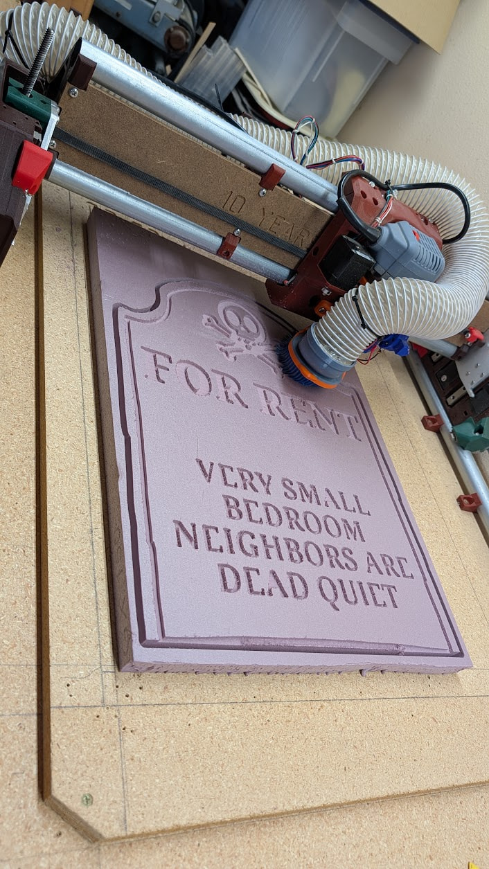

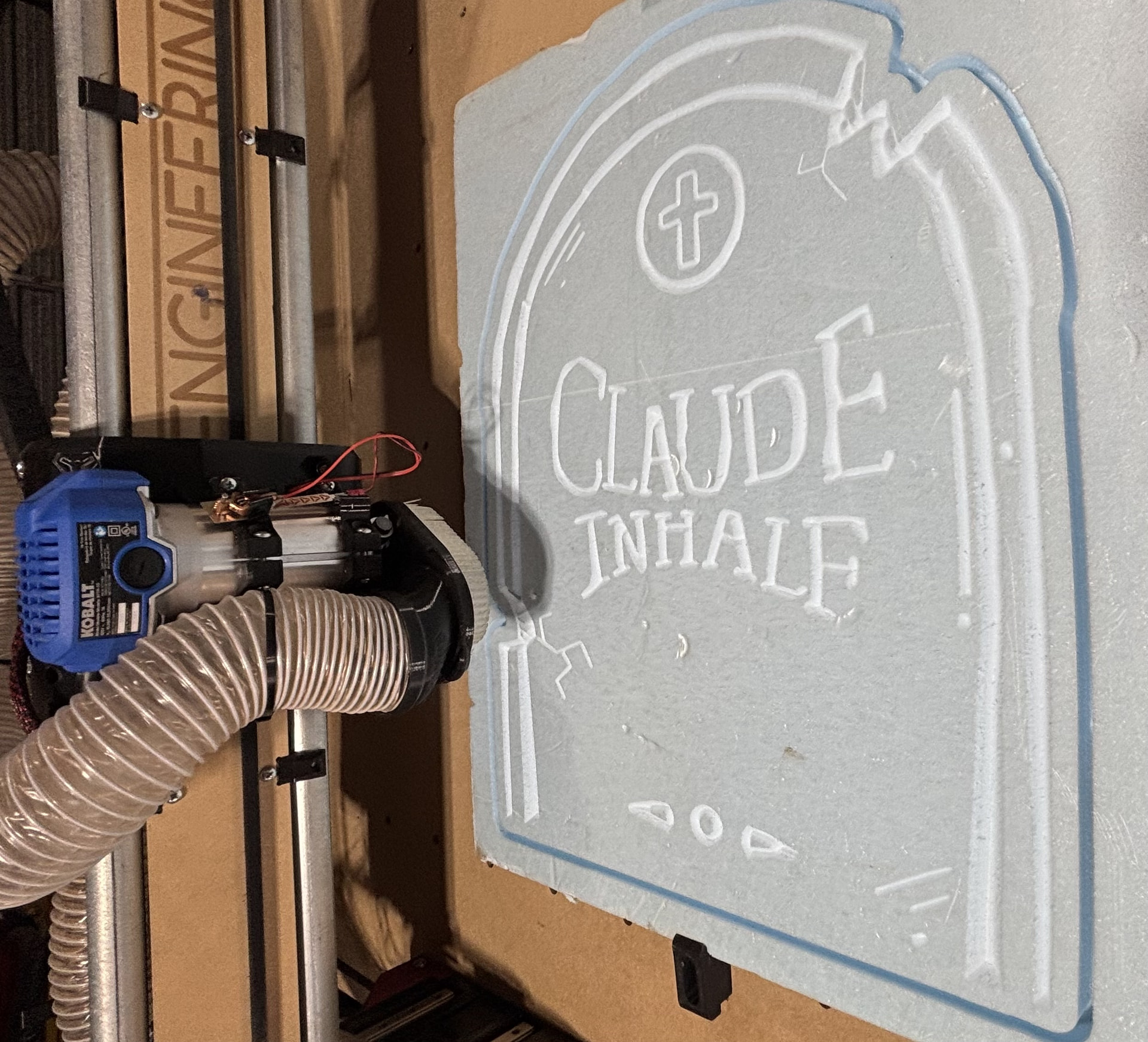

I used a free bitmap to vector tool (don’t remember exactly which one - most didn’t work or gave terrible results or weren’t actually free) and fired up Estlcam.
Got to try a few new things. I had never done pocketing with islands before, and I’ve never done toolchanges - took me a bit to figure out the process for islands but eventually I had previews that looked accurate. So time to dust off the machine and get it going again.

But for artistic foam - I figured it was good enough. These don’t have to be super accurate and foam is really soft and easy to cut.

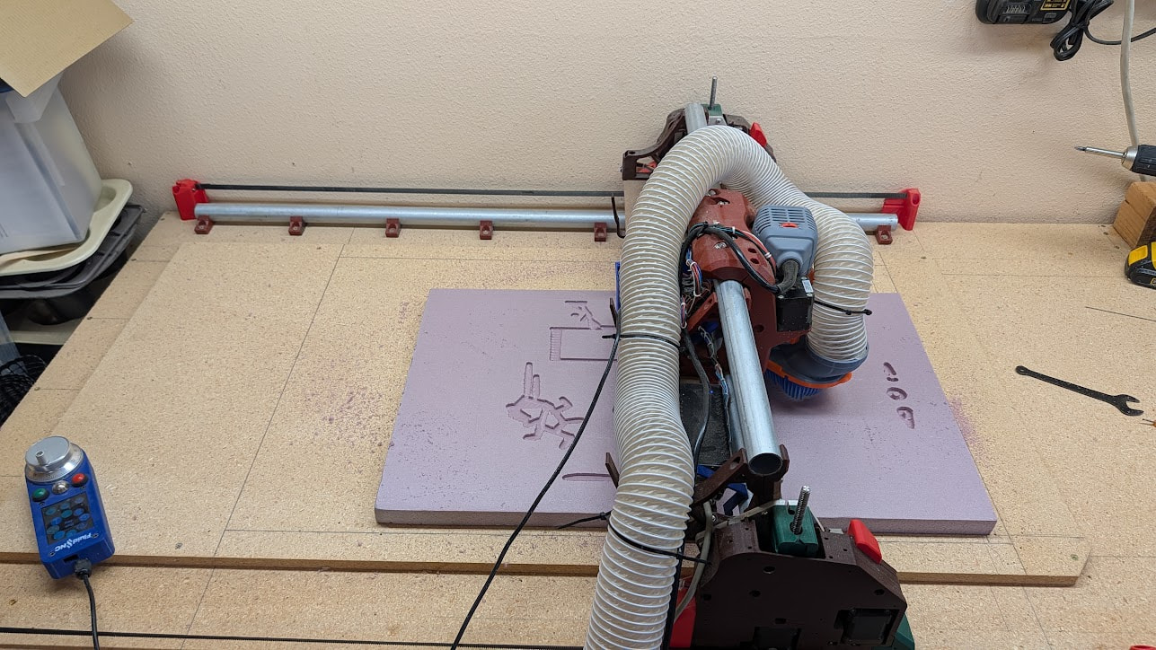

So full send:
First one went well! No issues at all really! Well, ok one issue and it was my own fault I noticed that the vacuum wasn’t getting the “chips” up and my vortex was sitting crooked - and when I tried to make sure the lid on the bucket was tight sawdust went flying everywhere. It was then that I realized I had apparently hooked the hose to the exhaust on my shopvac instead of the inlet. Whoops…that’s a mess I could have lived without :frowning: With the hose moved dust collection was working as expected again.

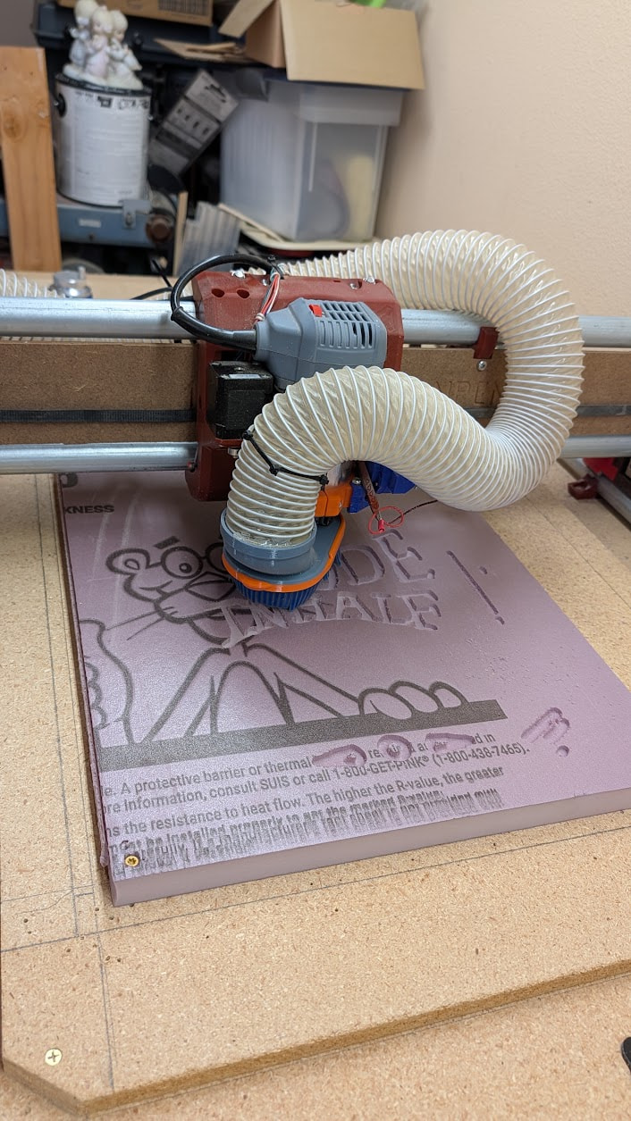

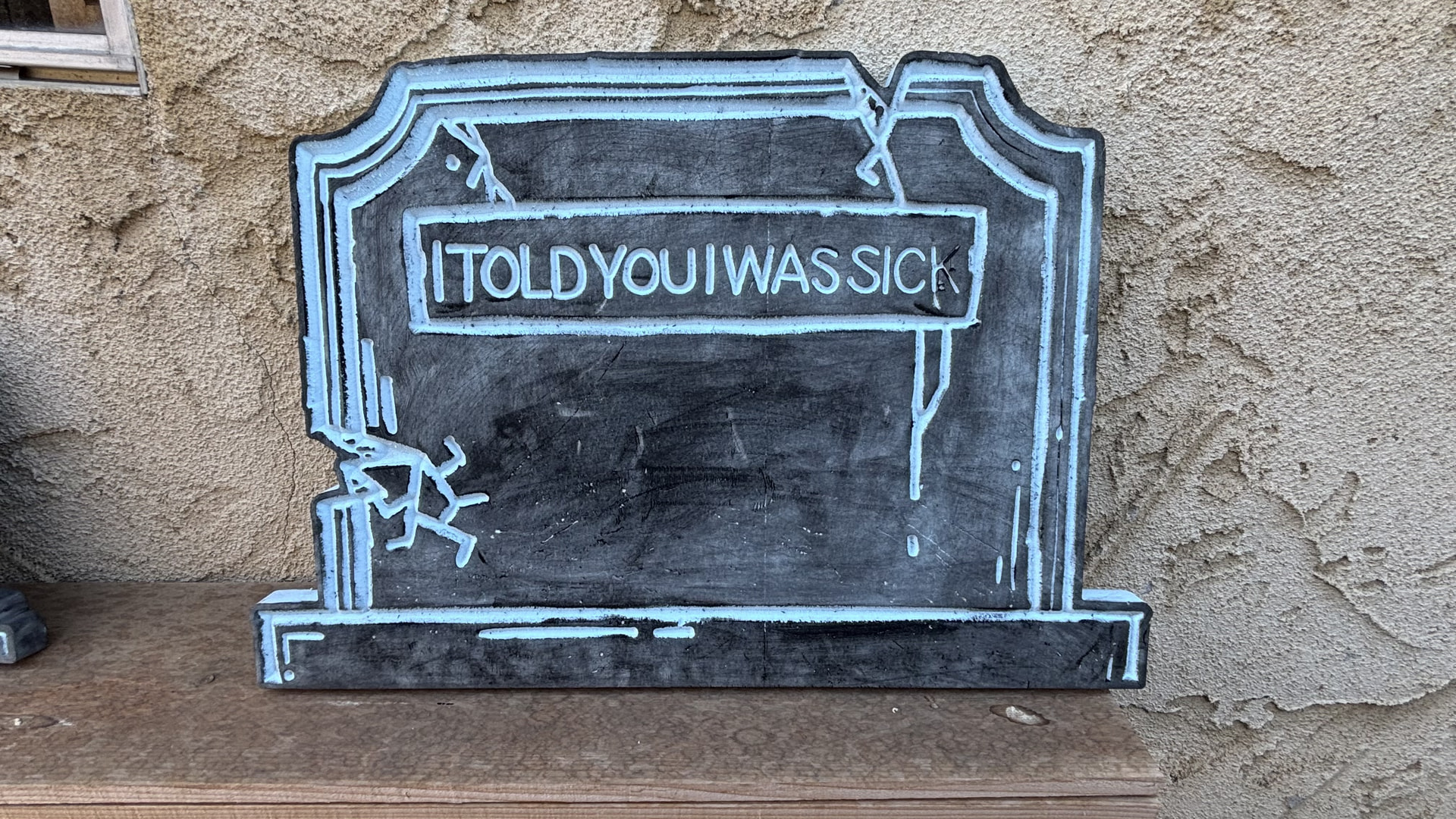

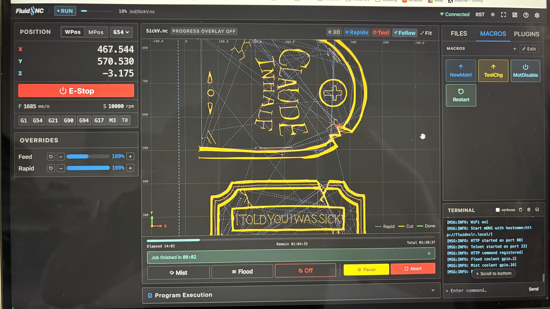

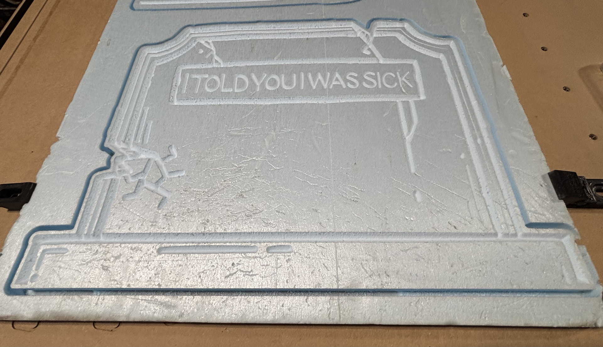

Second one got fancier - I needed to do a tool change between a 1/4" and 1/8" bit since I wanted the larger 1/4" for big areas and needed the 1/8" for the detailed text. I had never done a tool change before but finally felt up to it.
Tool change went smooth as could be! Nice! Not so scared of that now!
And third cut:

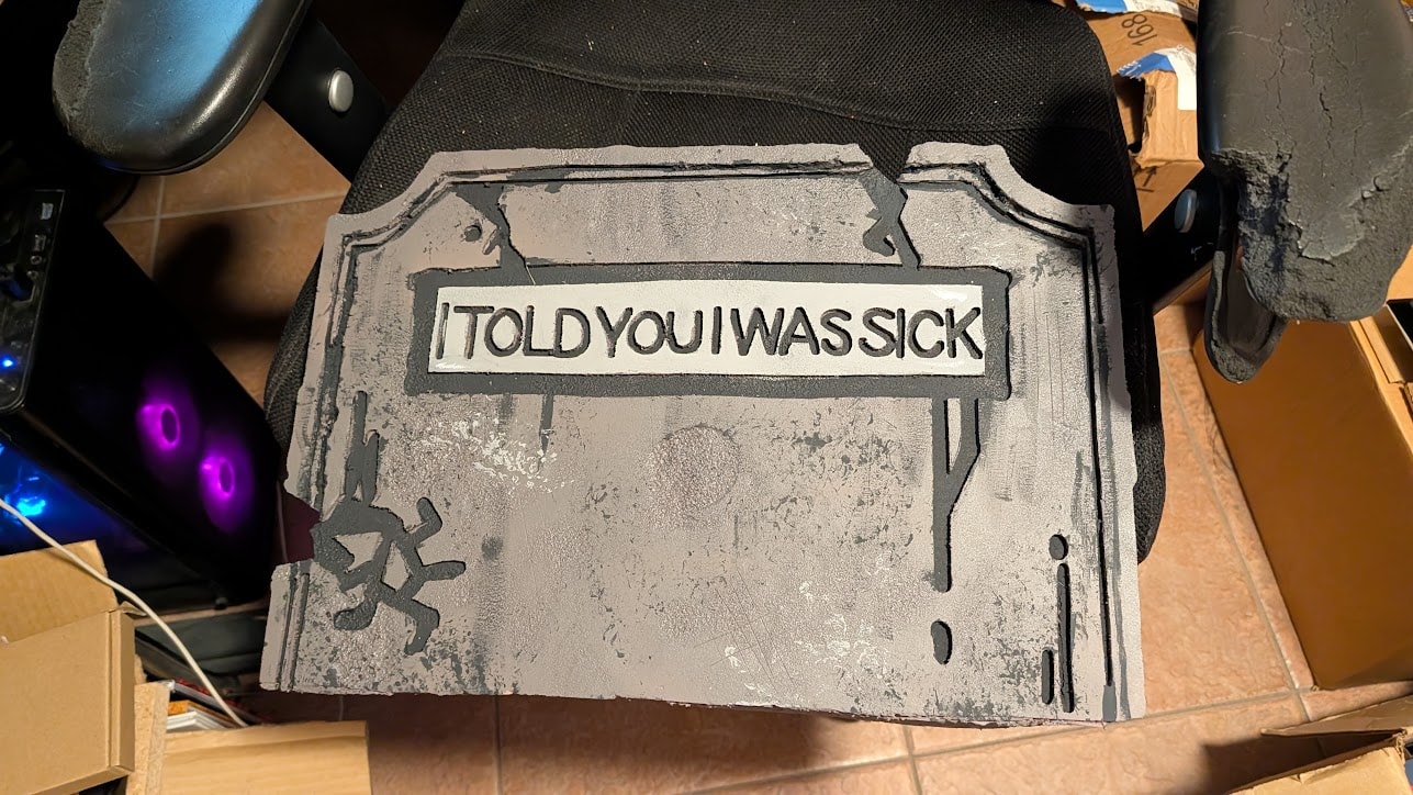

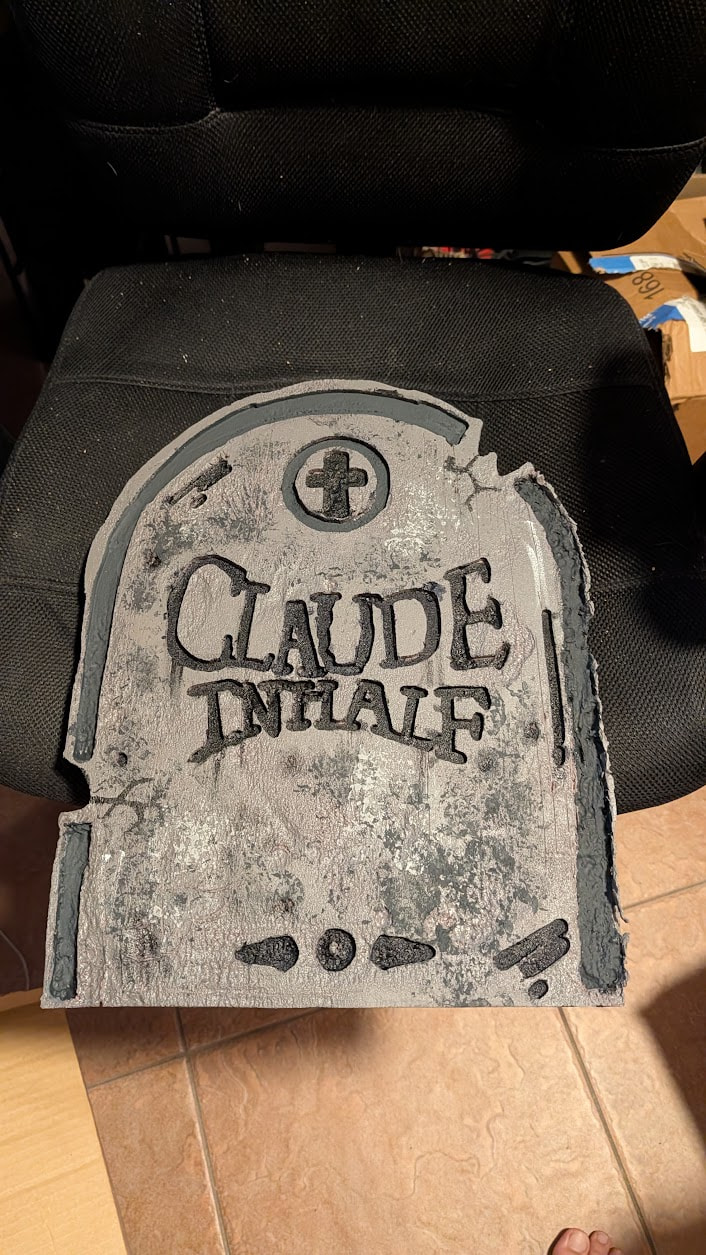

Even the 1/8" bit was too big to cut some of the detail on the text…but my daughter was having fun doing some additional carving with exact knives and working her magic with paint.

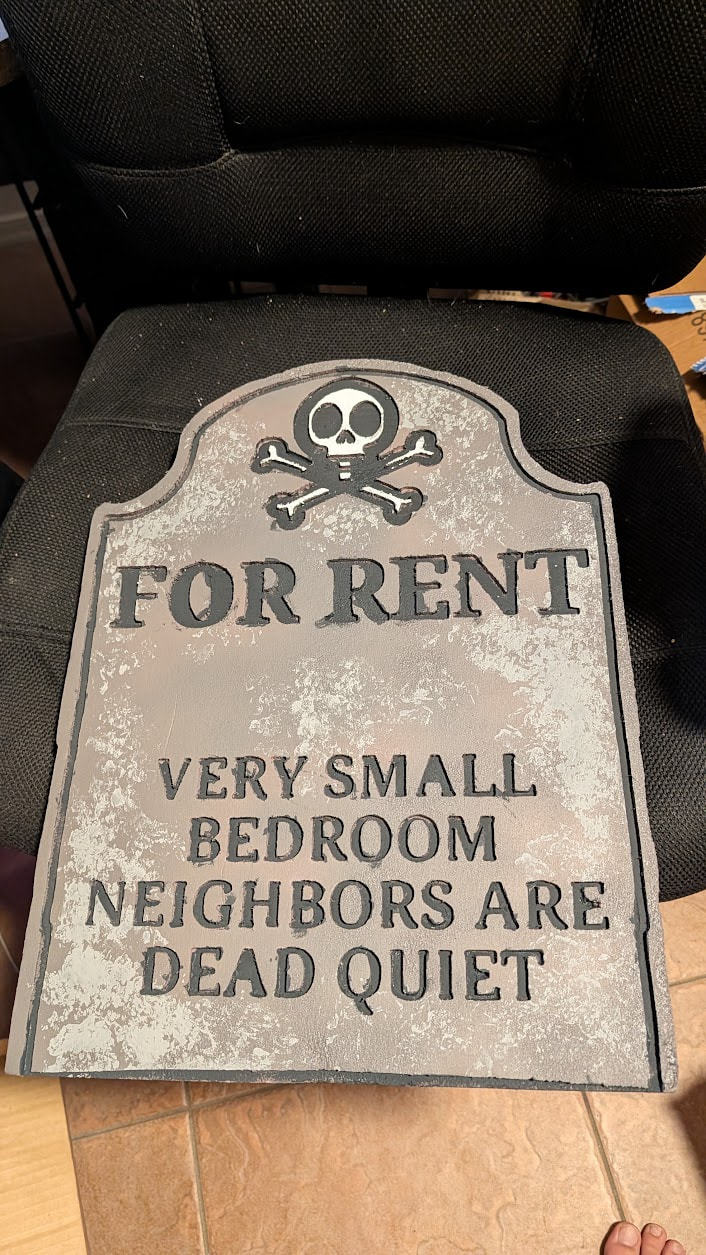

Before she started painting I warned her that spray paint would probably not play very nice with the foam…but she used that to her advantage to make them look even better.
End result once she was done painting them:
We’re still going to add some more foam on the bottom as bases and the next 3 she designed are far more complex and 3D so they’ll be a lot of fun if we find time to make them the next few weeks.
But just these 3 are so much better than the ones from the stores - they’re bigger I used less than 1/3rd of a 4x8 sheet of foam which cost less than buying 3 of these at a store would have cost.

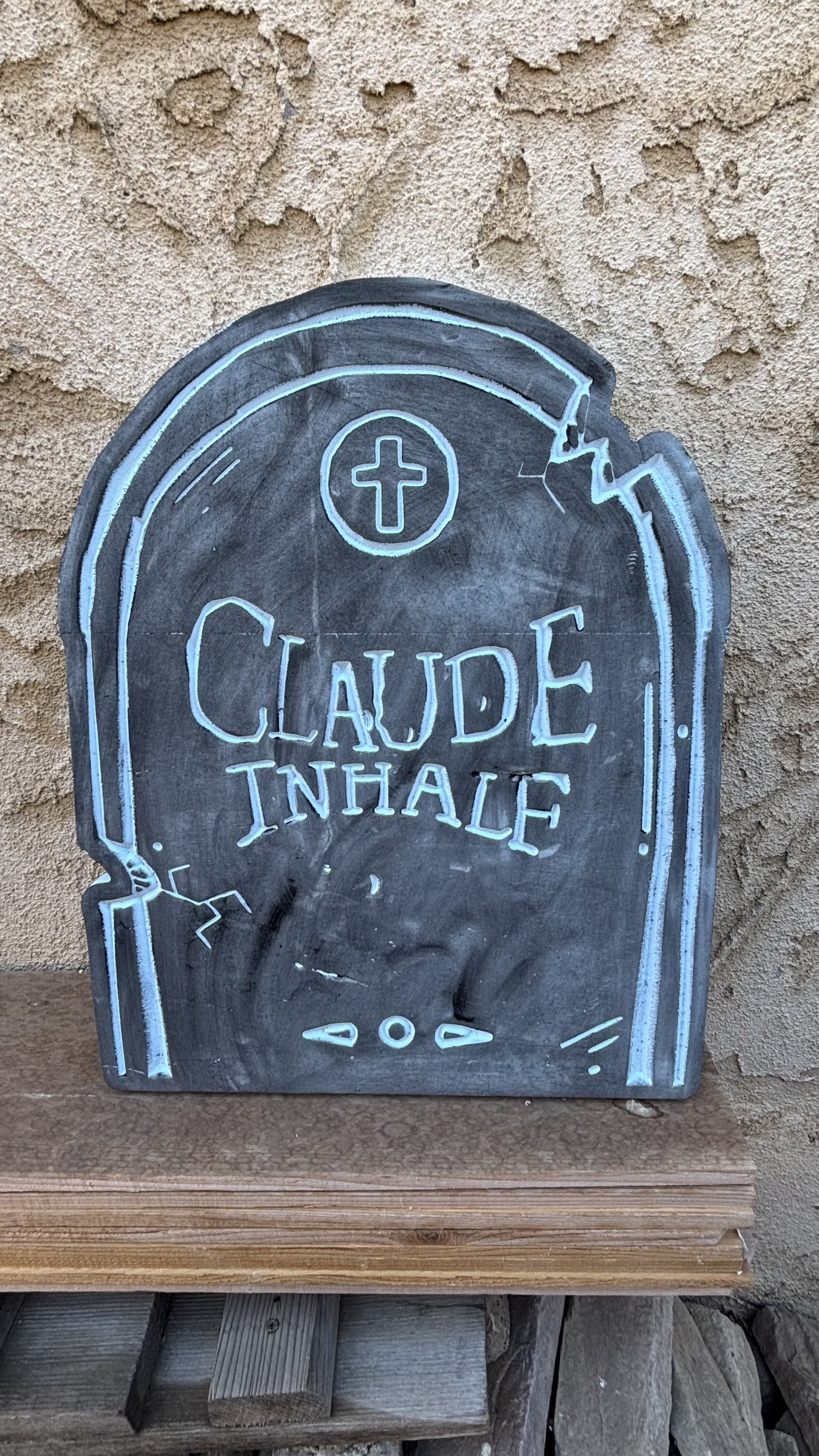

And all painted and in the yard:

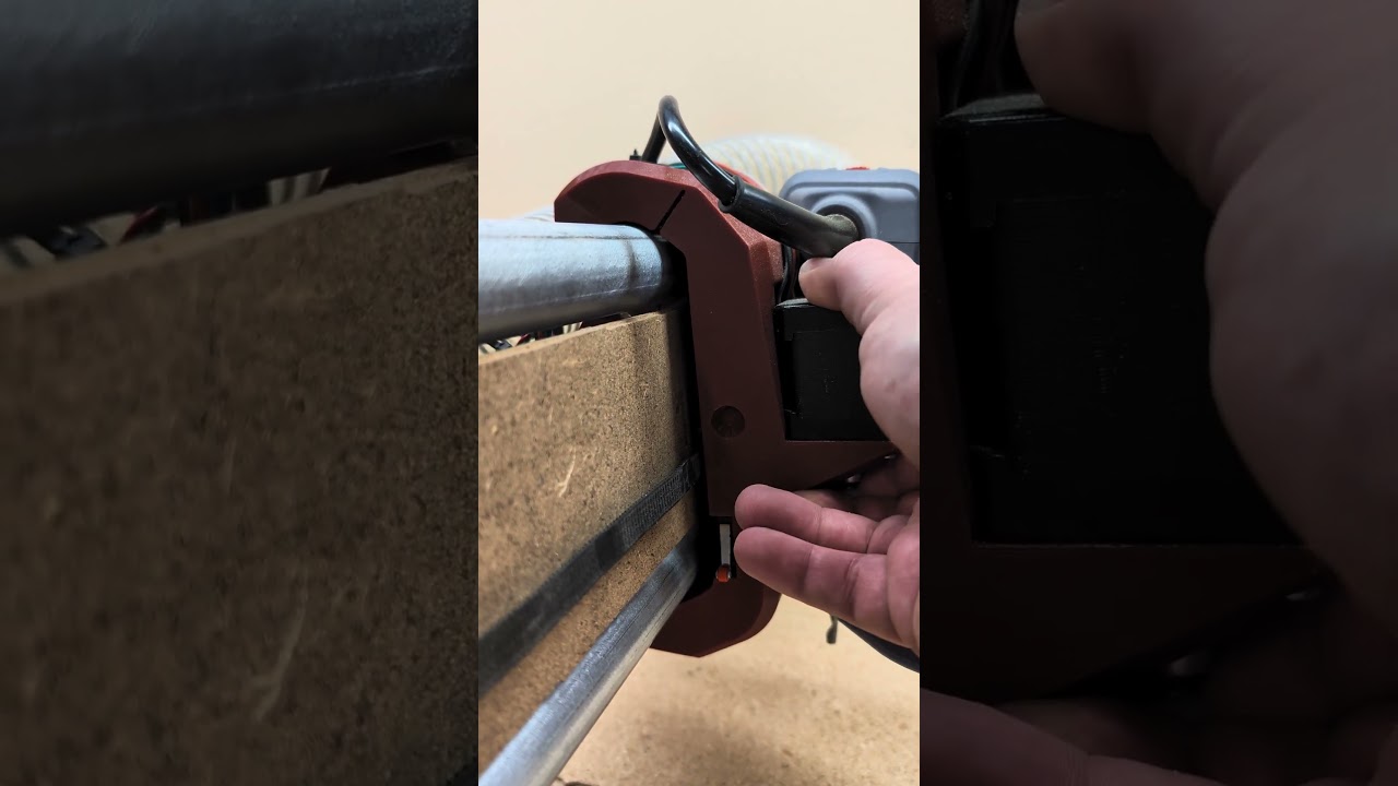

And that worked - but…cutting the wrist/lower chainsaw piece the power cord for my router got snagged and caused it to miss some steps :frowning: I didn’t know WHY it missed steps so when I went to cut the next piece it ALSO missed steps which was when I finally spotted the problem. So the chainsaw has a notch in the tip. The first piece that had flaws I want to recut…but don’t have any big enough pieces of foam left and didn’t feel like going back for another 4x8’ sheet of foam (They also sell 2’x2’ pieces but that wouldn’t have been big enough without adding yet another cut which I didn’t want to do either.

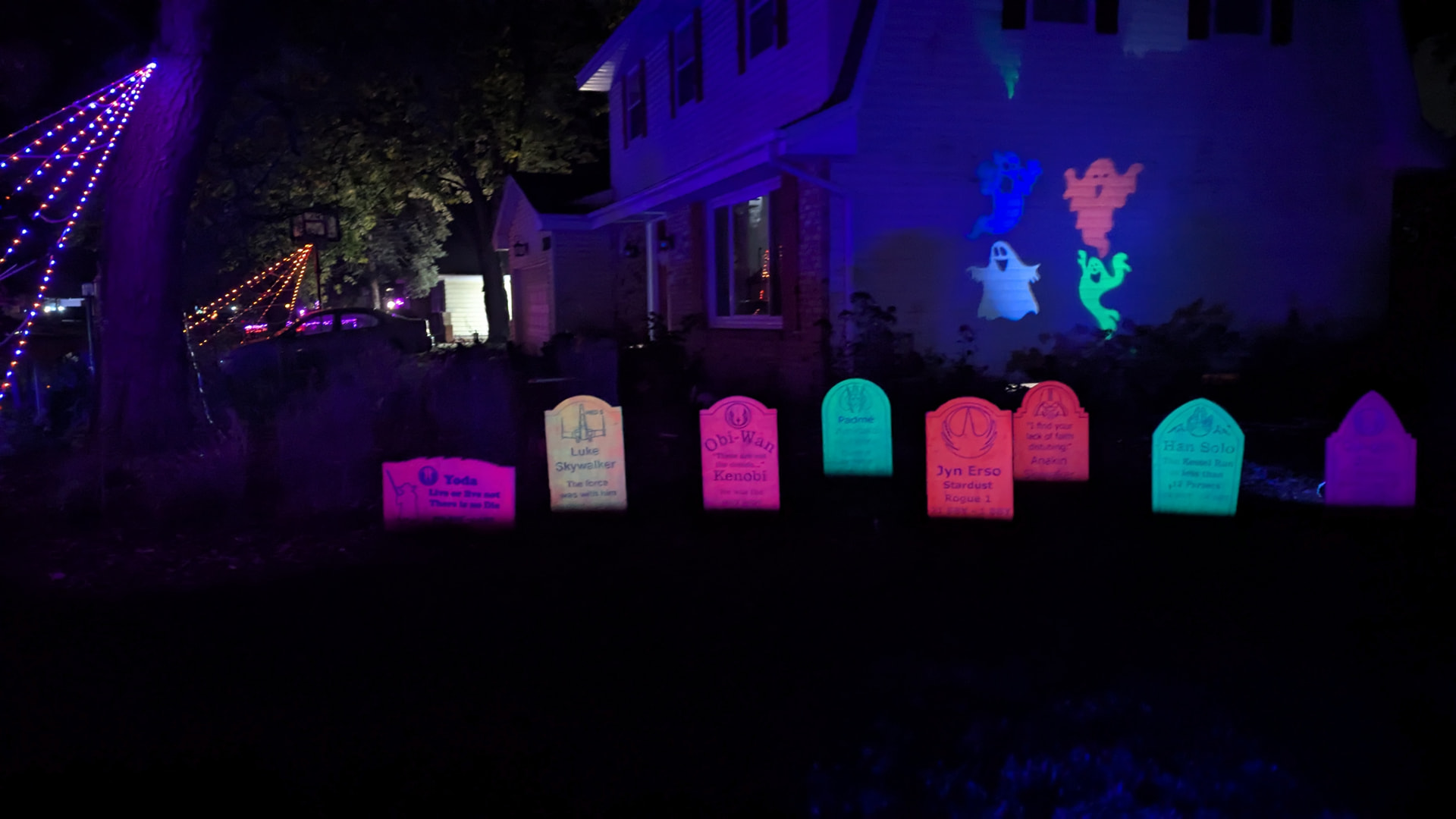

I paint my stones with fluorescent paint and put uv lights on so they pop at night…

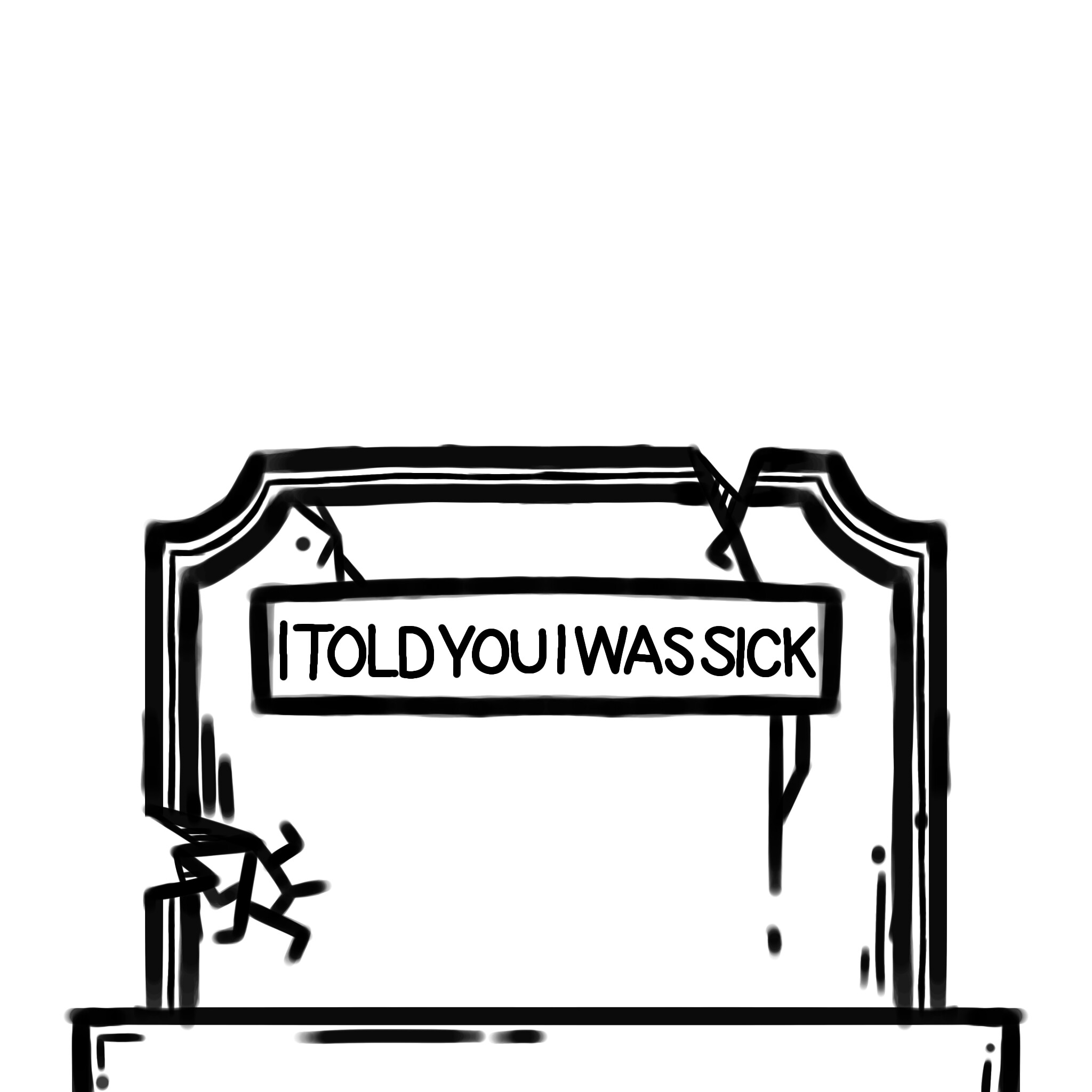

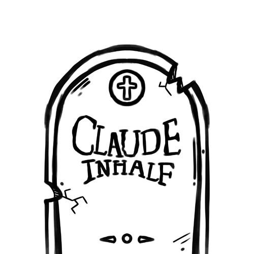

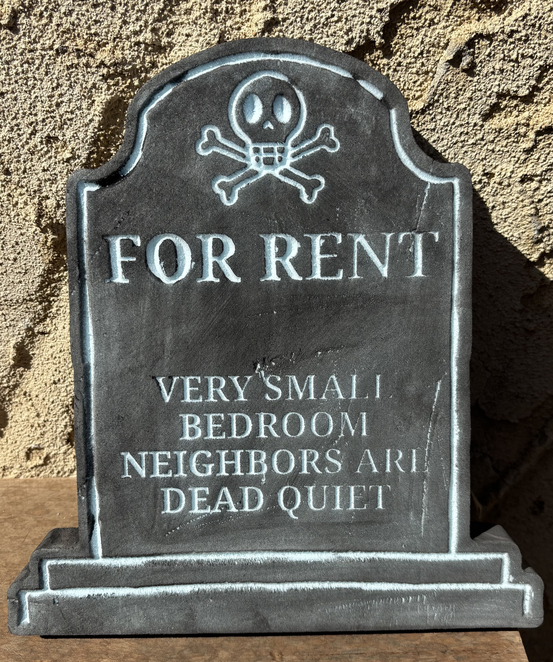

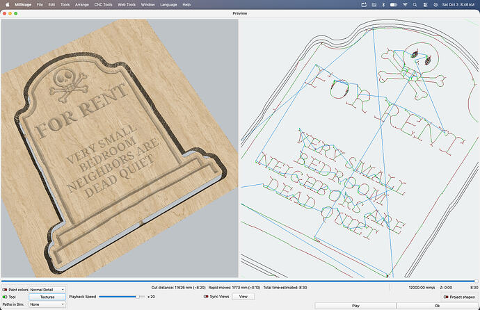

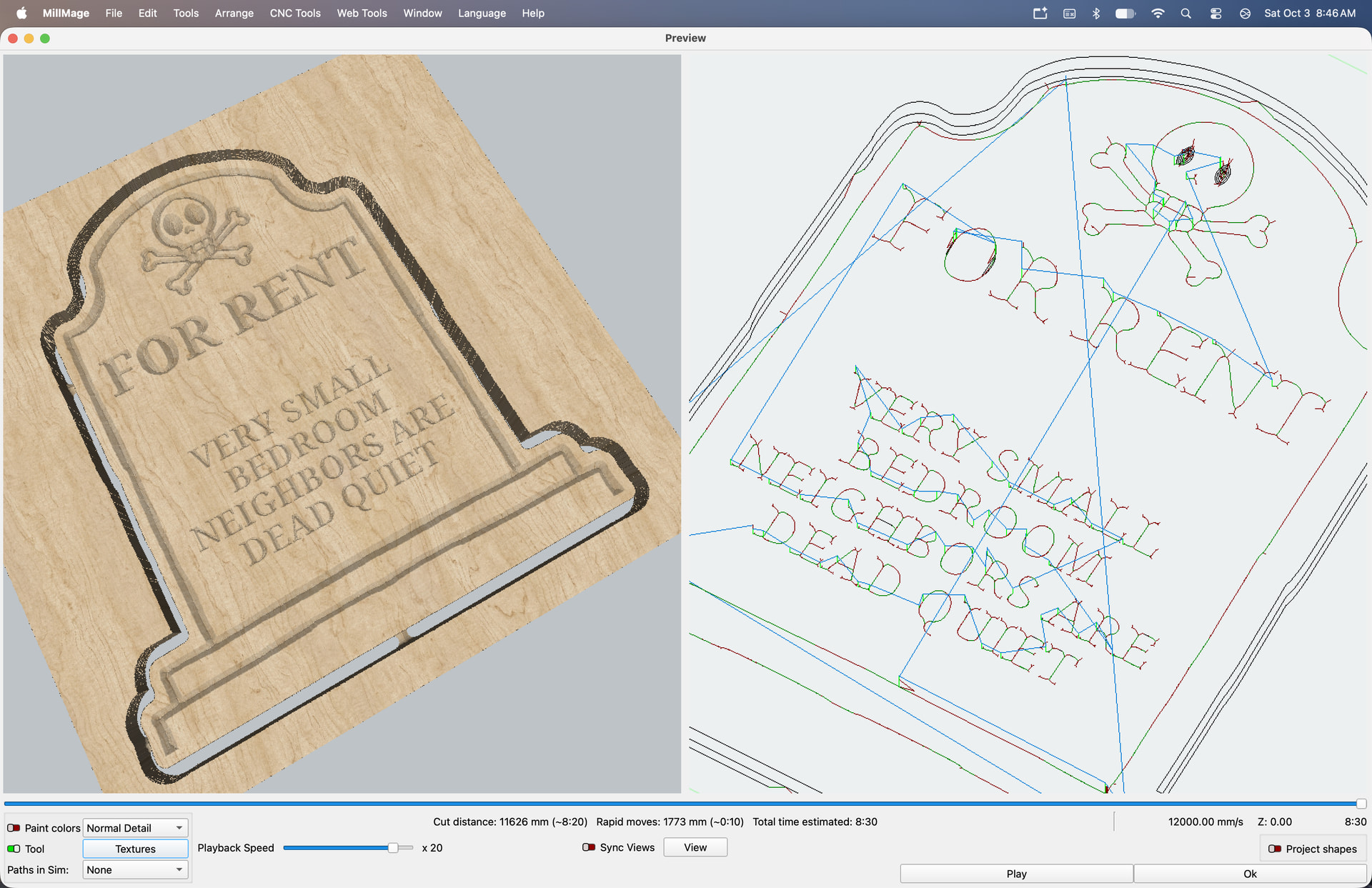

Thank you for sharing these @jhitesma. I cut out 3 of them today. Would you mind sharing the black and white graphic of the other 3? I used MillMage to convert the black and white to a vector image. I applied a V-carve to the image and did a profile with an 8mm offset to cut them out.
I didn’t even stop to think anyone else may want to make their own :smiley:
Here’s a google drive link with all of the original PNG’s, the SVG’s I generated from them, the gcode I used, and for the last 3 the Estlcam project files as well (Apparently I didn’t save project files for the first 3)
I really wanted to dig into MillMage this weekend - my demo is about to run out and I haven’t even finished setting up my machine or tools yet :frowning: I wanted to see how it does at converting to vector (looks like it did better than what I used - or you had finer bits or made the stones large.) And I really wanted to start playing with carving - got some new tapered ball nose bits that showed up Saturday.

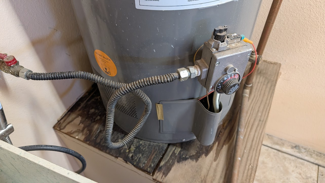

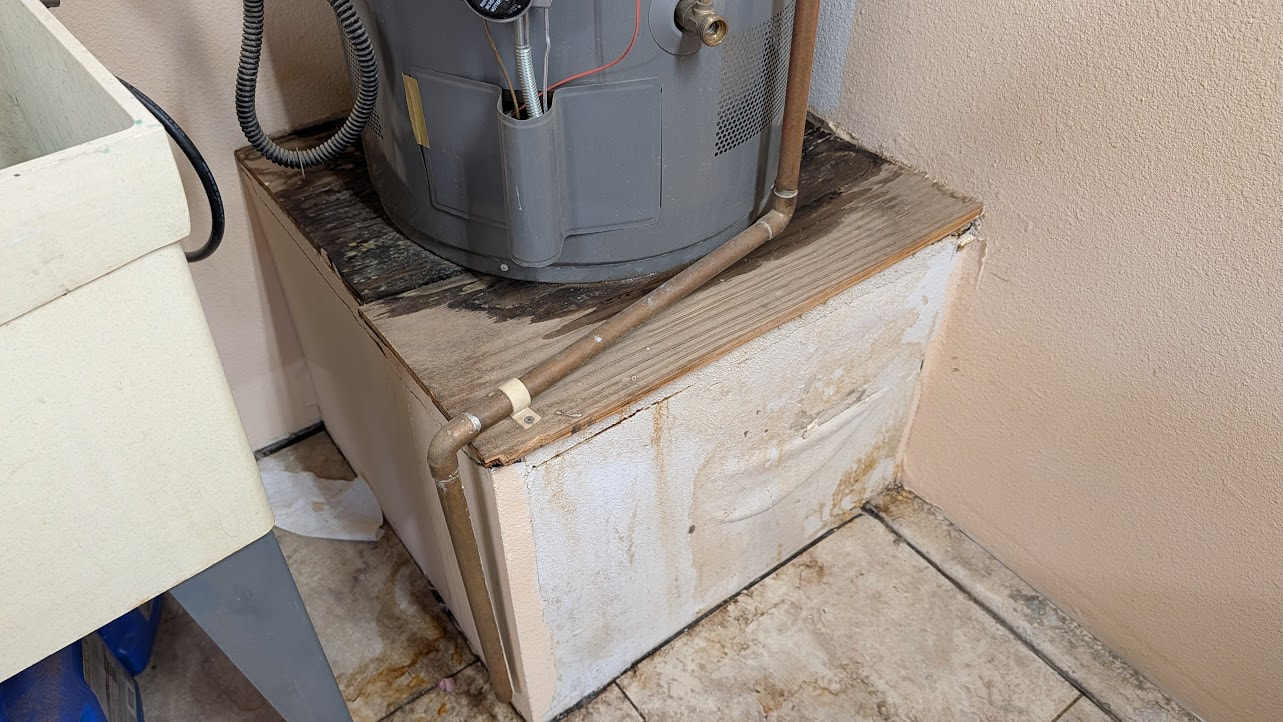

But…my weekend plans got reset Sunday morning when I went in the garage and found a puddle :frowning:Thought my drinking water pump and started leaking again…but no - it traced back to the water heater this time.
I thought it was the expansion valve letting lose some pressure at first but the I saw the base where it sits is wet :frowning:
moved a bunch of stuff and the whole thing was soaked:

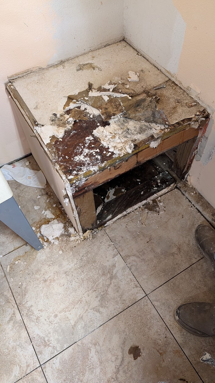

That stand is just 2x4’s with drywall (though it did have 2 layers of 1/2" ply for the top) and every bit of it was totally soaked. My fingers went through the drywall like playdough.
Inside was something far scarier than the tombstones…black mold everywhere and standing water :frowning:
So spent most of the day tearing that out, cleaning, bleaching…and then just switching to a metal stand so this won’t happen again. But ate almost my whole day not only did I not get time to play with my Low Rider…the table for it is now completely covered with a bunch of stuff I had to move to get access to the water heater. Tonight I get to try and re-assemble the garage. Maybe next weekend I’ll have some time to try MillMage…though I’ll probably have to just buy it now since my demo window is almost certainly about to close…not a big deal as I’ve been planning on it anyway. Just may take a little longer after having to buy my second water heater this summer (had to replace the one in my rental property last month!)

MillMage does a really good job of tracing and the node editor is very good also. A lot more like Illustrator than InkScape. The Rent tombstone is 10in x 10in. The Claude and Sick tombstones are 23in x 17in. I used a 1/4" 90° vbit. It was a lot of fun cutting them out in foam and being able to use much higher feedrates. You can extend the trial period on MillMage once I believe. You should try tracing them and see what you think.

Yeah, i’ve been looking forward to trying it out. I just had a 1/4" endmill and a 3mm end mill for mine so the detail was a bit limited. I have the 45degree v bit Ryan sells in the store but haven’t set it up in estlcam yet - keep forgetting I have it :smiley: Foam is fun running so fast :smiley:
