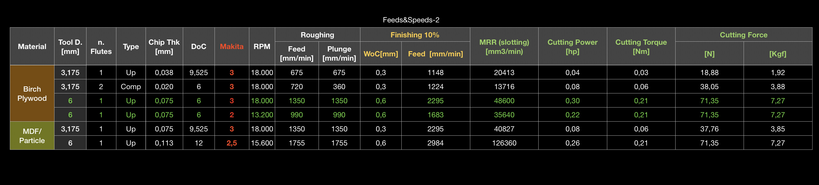

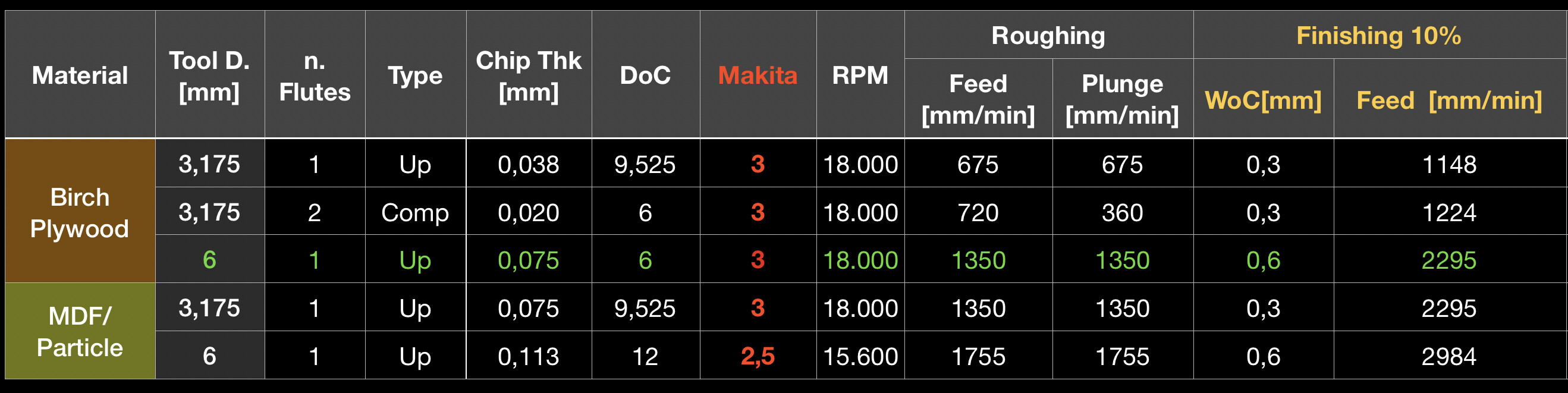

These are my F&S parameter, as You can see I highlighted in green two rows, same tool, same chipload, different rpm. The difference is only about MRR and Cutting Power. The Cutting Force is the same.
My conclusion is that my LR3 can handle about 8Kgf without skipping steps or chatter.
So, after found the best Chipload, I try to adjust other parameters to reach the maximum Cutting Force the machine can handle, and after that I aim to increase the Cutting Power to make the most of router power.
I figured out that reducing too much the rpm cause a longer machining time without other noticeable benefit.
RPM must be as high as possible, until the feed value becomes limiting for the stepper torque.
