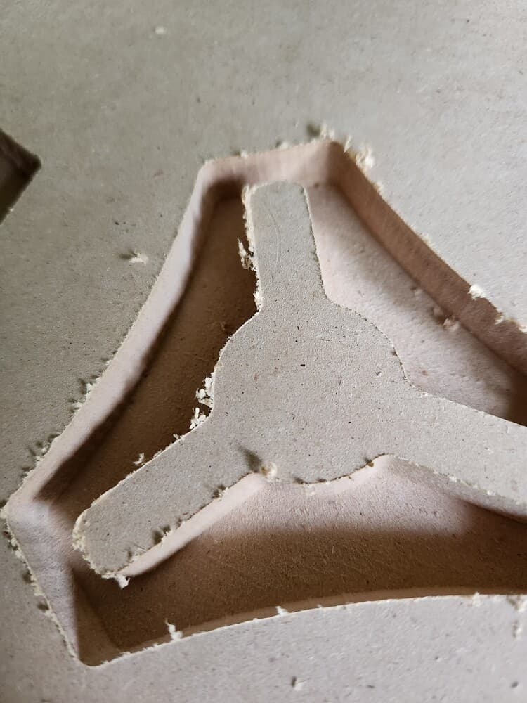

I built a fairly standard Primo. The machinable area is ~22" x 16". I started with a SKR board with TFT and recently upgraded to the Jackpot. I have a Makita router.

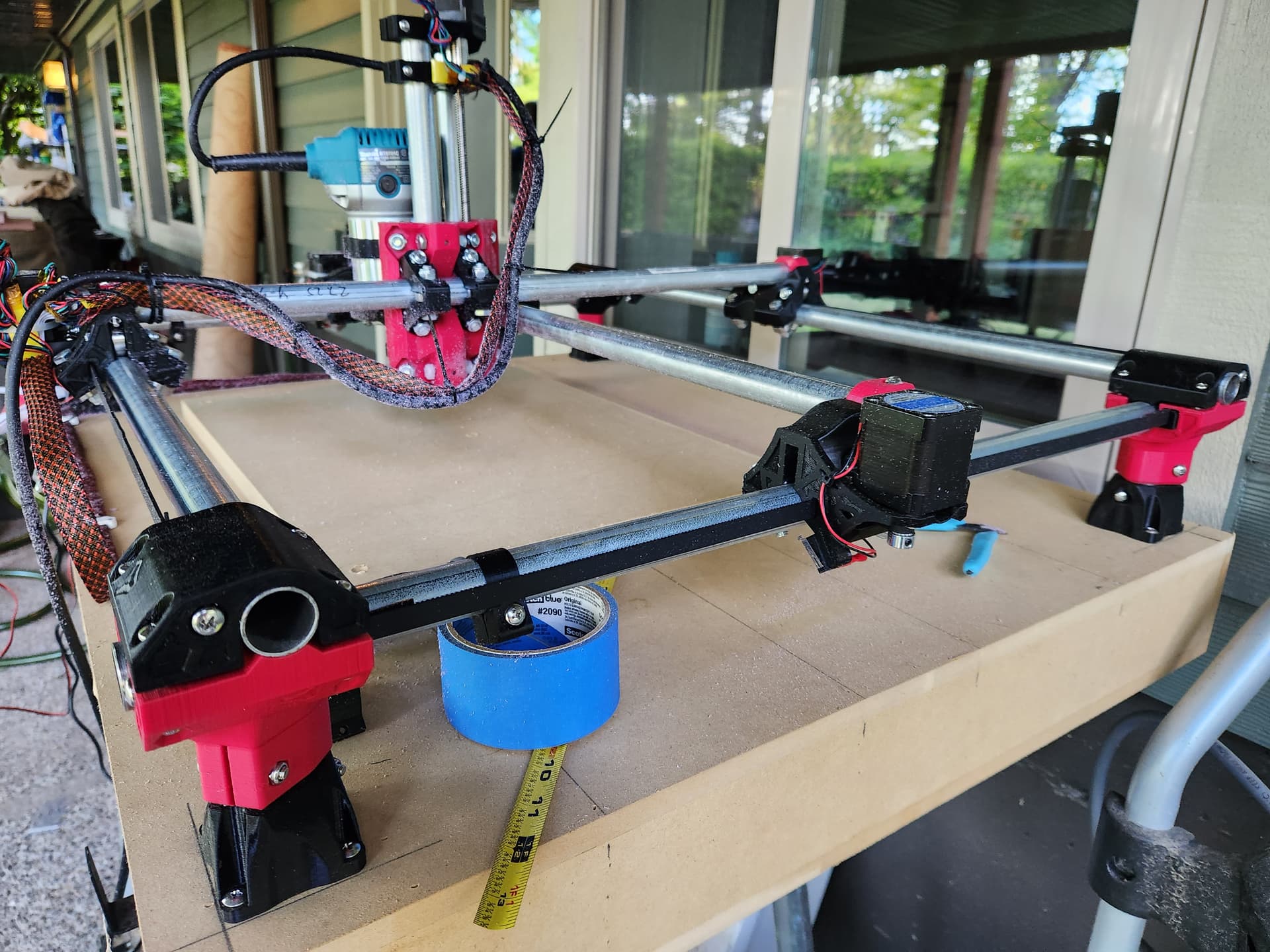

The legs seem pretty high to me on first glance.
Here is a different view
Yeah, waaa-aaay too tall, Papa Smurf… :roll_eyes:
Legs? You mean on the z axis? I thought you meant the corners, but I am not sure you can make those any lower.
He’s messing with you, first pic looked tall, it’s not. It looks good.
Technically, I’m messing with Philipp, but yeah, the legs are fine.

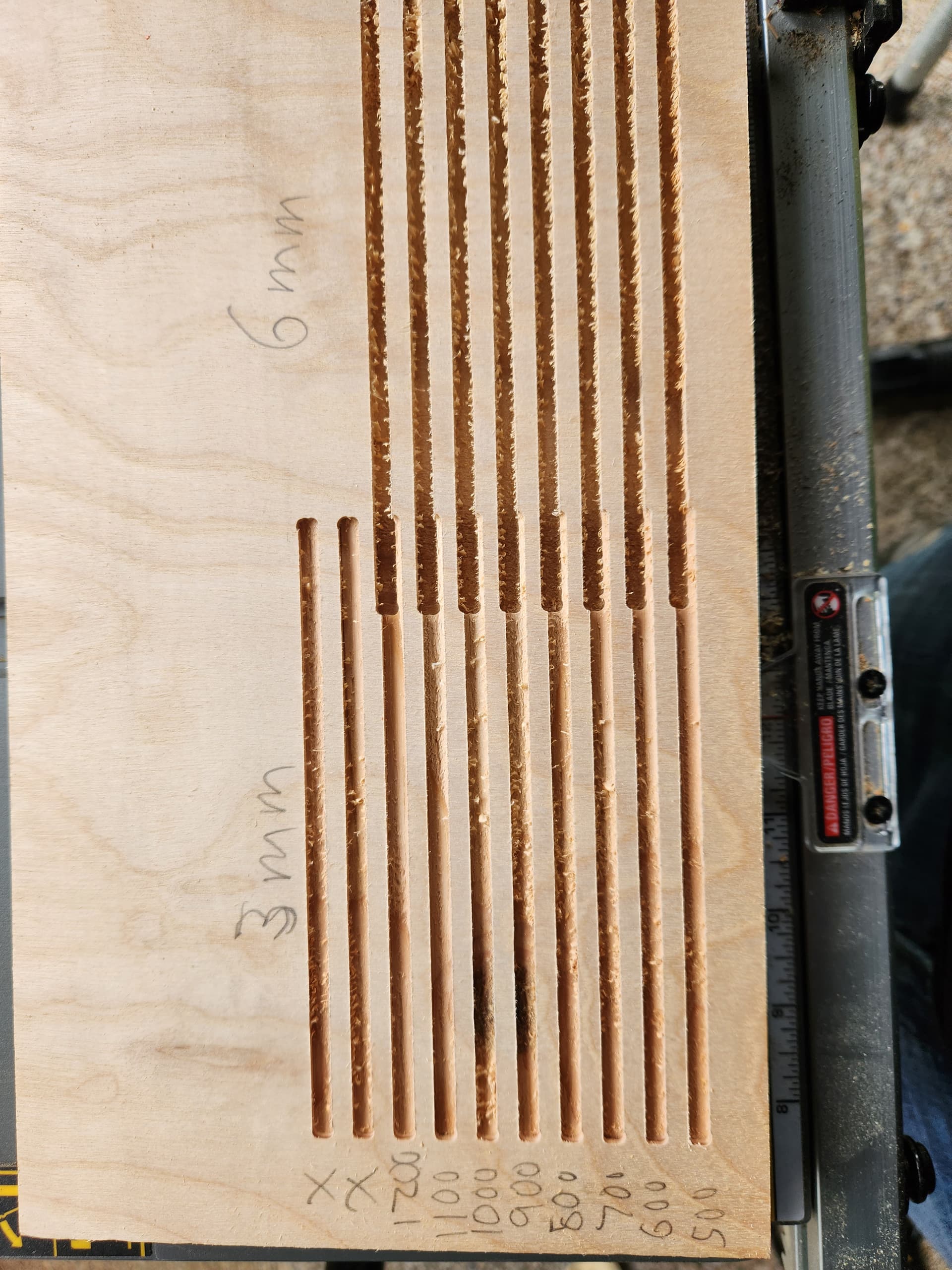

Here is the first test. 3mm and 6mm doc at 500 to 1200 mm/min.

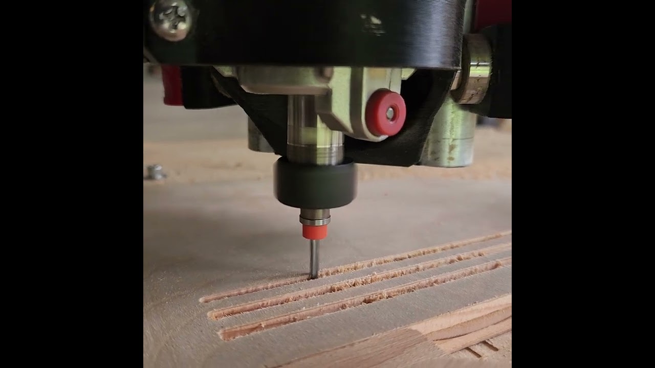

Here is the 3mm doc video.
And 6mm doc. I didn’t pay attention to the vector order, so it starts with 1200 and goes down from there.
Change your settings to climb milling. That sounds horrible with conventional?
Something is very wrong there. Is that a collet insert? You need a real 1/8" collet. Either that or your build is super loose.

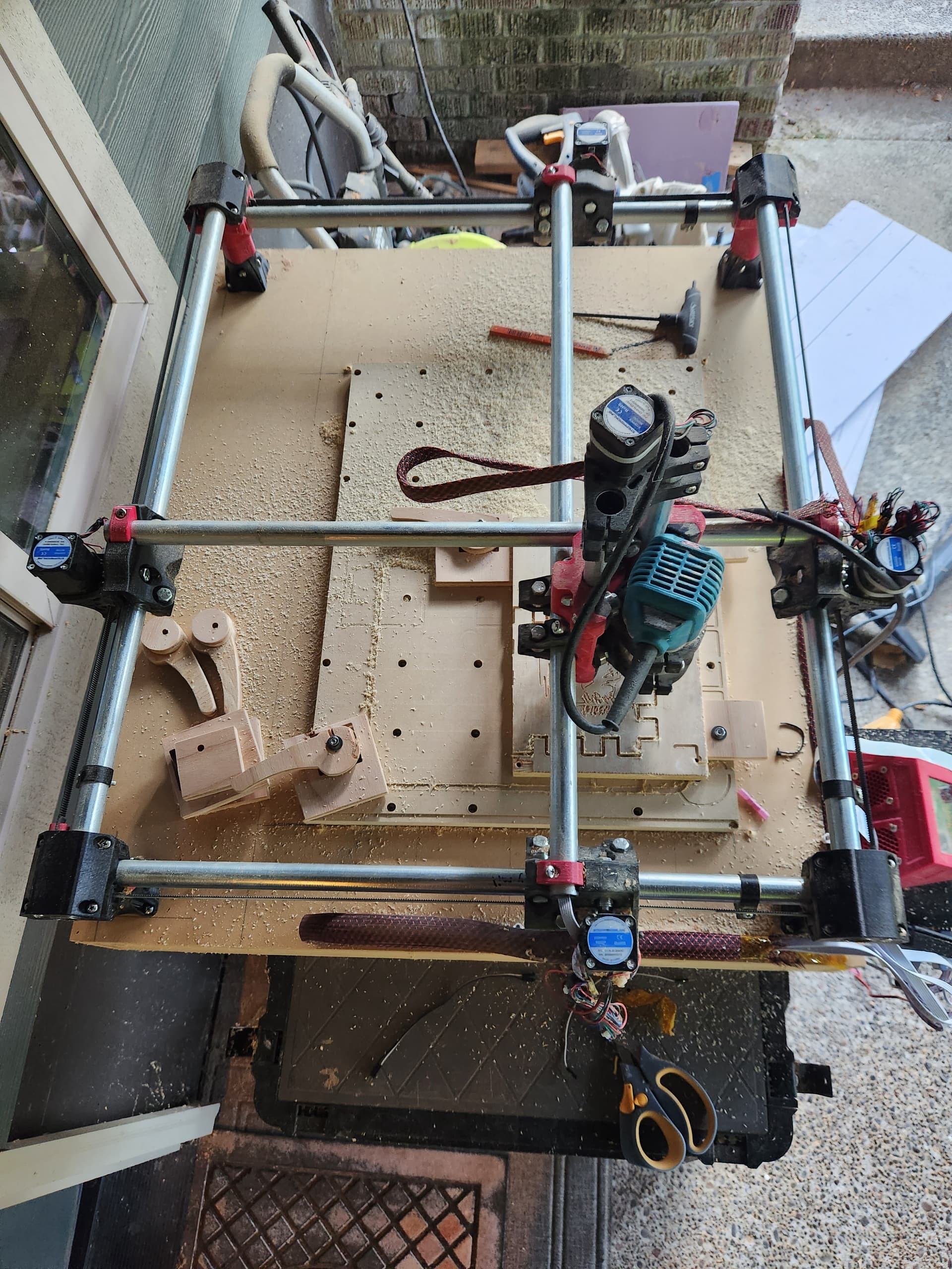

That sounds awful. Can you upload a picture of your entire build please.
Here is my build log. The only change I have made since then is to move to the Jackpot board. The Jackpot made the stepper movements quieter, but not the cutting.
As in the cutting is the same noise or worse?
Looking at your build log did you solve the issue you were having? It looks like you have a stepper that might not be connected properly. That would explain why it is acting like it is super loose.
If you power on the jackpot, can you move any of the XY steppers a little bit?
This should not happen at all. This is a sign of a loose grub screw, a stepper that is not running properly (at all or a bad connection), or a gantry that is very loose.
That was the cut before I tightened the belts and upped the current. This is the last one.
