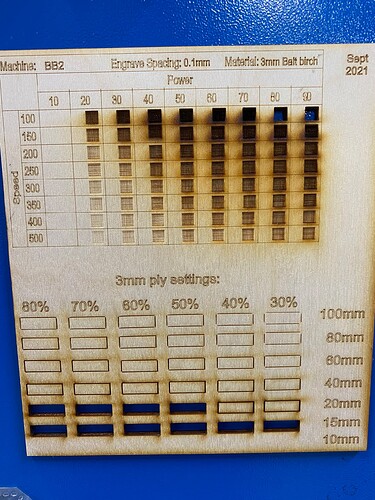

I’m curious why no one has made a gcode or even just a drawling to run tests
There has to be a reason I don’t understand - I’ve contemplated something like a standard laster test board. Maybe there are too many variables and a wide range of “right” answers so it’s overkill?
I was thinking the same thing. It seems pretty basic from all the videos and articles I’ve read so far. Not much different than really any part of 3d printing or woodworking (minus the fact that the wood/tool is fed manually).
I found this which is for a laser module. Can’t imagine it’d be hard to make a file similar that you could assign speeds and DOCs too. The spacing would only need to be as far apart as the bit you were testing

As far as a test file similar to the laser, with the laser test file, if your speeds are too high, you just won’t get a cut or engraving. If you run a test through all different feeds and speeds like that with a LowRider, and you max out at the very low end, the high end could be disastrous.
I think part of the difference is that with the laser, those files are meant to see how the material responds to the machine/settings, where in the LowRider case, you want to know how the machine responds to the material/settings.
When the thing in motion is the thing under test, you want to be a bit more careful and ease into the limits, stop, and pull back a little. The laser test can go well beyond the limits of it being useful on the material and nothing breaks.
The two primary failure modes for the laser test are: nothing really happens (too fast and/or too little power), or the material catches on fire (too slow and/or too much power).
There are multiple failure modes with a router/spindle, including, but not limited to, flying shards of HSS or carbide when the bit breaks, flames when the bit rubs on the material too long, skipped steps, overheated stepper drivers shutting down, etc., etc.
Despite all the science-y, “pew-pew” mystique of lasers, they’re a bit simpler to “dial in” than old school Spinning Blades of Death™, that require a more delicate balance between machine, material, and moron man to get clean, consistent results. It’s an art form as much as anything else.
That makes a bit more sense. But I still think a file similar might work. Maybe like this one but modify it so it’s L-shaped to test x & y axis. You’d have to stand by an emergency button / plug and listen for when the machine struggles vs letting it go full send. But I think it might help beginning user get some closer estimates to their machine limits vs having to put multiple projects at risk while you test the speeds.
Am I wrong in this thought? I think it’s similar to a 3d printer speed test print just more variables to watch. But even for those speed test you are supposed to be present and aware so you don’t ruin the printer
Sure, making a file like that is simple. Anyone can get in CAD and draw 10 lines.
The difference here is the CAM side. For a laser, that’s very simple. For a LowRider, it’s a lot more complex and nothing can generate the right CAM for you. This is what the gist of what I and @kvcummins were saying.
There are more variables than just speed and power like the Lightburn test usually focuses on.
And with a printer, you are still doing the “CAM” part of it yourself, although in a much more automated way with your slicer.
I think the reason the file you talk about doesn’t exist and get shared around, is because creating whatever test file you want with simple lines, etc is much easier to create than what a complex 3D test model is.
Open Inkscape, draw 10 lines, and save. That’s all you need to import it into EstlCAM and start programming your test.
