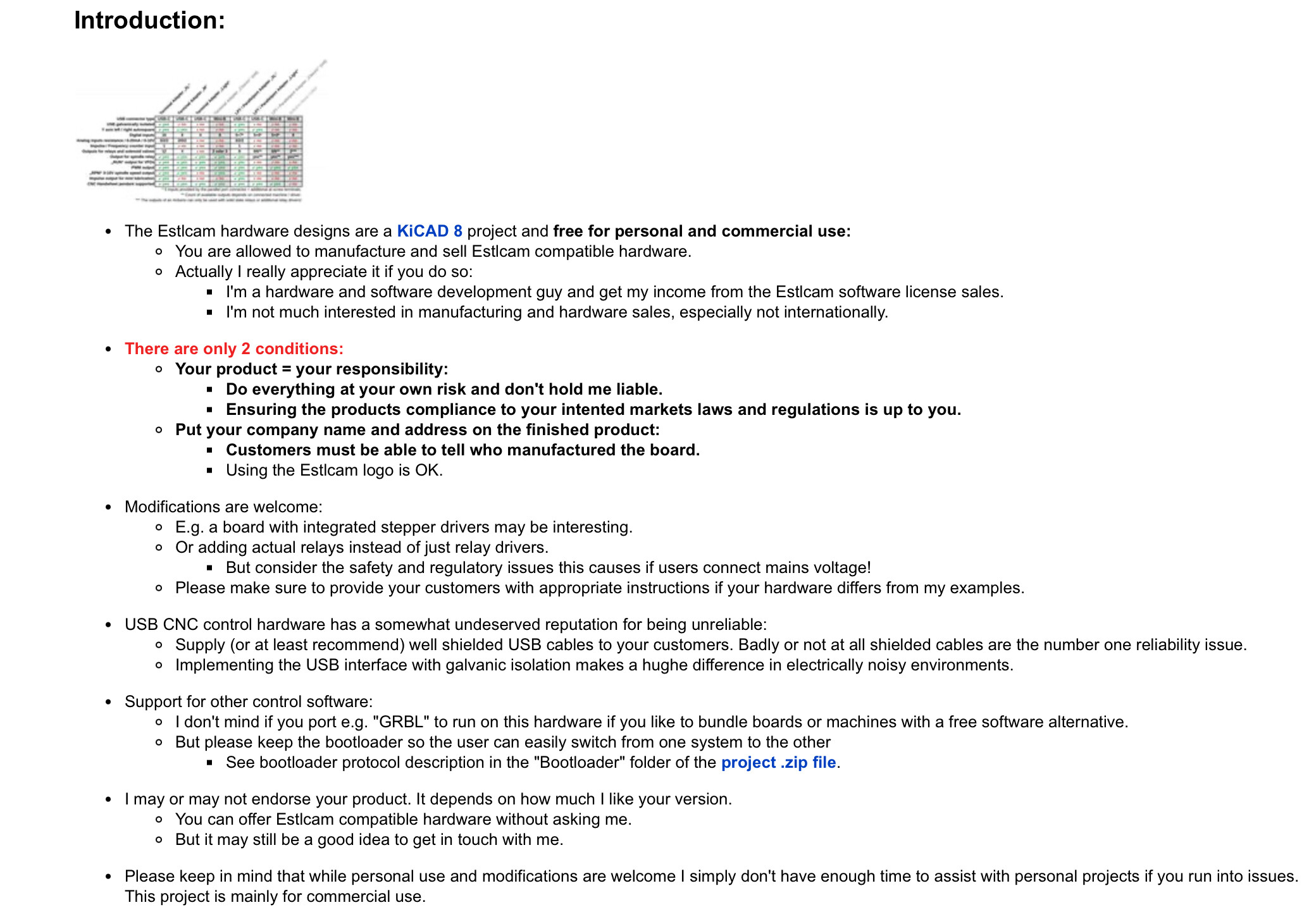

The v1 firmware on the skr is likely marlin and estlcam does not talk to marlin firmware. To get it to work, you would need to get a different binary file for the skr, but according to this post there isnt likely one available:

From the post i referenced, estlcam control firmware appears to be precompiled and works with 8 bit processors while the skr is 32 bit and uses a different processor.

I believe that Estlcam talks to the Arduino Uno style boards with a CNC shield. There may be others, but they are quite limited. Estlcam wants to talk to its own specific firmware. It’s not as flexible as Marlin to run on dozens of different platforms. I have no doubt that it’s capable in its sandbox, but I’ve never had a machine based on a board that Estlcam can control.
