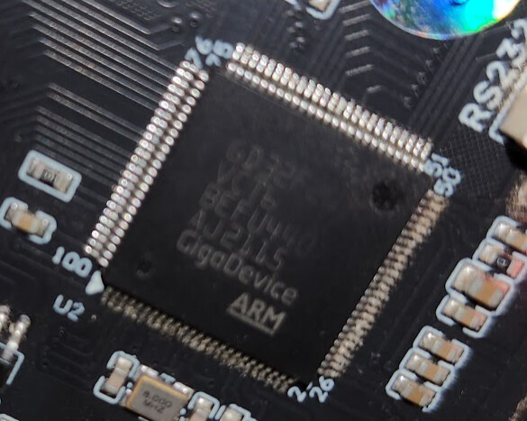

I asked so I could see what chip is on there. Some are a GD, most are not. Some firmware says GD even though it is not a GD.
It does say GD on it…Hmm. Try this one…try to trick it.

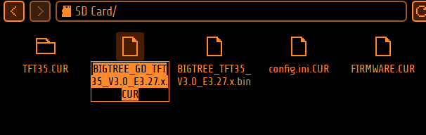

Kitchen towel.zip (2.4 MB)
Those pins still look mighty funky, do you have compressed air or an old toothbrush you can clean them off with. They could be doing something odd.
Same issue for reflashing all files, but they did all rename this time.
Any possibility that the drivers could have been toasted or are their firmware on the main board?
Odd you do have a GD version and it did flash this time.

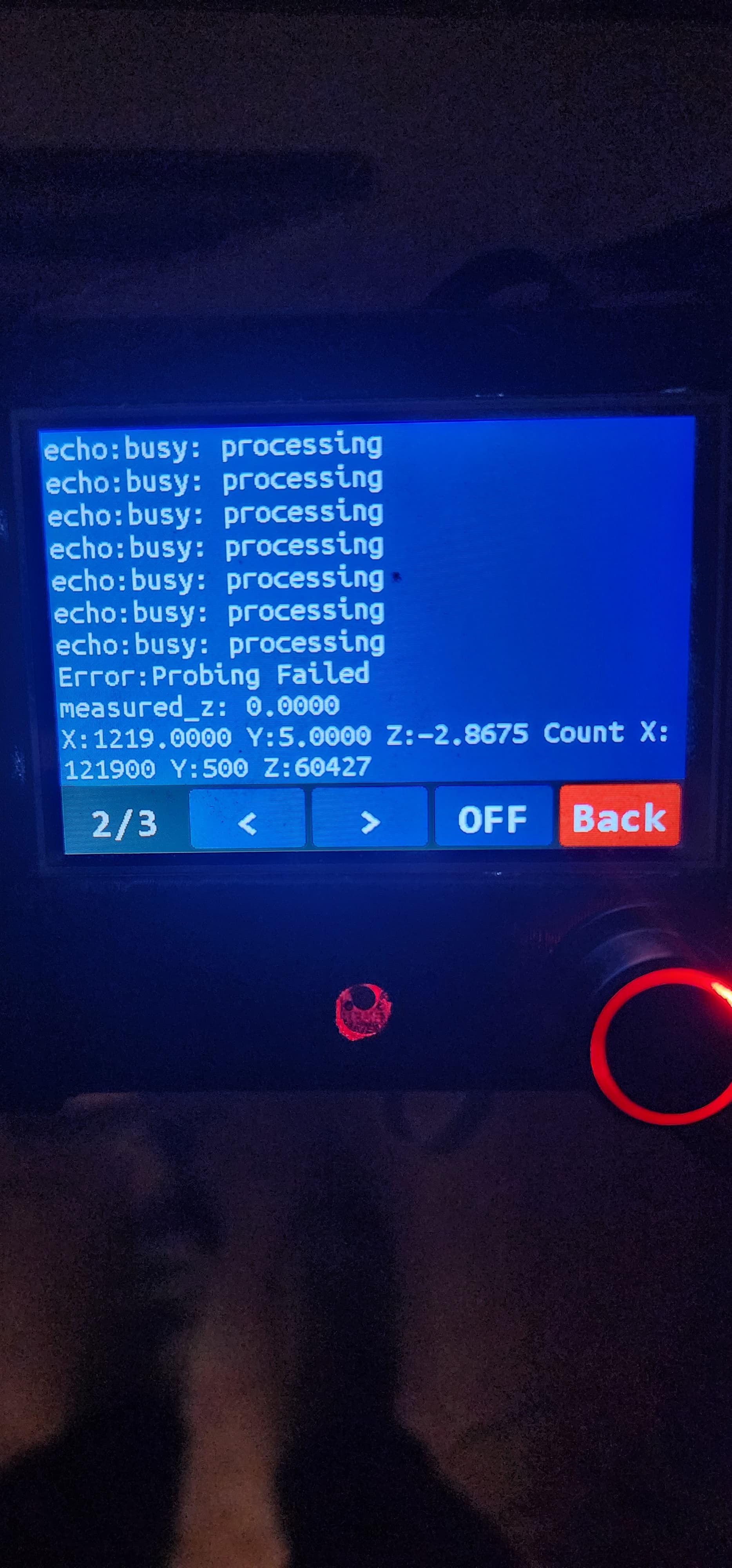

After messing with the BLTOUCH it seems I get the same proving issue even though all the troubleshooting checks out for the probe.
White is the probe pin and black is on ground. Tests for deployment of the probe work and show open and triggered. It will probe and stop at the point it’s triggered.

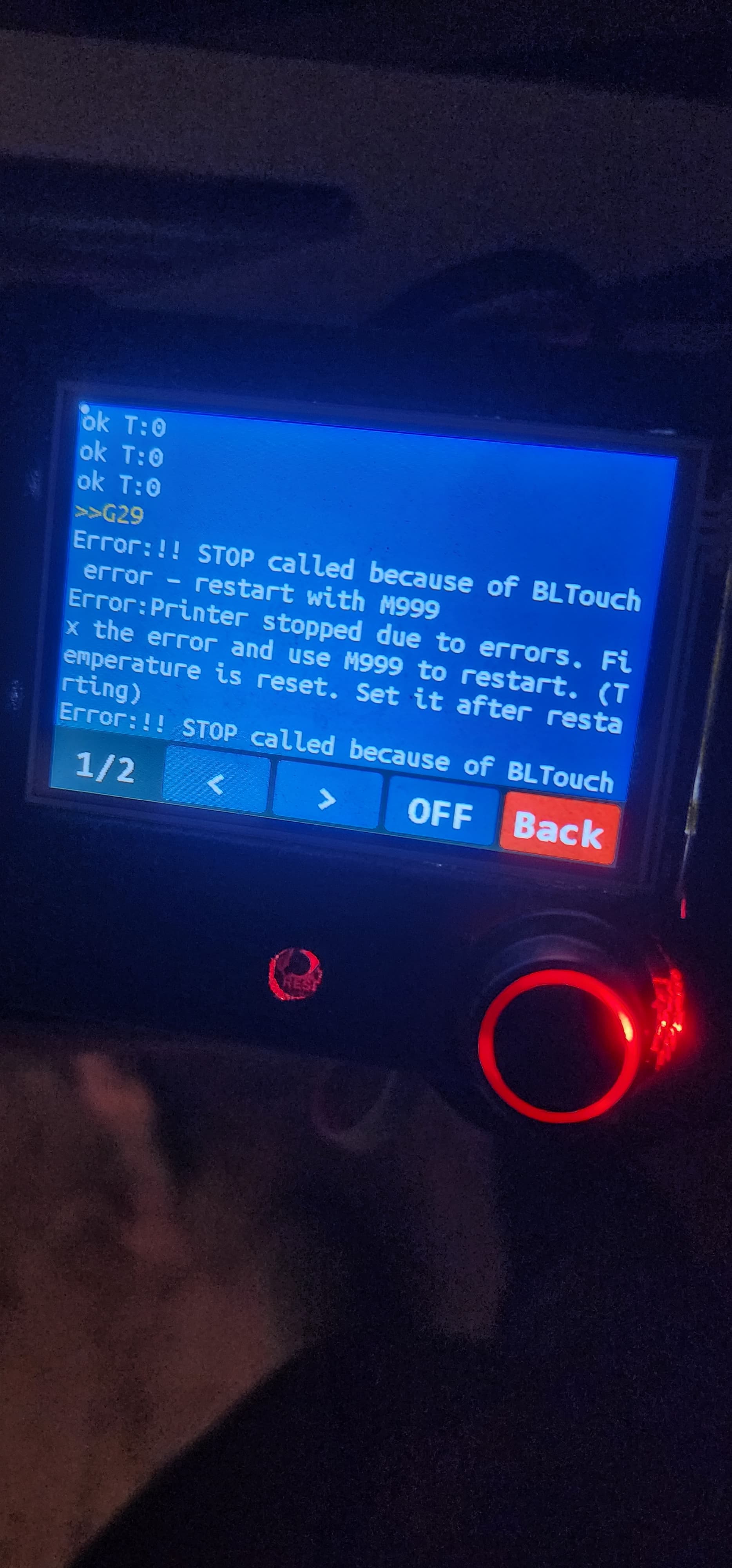

I get this error. I have the Z low point set to -200 to remove it as a variable. Z min is not trigging and software end stops are off.
The issue I had with the touch plate was the same at this point. Has anyone seen this specific error? Seems like it knows it’s at Z0 but it isn’t applying the current Z location for a given point. Works just fine using G38.2 as well where it stops and you set Z offset. Funny it came full circle which means it’s likely something deep in the config.

The bltouch will not work without flashing special firmware. Just because there are menus on teh TFT does not mean it will work.
I can not devote any time to this right now. I have my hands full with a few other issues. I do not see a reason to use a bltouch for the reasons I explained earlier.
