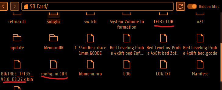

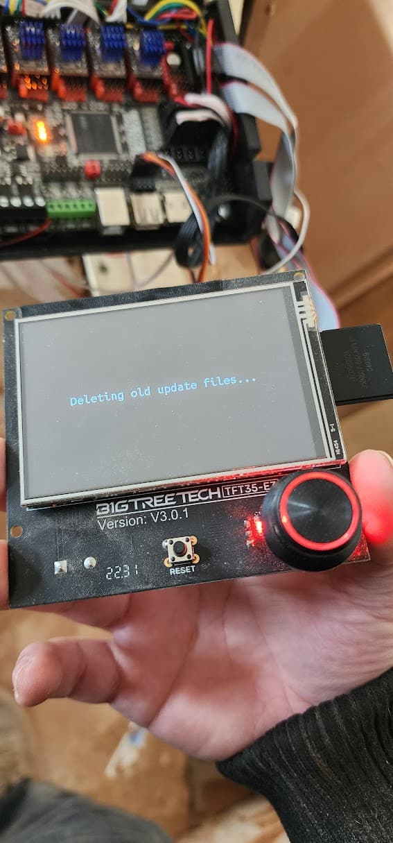

I am not going to download and unzip your files. Here is the direct link, https://github.com/V1EngineeringInc/BIGTREETECH-TouchScreenFirmware/releases/download/sept/CNC.TFT.zip , download that, unzip it, put all teh files on the SD card and reboot your LCD.
Does the flash take several minutes, show all the images while it goes and conclude with a firmware.cur file on your SD card? If that is not exactly what happens, Please describe in painful detail what happens.
I figured some wires got crossed with how I was replying. All good there though.

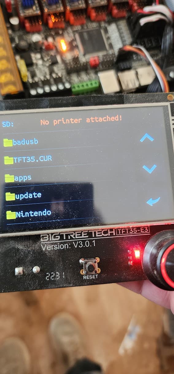

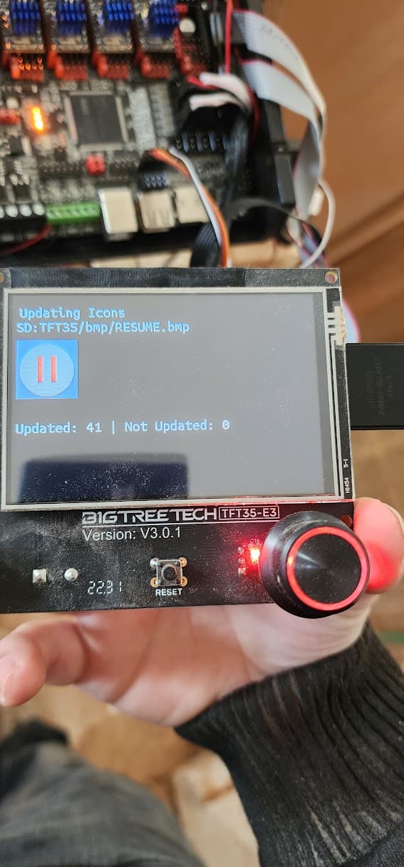

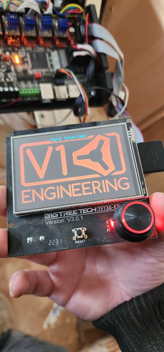

I took the link and flashed it over while taking photos. The files renamed as expected and the issue remains.
Tokoloshe
(Philipp)
February 2, 2023, 9:14pm
63

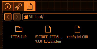

The last picture does not show a firmware.cur though, but TFT35.cur . Is that the same thing?
for the TFT I noticed it doesnt keep the firmware.cur like it does on the main board.
vicious1
(Ryan)
February 2, 2023, 9:29pm
65
Bigtree_tftâŚbin. That is not changing to .cur.

Try it one more time with these files. It is also best to do this with an empty SD card just to be certain.
I tired that and it would not load the bin like a normal flash. Whats the difference?

That is not right, one of those needs to flash. The screen shot you showed with the red highlights, did not flash.

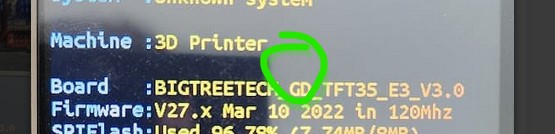

You unzipped mine and put the files directly in the home directory of the SD card?
Your screen has the GD version on it so I sent you a GD version bin.
The previous flash, that all the images changed, you just changed the theme. That did not flash the screen.
Technically, the exact same thing should have happenedâŚAND the bin file should have changed to CUR not just the folder and settings file.

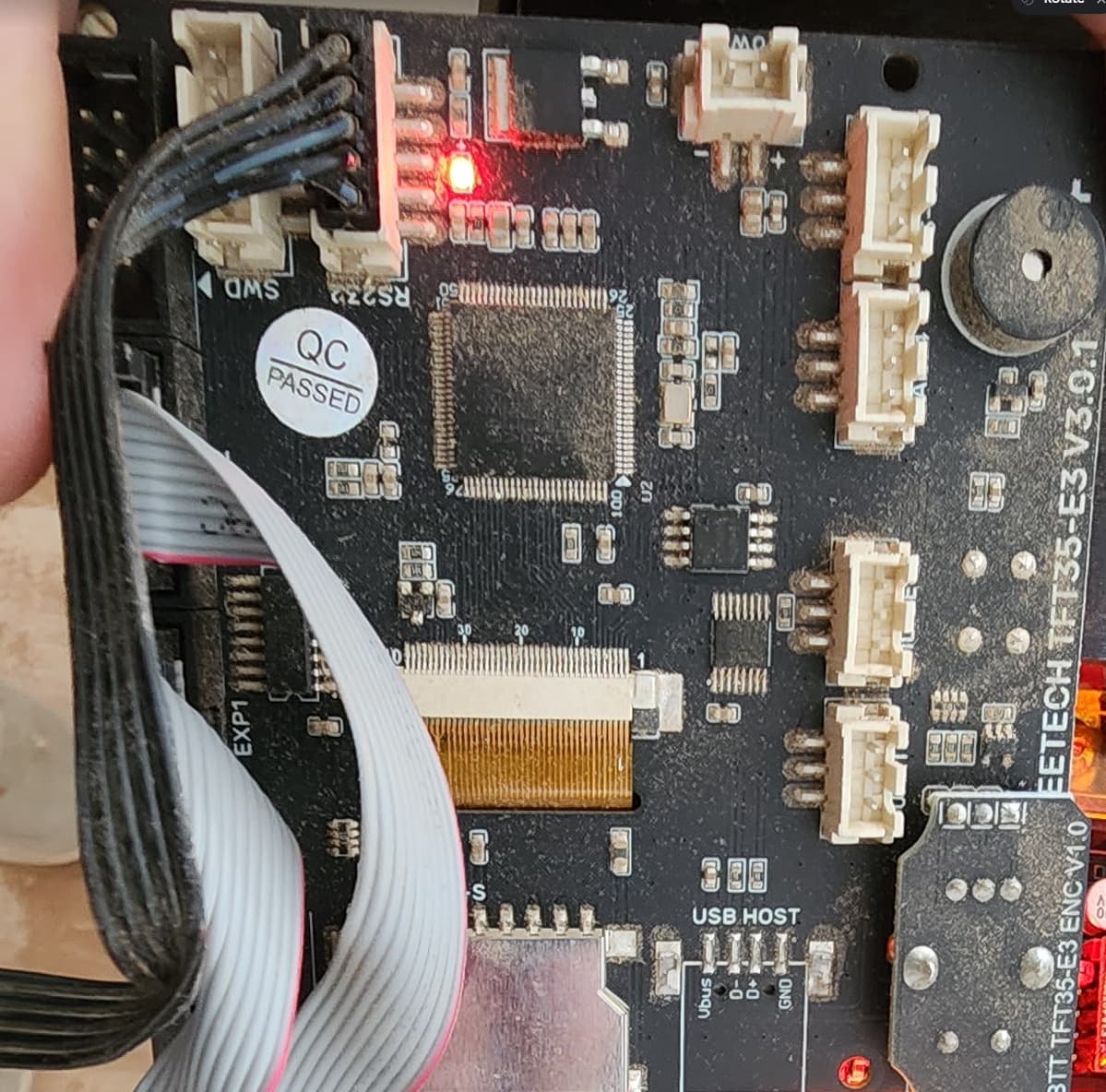

The same thing doesnât happen with the new, GD files? What the heck is going on. Can you get a tight shot of the back of your screen, and possibly the processor as well, to see the letters on there (looking for a GD or not).
No those files do not attempt to flash

I highly recommend some canned air on that. Those processor pins are pretty caked.
I can not read the processor numbers, can you clean it off some or type the numbers here.

Try flashing it without the gray ribbon cables plugged in.
The other thing is find the baud rate in the menus and change it to 250,000
That was just the old picture before I blew it off its clean now. Ill try manually setting the baud rate after I reflash it.
