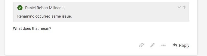

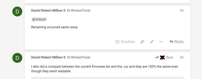

Renaming occurred same issue.

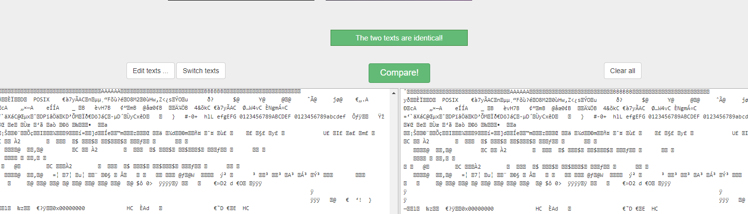

I also did a compare between the current firmware.bin and the .cur and they are 100% the same even though they arent readable.
I ordered replacements from Amazon that will be here tomorrow. Ill be able to replace and use the same cables. If it still doesnt work then its the cable connection. If it does then its one of the boards. I can then return them as needed. If its just the wires then I have 2 boards so I can make another sooner or return them.
Nothing is supposed to change in the file. The extension change just shows it was a complete flash. That is why I asked twice if the file name changed. Here is teh original question that has not been answered. “Did the file names change? The board takes a few seconds, the screen takes a few minutes (several files and folders not just a bin for the screen, if you missed the configs and images it will not communicate).”
Please take the BLtouch out of this issue. you need a working board before you bother adding things.
What does that mean?

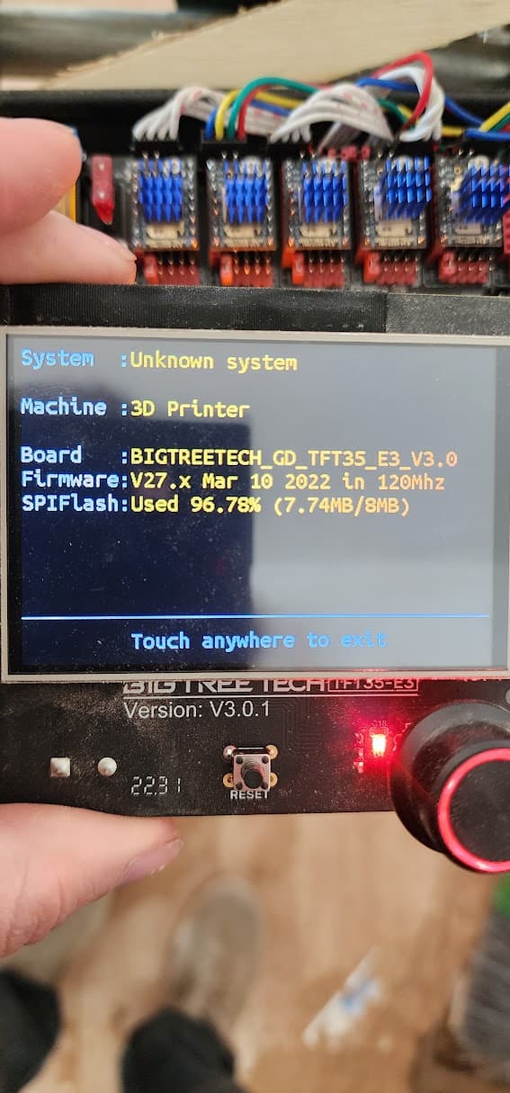

To verify, check the baud rate of the screen in the settings, what does it show? Does my logo show on the boot screen?
Yes your logo shows. Not sure on where the rate shows in the settings menus.
That is not my firmware, Mine does not have the “GD” in it usually.
So to ask again does the firmware.bin file on the LCD change to firmware.cur? I suspect it does not at this point.
