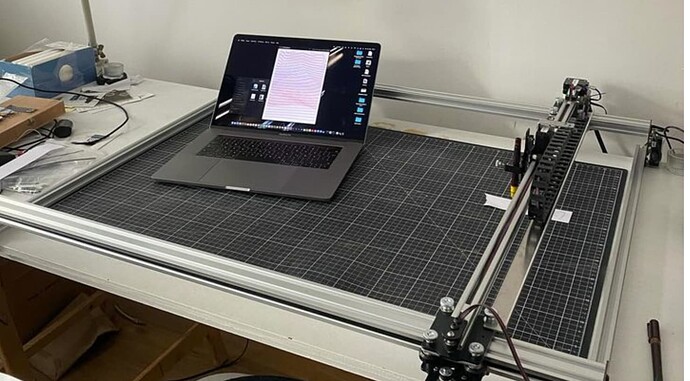

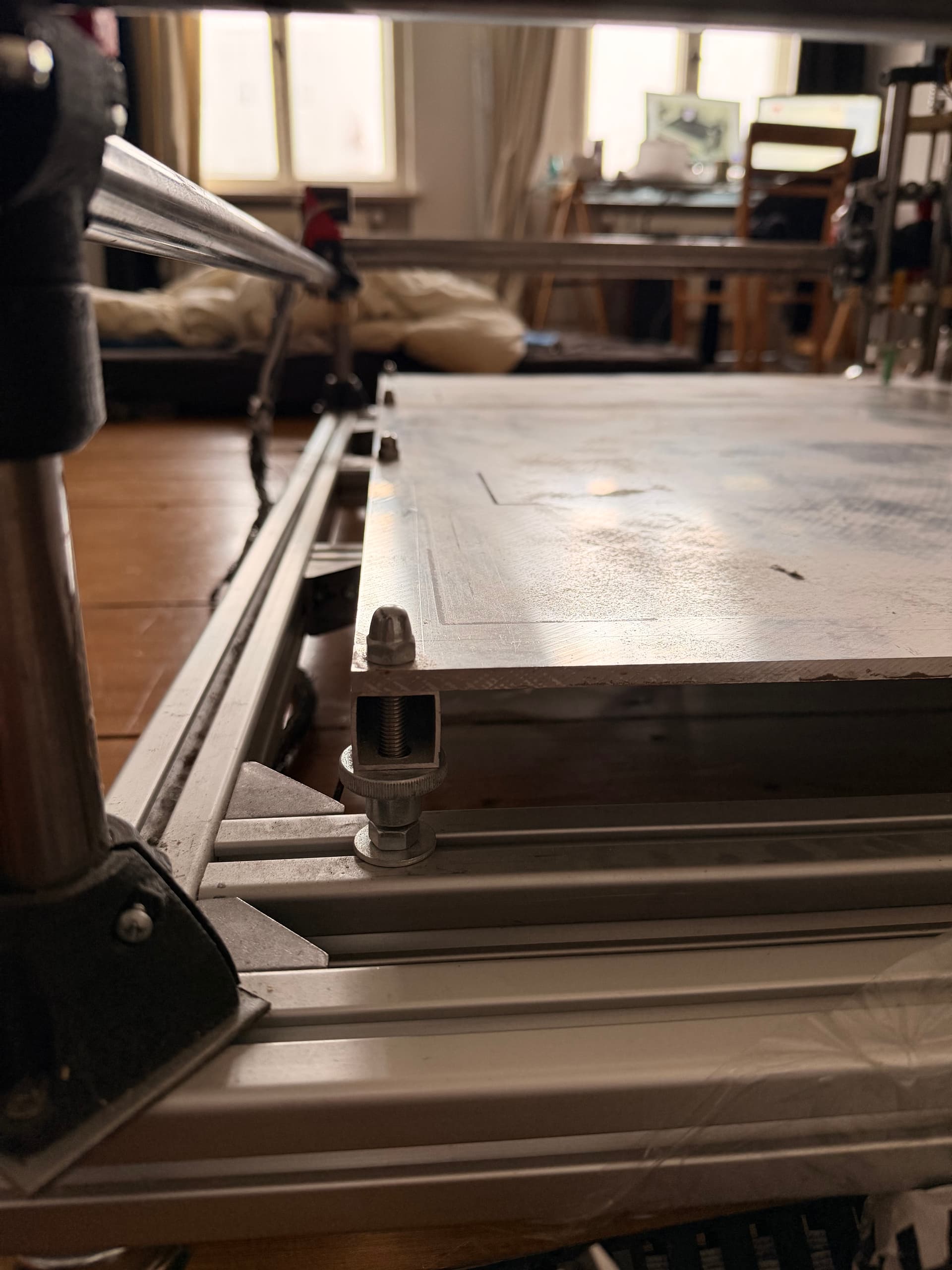

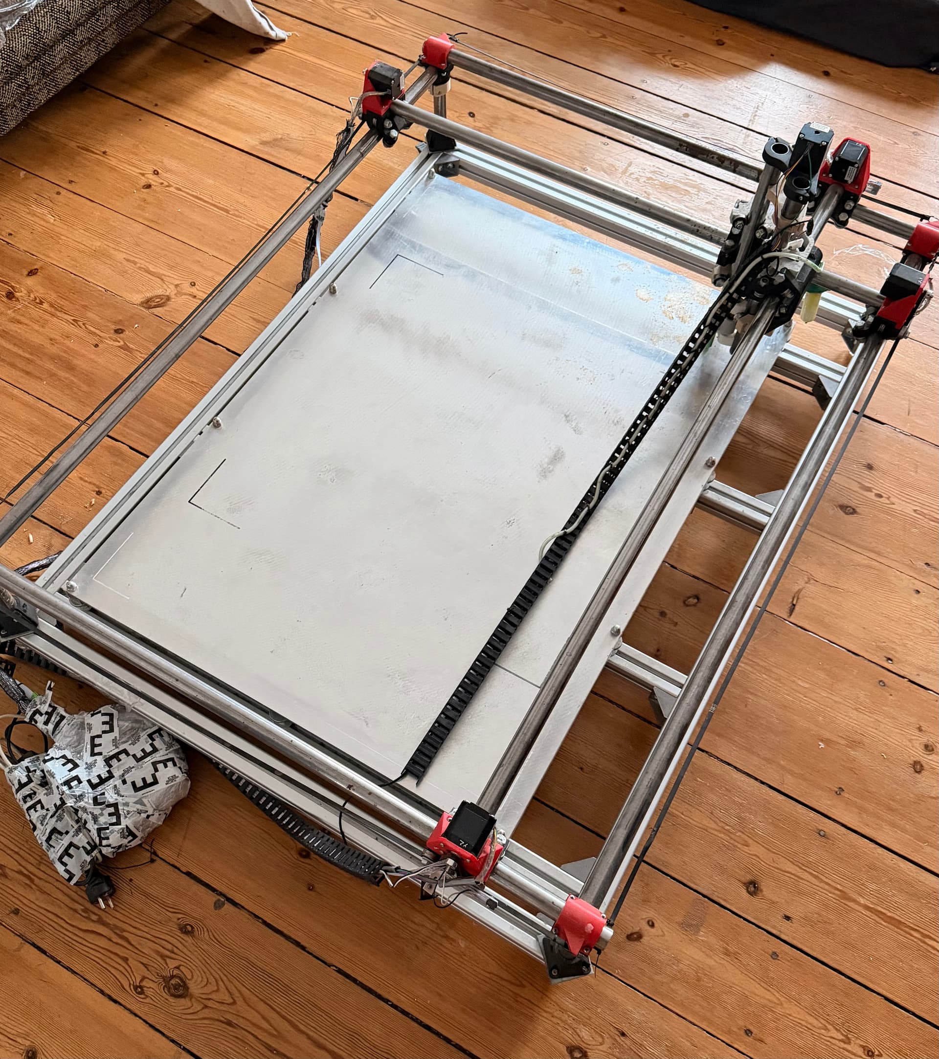

About 5 years ago, I bought an MPCNC in a way that was much more impulsive than rational. At the time, I honestly didn’t know exactly what I wanted to do with it. What followed was a huge learning journey — mechanics, firmware, calibration, mistakes, fixes… all of it.
Fast-forward to today, and I’ve come to a very clear realization:
I mainly want to use my machine for drawing and painting.
Over the years, I’ve developed my own tools for dispensing paint, and that is now the core purpose of this machine. In that sense, I feel that my current build could be optimized more for my use case rather than following the original MPCNC design.

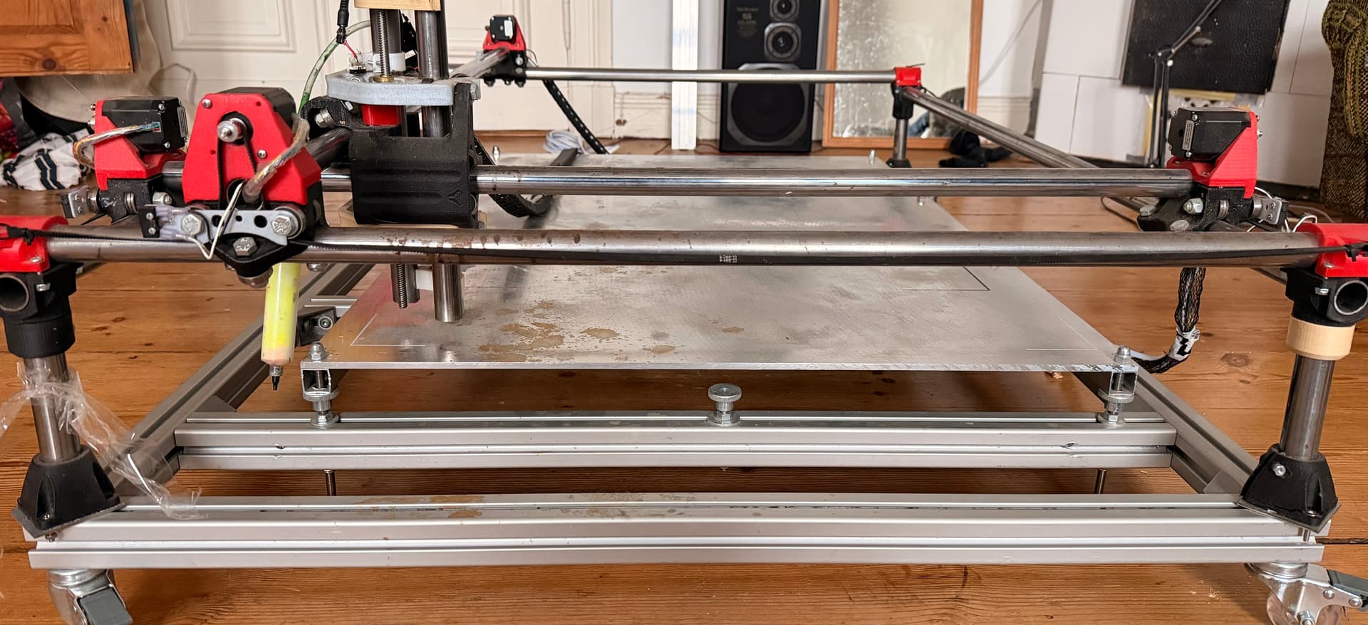

My current setup :building_construction:
As you can see in the pictures, my machine sits on a very solid, mobile frame with a large aluminum sheet as the working surface. The sheet is carefully straightened and leveled, which is absolutely critical for me — dispensing paint is basically like doing a perfect first layer of 3D printing, but on a very large scale. I’ve gone as far as Measuring the table height at many points and automating calibrating Z per drawing G-code to optimize the height instability issues​:pen:
The machine is roughly A0 paper size, with dimensions 1200mm Ɨ 900mm, so it’s quite a big build.
As you might expect from a very large MPCNC, I’m facing the usual challenges:
  • Flex and rigidity limits :cyclone:
  • Long belt behavior :up_arrow:
  • Squareness and alignment drift :triangular_ruler:
  • Speed limitations once things get large :rocket:
Here are some pictures of my build and snapshots of my tools and process.

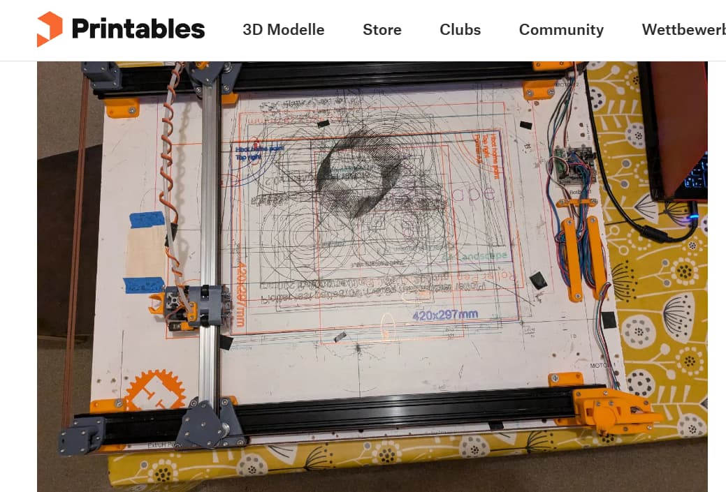

The plotter that Orob linked seems really great, but is also quite expensive as far as I can see, if that’s too much, I’d recommend the LR4. It can go as big as you want and is really stiff. :slight_smile:
How much z axis movement do you need? Im intrigued by your painting and if bed leveling/flatness is of critical importance, have you considered using a 3d printer mesh scan of the work area to get that amazing first layer? This might be a case where a z probe paired with klipper control software could be your friend to map the bed (painting area) and compensate for it in software. I dont know the upper limit on the number of points for a bed mesh in this scenario, but it might be worth investigating. There will be a scan time tradeoff to make the mesh scan.
That pen plotter has a tool changer to switch pens, but its z is basically up or down with some tension in the down so it will write. That mech may mot be ideal for a :paintbrush:.
Yea, that pen plotter (I built one) is designed for hanging on the wall and has limited Z which is designed for using pens with automatic pen changes. You’d likely have to do something different for the Z axis.
That’s actually exactly how I’m solving it :slightly_smiling_face:
I measure the bed at many points manually with a gauge, then use a custom script to take all those points, generate a NURBS surface, and project all drawing paths onto that surface. This way the final toolpaths already include full Z compensation, and the paint is deposited perfectly on the bed.
This approach is commonly used on very large 1m Ɨ 1m Ɨ 1m 3D printers, but I wrote my own script specifically for painting and plotting. The Z axis itself only needs minimal travel, mainly for lifting and tool changes, but it has to be very consistent.
At this point, what I need to figure out is which new build to put on top of my existing structure, since as mentioned earlier in the post, I’d like to keep the current frame and aluminum bed unchanged.

A Primo is a direct upgrade, will re-use most hardware, including rails that you currently use. 3" is minimum Z, less than that, you can’t really build, and doesn’t reduce anything.
A LowRider will re-use motors and some of the bearings, but require other hardware, including rails. Slightly greater cost, a bit more flexibility with the table.
For me when it comes to plotting, laser, or drag knife applications, I tend to preffer a CoreXY solution. This allows more high speed travel and cutting applications. This is important with a laser, nice to have with a pen or drag knife, hard to say with your paint dispenser.
The plotter linked above is a good solution. I have a CoreXY design I did myself, but it’s a bit small for your application. I have one laser that I am using a modified 3D printer stage (MP3DPv3) to move a laser, with the @dkj4linux manual Z axis stage to focus it. In this case, I used the older 3D printer stage because I already had all of the parts, as I had intended to build a second, but then the v4 was released, then the v5. Also I could get the size I wanted (400mm by 450mm) with parts in hand.
A0 is pretty big, and while a Primo can be built that big, it gets wobbly under any kind of load. I would be strongly inclined to use a LowRider for that size. However, it is more than possible to get belt to allow a CoreXY stage to be made. If you were to base the design on the MP3DPv4, this would require some pretty long MGN12 rails, but the result would be fast, accurate and reasonably lightweight. I would favor the printer design over the ZenXY design simply because the ZenXY core is just not designed to carry a tool, while the printer design is designed to do so.

Using an aluminum frame is fine. Using an aluminum table top is less so, at least for normal CNC routing. You would need to add a wooden (MDF/Plywood/OSB) spoil board, so that you don’t shatter bits when you cut beyond the stock depth, and you would want it thick enough that you can screw into it for holding purposes.
If your purpose is exclusively as a pen plotter, then I can’t think of many reasons that you couldn’t use an aluminum table top, as long as it was very flat. Often times there is enough uneven-ness on a typical table top that surfacing is required (especially for non-through cut projects, which would include a pen plotter). This would be a challenge with an aluminum surface (IMO)
The LR4 uses 1ā€ EMT. So the tubes you have now won’t work. EMT isn’t that expensive though. Mine was around $19 for a 10 foot piece.
He is drawing on it, not milling. :slight_smile:
Well, you couold for a LR3. but not for a 4. The 3 uses (or can use) the same size tubes, the 4 uses larger ones. The MPCNC was designed around 3/4" conduit (or 25mm or 1" tube) the LR4 is designed around 1" conduit (or 30mm or 32mm tube) This would mean new steel is needed for an LR4, though you could re-use what you have for an LR3.
For hat it’s worth, the LR3 is still a plenty capable machine.
Either style LowRider is going to have a slightly different footprint, so if your table is set up for your A0 size, it might end up being slightly different with a new LowRider.
The LR3 in stock form has less Z travel than the LR4, but as you’ve noted, that isn’t an issue for your usage case. You may be able to get used LR3 parts from someone who has upgraded. This would make the YZ plates easier to come by. You might even score some nice aluminum XZ plates. People would be likely to have re-used the MGN12H rails for an LR4 build though.
