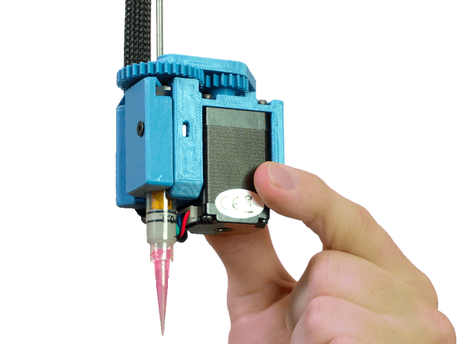

@kinansarak, already considered motion and extruder concepts/designs that Opulo folks have come up with for their pick 'n place 'n extrude machines?
