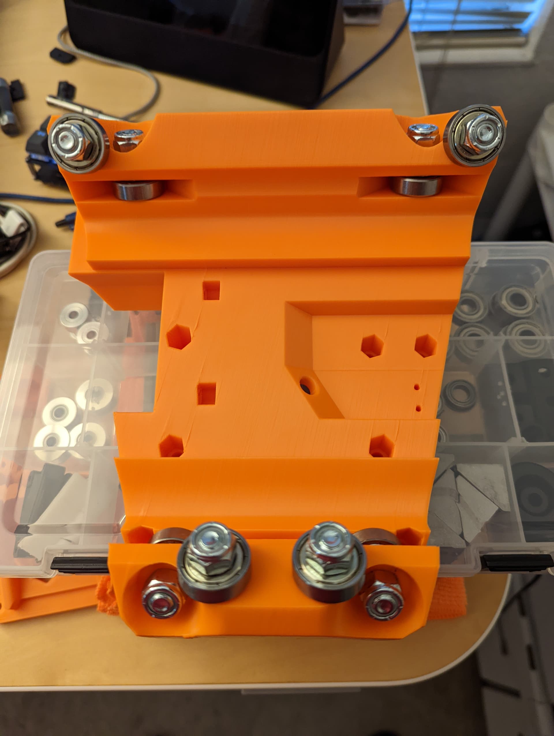

I’m planning on printing my parts out of ABS since I built a Voron v2 last year. This should provide similar (possibly better) rigidity to PLA but with higher heat deflection. Here is the first batch of parts from this last weekend. I didn’t really have a color scheme in mind, but orange was already on the printer, so orange it is.
This will be my first CNC, so looking forward to learning along the way. Thanks in advance for any help and advice the kind members of this forum can offer along the way. If there are any kind souls in the Bay Area of Northern California that would like to cut my strut plates for me, I would be forever grateful. :wink:

A few more parts done. I think it’s time to start shopping for hardware.
Looking at the Amazon links in the documentation, it calls for 110mm lead screws, but links to 300mm versions. I assume this need to be cut to length. Would 100mm lead screws be too short? I found these:

Yeah cut to length or leave them sticking up. I have 110’s here. 110mm T8 LeadScrew and Nut – V1 Engineering Inc
I think I squeezed that last little bit out of my orange remnant spools. Time to move on to black.
I also found a stash of skate bearings in my parts bin, so a quick trip to Ace and I now have metal installed. It’s practically a CNC already. :wink:
