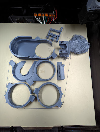

Fresh over night prints:
One the printer now:

You win some, you lose some. 5 out of 6 isn’t bad right? It might be time for a new PEI sheet.

The core is looking nice!
IPA and a magic eraser, good…or better than new.
Those prints look so good though.
