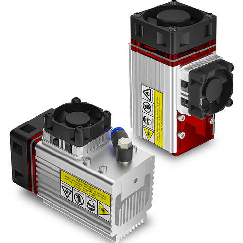

Getting closer! Using pin 45, and trying to use fusion. The laser turns on and off, but is at reduced power. Any advice on trouble shooting this. using Fusion might be missing something in the post processor.
My laser was plug-and-play wrt the Rambo board. Are you turning your laser on and off with g-code or the display? There was an issue with a version of Marlin turning the laser on and off via the display where the laser would come on briefly and then go out. It is an issue with the safety timeout.
If it is just reduced power with g-code, can you send me a snipped of that code? Note the PWM values for the Rambo board need to be in the range of 0 to 255, so you may need to make adjustments in whatever tool you are using to generate the g-code.
Did you measure the voltage you are getting at the laser? If you used smaller gauge wire for your longer run, there might be a drop.
Did you wire the laser using the companion board, or directly? If directly, did you include a ground connection between the laser and the control board? This will be required if you use a separate power supply for your CNC control board and your laser module.
Are you sure you have the focus distance right? Out-of-focus makes a huge difference in cutting ability.

Do you have a link to the laser you are using? I like Plug-n-play. The laser I am using was given to me 2.5W. Plan on buying a real one
I am using Gcode M3

The way I determined that I was not getting full power is, I disconnect the PWM line, Power increases

This is the latest version of the laser I use:
M3 O255
This is full power, so it is not a g-code issue.
I’m surprised the laser did not turn off when the PWM line was disconnected. Maybe the logic is backwards, in which case I’m surprised the laser turned on at all. There is a provision in Marlin for reversed logic where 255 is off and 0 is fully on. You might try sending a PWM signal of 0 (i.e. M3 0) or M4), and see what the laser does.
Are you sure this laser was designed for a 5V PWM signal? Do you know if the laser PWM is analog? One thought is that the laser is expecting a 12V PWM signal and uses the voltage of that signal to determine the laser power. If so, a 255 value would produce 5V turning the laser on at less than half power. That does not explain how the laser increases in power when the PWM line is disconnected.
I ordered the laser you suggested. Again thanks for all the help!
There are several topics on this forum concerning this laser, and I believe there are links to mounting solutions.
Am I correct that the 40640 connects direct to the Rambo? No need for the adapter board? Any other hook up information would be appreciated.
It will directly wire to the laser, but personally, I used the adaptor board. It provided plug-n-play, with no wires cut or soldered. I did have to extend the PWM control from the Rambo board to the companion board. And, after hundreds of hours of laser use, I started to get arcing where the laser plugged into board. I write about how I rewired the board here.
But the companion board is not necessary. I purchased one of the $79 laser engravers when they were available and written about here. For use on that machine, I wired the module directly, and it works just fine.
