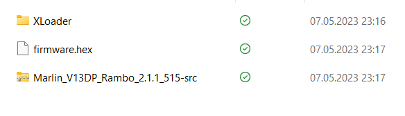

I bought the board on this site about 3 years ago. I updated it a few days ago. I took all the information for updating from this site.
Marlin_V13DP_Rambo_2.1.1_515-src through XLoader

I figured out the problem, and I’m sorry I did not catch it sooner. You installed the firmware for the V1 3D printer, not the Lowrider. From this page, you want to download V1CNC_Rambo_DualLR. Note the LR in the title indicating it is the firmware for the Lowrider. Use XLoader to update the firmware, and then retest. If you have the M3 I at the beginning of the file, and if you have Lightburn set for Inline commands, then your laser should work.
Thanks! Are you talking about this firmware that’s in the photo?
