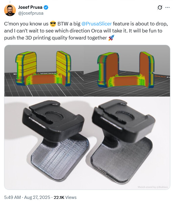

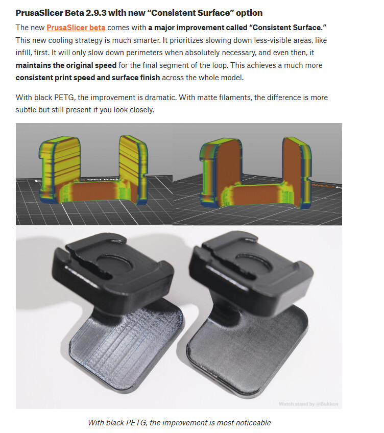

My non-matte filament is always matte when printed, only the last bit where it prints more slowly because of the cooling it is shiny. :smiley:
Yeah, doesn’t help for the tip though, just removes the visible artifacts. :slight_smile:
well… if it’s just the tip… does it count??
Noooo? :joy:
In the cold hard light of day, the noticeable shiny bit is less noticeable when not placed under a lit camera lens, but I don’t know why the last twenty or so layers should be treated differently. Still, I’m pretty happy with the overall quality - it’s first class and that was on draft mode, I shudder to think what the .15 quality one will look like.
There is less to print so it slows down because of cooling. Don’t want your layers to not be hard when the next one goes on top of it. You could slow down the whole print if you wanted the same colour.

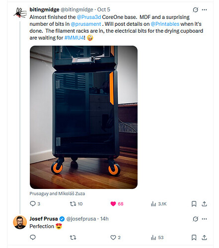

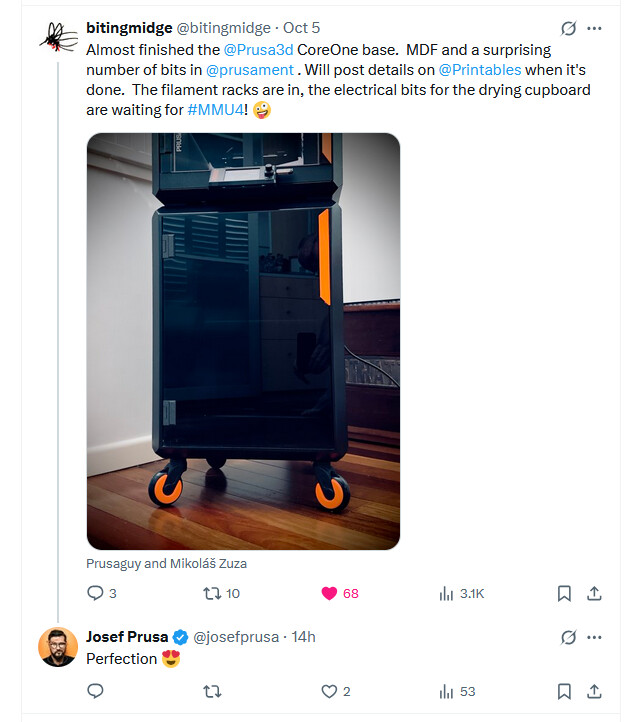

So far so good, and it’s almost done - there’s a fold-down shelf almost finished to hold the dryer so it can direct feed, and inside two racks hold eights spools of filament with room to double that if I get stupid - am waiting for details of the MMU4/INDX before I make the bits to feed it out the back, but have a plan to heat and ventilate it to make it a drying cupboard if that works out.
That looks like a way better solution than my kraken thingy… :smiley: I still struggle with really good filament buffers/rewinders for those, but the good ideas won‘t come. :sweat_smile:
This cabinet is “almost” 400mm deep, so the buffers could fit inside - but I am hopeful that -
  • the MMU4 (let’s call it that shall we?) will lead the filament so I can draw it into the back of the cabinet,
  • I won’t need a rewinder
  • It can really handle seven heads (I have eight connected)
I admit that not much more than a year ago, I doubted the value of multi colour printing - but I have some projects planned in the distant future, and multi material will be a game changer for a couple of things I have on my list too! But I need to keep some of that stuff DRY baby! I could even compartmentalise it and dry at different temperatures, but that is getting ahead of myself!

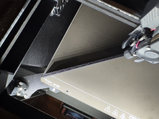

330mm is where the CoreOne draws the line - I would have preferred to have squared ends on this part, but one piece was worth the trade off.

Let me just put that up here real quick. You have a heck of an eye for design. I love to see the big guys notice it!!!
Thanks so much! (I shall have a word with your spy! :rofl: ) I posted that on Twitter for the benefit of David (Prusa’s model maker extraordinaire) who’s designed some really nice accessories and I’ve been really chuffed with the reaction. :face_with_peeking_eye: It’s sort of embarrassing because it’s really just an MDF copy of the printer, but really satisfying to build and I am really pleased with the outcome. I am hoping that it will work to feed spools direct to the INDX, and I have had a very broad hint that “Formnext will be a very busy time for the team” - so maybe I can finish it by Christmas after all! :rofl:
That’s the big dude indeed!
You should be. Your work is outstanding.
It wasn’t me! I swear! :scream:
