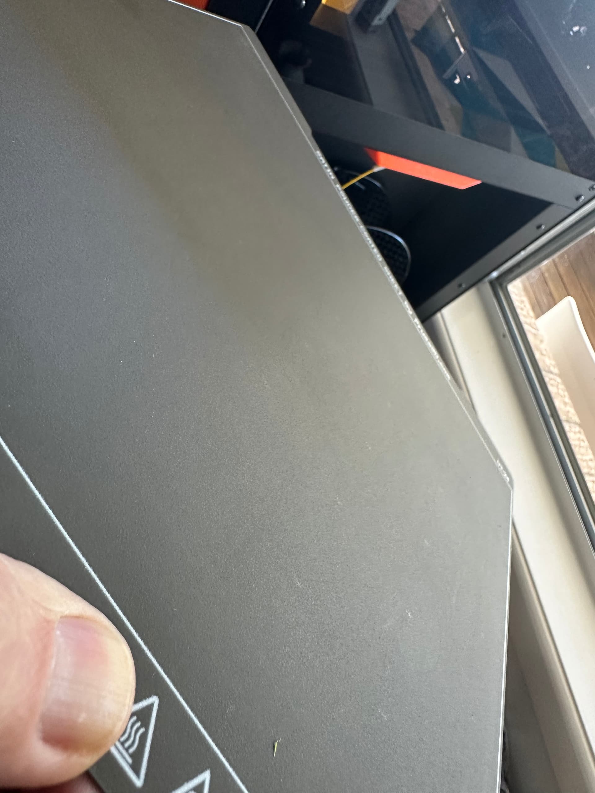

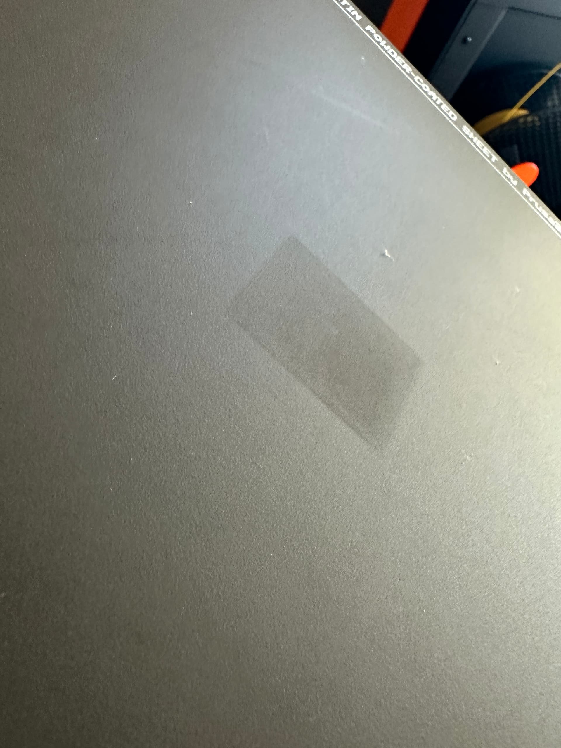

I’ve just printed 30 identical parts (yesterday and today) and my satin sheet looks like this with no cleaning between them.
After a quick clean with IPA, you can still see the slightest shadow - I don’t think it’s enough to affect any print, but I’ll give it a proper scrub with detergent later and I am pretty confident that it’s not actually a mark in the finish of the sheet.

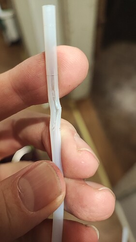

Not my day… The PTFE tube from the MMU to the Nextruder…
Did it get pinched?
I might have when I tried to unjam TPU a few weeks ago. It’s the most stressed part I guess.
I don’t think I like the sound of that… but I guess it was via the MMU?

The sheet now only leaves very slight shadows that you can remove by cleaning after basically having printed all over it several times.
I love the matte surface finish and it’s amazing how well PLA sticks to it (and comes loose when it’s cold).

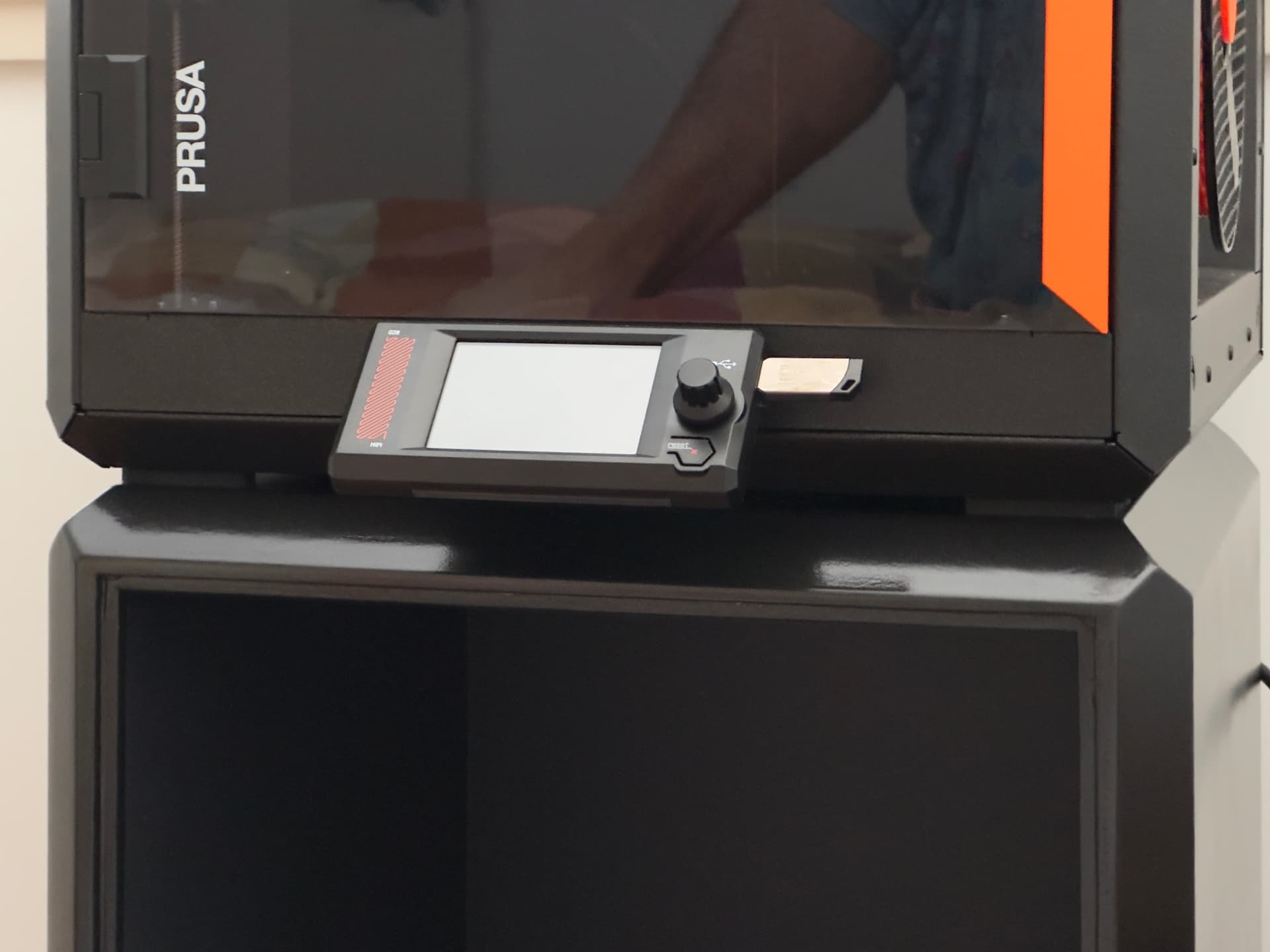

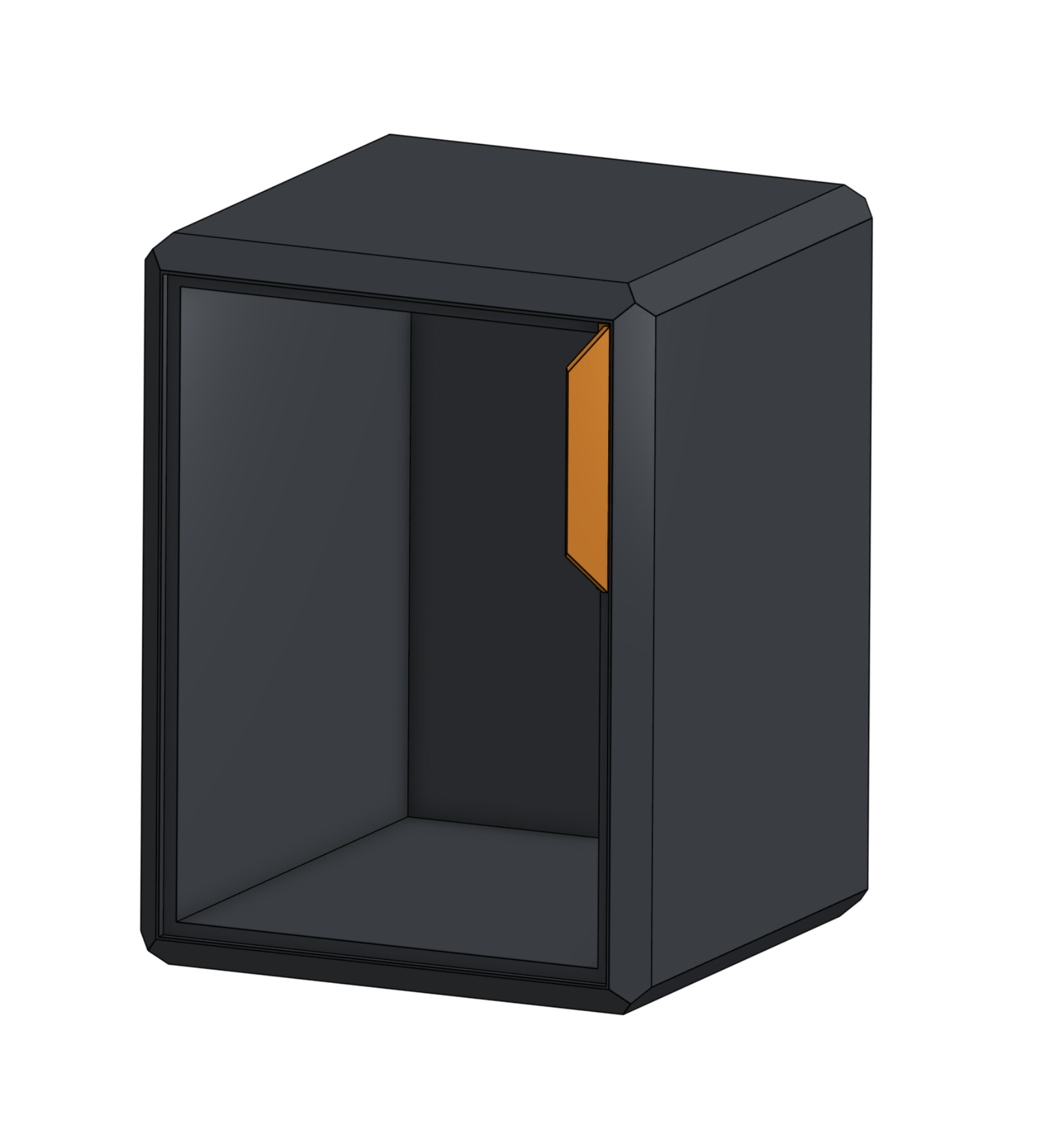

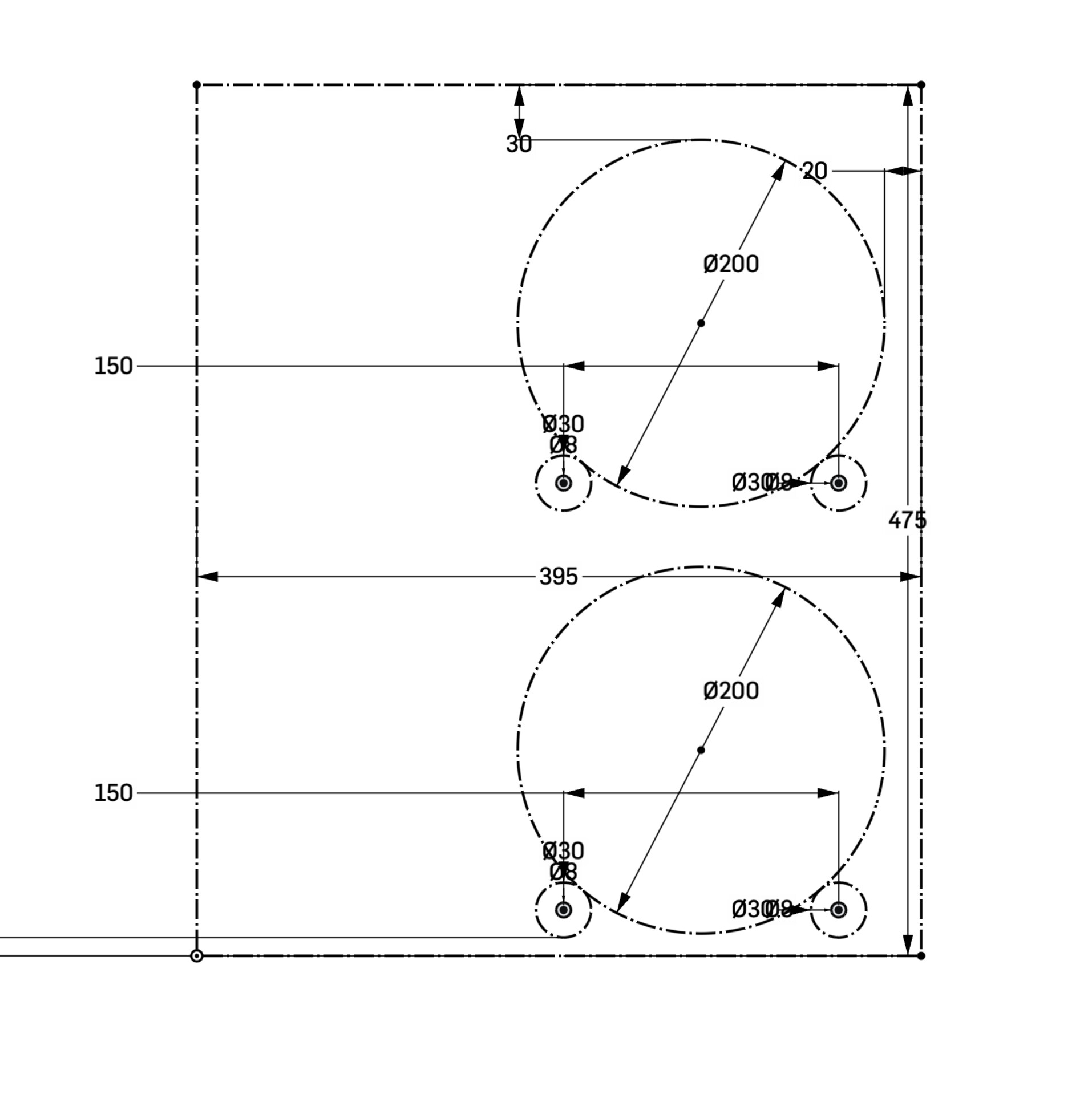

I’ve been quietly working on the base for the CoreOne. Today I discovered that Biqu are now making a thing called a PandaHub, which is almost exactly what I am doing here, maybe they are trawling my Onshape account, or more likely it’s not a very original thought!
I’ll have a little fold-up shelf on the right hand side, to hold the dryer and as a stopper to maintain space to change filament. At the back, eventually I think I’ll recirculate hot air with a duct from top to bottom and a heater element in it.
For now, it’s main purpose is to keep the CoreOne 600 mm above the floor! It’s designed to mimic the printer detail - I’ll spray it metallic black to match.

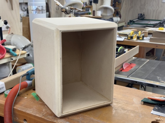

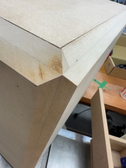

It needed to have some heft because it’s holding up 25kg of printer, so two layers of 12mm MDF with a spacer frame of 12mm do the trick. Ready to sand, fill and prime.
The mitre is “close” to the metal one, I’ll round off the corners to get a better match, but there’s a few mm difference I think because I wanted to land the cut on the inner skin joint line for tidiness. Sometimes, the old Jet contractor’s saw makes me very happy!

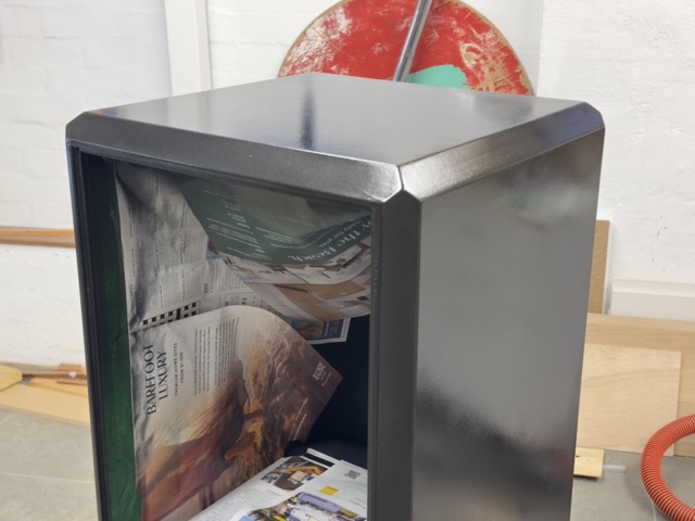

And we were going so well…
I’m pretty happy with the finish, it’s a close enough match to the CoreOne powder coating, or will be after it gets a coat of matte clear, but why oh why did I have to get one run, right at the top corner where it can be seen. I can’t live with it, so a bit of wet and dry will fix this afternoon.

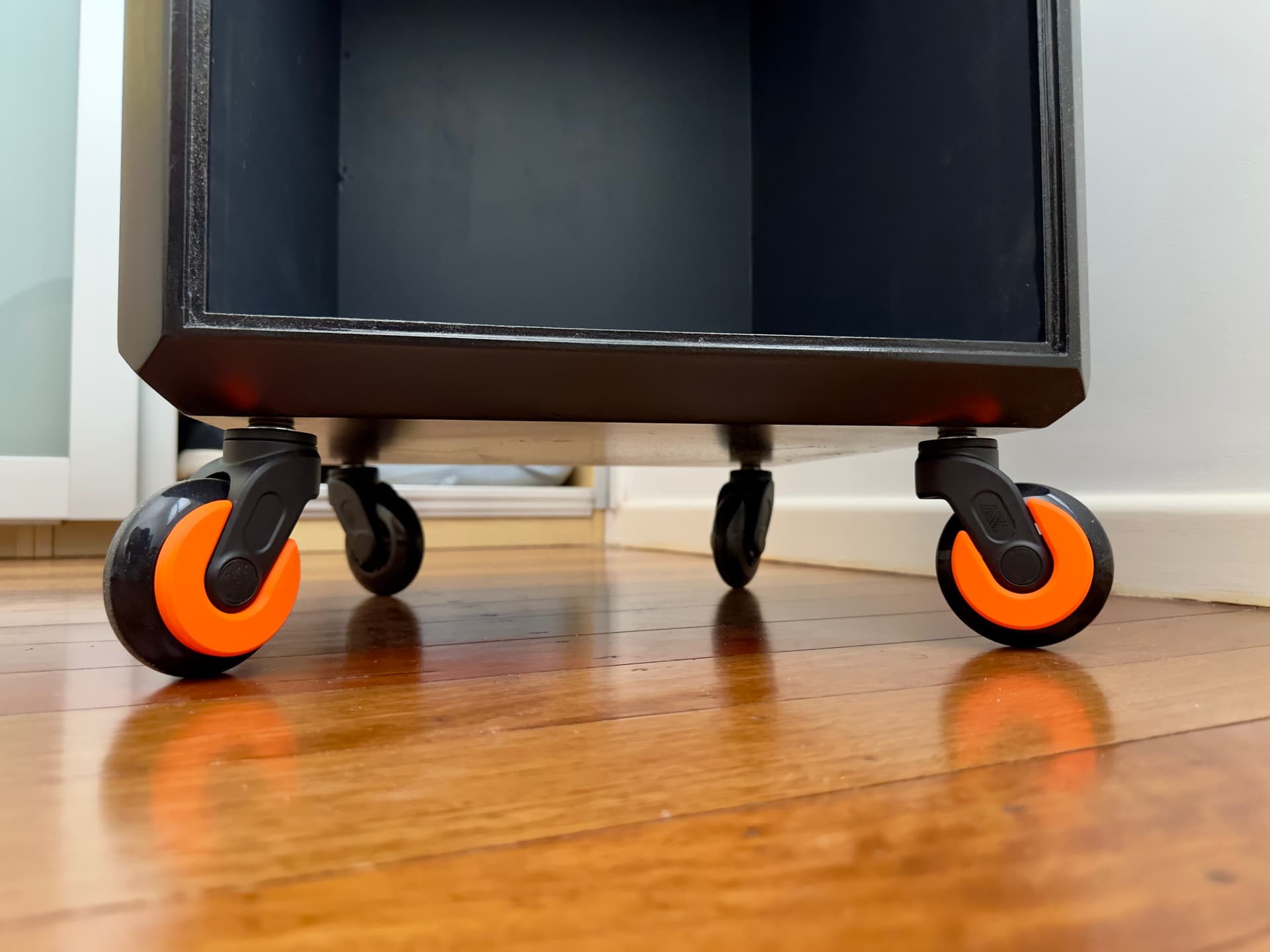

I decided I would run with the gloss, the paint will need a day or two to cure, but I thought I would fit the casters anyway. I am using scooter wheels and suddenly the cupboard took off down the hall of its own volition. :rofl: More interruption while I made a couple of snap-in wheel stops!
Are those casters of your own design?
It fits!
No, but the orange locks are. (details here) They are standard scooter wheel casters for chairs - I’d recommend them for every office chair, but they are a bit speedy for vibrating bit of furniture, and on our not terribly level timber floor the cupboard will almost certainly go walkabout!
I like to use casters because (apart from the obvious moving thing) they are a great way of reducing noise transmission).
As an aside - some may find this useful - standard chair casters are 11mm diameter, and while it’s possible to just fit them straight into timber, because of the circlip spring they do end up getting a bit sloppy. Sleeves can be bought at some stupid money, so here’s one you can print for almost free. CASTER SLEEVE SOCKET ADAPTER by Peter H | Download free STL model | Printables.com

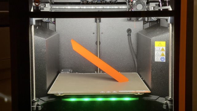

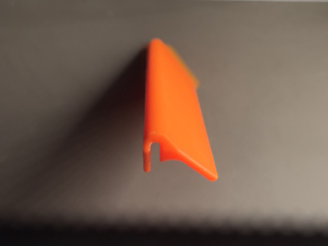

I was slicing the faux metal handle this evening, and not being silly I put a nice 4mm brim around the thing because it was just a 2mm and 3mm vee (before chamfer) so two thirds of a metric jigger all in contact with the bed. PrusaSlicer didn’t kick up any warnings about support being needed, so I thought “I’ll play your silly game”…
How is that even possible?
Printed in DRAFT mode, the top taper is quite shiny compared to the rest, but apart from that it’s a perfect print. This might be the point where I admit to a tiny bit of love forming for this machine.
That would be a plate of plastic spaghetti on the TAZ or the FRCPs. May the A5M could do it but I doubt it.
