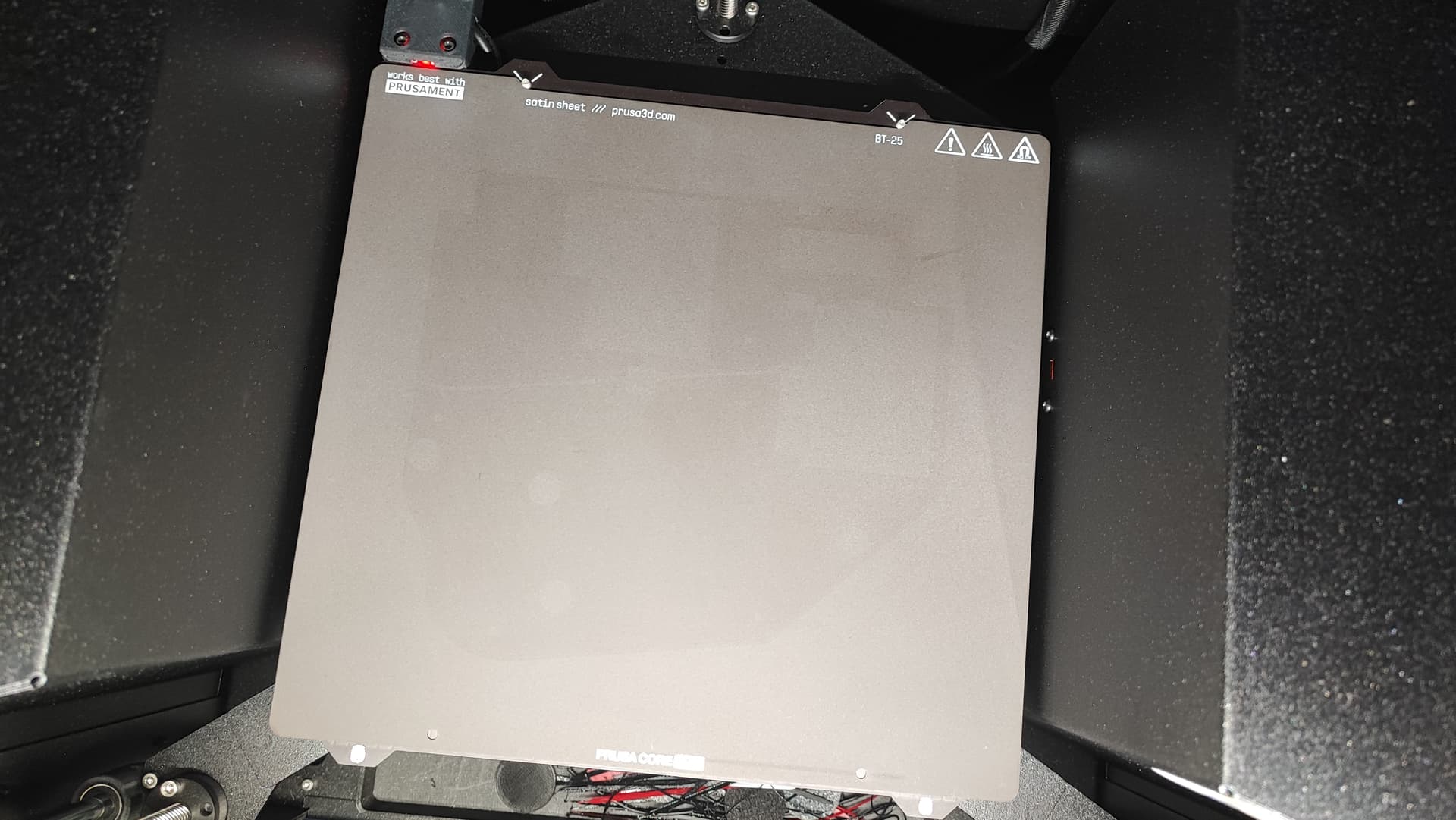

@bitingmidge, does your Satin Print Sheet also have the shadows of the prints that came before? They are on the bed after the first prints already, the little round disc I printed shows itself in the side plate as well. I have only had that problem with the smooth sheet when printing the wrong material and never with the other sheet.
Old Smooth:
You can see the shadows of prints where some residue of TPU was still in the nozzle.
New Satin:
I printed one circle and wiped it down, you can see both… (though the satin surface looks much better for my taste, I just like matte more than glossy. :slight_smile: )
No not at all- did you clean it well with IPA before printing? It’s powder coat so it should not be embedded in the finish - try scrubbing with dishwashing soap, a clean microfibres cloth and HOT water - Prusa says don’t, but dry it immediately with a clean tea towel.
Let me know - it’s one of the reasons I love the satin sheet.

Washed with a lot of soap and a cloth, wiped it down and there’s still a shadow. You haven’t had one ever? Can you send a picture of your bed?
Message sent. I am surprised to say the least - neither my satin or textured sheets show any sign of imprinting - I maybe didn’t mention that I use neat detergent then wash it off with the hot water, but that looks a bit unwashable from where I’m sitting. :cry:
I’m not sure if we can expect prints not to have traces from the bed? I just always assumed that it’s a part of the game?
They shouldn’t show on the next print though. :sweat_smile:
If the image is powdered residue from the previous print, have you tried washing the print with IPA? I know on the smooth sheet it’s a definite imprint but Maybe not on the powder coat one?
