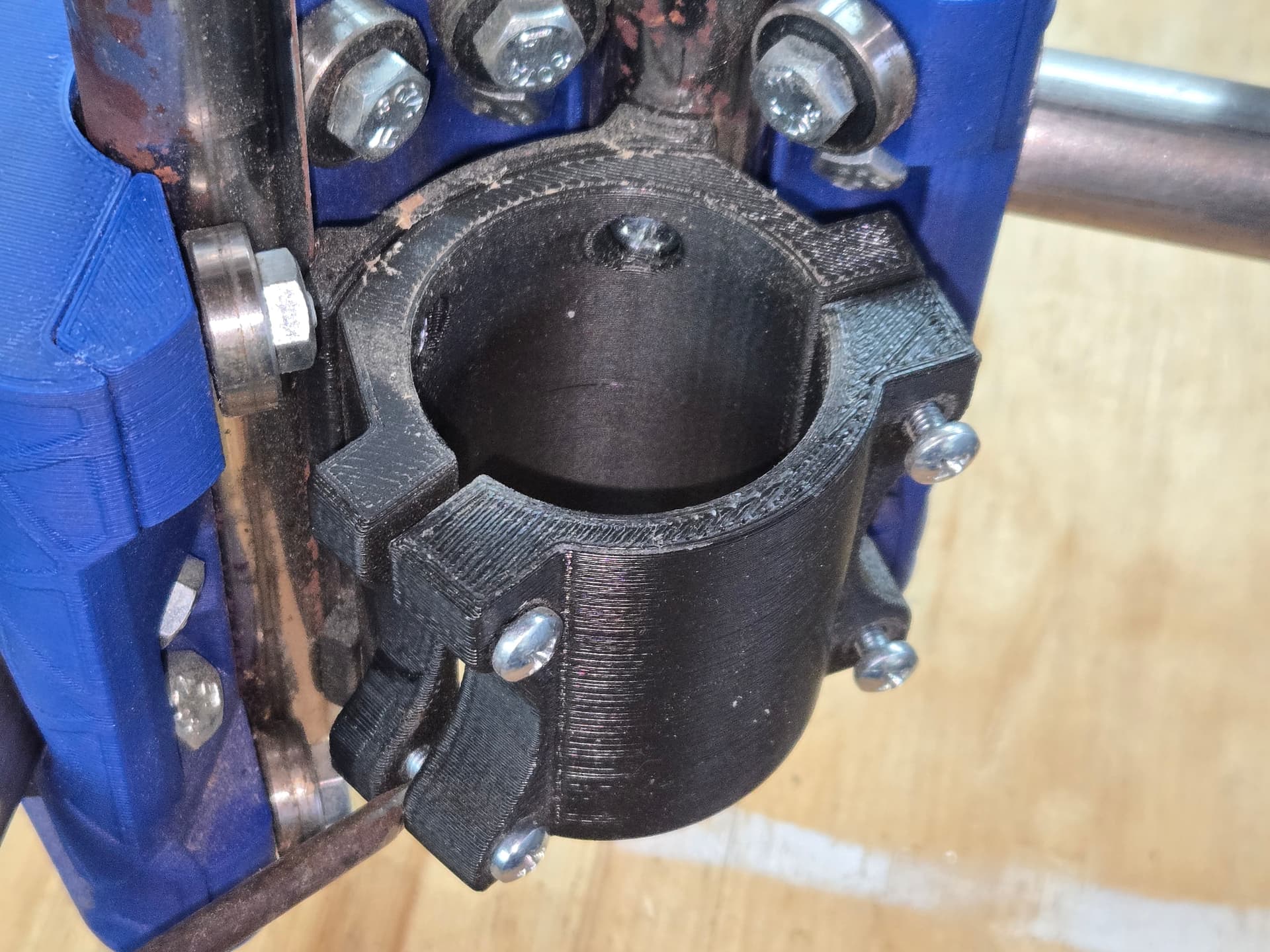

So I was running some tests this evening, and noticed that something looked funky on the cuts.
Upon closer inspection, I realized that my spindle motor was slipping in the mount! I tried tightening it up just a little, but one screw (bottom left) wasn’t getting snug. I saw immediately that the rear side mounting ear was cracked. I superglued it back in place, but I have no real confidence that it will hold. I figured I’d just print a new mount, but I can’t seem to identify the right parts…
I found this mount, which seems to be correct, based on the name, but it looks a little different than my current one.
The current mount has a back plate that the mount…mounts to. :slight_smile:
Is this the right model? I just want to be sure, since it’s likely to be a fairly long print.
Looks like the one i have i believe.
Cool. I hope it works, because I’m printing one now… :slight_smile:
The one on Printables looks a bit different than yours and mine. Maybe it’s just been updated. We’ll find out shortly.
The motor mount worked great, thanks everyone. :slight_smile:

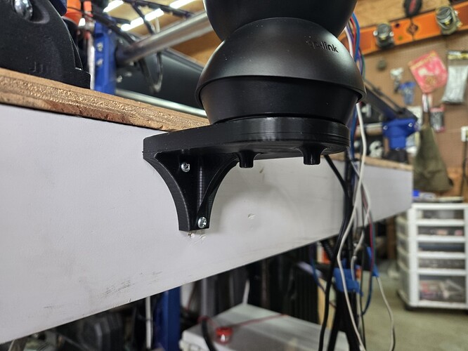

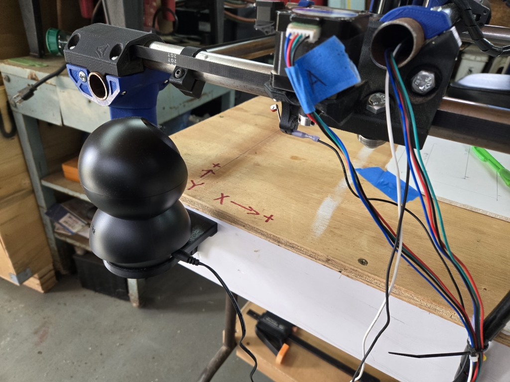

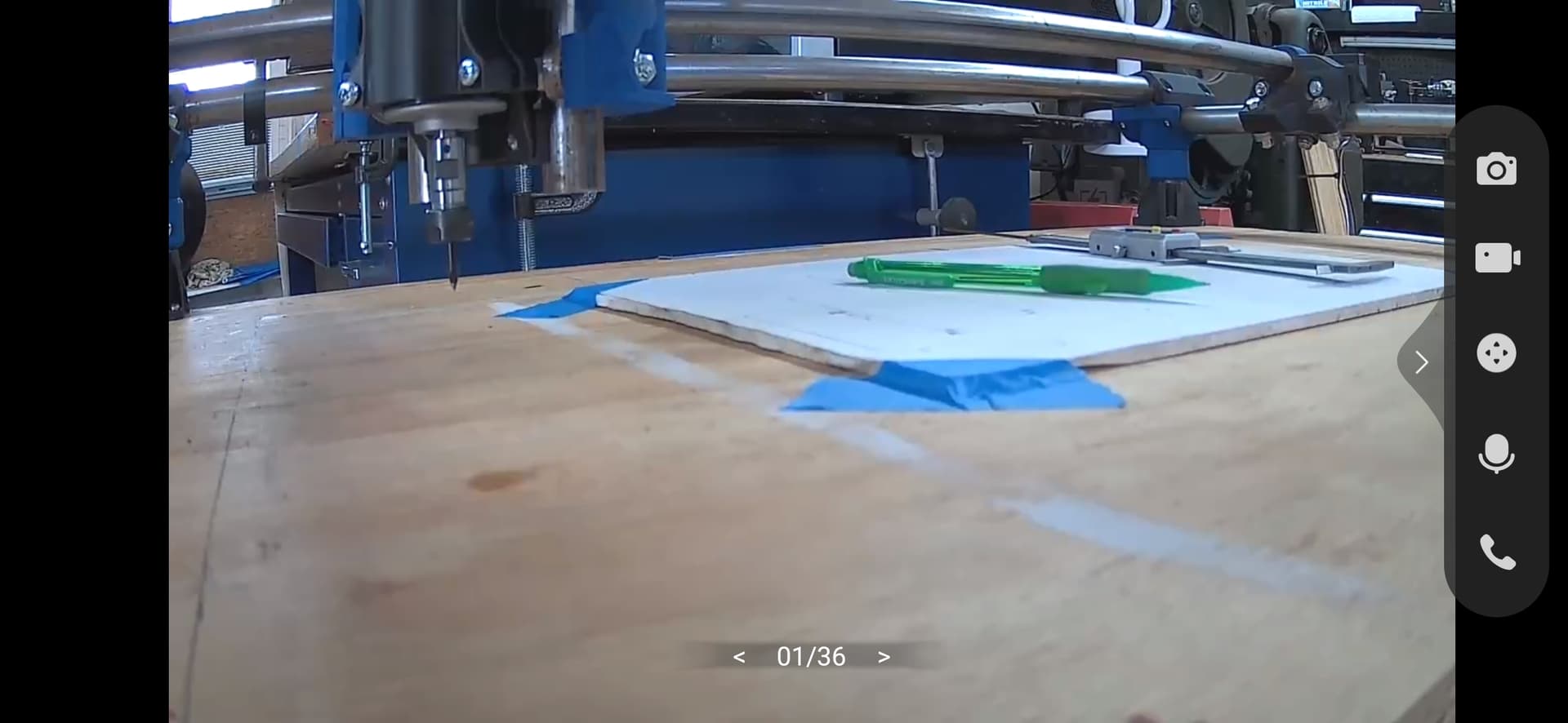

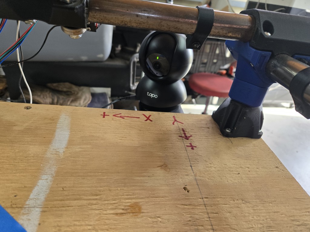

I’ve modeled and 3D printed a mount, so I can install a small IP camera to monitor things while I’m not there in the shop. This Tapo C201 is a pretty good camera (so far) for only $19 shipped.
I won’t use this for regular jobs or anything, but it will be nice to watch it work from my desk, if it’s a longer cut job.

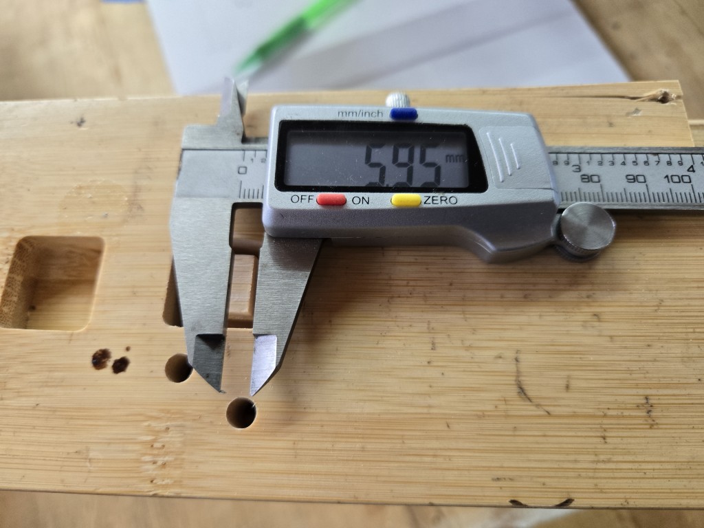

In other news, I’m trying to figure out why my holes are cutting undersized.
In that test job I was doing earlier, I had a row of holes that intended to hold 1/4” router bits. Those are 6.35mm shafts, so I modeled the holes as 6.5mm dia. to allow a little clearance.
There are a 2nd set of smaller holes, meant for 1/8” bits. Those are modeled at 3.2mm, so basically a drill with a little wiggle. :wink:

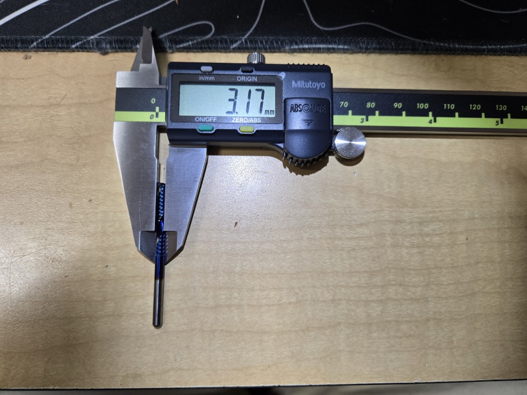

My bit is a 1/8” (3.175mm) spiral O-flute upcut. I thought the tool was undersized, but it checks out.
When I run the job, the holes are cut too small, by quite a bit. (see image)
The larger holes are running about 5.9-6.0mm (I measured a couple of them, several times), and the small holes (not shown) are just under 3.1mm. Neither will accept the bits they are designed to hold.

Anyway, all that was to say that I can’t figure out why a hole drawn at 6.5mm is being cut ~6mm.
I thought I had the tool size set wrong in EstlCAM, but it’s on 3.175mm.
What else should I check?

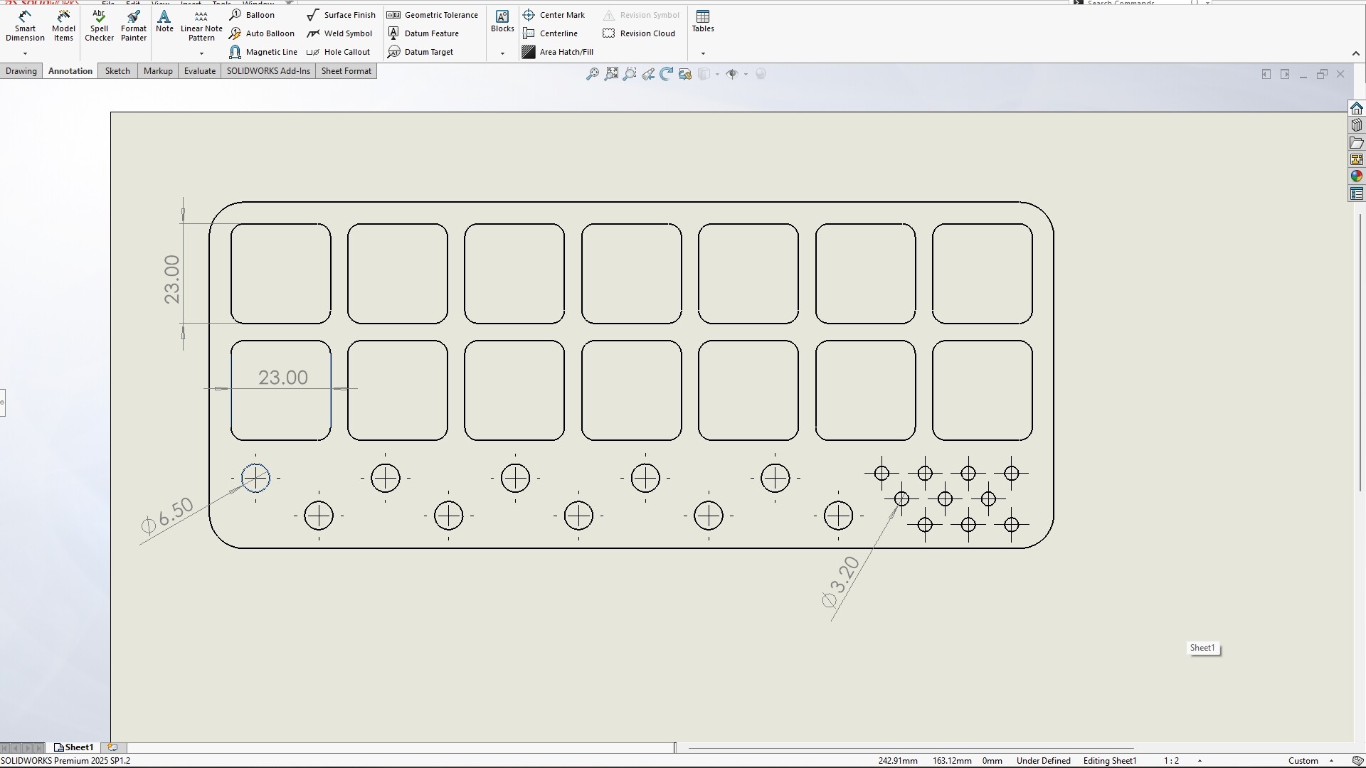

EDIT to add: This is the layout in the design software, with the desired dimensions.
Is there any way to accurately measure an object in EstlCAM? It all looks right, but I can’t tell if it’s 10% off size or night.
I’m also noticing that the square 23mm x 23mm pockets are cutting at 22.85mm, if that helps anyone with the troubleshooting. I swear it acts like the tool is undersized, right?
Do not do this please! Something goes wrong that thing can be on fire before you even know it in the camera and way too late for you to get to it to stop it.
That’s what insurance is for! :rofl:
Seriously, though, I run long laser engraving/cutting jobs and long 3D printing jobs remotely fairly often. There is absolutely an increased measure of risk involved.
However, the likelihood of something bad happening is less than the 100% chance of me suffering back and foot injury if I have to stay there and watch it cut a 2-hour project.
Thanks for the warning!
Insurance is there for accidents, not negligence.
Please do not run your machine unattended.

Deflection. Looseness in the core. Etc.
Use the grid (settings are at the bottom left corner)
0.15mm clearance is not very much. About the thickness of a post it note. In Wood products, that is never going to be enough. Plastic maybe, metal probably.
Are you using a full depth finishing pass, if not you 100% have to if you are trying to hold tolerances like that. In the case of a hole I would also do that finishing pass slower than normal.
Ok, I didn’t realize things were that ‘loose’ on the wood side of the house. lol I’ll adjust the design.
No, but I will! Thanks for the tips. :+1:
So I guess the bottom line is that this machine isn’t going to be all that accurate, and I need to allow for flex in my designs? I can work with that, I think.
