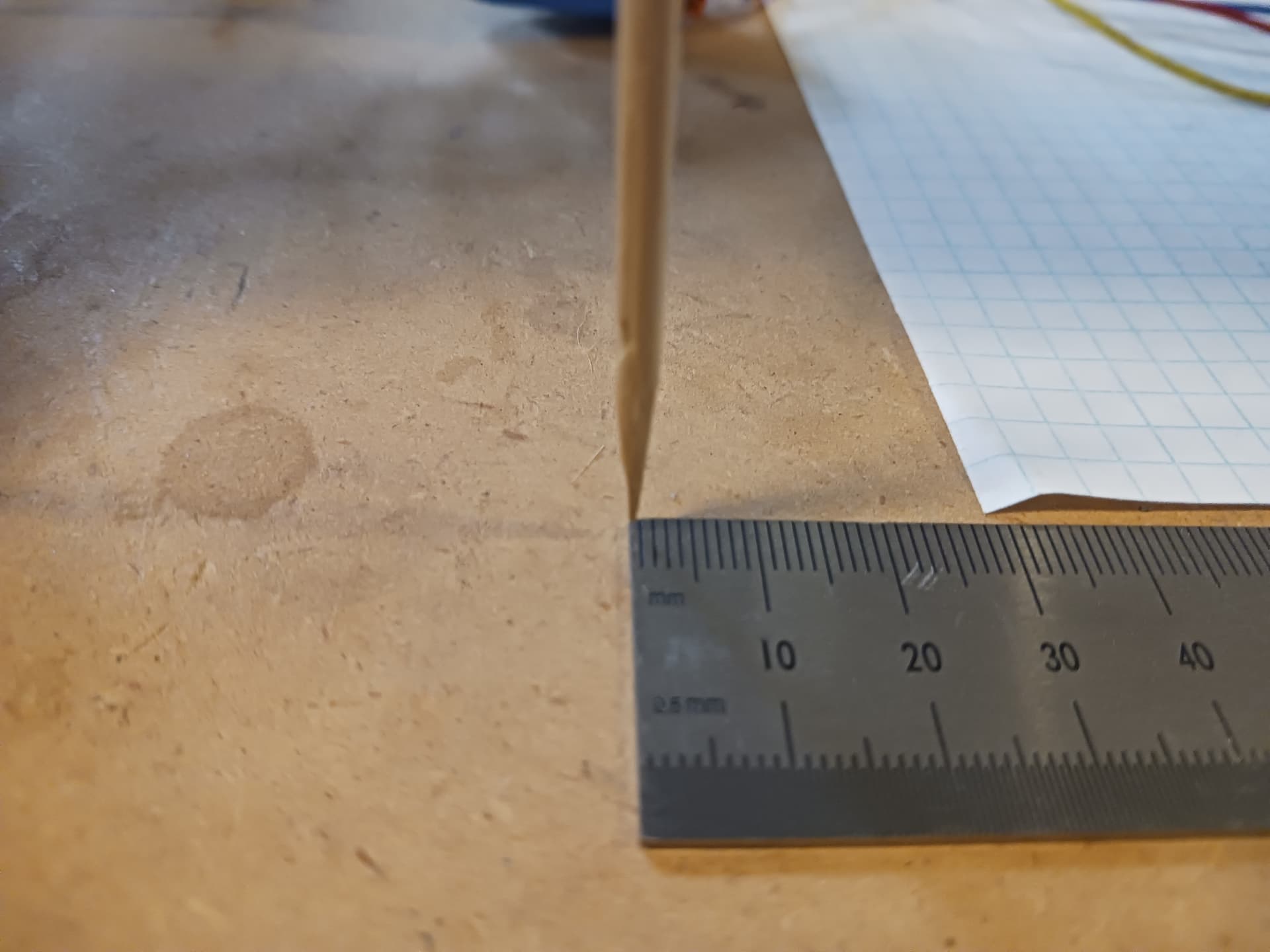

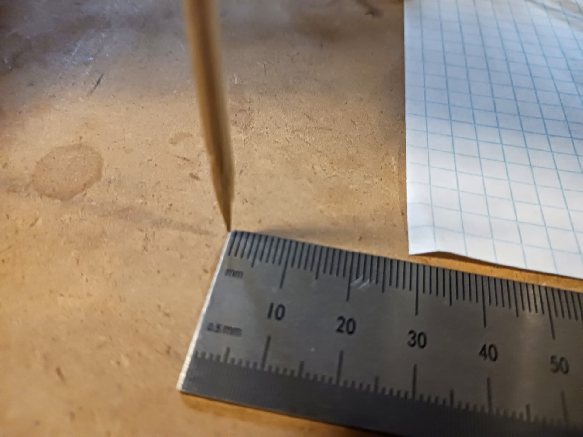

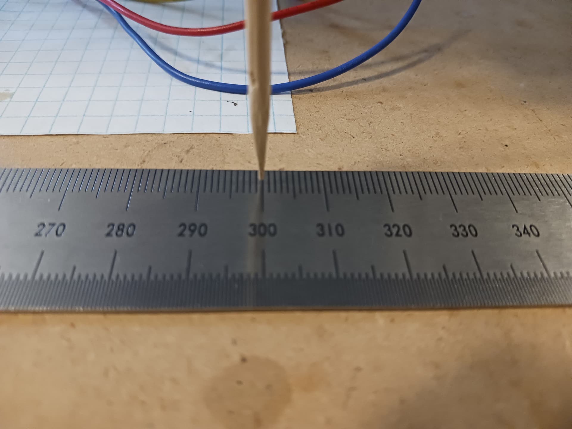

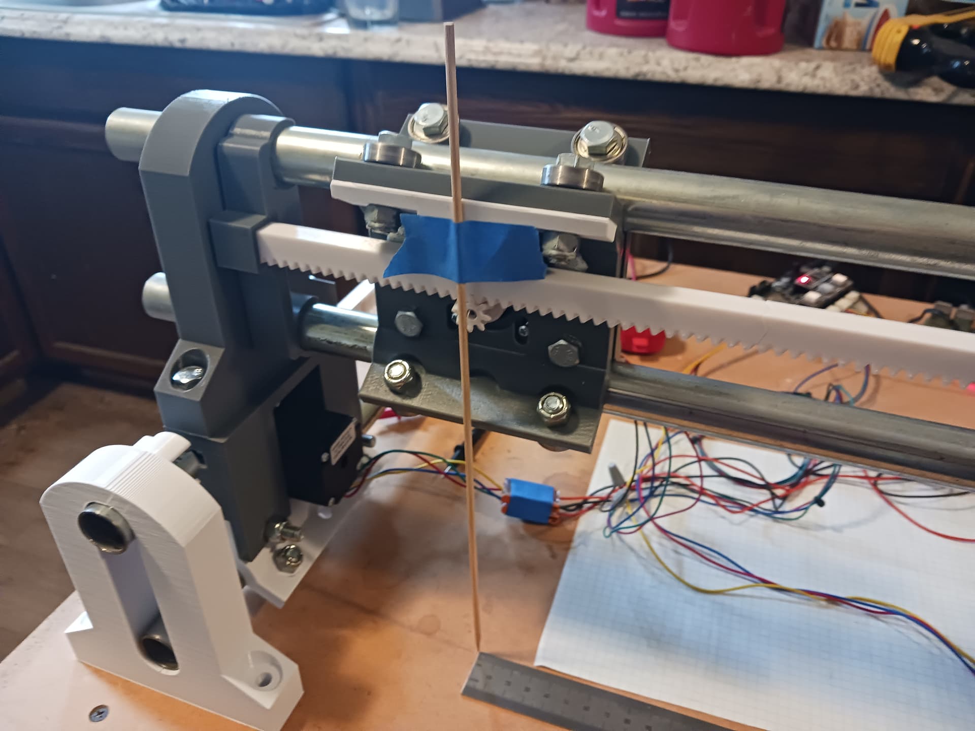

I did an initial calibration of the X-axis on this MPR&P (it’s growing on me…) machine. The Grbl 1.1h previously flashed into the Arduino Nano had 160 steps/mm for both $100 (X) and $101 (Y) settings. So using my “skewer method”…
I eyeballed the tip close to a metal ruler’s “0” and commanded a 300mm move… and it moved consistently to 314mm on the metal ruler. And using [(commanded/actual)*current_$100] I computed a new steps/mm setting of 152.8. Setting $100=152.8 and commanding the same 300mm move yielded…
which is certainly close enough for now. Since both the X and Y axis use the same rack and pinion setup, I set the Y steps/mm setting ($101) to the same 152.8 value… and trust it should be reasonably accurate as well. I test it for sure later.

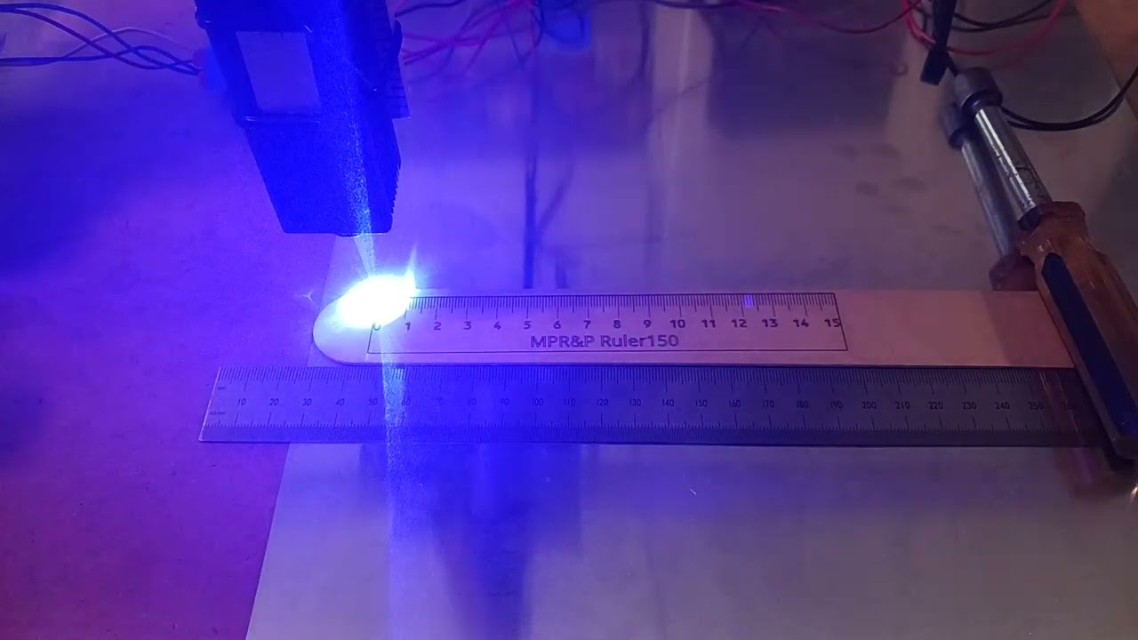

I then ran a laser gcode file that was handy… and air-milled it. It’s doing a series of hex figures in a grill pattern… 4 times around each hex figure. Sorry about the shaky video…

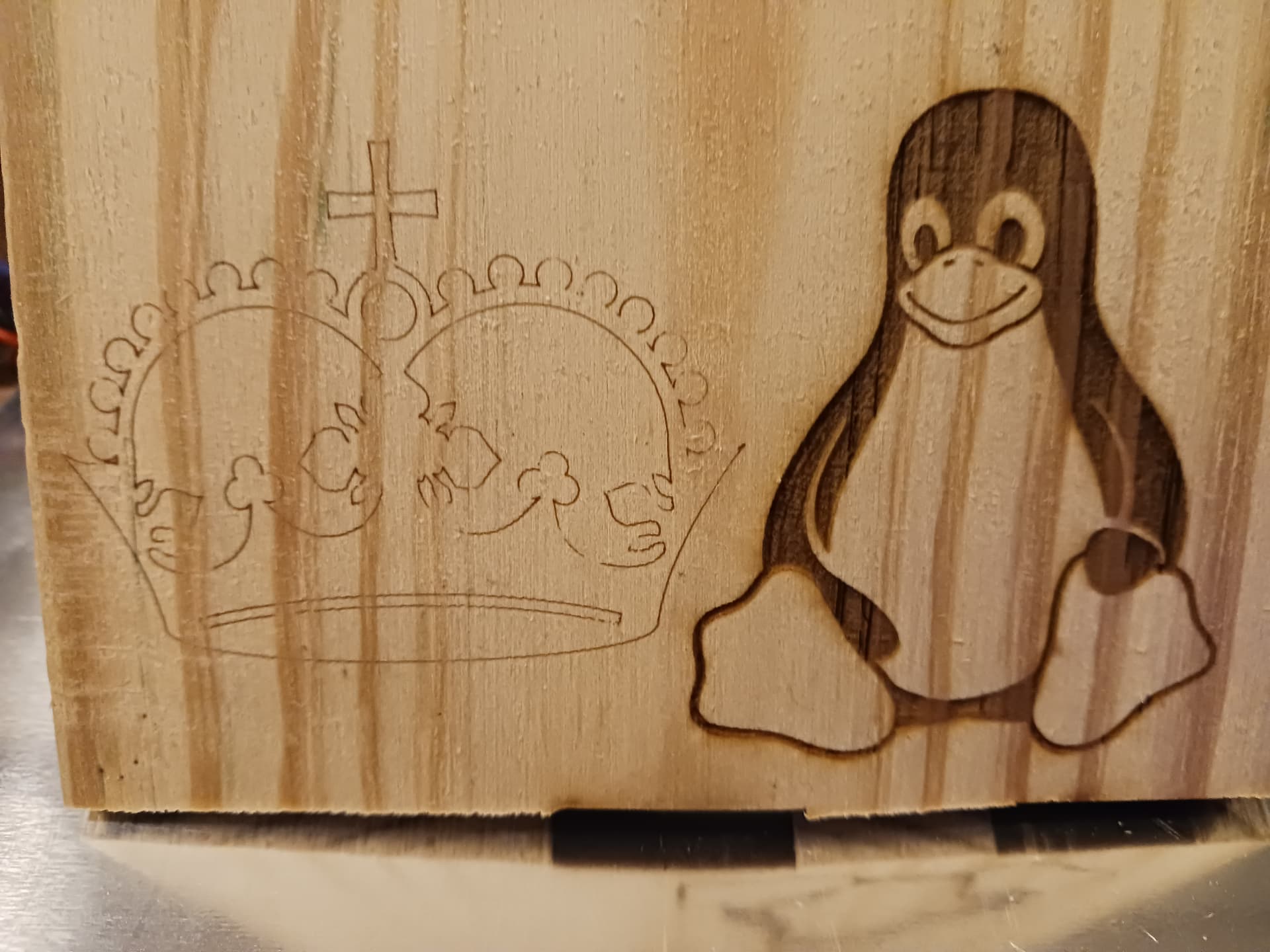

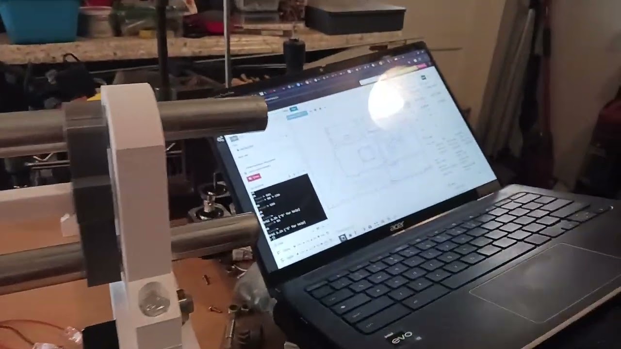

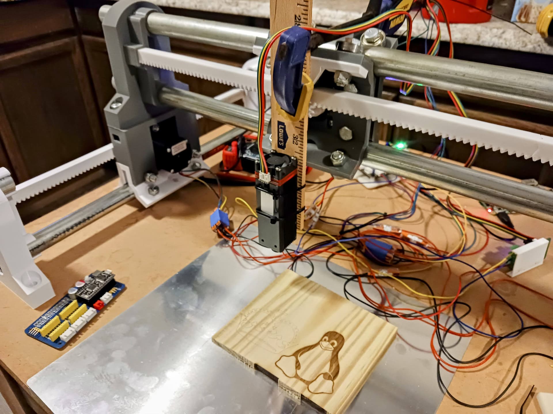

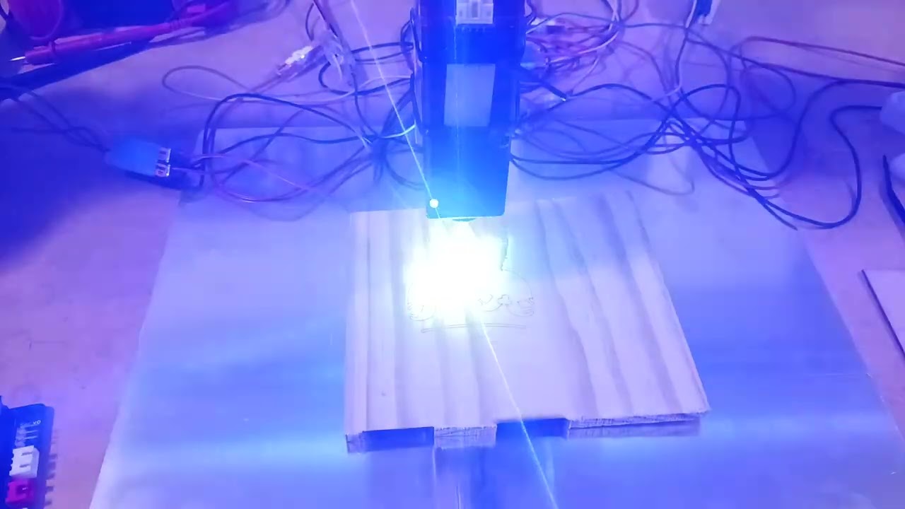

Between spinning my wheels all day, trying to come up with a R&P Z-axis design and fighting a balky Nano, I finally made a pretty decent first attempt to laser something…
with this crude setup…

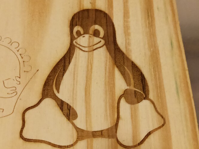

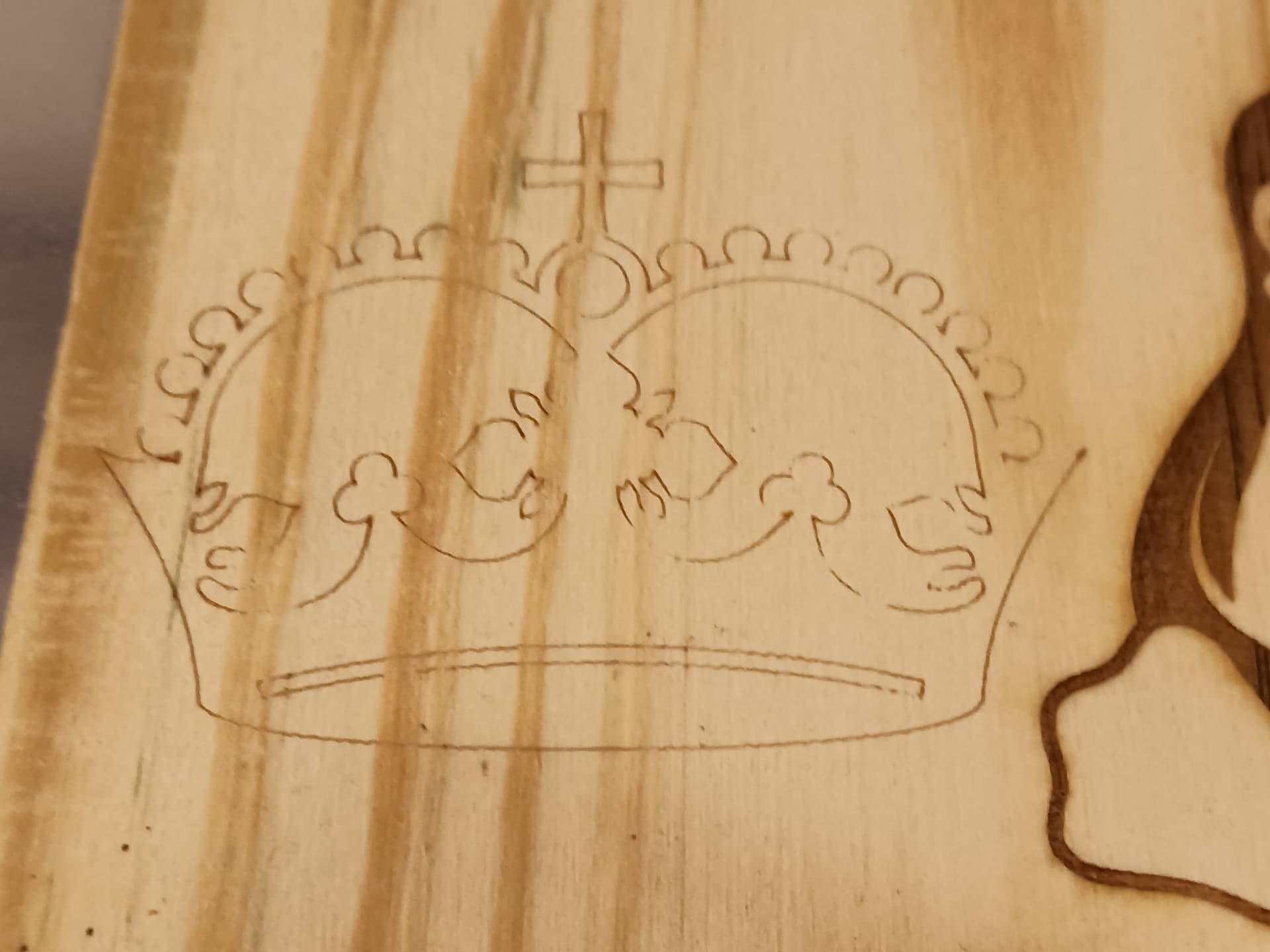

The video is actually the second crown I did… didn’t get the camera set up in time to catch the first. The first was accompanied by a welcome guest (a raster) that took about 15 minutes longer to laser than the crown. Here’s what the first run resulted in…
The crown was a vector image that took only a minute or so… and coulda used “more powa…” but that area of the wood was pretty inconsistent as well…

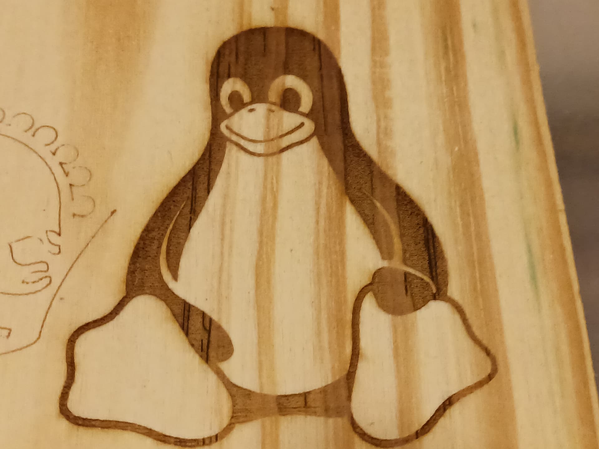

Tux was a raster image and came out much better…
The “balky laser” wouldn’t fire though everything else worked fine… and I dug around in my junkbox and finally came up with another Nano, already flashed with Grbl 1.1h to replace the Nano I had been using. Shock of shocks! Viola!
It made my day! Gonna take my time now with the Z-axis. Always helps to finish my day on a high/relaxed note; i.e. JD… or a silly crown!

within at least a quarter of a mm over 300 isn’t too bad for a first attempt!

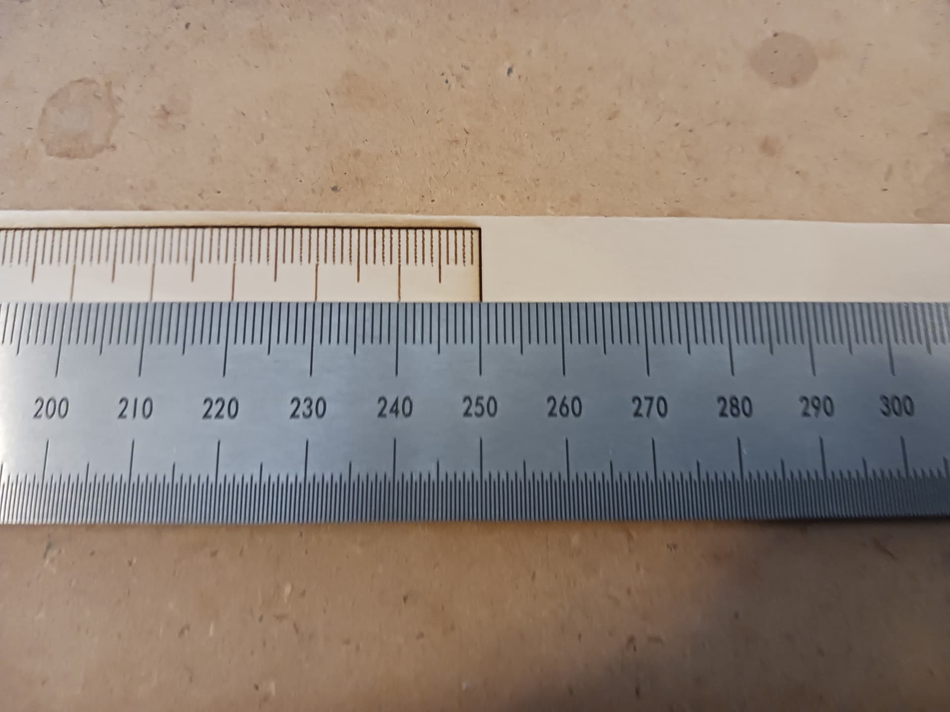

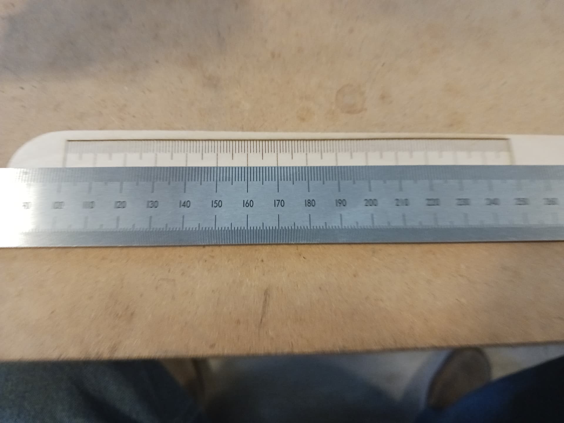

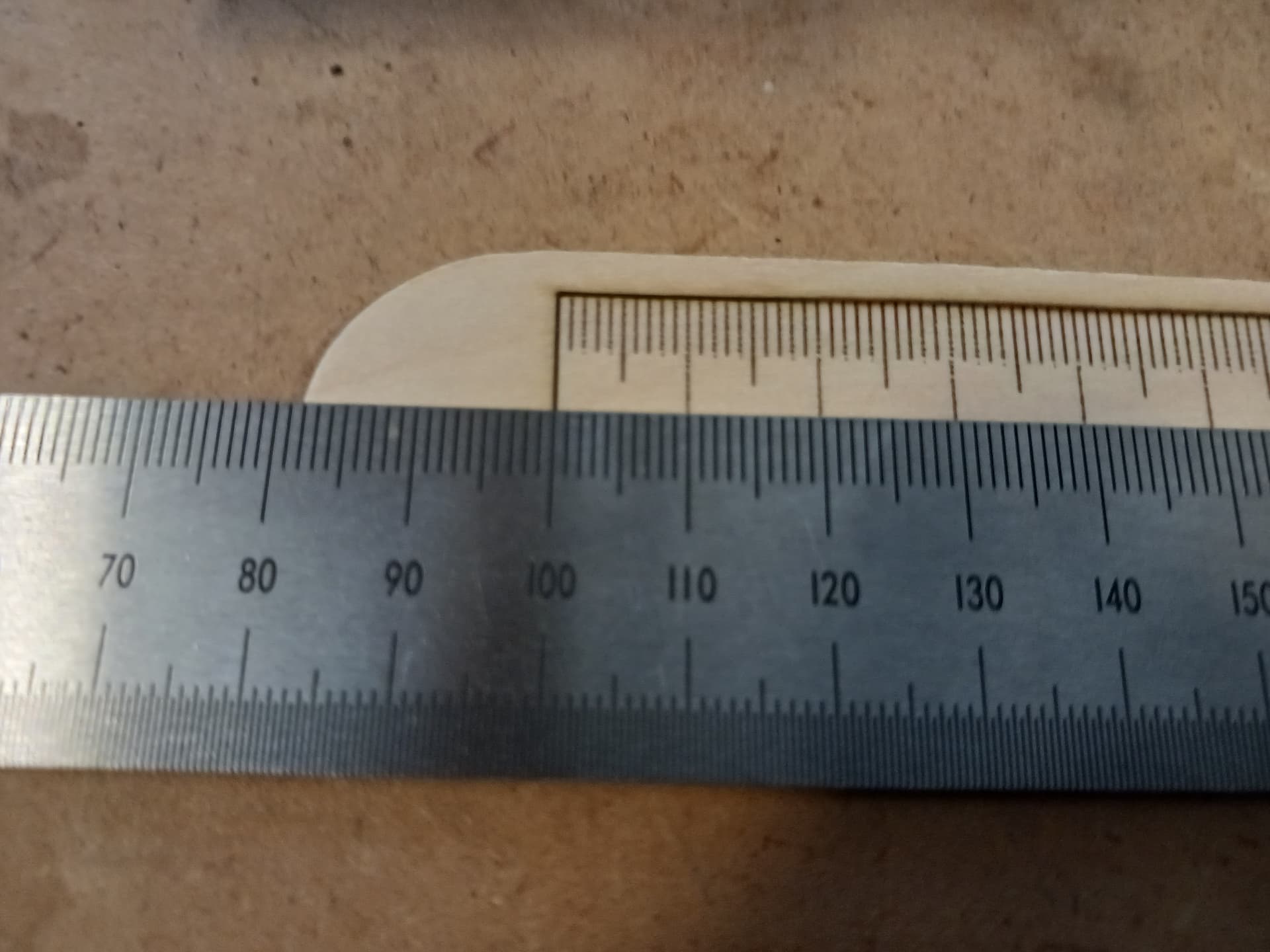

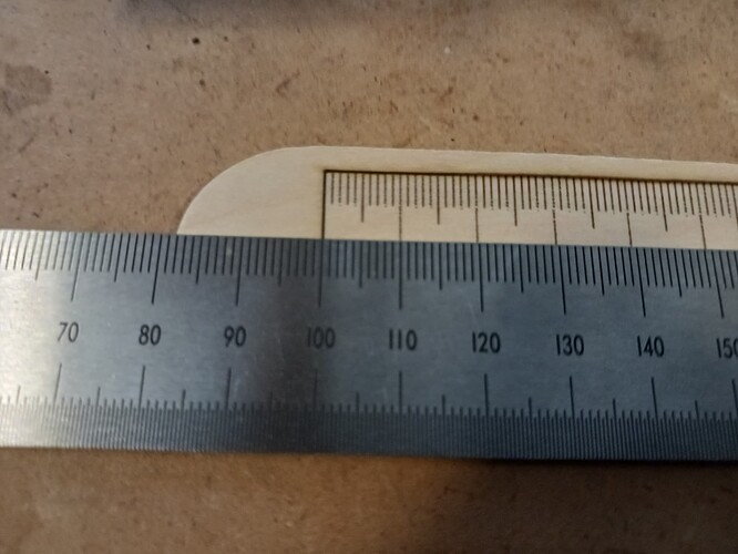

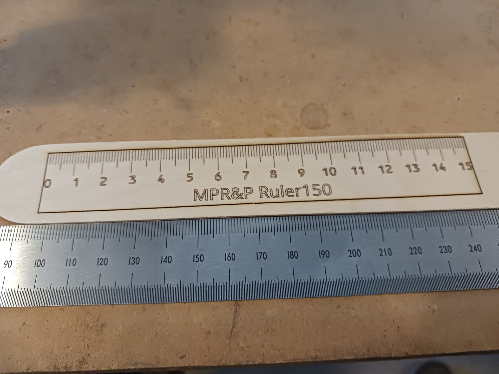

I refined the calibration of my X-axis by repeating the skewer method tests of yesterday. This time, however, I checked it over 450mm (rather than 300mm) and calculated a new steps/mm setting ($100) of 152.88 vs. the old 152.80. I set the new value and rechecked… looked good. I decided it was now time to engrave a ruler on craft stick…
Sadly, I only guessed at the settings for engraving and cutting a craft stick with the low-powered Neje laser I pulled out of my junkbox and it failed to cut out, even with 4 passes…
Ignore the parallax and focus on the center of the image to see reasonably decent alignment of the millimeter markings…
Ruler “0” at the 100mm mark on the commercial ruler…
and ruler “150” at the 250 mark.

Looks legit to me. Especially after multiple passes with the laser.

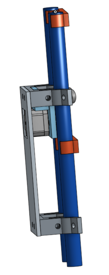

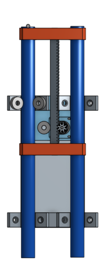

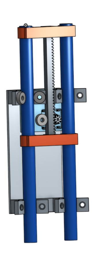

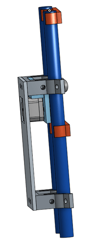

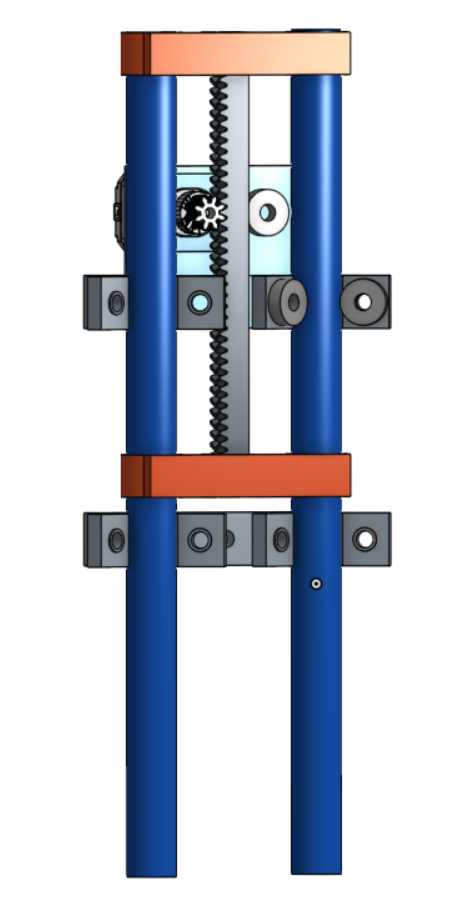

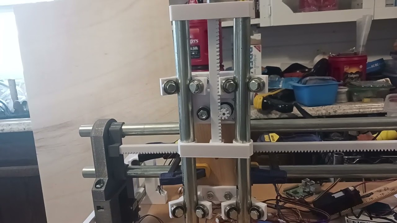

Here’s a first cut at a prototype Z-axis… but not entirely happy with it.
It runs up and down nice and smooth but is a little wider than I’d like. I need to cut a couple of pieces of conduit to to replace the ones shown. That will increase the range by another inch or so; i.e. 100mm plus vs the 80mm or so as shown in the video. Here’s a couple of assembly screenshots for the one in the video… again use your minds eye to supply the missing parts.
I’m also working on a second prototype – and printing parts right now – that is similar but fewer parts and more compact and no wider than the X-carriage.

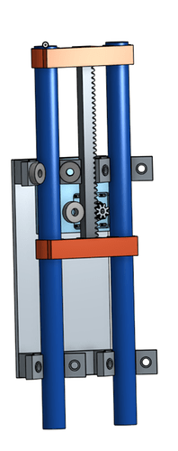

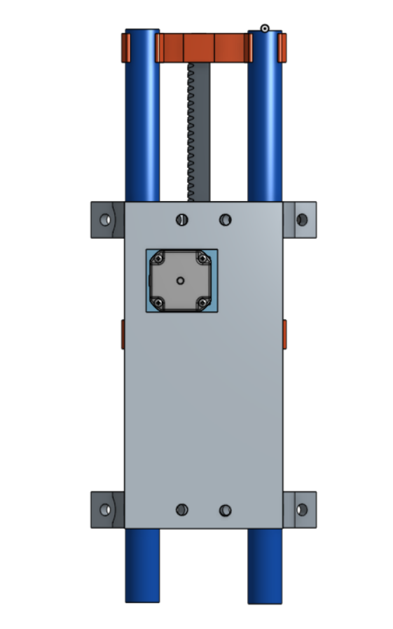

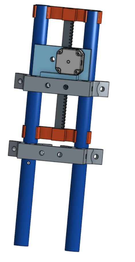

I repeated the Z-axis test of last evening after studying and reorienting the relative placement of the same parts on the assembly. I also laser cut a couple of iterations of the plywood backplate to mount and hold things together… and allow me to clamp the assembly in place on the X-carriage. The full range of motion is 100mm to ~120mm and feel that’s plenty for me…
Here are some screenshots of the “assembly”…
I’m self-taught pretty much on Onshape and I know I’m making lots of “rookie mistakes” so my documentation is really a mess. Rather that using Onshape’s actual Assembly functionality… I seem to do better “assembling” all the parts in one Part Studio… which is where I can make sketches (rarely fully defined… :worried:) and design/print parts with relative position of mating parts in the same document. I’m not sure when the actual Assembly documents are supposed to come into play… after all the design work is done? Oh, well…
