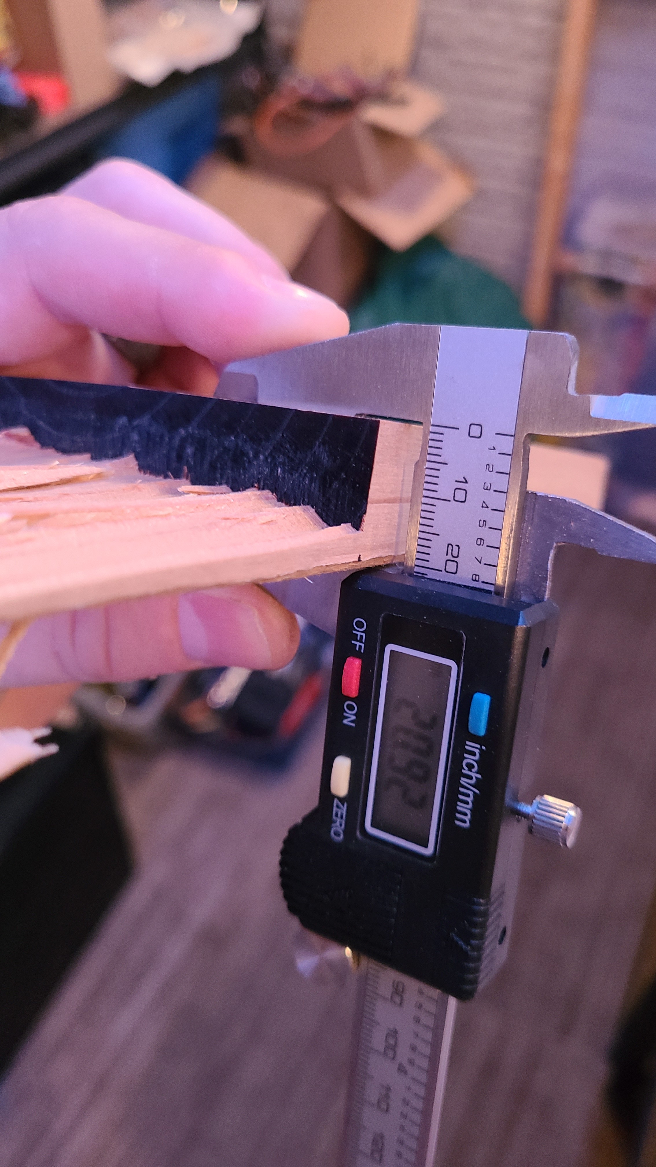

More tests from laserland. Apparently if it’s not plywood, you can cut a lot thicker.

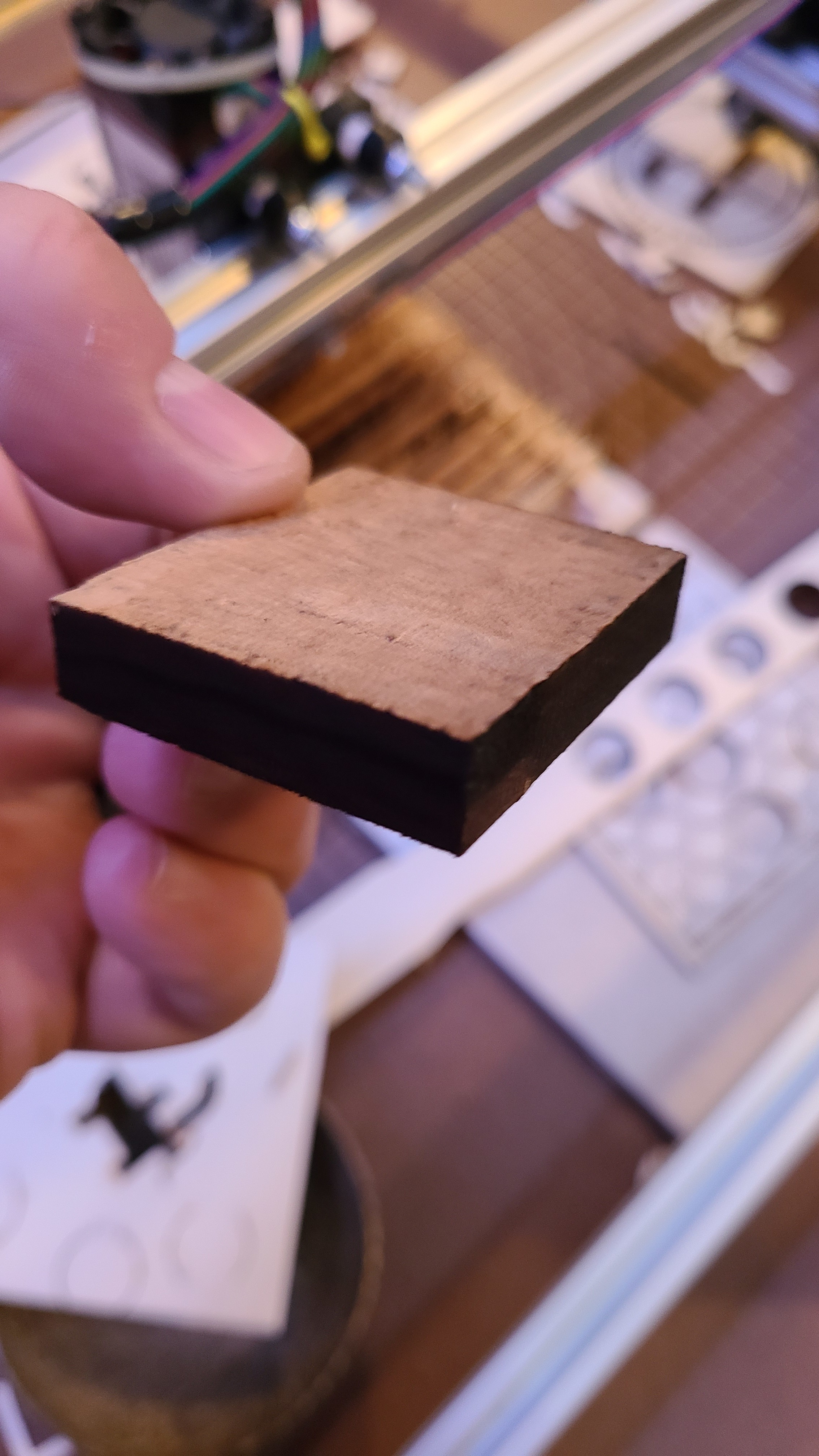

This is pallet wood I was collecting for a feature wall project that ended up being done with Pergo. I figured I’d give it a try to see how deep it would cut. Well, 100mm/min, 100% pew, 3 passes, goes all the way through. Cross-cut and rip.

Just thought I’d run another test with no over cut.
It’s really amazing how much can be done with this caliber of laser.

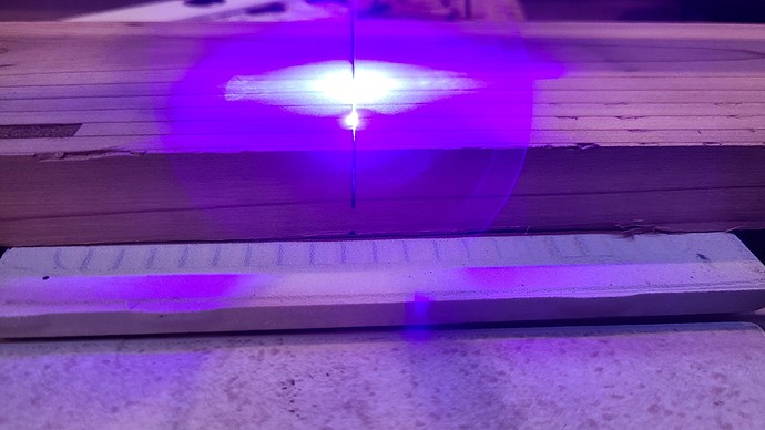

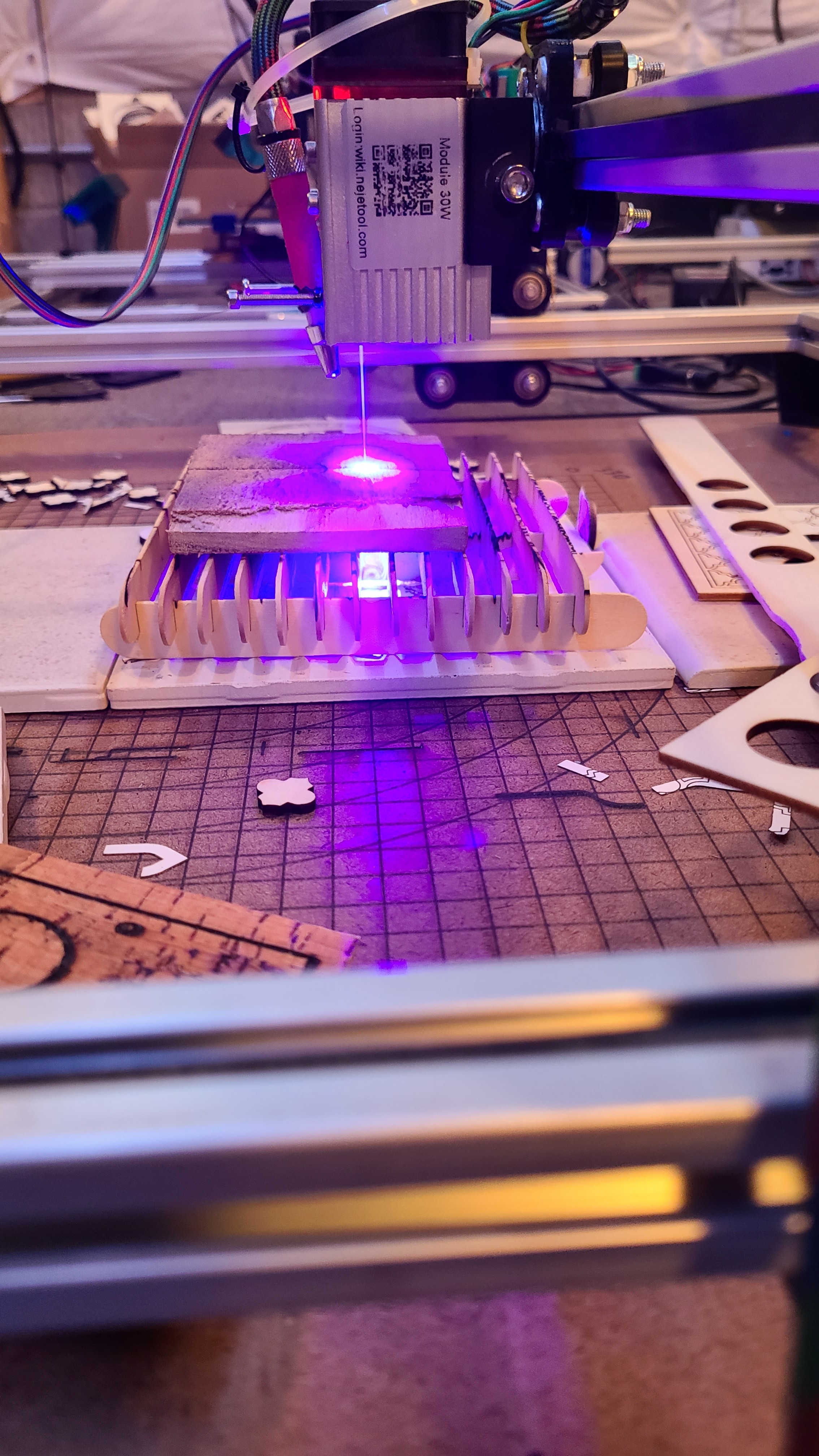

Feeling adventurous I tried a piece of ~3/4" cedar leftover from a fence project.
After 1st pass, nearly halfway through.

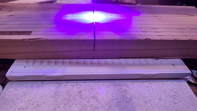

After 3 passes.
After 5 passes, on its way back on pass 6, which produced no marked improvement.

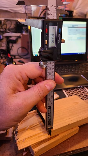

Board depth with cross section.
Deepest part after 6 passes.
So I’m pretty sure if I had a Z, it would go all the way through. I think I might need to put it back on the Primo for further testing.
Well that is impressive as heck. I would have bet all sorts of cash against that going that far. Now you have to add a Z!!!
At some point the focal cone will get in the way, so try to adjust it so the focal point is as far away as possible to keep it narrow.
