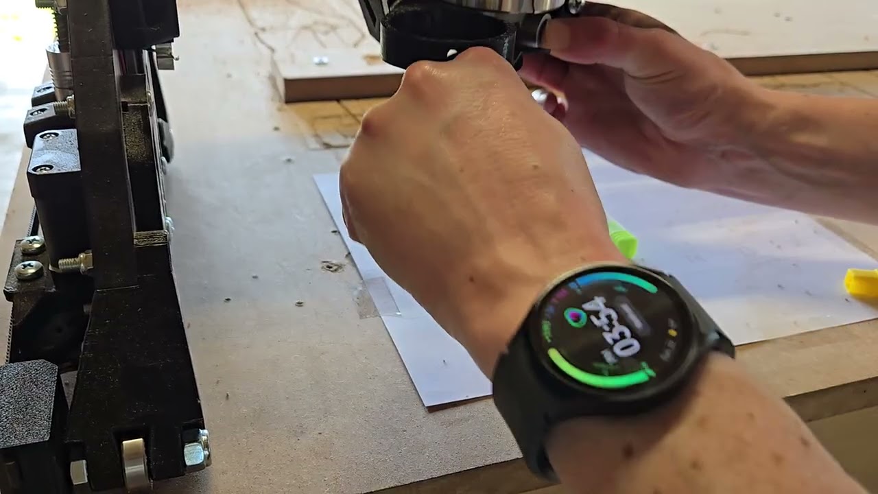

@jeyeager I’m not sure what’s going on here. This all made sense to me before and the math looked right, but it seems that when my 2nd tool gets put on and the NewZZero is determined, it is off by about the thickness of my ‘probe plate’ (aka large washer). it comes down and thinks the z0 spot is now higher than it really is.
Here is a very heavily edits gcode that I’m using to test (all the ‘cutting’ moves have been taken out).
test_patc.gcode (3.1 KB)
Did I miss something from your original code?
Not sure about the specifics of your situation, but in general, for any probing, you don’t want to set Z=0, you want to set Z= (probe thickness).
Not sure. My touchplate is also only half a mm thick so I might not have noticed if it was off.
Bartman - yes, I agree. My terminology may not be 100% correct :wink:
Jason, I did a test with using a thicker probe and I saw the delta was bigger.
So I am just going to subtract the probe thickness from the # variable.
#<NewZZero> = [#<ProbeZOriginal> + [#<ProbeZOffsetNew> - probe_thickness]]
where probe_thickness = the measured thickness of the probe you use (or the value used with the G38.2 statements)
After testing this, it worked for me and it looks like the 2nd tool comes down to the proper spot.
(your comment about the thickness of the probe you use made me think about using a much thicker probe because then it would be very obvious by looking at how far off it was.)
Anyone willing to post a video showing this in action? I am interested in seeing how this works in reality.
This is a not great video I recorded a couple months ago. I think it gets the idea across.
