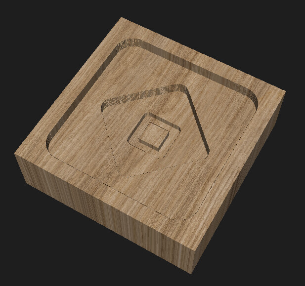

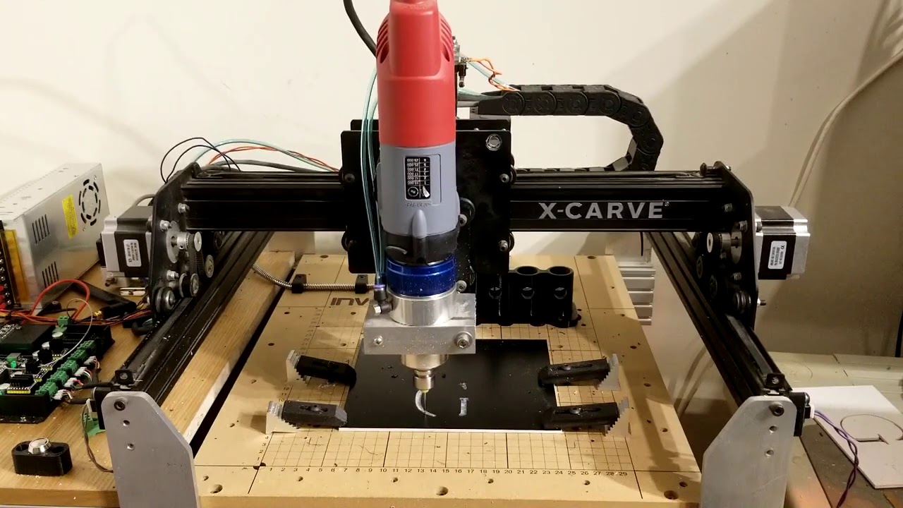

I’m making progress. I created a simple test design that uses 3 tools. I manually updated the gcode to change the start and tool change gcode. I can get it to move to the appropriate tool specific change locations and probe and such. I haven’t cut it out yet since I didn’t incorporate the Z offsets yet. I think I have the logic figured out.
The Z offset part is something like this:
  1. Probe Z on the fake magazine (piece of paper). Store the Z offset (example -68.885).
  2. Probe Z on the workpiece (this is the only time it is probed here). Store the Z offset (example -49.350). Since the probing sets Z0, it’s good to continue.
  3. Change the tool (I just pulled the same bit out further). Probe Z and store the Z offset (example -63.705 - so it’s sticking out an extra 5.18mm). Since this changed Z0, we need to get Z0 back to the top of the workpiece.
  4. Take the Z offset from step 2 minus the Z offset from step 1 (example 19.535). This is the difference between the top of the workpiece and the probe location. Since my probe location is a piece of paper on the spoilboard, it’s basically the stock thickness.
  5. Take the Z offset from step 3 minus the Z offset from step 1 (example -5.18). This is the difference in bit length.
  6. Take step 4 plus step 5 (example 14.355).
  7. Move to the Z position from step 6. This is the top of the workpiece with the new bit.
  8. Zero Z at that point.

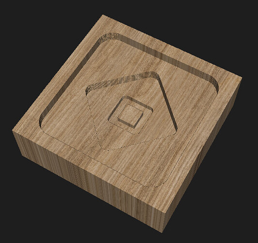

My test design is wildly inefficient for but good for testing. It’s 30mm square. The large square is a 2mm deep pocket done with a 6mm endmill. The diamond is a 4mm deep pocket with a 3mm endmill. And the middle square is a 5mm deep profile with a 1.5mm endmill. That should adequately test that I got the Z offset right. Ignoring probing and tool changes, it’s supposed to take 36 seconds.

I got this figured out. I successfully made my test cut. It moved to the proper positions for each tool change and set Z after each tool change without re-probing on the workpiece. Too many iterations so I didn’t get a video yet.
I had a hard time figuring out how to set Z after a tool change. I apparently still don’t understand how offsets work. G38.2 sets an offset, then there’s G92 which is an offset on an offset, and then there’s G10 to set it right in G54. At first, I was trying to use G92 offsets for Z but when you already have a G54 offset set by the G38.2 (I think), then you have an offset on an offset and that confused me. I was cutting too deep. So, I skipped the G92. Then I was trying to use G10 with a non-zero value and messed that up so I was air cutting. Eventually, I calculated the new Z0 in machine coordinates, moved there in G53, and set Z0 with G10 L20 P0 Z0. I’m still getting G10 L20 and G10 L2 confused.
I’m sure there’s a better way to do that, but that’s what managed to work in my head and in reality.
Now I just need to clean it up and sort out setting the starting and tool change gcode in CAM. It’s not an issue in Estlcam but in Millmage it wants to do the same tool change gcode at the start and for tool changes (and it doesn’t like fancy gcode that could solve that problem).
I also need to make something new to test. This was tiny and in MDF without finishing passes so the result is pretty ugly. Also, tool changes that require changing the collet are really annoying. I’m going to avoid that in the future.
