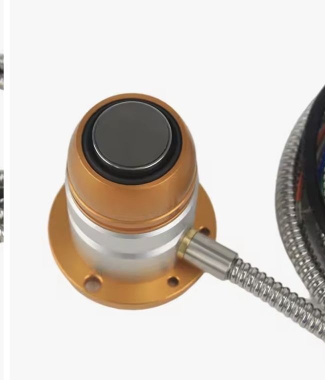

ATCs also have a tool setter to automatically set the height after a tool change. FluidNC supports this for manual tool changes without an ATC through an “atc_manual” configuration. However, I don’t want to use a bit setter because I don’t want to run a wire from it to the controller. Also, then I can’t use the M6 macros I need to do the other ridiculous things I’m getting to.

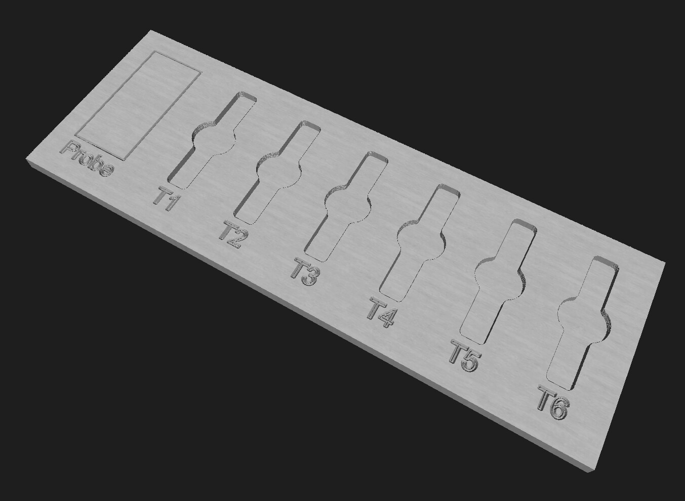

Well, here’s a concept of a pretend ATC magazine that I whipped up in MillMage:
Picture that in your spoilboard. It would go something like this:
  1. Place the tools as defined in CAM in their appropriate slots.
  2. Run the job.
  3. For now, let’s assume we installed the first tool T1 and probed to set Z. I haven’t sorted out the starting tool details in my head yet.
  4. Run the job.
  5. It gets to a tool change and calls M6 T2. That triggers the M6 macro to run. It does the following:
  • Stores the current position
  • It sees that we haven’t gotten an offset for the “probe” section in the pretend magazine yet, so it moves to the probe position and pauses. You attach the probe and resume. You probe and it pauses. You remove the probe. This won’t be necessary for any more tool changes.
  • Moves to the position in the pretend ATC magazine for T1 (currently empty) and pauses
  • You remove the tool, put it back in the slot, and resume. (In the spirit of the LR3 instructions, you should make robot noises while doing this)
  • It moves to the position of the tool it needs to change to and pauses
  • You add the new tool and resume (more robot noises)
  • It moves to the probe section and pauses.
  • You attach the probe and resume.
  • You probe and it pauses. It figures out the new Z based on the offset it figured out for the first tool.
  • You remove the probe and resume.
  • It moves back to the stored position and continues.
The idea here is that it should be intuitive. If it moves to an empty tool slot, it wants you to remove the current tool. If it moves to a non-empty tool slot, it wants you to add that tool. If it moves to the probe position, it wants you to probe.

I think that this is a really cool idea.
Is the ATC magazine something that would be permanently mounted/carved on the spoilboard or would it be a plate that would be placed depending on the job?
Robot noises just makes stuff work better.
I was thinking it would be permanent. I suppose you could remove it and add it as needed. Whether it’s carved into the spoilboard or a plate of some kind wouldn’t really matter. It would be important that whenever it is used, it goes in the same position but doesn’t have to be super precise. It would have to be based on machine coordinates so zeroing XY doesn’t break it.

What if we had a tap pad for the fake ATC that was wired so it doesnt require a clip on the bit? Im thinking a springboard the bit can press so no clamps required. Hasn’t someone already made one of these?
Yea, those are the tool length setters I mentioned before. I just don’t want to run the wire but that’s definitely an option.
I’d splice the wire to the z plate
I wonder if you could wire that to an IR emitter and put a small sensor on the core. Touches, emits IR, endstop triggers. Would be interesting to see if the precision could be good enough.
I’ve seen some people wire up the touch probe so there’s a jack or something on the core to plug it into. I wonder if something like that could be setup so you drive the core into something to connect it, probe, and then put it back. Something with magnets probably.

I literally printed out my pretend magazine on paper for testing this out. The current size is 260x100 mm (about 10x4 in). Only about 30mm of Y needs to be in the working area.
