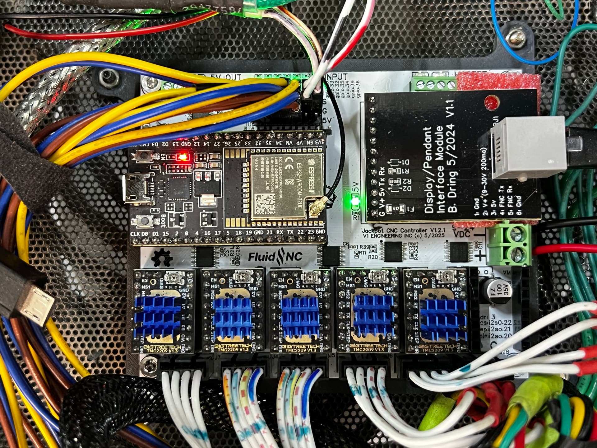

With 24v Power Only coming to the 9-24vdc connector (VMOT) and NO USB cable connected to the ESP32
this is a photo of the board:
The machine behaves normally and all Fluid NC and FluidDial functions are working properly.

One other possibility is that these stepper drivers are new and came with the V1.2.1 board and I left the OLD stepper drivers on the Old board.
Wondering if for some reason the NEW ESP32 is not getting enough volts to make the USB port create the COM link with a data only USB cable. <<<Is there a way to check this with a multimeter to see if there is a difference between the Old V1 board and the new V1.2.2 board?
The only difference between the two boards is a resistor on gpio.0. That makes flashing work better.

That’s pretty unlikely. There is a 5V voltage regulator on the jackpot which is adequately sized for this application.
You can measure 5V on the ESP32, and also the 3V3 on the ESP32.
They are clearly marked on the silkscreen of the ESP32.

  2. I checked the voltage on the new v1.2.1 board with the new ESP32 (remote antenna)
4.86 volts at the 5V pin
3.28 volts at the 3.3 V pin
