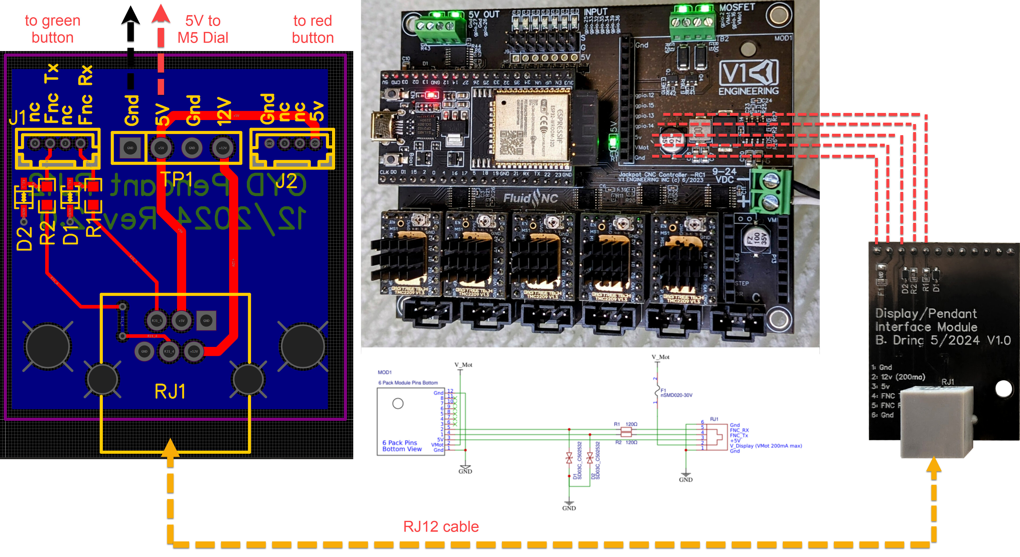

Power to ESP32 from USB
I believe (If I read the wiring diagrams for the Fluid Dial correctly) that the M5 dial is only getting 5V
Although there is Vmot present in the wiring diagram.
But I used the Ground and 5V connections on the FluidDial RJ12 Adapter to connect to the M5 so that is why I’m certain that it’s only using the 5V
RE:
5v Leakage with the Prox Sensors. I’m gonna go with the old adage
“If it ain’t broke, don’t fix it”
Here is a link to the USB Power Blocker Dongle:
Power Blocker
