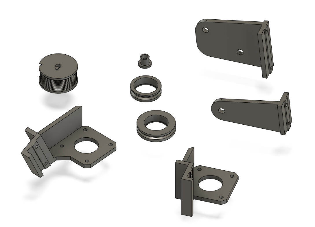

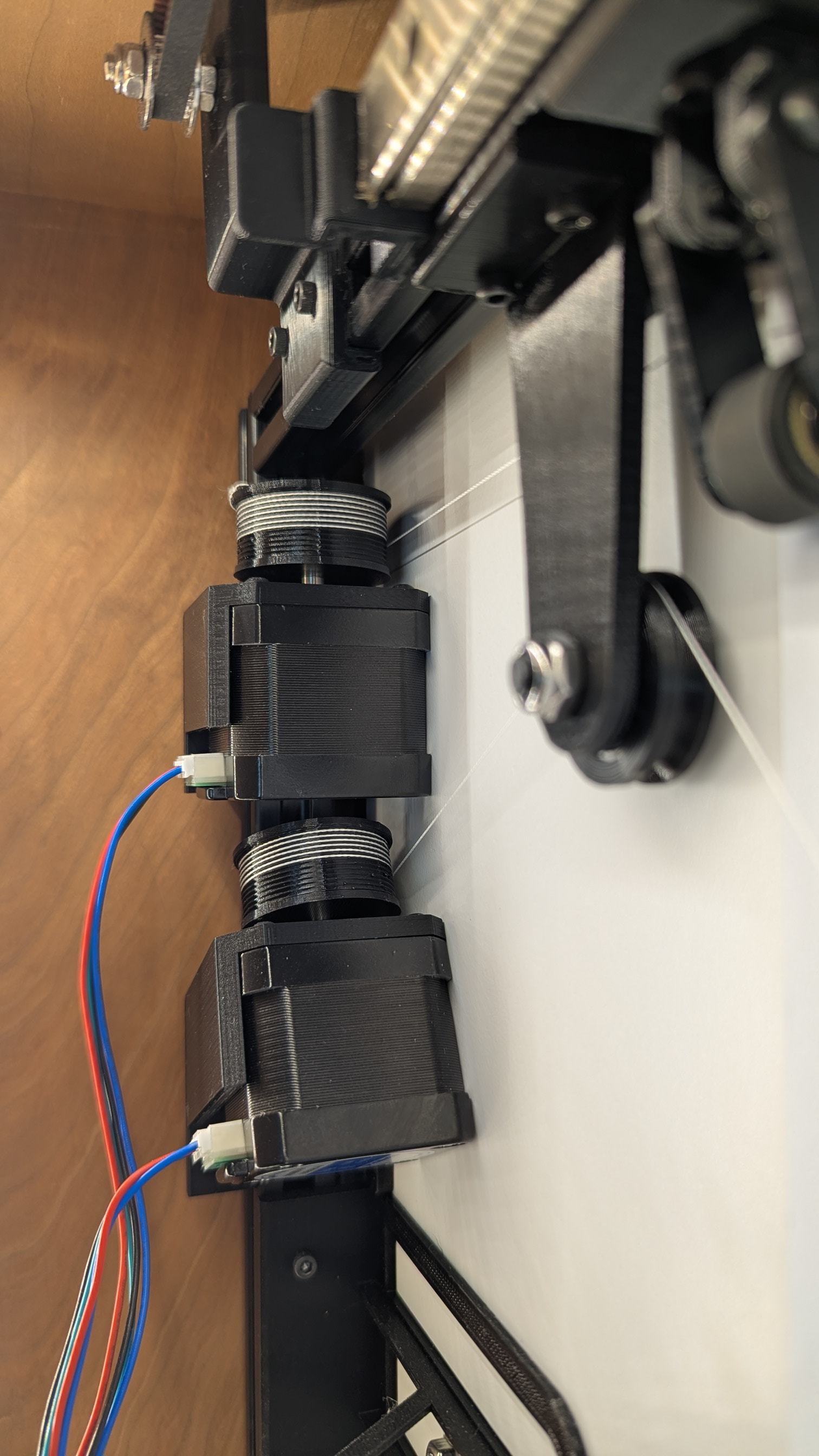

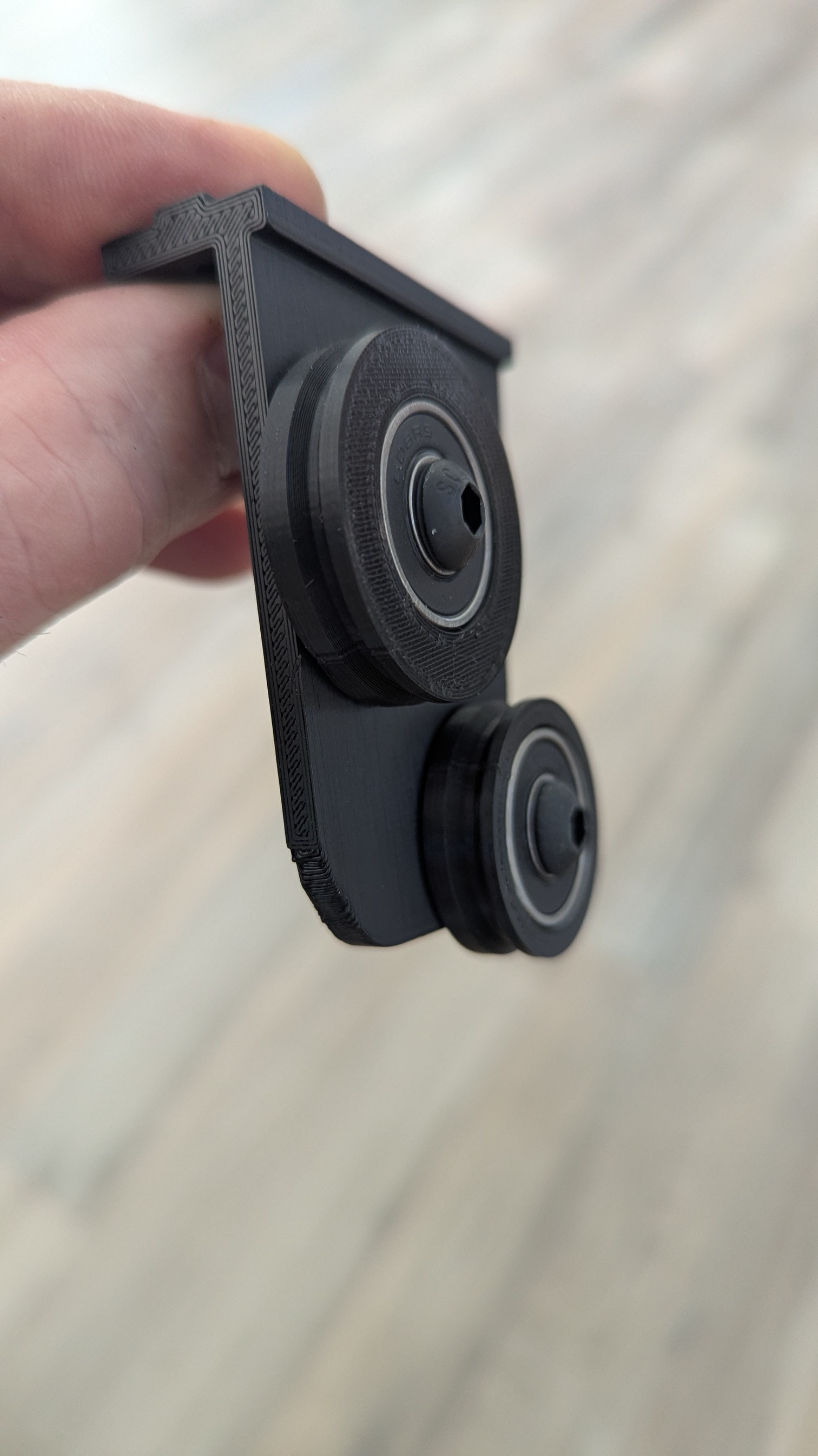

Build - Part I
Pulleys and Motor mounts
3d Models:
Here are the STL files:
frame_models.zip (364.6 KB)
Notes:
  • I used 40lb braided fishing line for the string because it has little to no stretch. The pulleys are designed to use 8mm ID x 22mm OD x 7mm bearings and M6 x 20 button head socket cap screws with lock nuts.
  • See pics for assembly and mounting. Take a close look at the pulley orientation. There is a back and a front to the wheels and the bushing needs to be inserted correctly as well.

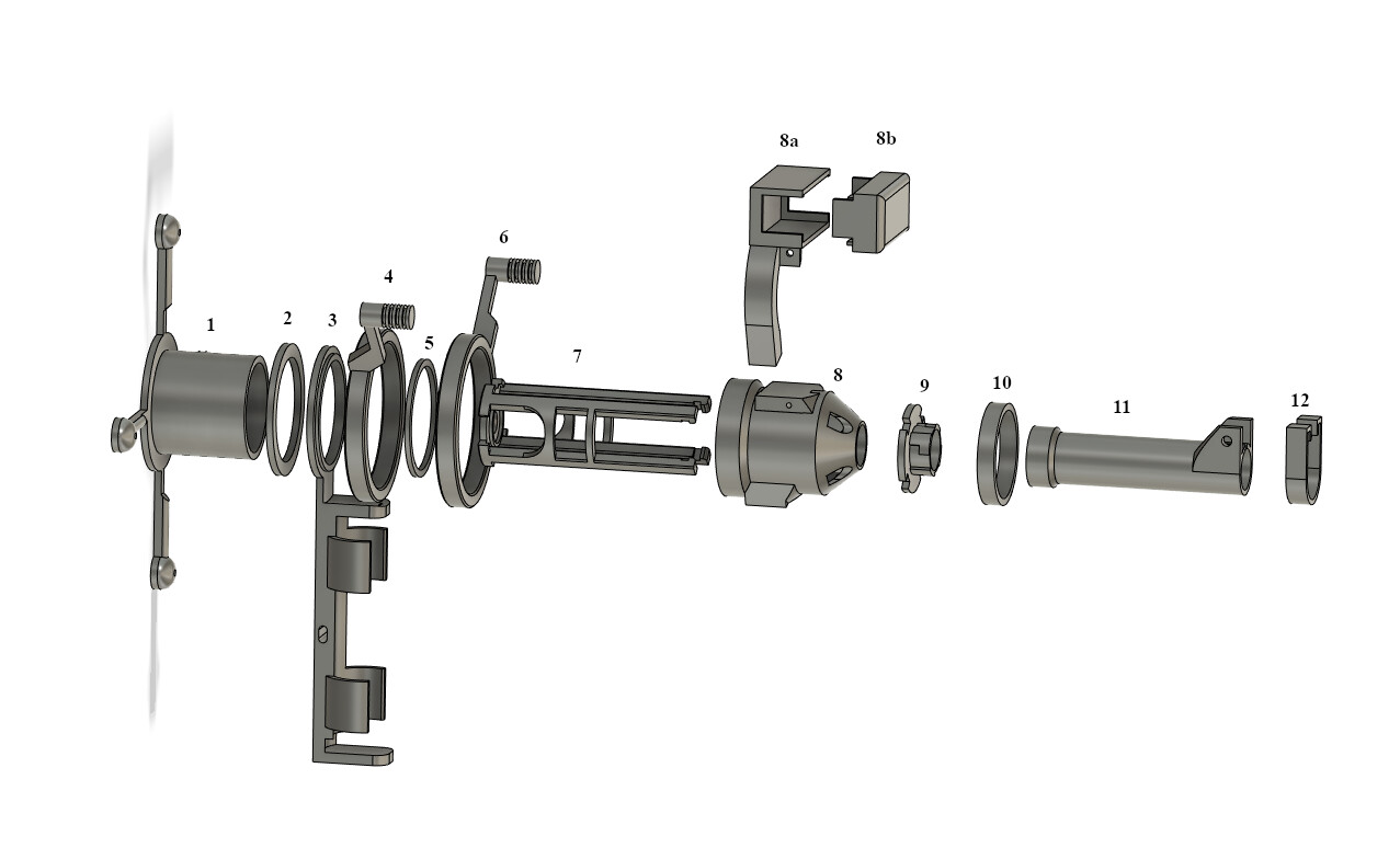

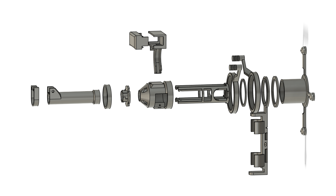

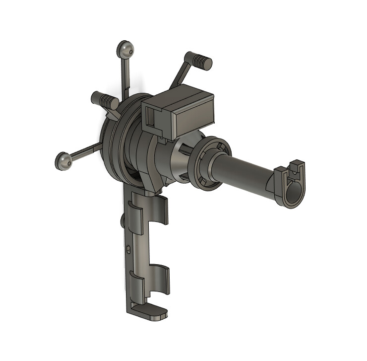

Gondola
3d Models:
gondola_models.zip (452.6 KB)
Notes:
  • I print the gondola spider (1) at the highest quality. I find that the nylon bearing balls rotate better in their sockets at this setting.
  • The gondola_cone (8) will likely be oriented upside down when added to your 3d printer’s build plate. I recommend printing it in that orientation using a brim for adhesion.
  • Missing from the pictures above are four 1/4" Nylon bearing balls, two 30mm ID x 42mm OD x 7mm bearings, a 40mm x 16mm x .7mm spring, two 1mm bearings, and pen pressure lever. The optional pen lift components are a battery, a servo and the rf circuit. I will address these in a later post.
  • Even if you aren’t going with the pen lift, you should still include the battery holder and a battery or weight equivalent for ballast.
  • The four nylon bearing balls get pressed into the feet of the spider (1).
  • The 30mm x 42mm bearings are pressed into the parts 4 and 6.
  • There are two versions of part #7 (gondola_spring_arms) in the models zip. One is for a Pigma Micron pen, and the other is for an Expo fine tip dry erase marker. The spring must be inserted into the gondola_spring_arms before it is inserted into the gondola_cone.
  • Pay close attention to the orientation of the gondola_spring_arms (7) in relation to the gondola_cone (8) during assembly.
  • I will try to create a quick video of the assembly process when I get a chance.

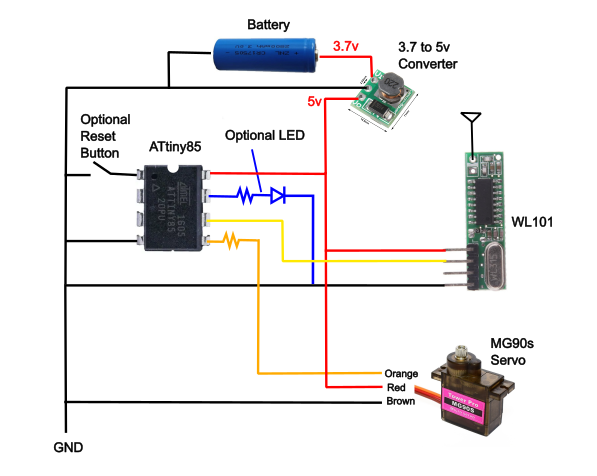

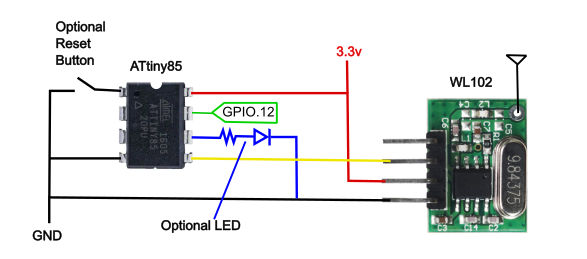

Pen Lifter Circuits
Transmitter (Jackpot Expansion Port)
Notes:
  • The WL102 uses 3.3v logic level on its DAT pin, as does the ESP-32 (GPIO.12) so we stick with that. The Jackpot Expansion port only has a 5v option, so you either need a 3.3v regulator or if you have a JP1, it is fairly easy to run a trace wire from the 3.3v output of the ESP-32 over to one of the unused pins on the expansion port. The circuit doesn’t draw much current, so the regulator on the ESP can handle it.
  • I included an optional led that indicates PEN UP when lit. As shown, it is driven from a GPIO which will work but isn’t the best way to do it. I recommend driving the LED with a transistor if you have one. A 330 ohm resistor should be in the ballpark for whatever color LED you have.
  • In an earlier picture, I show a transmitter plugged directly into the expansion port but I was unable to get that to work with any of the cheapo transmitter/receiver combos I had laying around so an ATtiny was necessary to make it work. You could of course use just about any microcontroller. I wanted the smallest one I could find for the receiver on the gondola and the ATtiny fit the bill, so I used the same on the transmitter.
  • Note that you will need a way to program the ATtiny. I used a clone of the Sparkfun Tiny AVR Programmer.
  • The antenna on the WL102 is optional. More discussion on that below.
Receiver (Gondola)
Notes:
  • The servo needs (likes) 5v, as does the WL101 receiver, so we use 5v logic levels on the gondola. The battery I chose was 3.7v, so we need a converter. All these parts are available on Amazon.
  • I use a 1.8K ohm resistor with the LED on this circuit due to the higher voltage.
  • A 1K ohm resistor is used on the servo signal line (orange) to protect the ATtiny from glitches in the servo’s internal circuitry.

    vw_set_rx_pin(RCV_PIN);
    vw_set_ptt_pin(255);  //originally: vw_set_ptt_inverted(true);
    vw_setup(4000);
    vw_rx_start();
void loop() {
    uint8_t buf[VW_MAX_MESSAGE_LEN];
    uint8_t buflen = VW_MAX_MESSAGE_LEN;
    // Update only when a new message arrives
    if (vw_get_message(buf, &buflen)) {
        if (buf[0] == '1') penUp = true;
        else if (buf[0] == '0') penUp = false;
    // OPTIONAL LED indicator
    digitalWrite(LED_PIN, penUp ? HIGH : LOW);
    // Determine target pulse
    uint16_t targetPulse = penUp ? PULSE_UP : PULSE_DOWN;
    // Smooth ramping
    if (currentPulse < targetPulse) {
        currentPulse += stepSizeFast;
        if (currentPulse > targetPulse) currentPulse = targetPulse;
    } else if (currentPulse > targetPulse) {
        currentPulse -= stepSizeSlow;
        if (currentPulse < targetPulse) currentPulse = targetPulse;
    // --- INTERRUPT-SAFE SERVO PULSE ---
    noInterrupts();                     // <‑‑ critical - disables VirtualWire during Servo Moves
    digitalWrite(SERVO_PIN, HIGH);
    delayMicroseconds(currentPulse);
    digitalWrite(SERVO_PIN, LOW);
    interrupts();                       // <‑‑ critical - re-enable VirtualWire
    delayMicroseconds(frameTime - currentPulse);
Sketch Notes:
  • I use VS Code with Platformio as an IDE. The above code should work in Arduino IDE but you won’t need the first line ( #include <Arduino.h> ).
  • If you need help programming an ATtiny, just ask. There are nuances involving USB drivers and clock speed (fuses).
  • I used the VirtualWire libary because it is small. Otherwise it isn’t the best choice. It’s successor (RadioHead) is much more robust but uses almost all the memory available on the ATtiny. One problem with VirtualWire is that it takes over the clock (Timer0). This messes with things like millis(), delay() and timing in general.
  • The transmitter sketch is ALWAYS transmitting. This may be problematic depending on your environment - I have 6 RF devices in my house that use the same frequency (433MhZ) and all of them were disabled when the transmitter was powered because the signals from their remotes were being trampled by the WL102. My first solution was to remove the antenna from the WL102. That worked fine because the gondola is only a few feet away, but I am in the process of testing out a sketch that only transmits for 5 seconds after a change in the pen state. You may wonder why I didn’t do that to begin with. It’s complicated. It was for me anyways. If you want more info, just ask.
