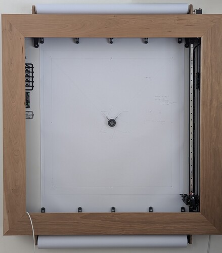

PolarGraph addition to my Wall Mounted Pen Plotter

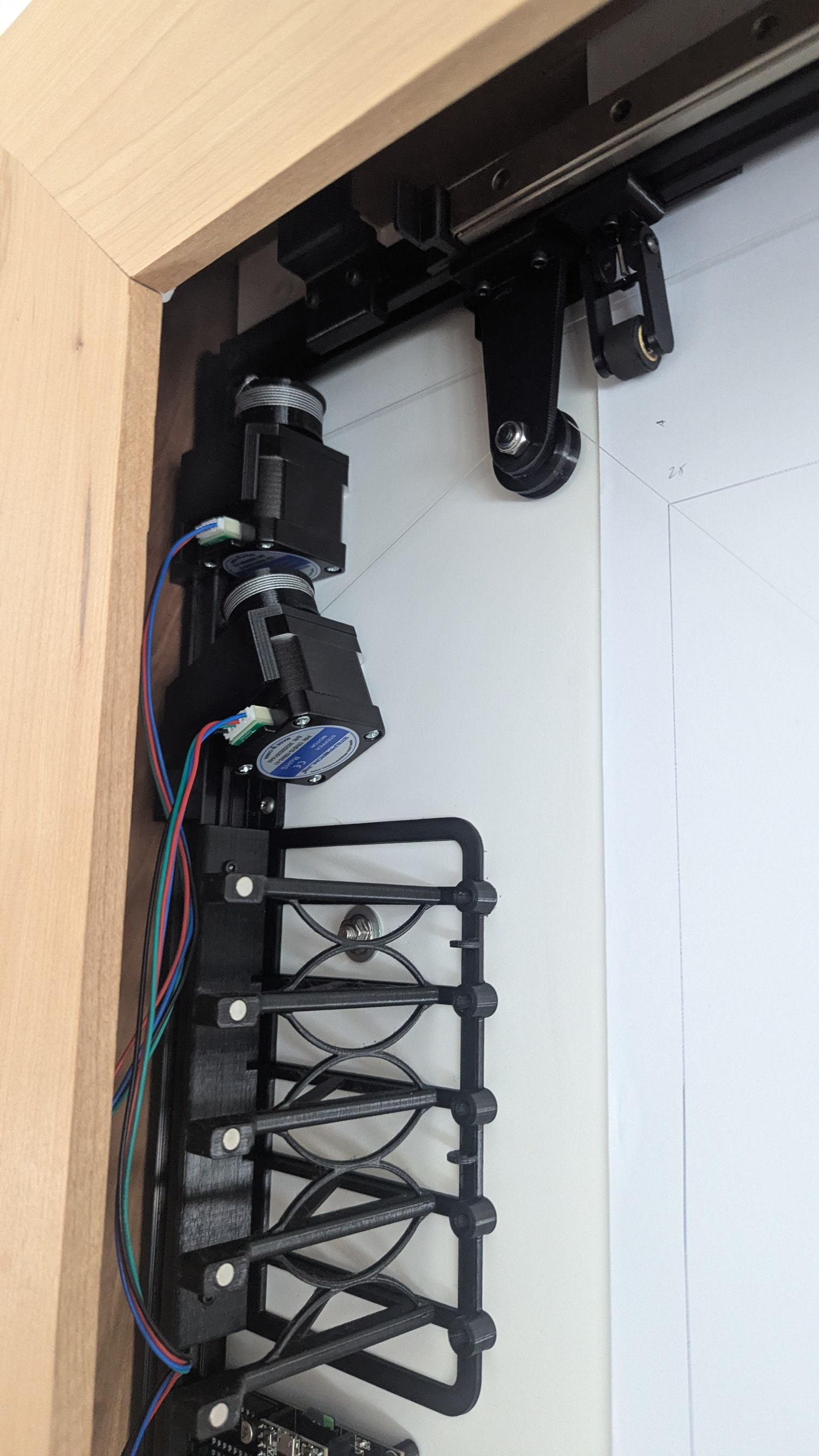

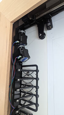

I have only just begun this project but thought if I started a build thread, it might motivate me to take it to completion. I wanted to create something else for the coffee shop that was interesting to watch. The existing plotter (Wall Mounted Pen Plotter) continues to be a huge hit, but any excuse to buy another Jackpot board and some steppers…
This mod will not affect the operation of the current plotter. It will just be another interesting way to move a pen around. They typically won’t be running at the same time - although it is technically possible to do so if the g-code that the existing cartesian system is running keeps the pen on the bottom right of the canvas and the new polargraph keeps the gondola in the top left.
FluidNC has a kinematic option called WallPlotter that makes the necessary translation. The firmware code is not supported and is a little buggy, but I have made some mods to the firmware and it seems to be working as it should at this point.

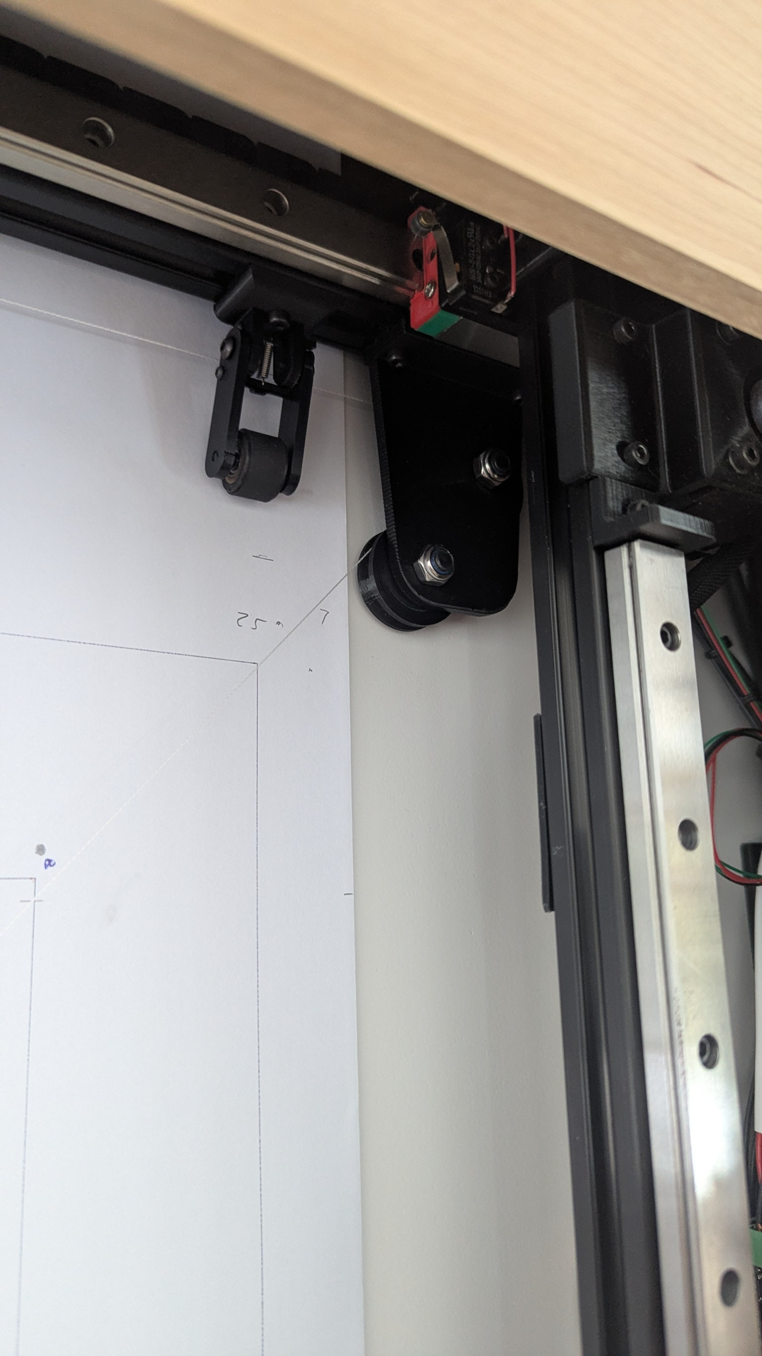

One problem I have noticed with every one of the polargraph projects I have found online is the way they incorporate a pen lift mechanism. It is always done with some ugly wires that hang from a servo on the “gondola” to the controller board. Hideous and not an option here. My first idea was to incorporate wires from the bottom corners (mirror images of the strings that the gondola hangs from) - cleaner but still not desirable. My current plan is to go wireless on the pen lift.

it is a maslow without the dc encoded motors and uses steppers.
edit: i mean in principle it is like a maslow. I too would like to know why there are linear rails on it.
If this is a maslow, what are you using the linears for?

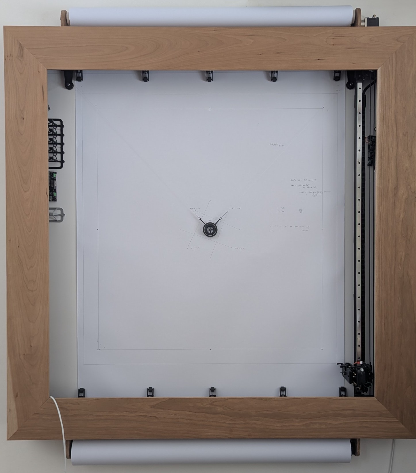

This project was originally designed as a simple Cartesian plotter… that’s why it has linear rails. It has been drawing things in a public space for about one year now. Its purpose is more entertainment than anything else. So, in that light, I wanted to add some entertainment value to it without detracting or changing the original design. Ergo the addition of the PolarGraph. And, yes, the kinematics are very similar to the Maslow design.
In theory, it will be able to draw using the original cartesian system for a day or two, then I can hang the gondola on there and use the Polargraph system the next few days. And now I am thinking that it is possible to synchronize the two and have both systems drawing at the same time. I think that might be pretty entertaining.

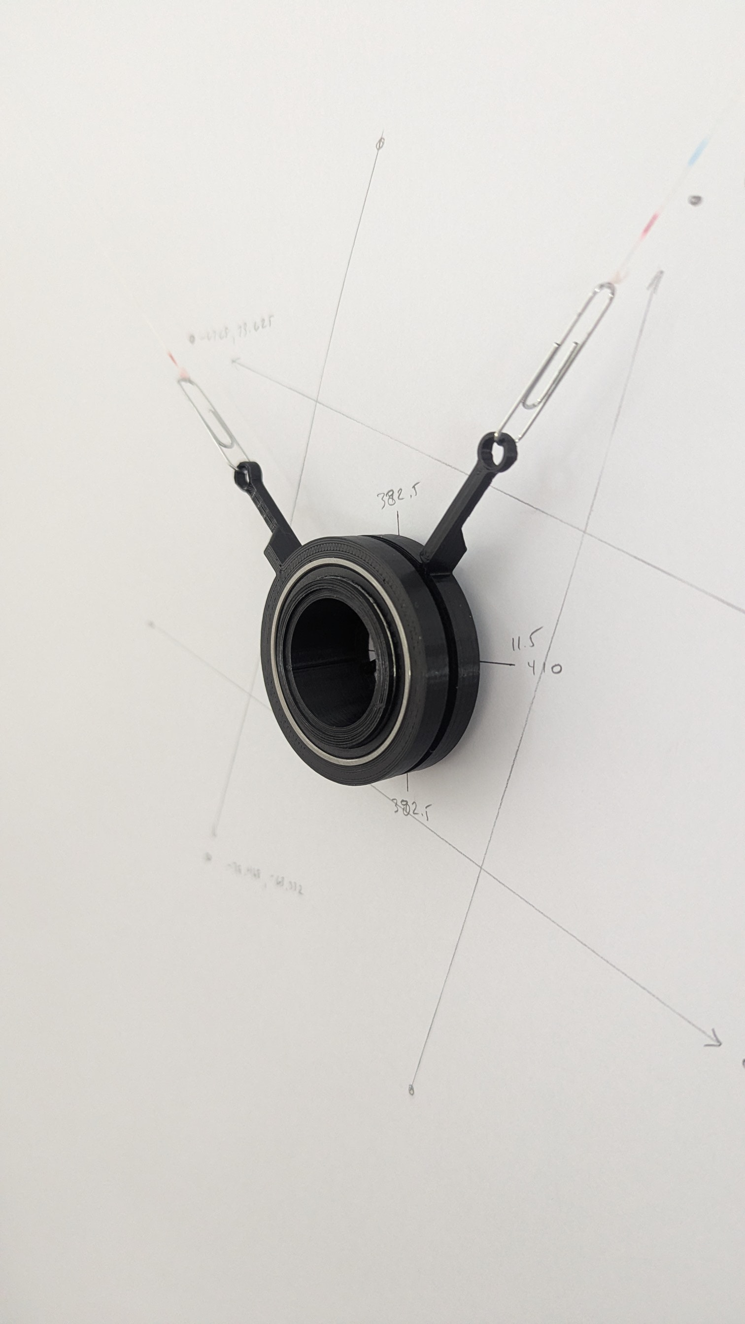

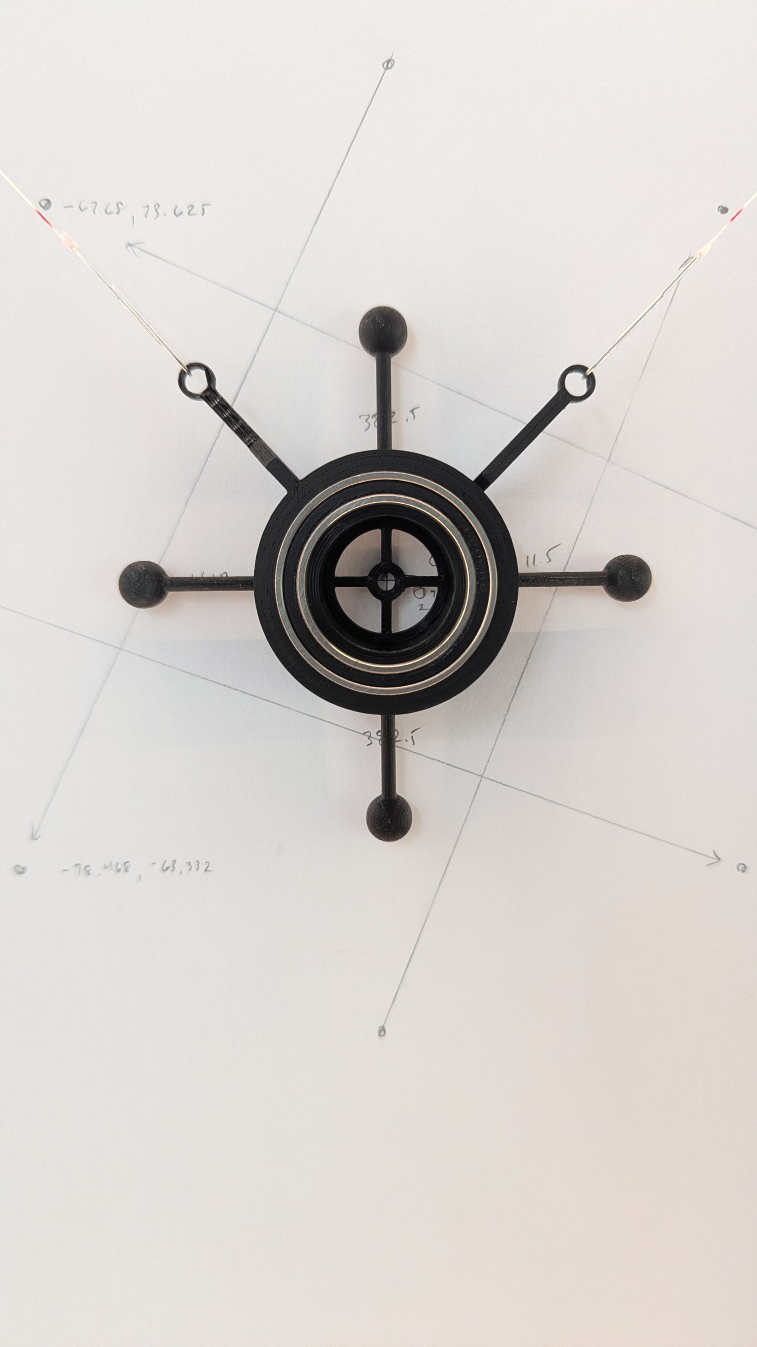

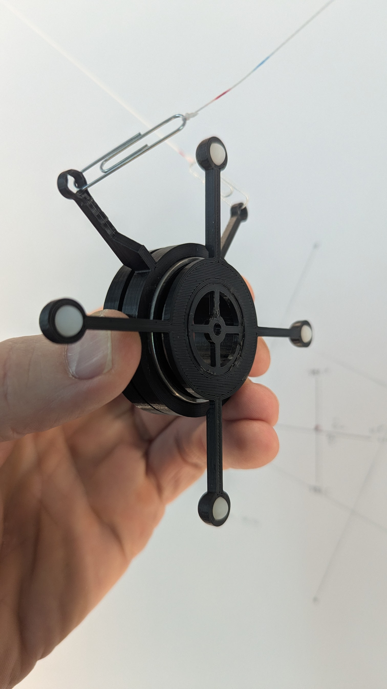

The gondola is suspended using two large bearings, each with a 30mm ID and 42mm OD. That will allow the core to remain vertically oriented as it moves over the canvas (once some ballast, in the form of the battery is attached). The core (that will eventually house the pen lift and battery) is held on the surface of the canvas by gravity. To assist in a smooth glide over the canvas, I have incorporated 4 nylon ball bearings (one in each cardinal compass position) that can spin freely in their 3-d printed sockets. I wasn’t sure if I could pull that off, but they work surprisingly well. Those cross-hairs are temporary - used for calibration.

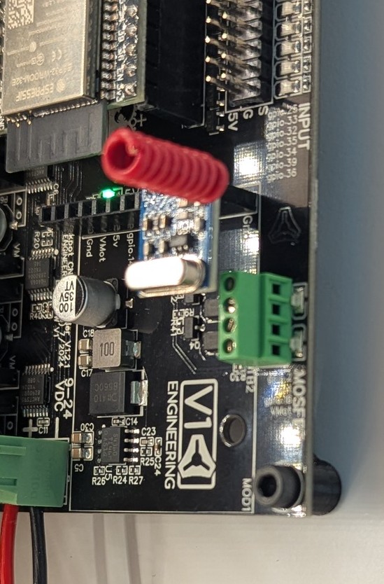

I haven’t tested it yet, but the 433Mhz transmitter for the pen lift will be a very clean addition to the Jackpot board. In theory, it only requires 3 connections - VCC, GND and DAT. Shown plugged into the expansion module socket above, I used the existing GND pin on the end of the socket and ran wires (on the underside of the board) from the 3.3v pin on the ESP32 to VCC and another from GPIO12 on the expansion slot to DAT. I assume/hope those unlabeled pins next the GND on the expansion slot aren’t connected to anything else??
For the firmware part, I will tie Mist control in the config.yaml to GPIO12 and then use M7 and M9 for pen up/down.
NOTE: I haven’t looked at the specs of the voltage regulator on the V1 ESP32 dev board, but hopefully it can handle the current required by the transmitter, which doesn’t require much. :crossed_fingers:

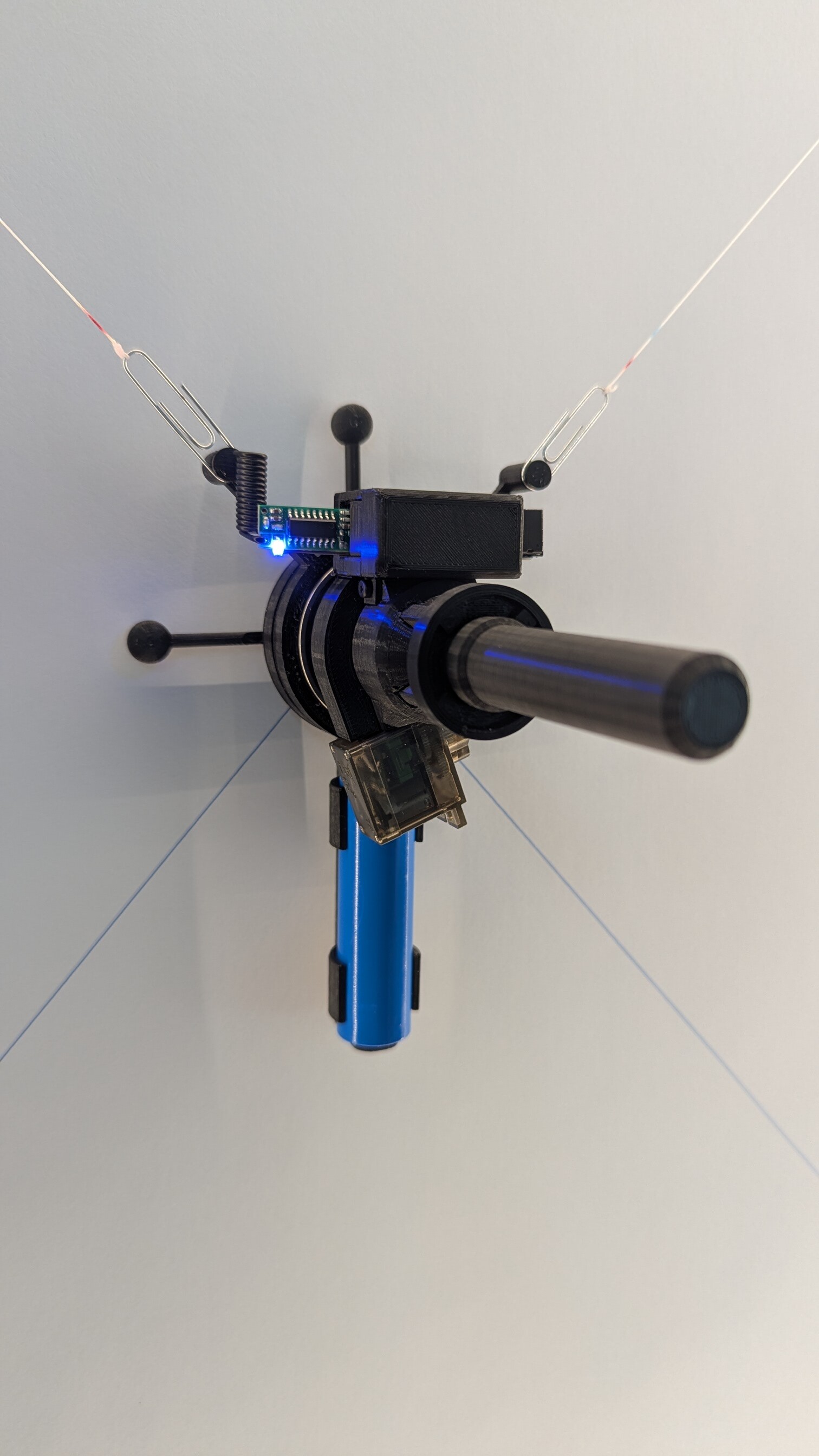

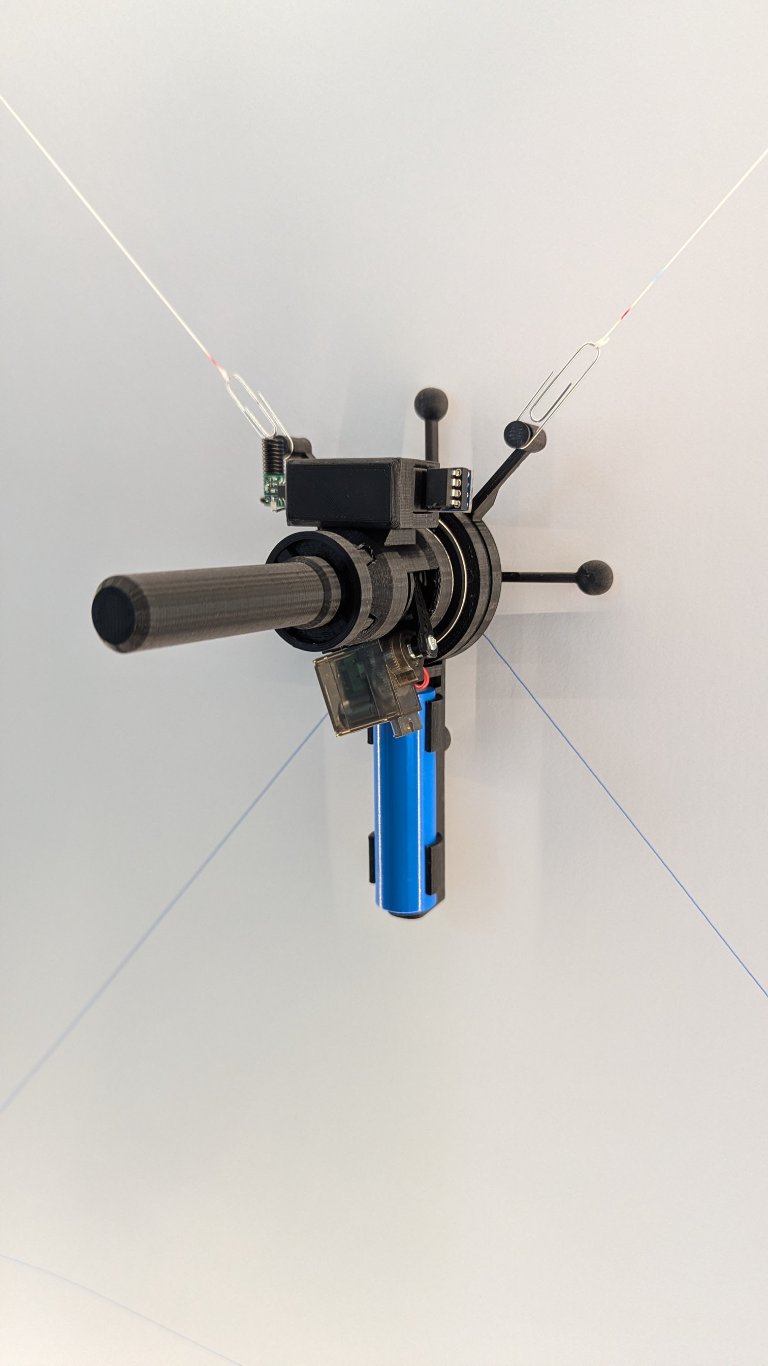

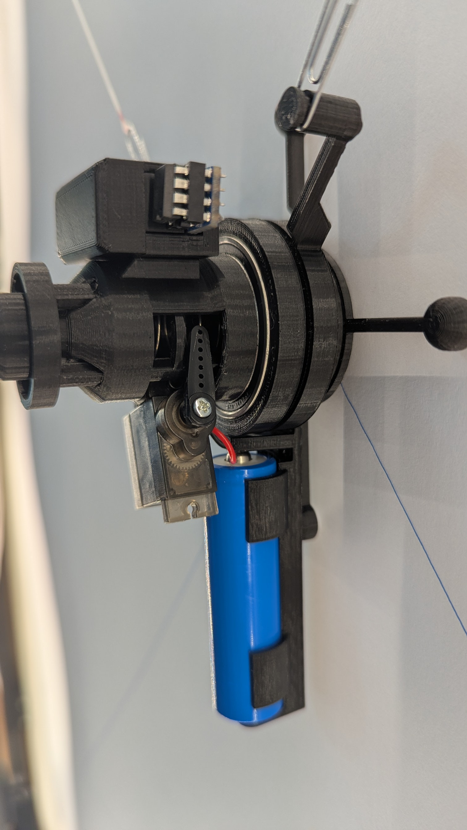

Version 1 of the wireless pen lift is done. Needs some refining but pretty happy with the results.
The biggest issue that needs addressing is the spring that holds the pen to the paper. I am using a very low force compression spring I found in a box of pinball machine parts and it still exerts too much force. I was hoping it wouldn’t cause the gondola feet to leave the paper, but … it does. I can lower the pen a lot slower by changing the step size of the pulse, which would help, but I need to find a lighter spring, which I feel will be difficult as there are no spring stores near me :slightly_smiling_face:.
Another issue, easy to solve, is timing. The pen lifts are considered instantaneous by the firmware, so I need to add a g-code pause after each movement of the servo.
Brain: ATtiny85
RF: 433Mhz (WL101 & WL102) superhets
Battery: 3.7v, 3500mAh
Servo: MG90s
Spring: .7mm wire dia., 16mm OD, 40mm long
I think I need the same size spring with a smaller wire diameter. Somewhere around .4-.5mm.
I was unable to get any of the RF units that I had in my parts box to work by driving the data pin directly from a GPIO on the ESP32, so I had to use an ATtiny on the transmitter to modulate the on/off signal. I used the VirtualWire Arduino library. Seems to be working well.
