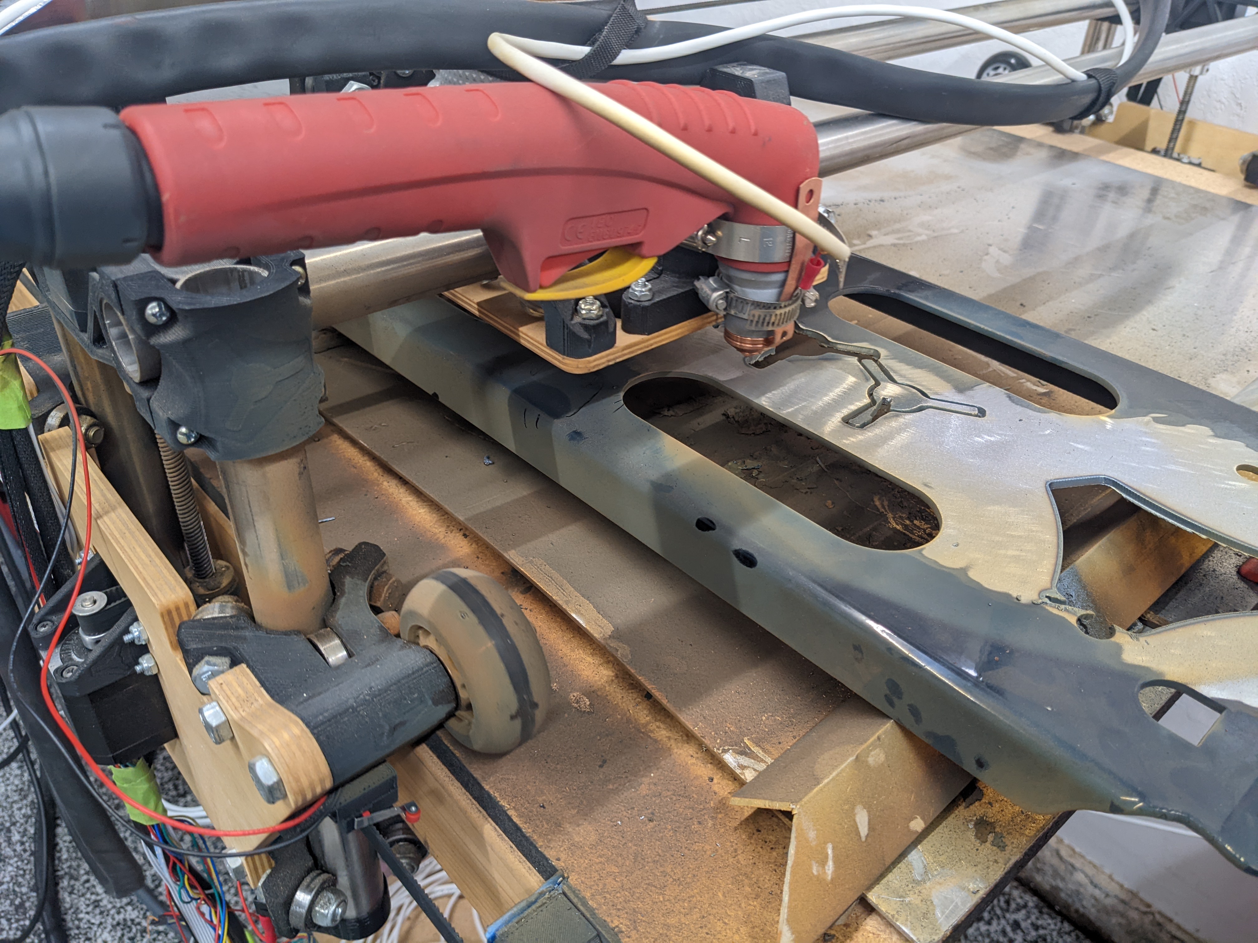

It is working now I either need to print up a mount or get started on the new LR…hmmmmmm. Watertable is a must…decisions.

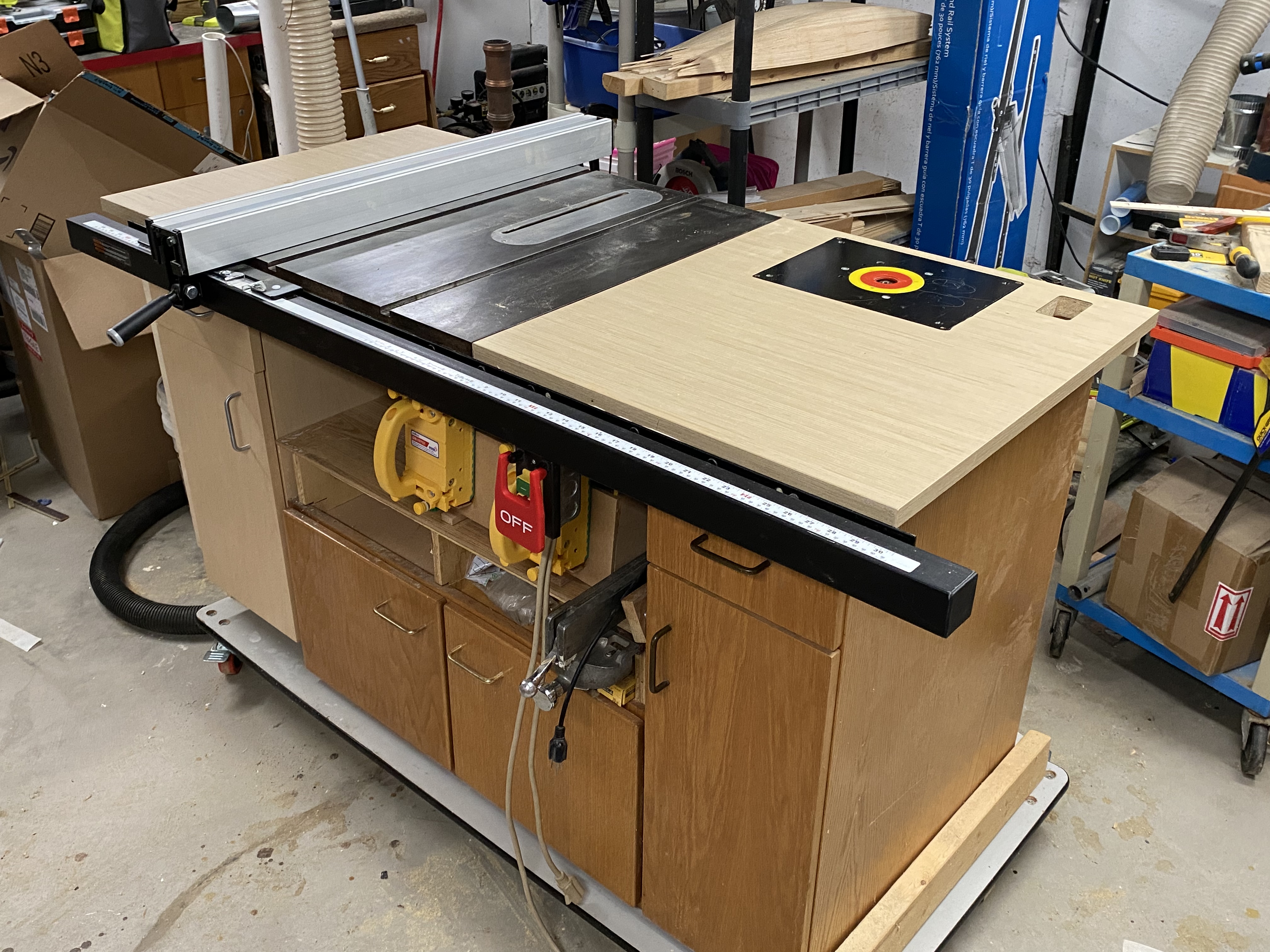

You know, I just saw this type of table somewhere else, thinking about doing it also. I have a small Ryobi table saw on a stand. I could remove it and put it in this environment.
The cabinets in mine are from our local Habitat for Humanity ReStore, with a custom platform for the tablesaw with a dust collection duct built-in. There’s a 4" dust collection pipe along the back to try and get the table saw, (eventually) an over-the-blade connection, and over/under for the router plate as well.
Now that the table saw is back together, I can crank out a couple of drawers to fill those blank slots. Blade change wrenches, featherboards, miter saw extensions may soon have a home. There’s a leftover piece of the tabletop that would make a nice flip-up outfeed extension. I like the saw a lot, and the price was right, but the blade is pretty far back so there’s very little post-cut runway.
There’s a nice cross-cut sled slotted into some brackets on the far side. At least that project is finished.

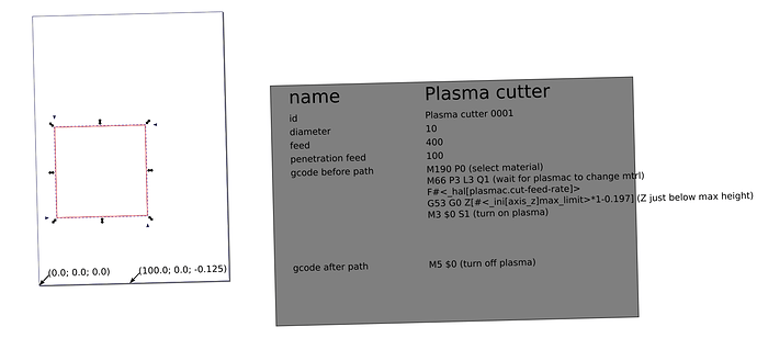

Oh, I forgot something… There is a guy on the Linuxcnc forums that builds and sells plasma tables that I believe just trains his customers to use inkscape with the built-in gcode converter plug-in. I think he tweaks the plug-in for qtplasmac.
I messed with it very briefly and forgot about it.
I don’t think that is the right link?
Yeah, post #2 starts to go in to how to use it. I’ve spent the last few minutes refreshing my memory. If you’re inclined to check it out here’s what I gather you would do:
  1. Load or create a drawing in inkscape
  2. Select what you want to cut and make sure it’s a path.
    You may need to select it and go to Path → Object To Path
  3. Go to Extensions → Gcodetools → Tools Library… and select Plasma and click apply
    This will add a box with gcode template settings right in the drawing. You’ll need to change some of this to suite qtplasmac
  4. Go to Extensions → Gcodetools → Path To GCode…
    Check the preferences tab to set where you will be saving the gcode outputs
    Go back to the Path to Gcode tab before clicking Apply otherwise it’ll throw an error… it’s kind of dumb
If you look in the generated ngc file you’ll notice it says you can create your own header and footer files if you prefer (note these file names don’t have extensions). I created these based off of what’s generated by the qtplasmac conversational tab.
header:
g20g64p0.004g40g49g80g90g92.1g94g97 (preamble)
footer file:
g20g64p0.004g40g49g80g90g92.1g94g97 (postamble)
m2

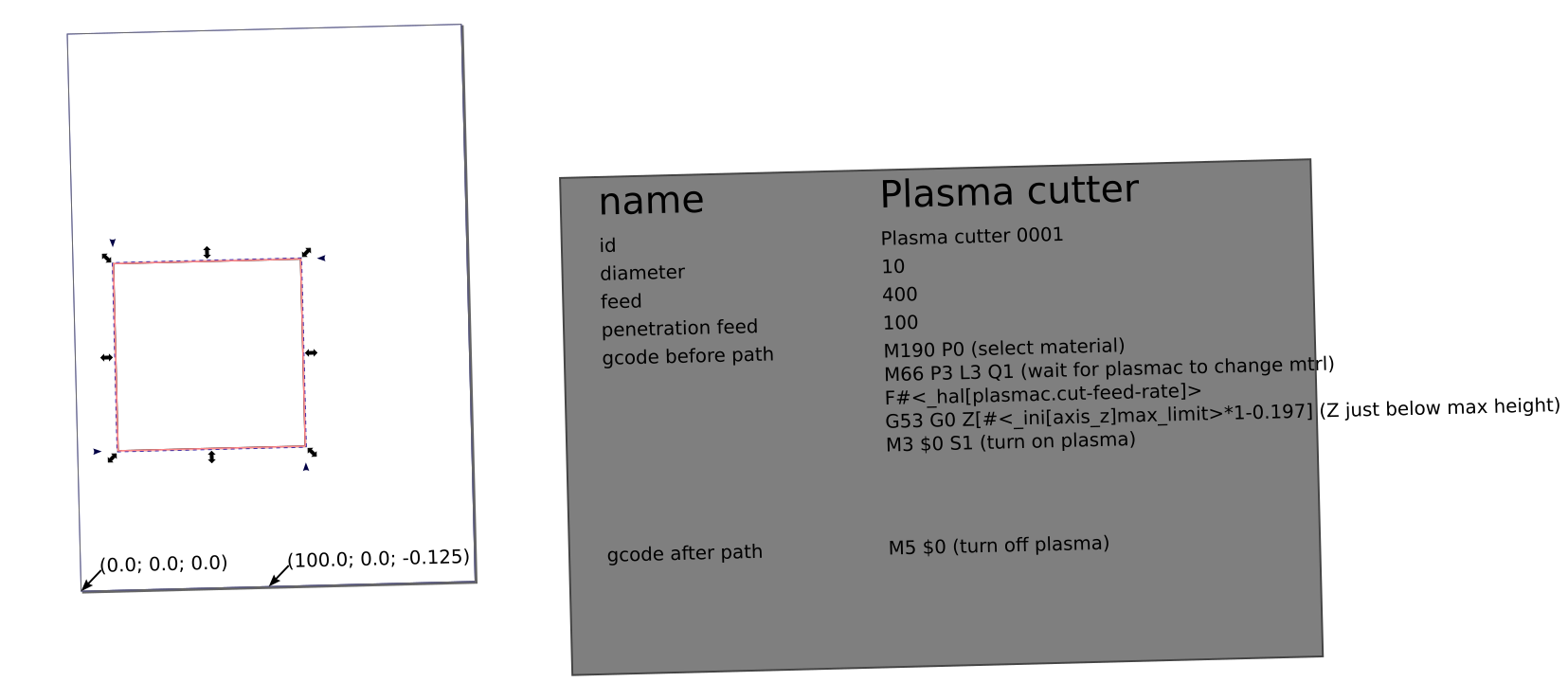

And here is what my tool setup box looks like at the moment:
This is just a starting point. You may need to make adjustments for metric vs imperial. And there’s probably a smarter way to ‘handle’ material handling.
There’s a spot where you can add your own post processor which I’m going to guess is just a python script you can throw together. (Here is where I might run some regex to find and remove the auto generated feed rates that are incorrect… the F#<_hal[plasmac.cut-feed-rate]> is what we want here. Changing the default feed of 400 to a string, #<_hal[plasmac.cut-feed-rate]> , throws an error)
There’s also Extensions → Gcodetools → Prepare path for plasma which looks like can handle lead ins and outs and junk.
As I mentioned I’ve only looked at it very briefly, now you know all I know about this. But it it might be worth exploring since it’s free.

Ok… it was bothering me so I did a little more digging in the off chance you or someone wants to use this. I couldn’t find any documentation on how to use a custom post processor so I had to dig through the source code.
It turns out that Additional post-processor setting in the Path to Gcode window does NOT load a python file like I assumed in my previous post. Basically it just expects you to input one or more predefined functions from the Postprocessor class. These are the functions available to us:
self.functions = {
    "remap": self.remap,
    "remapi": self.remapi,
    "scale": self.scale,
    "move": self.move,
    "flip": self.flip_axis,
    "flip_axis": self.flip_axis,
    "round": self.round_coordinates,
    "parameterize": self.parameterize,
    "regex": self.re_sub_on_gcode_lines
the last one ‘regex’ was what I was hoping for. If you put this in the additional post-processor box it will replace feedrates with what we want:
regex(r'(G01.+F)\d+\.?\d*(.*)', r'\1#<_hal[plasmac.cut-feed-rate]>\2')
Also, it looks like you can string multiple commands together seperated by a back slash or semicolon but I’m not sure. (reference line #2225 of the source code linked above)
