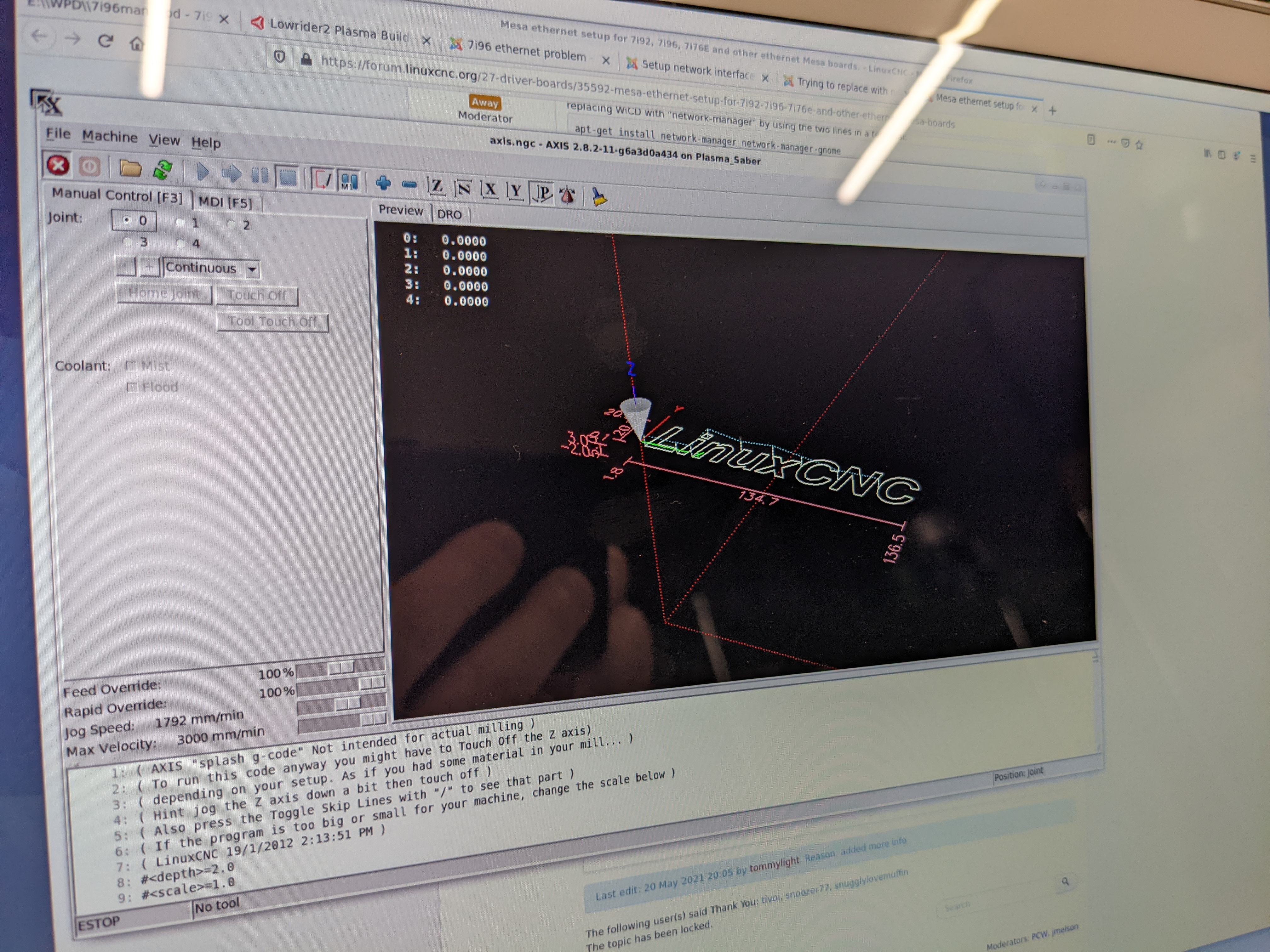

I am sure you have been plenty busy as of late, however, have you put in any more thought into making a Plasma machine? I am interested in building one myself but I cannot decide on whether to go the Rambo and Marlin route or the LinuxCNC and Mesa route.
It looks like if you are cutting thinner material, THC is a must. So go with linux/mesa. I cut some body panels those things moved inches!!! So I am assuming even 1/4 material moves a bit and nozzle distance has a huge effect of cut quality.

Took me all day but @kd2018 's tutorial was awesome.
So close now
