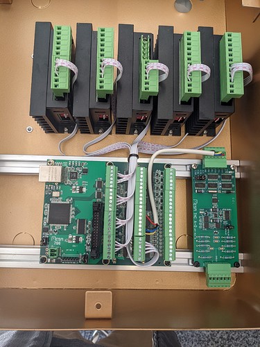

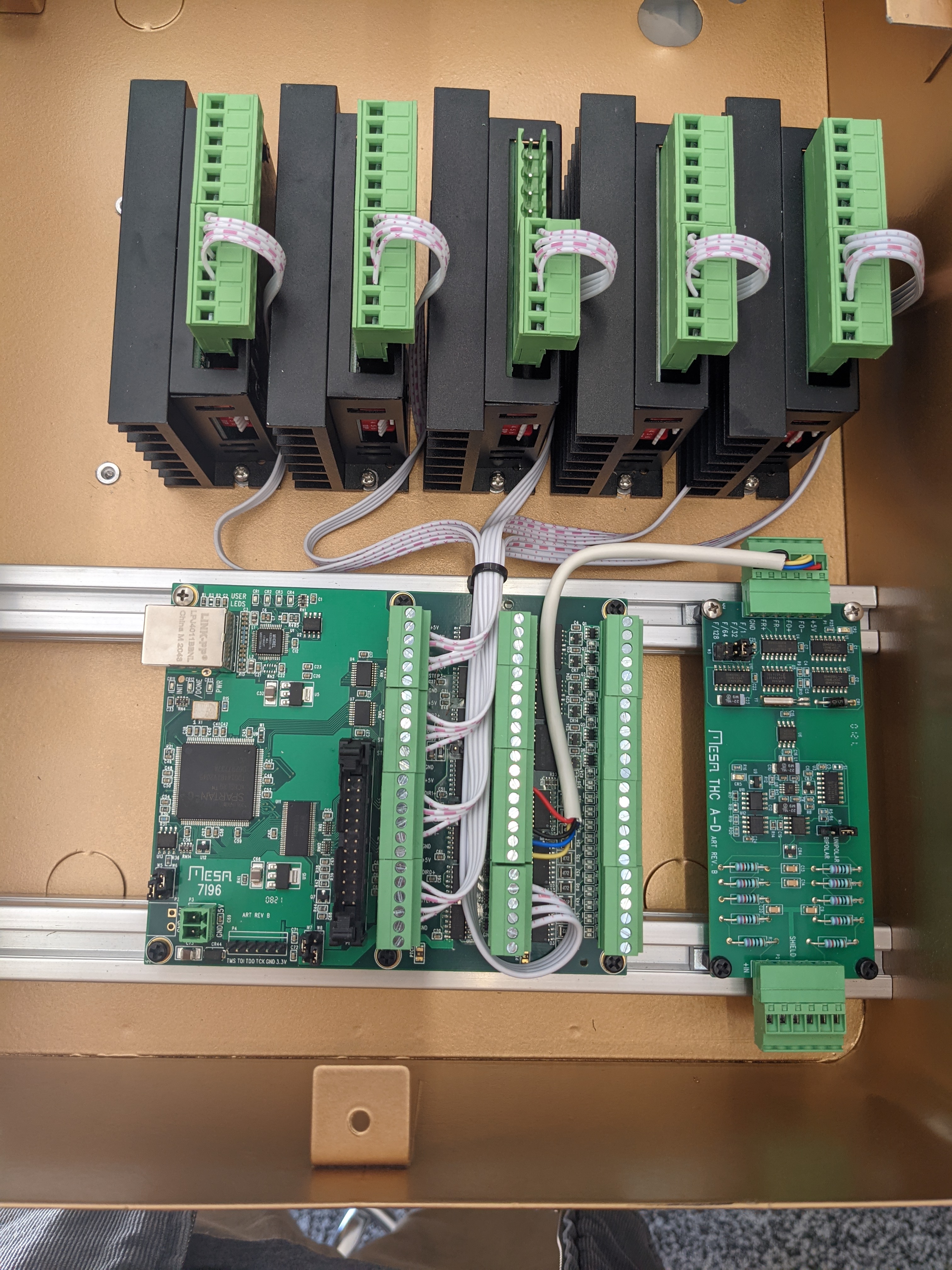

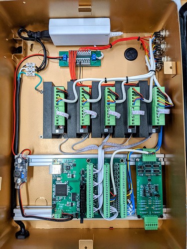

Almost ready to run it, only the torch and Ethernet left on the inside.
Nice control box.
I’ve been slowly gathering parts for a new box too. I’m going with all din rail mounted parts. I still need to design rail mounts for the stepper drivers.
It has been really frustrating for me, I feel like I am going into this very blind…even though I am following Kyle’s guide. I have not seen very many fully populated control boxes, so I was not really sure what to expect. Turns out there is a lot of din rail stuff available, and it is pretty inexpensive.
The plasma stuff is nothing like how we have it here. Lots of new information, lots of Jargon, lot’s of assumptions of knowledge and very few pictures.’
The only thing I have left is float switch, ohmic sensing, or both. ( really just want ohmic and a breakaway mount. I can not believe there are not a ton of ohmic sensing options that are just plug and play. If I make one I will surely make a board and parts list. Most of the plans are pretty vague. Heck I might just buy the one ebay option I saw.
I think part of the problem is everything changes depending on which plasma cutter you go with.
The one you have is CNC ready. One of the pins provides an output signal on the amount of power the plasma is using. Something I read said that you can use that knowledge to adjust the height. I’m not sure how. But I think that has to do with THC.
I also didn’t think your plasma had to be touched off. I thought the pilot arc or blow-back plasmas could be started as long as their within a certain distance of the work. I would think you could set 0,0,0 where you want it on the plate just barely touching the top of it and then have the gcode raise up just a touch to do the cutting.
This is all 100% theory for me. I have 0 hand on knowledge of anything I’m talking about here.
Yes, that is correct (from my limited experience), I have the thcad for that. I assumed that also meant it would drive until it hit a certain voltage for leveling…not how it works. No arc no initial voltage no initial height., that is a DUH moment for me.
