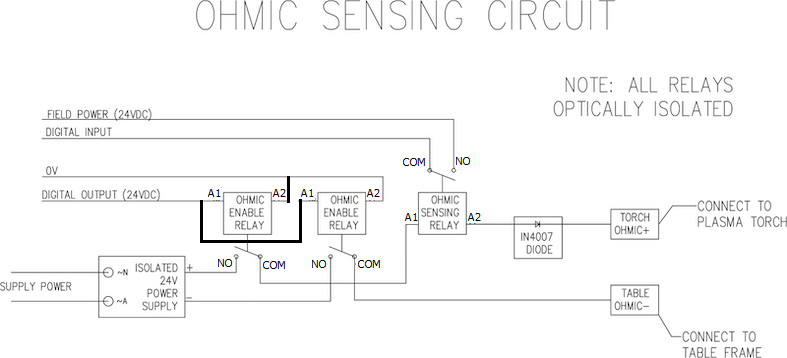

@vicious1 Hey, I noticed you have several Solid State Relays in your box, and I think I read where those were for end stops or something. I’m confused on that. Would you mind to explain why those are needed and how they are being used?
I am pretty sure they are all for the ohmic sensing.
Physical disconnects for when the High voltage turns on.
OK, thanks. I had to read up on what that even means. Found this. Reading the post you linked made my head spin.
Anyhow based on the starlabcnc website I linked to, apparently the two main choices for detecting the metal are “floating head” (which I am doing) and “ohmic sensing” (which you did). I hope “floating head” is not super challenging to setup. At least it’s something I understand the premise of.
They both work equally accurate. I am just not a fan of adding the floating head hardware. Ohmic has the drawback of needing to remove paint if it’s there, but you have to do that for the ground clamp anyway.

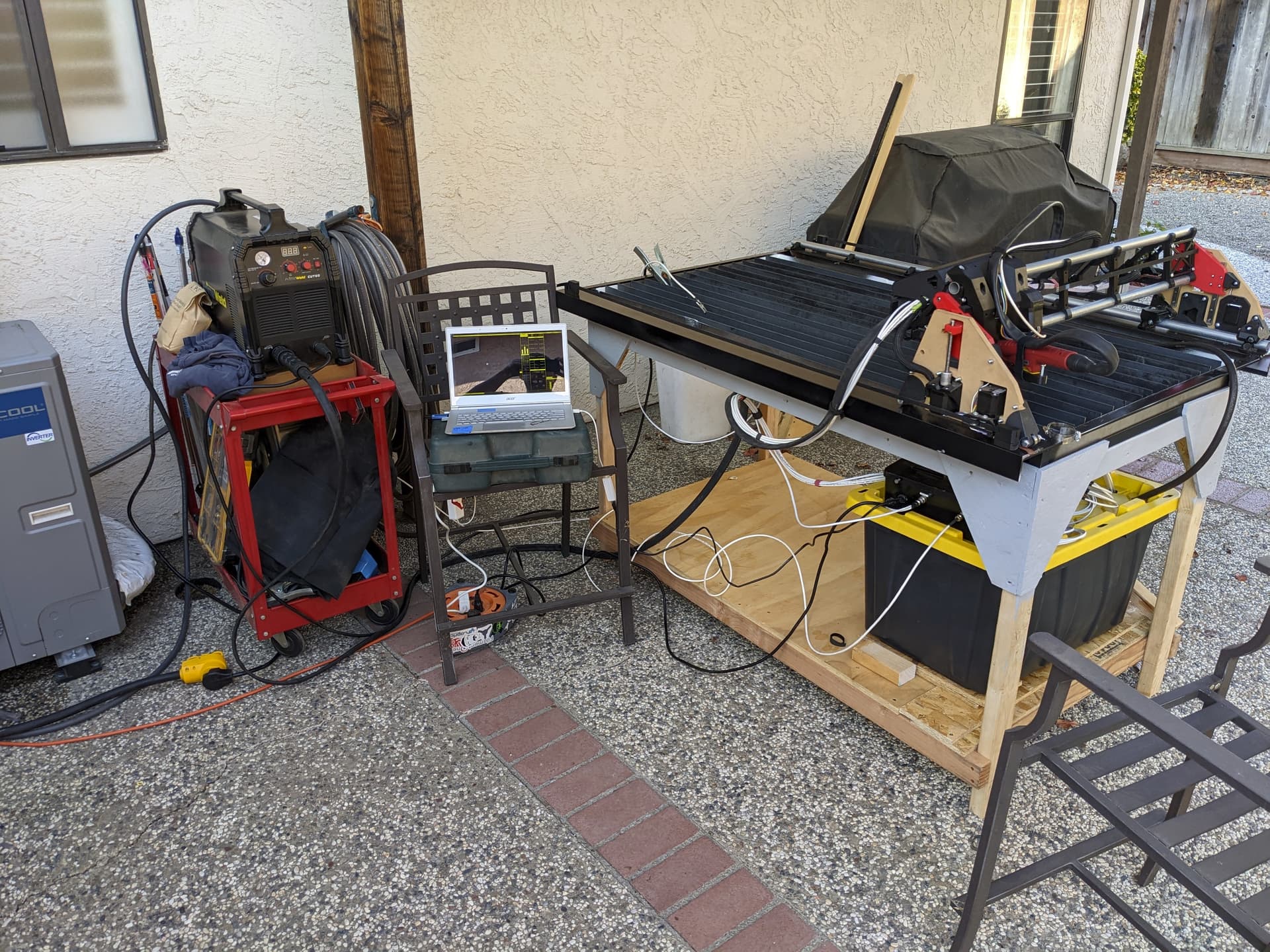

Look how janky this turned out. I wanted to get up and running so bad I just left it outside. Sure enough went outside this morning and my neighbor asked for a steel bracket for his transmission. Job one, day one!
When I figure out what I need and where everything flows I will pretty this up a bit.
Looks great! Love it!!
