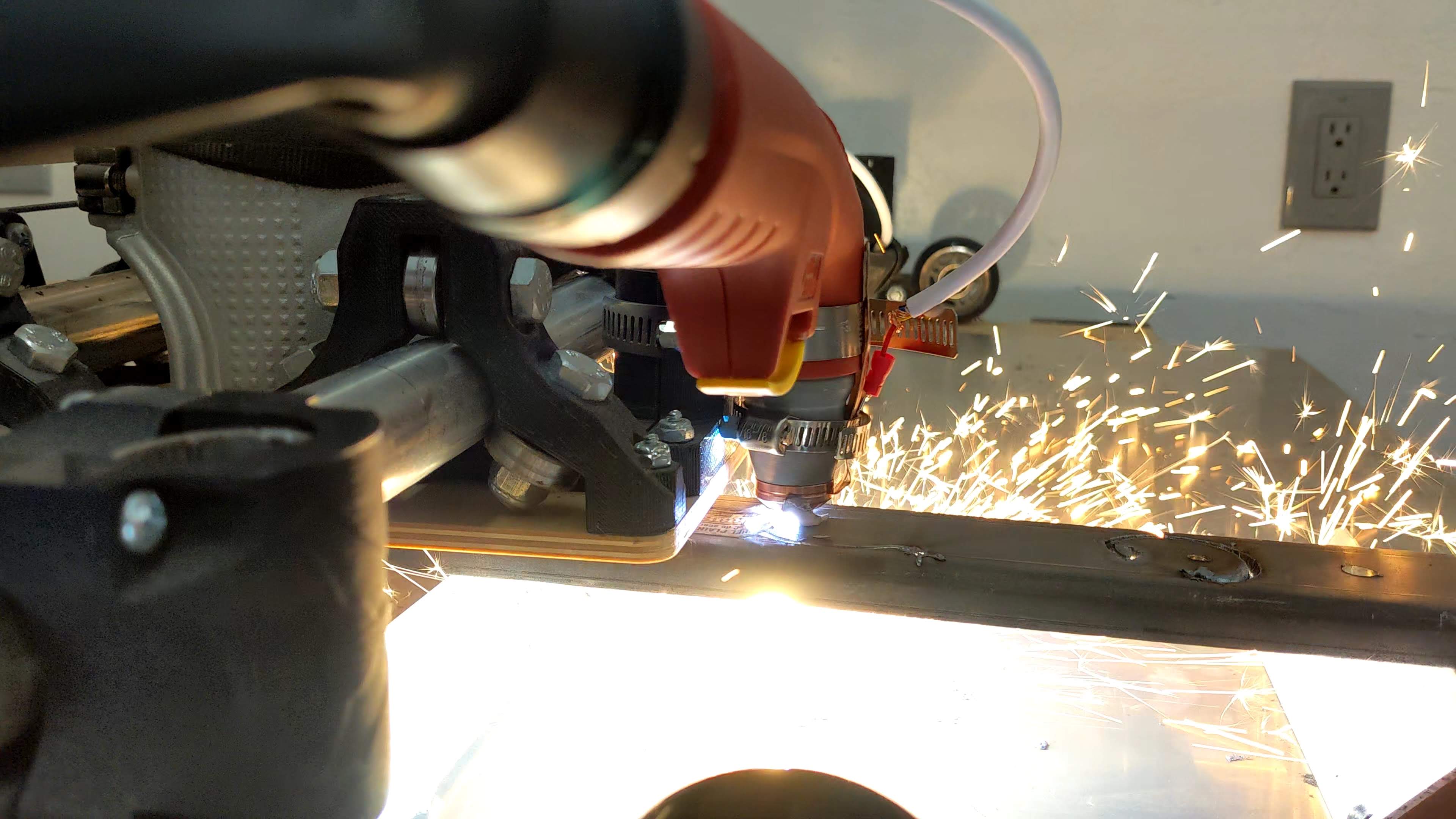

I just pipe clamped the torch on, and literally plugged in the stepper cables under the table. Apparently I have zero EMF issues even with unsheilded cables.

I need to slow down my probe speed. I feel like the ohmic pushes harder than expected.
Had a bunch of hiccups that cost me a lot of time. I had to make a whole new LinuxCNC setup once you get into qTplasmac it seems some of the settings don’t change right, So I followed the instructions and made everything work in regular linucnc (avid?) then set all the homing offsets and stuff, then switched to Qt and I was in business.
Then I had slag clog up the tip enough to trigger the ohmic mid air.
Simple now, took a while to figure it out the first time though.

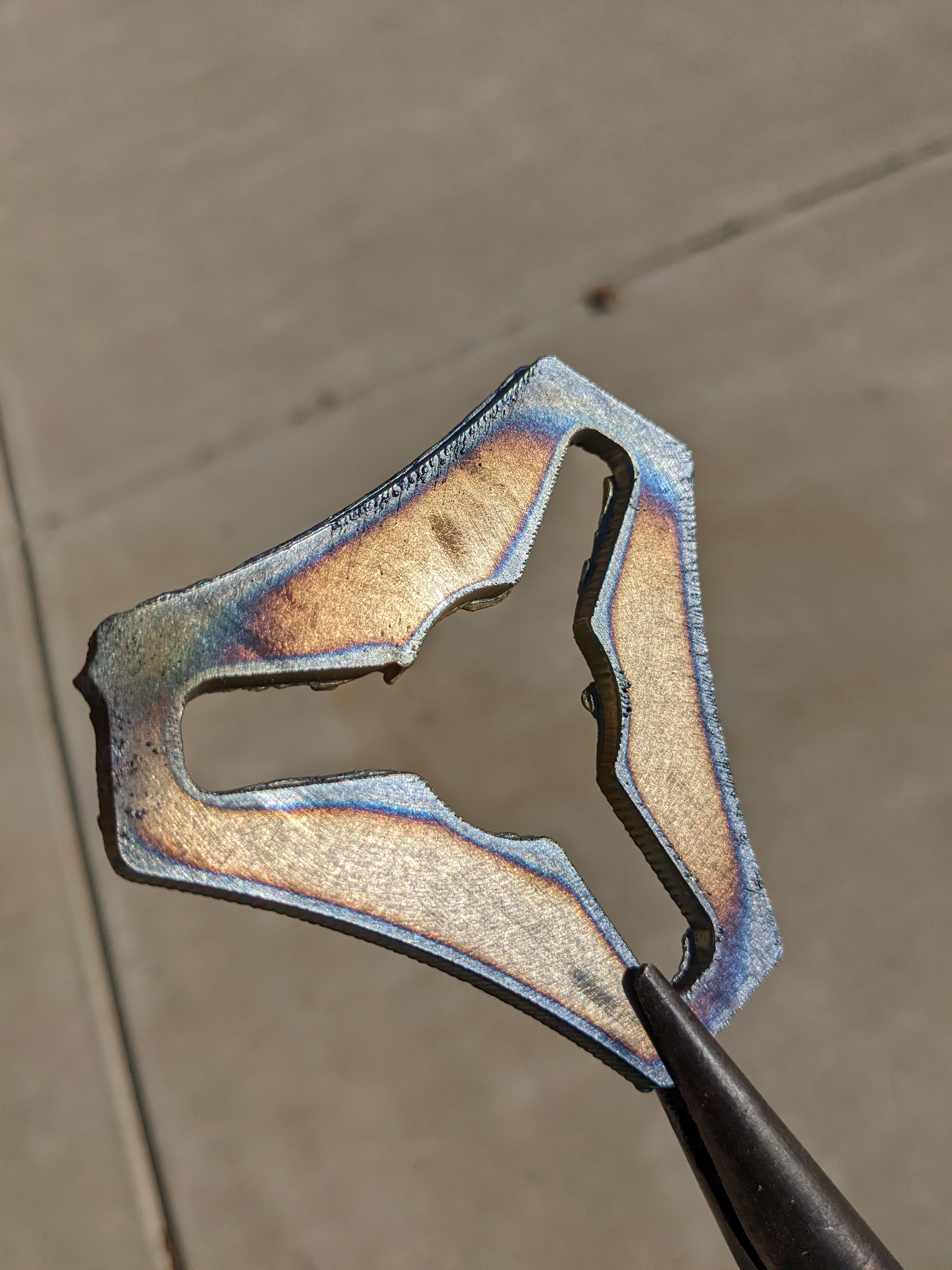

Better, have it set for 1/4", but forgot I loaded a sheet of 1/8". Still, freaking awesome!

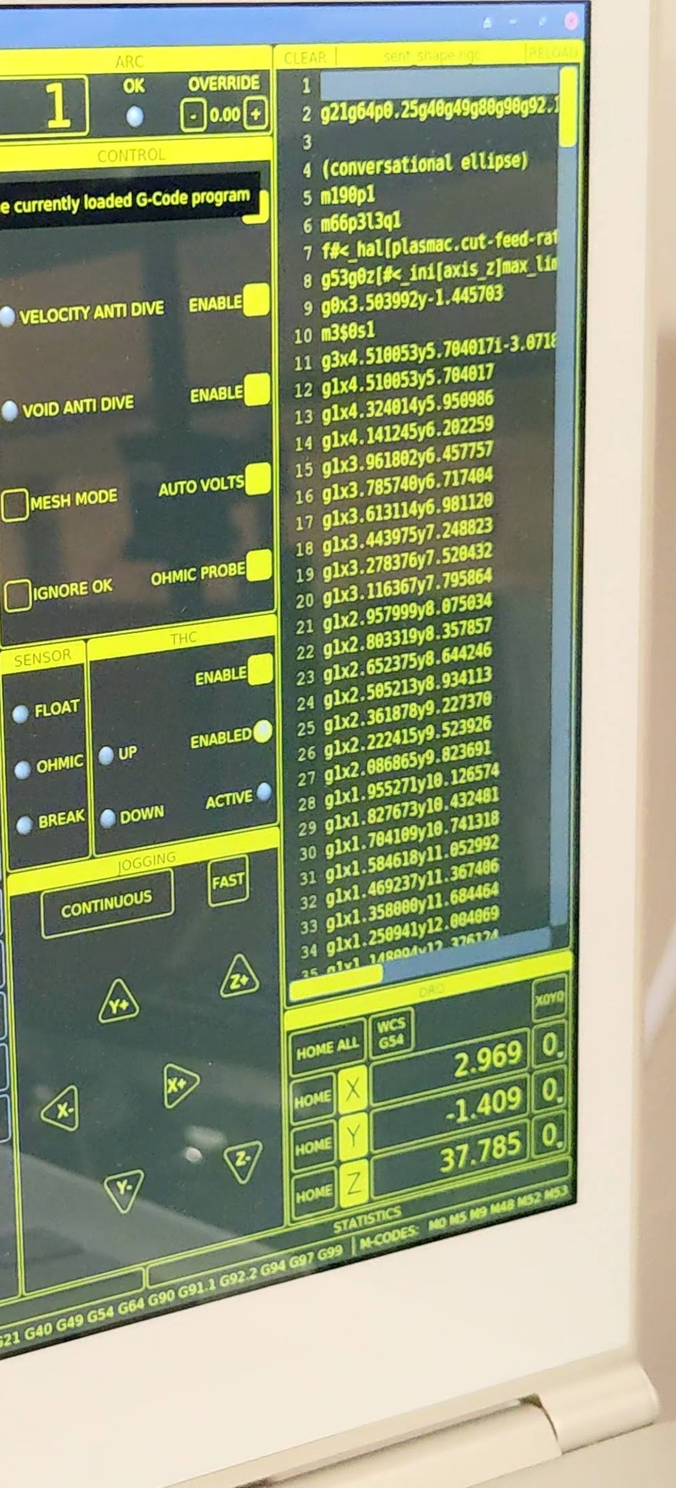

I am not getting a preview of my gcode though? Get warnings about material 00000 but I have material 2 loaded…so getting there but not ideal yet.
That’s weird. Maybe the preview is zoomed in for some reason?
Have you configured a materials file? How did you generate the gcode?
A gcode file can either specify a material from your QTPlasmaCs config or it can provide it’s own config settings within the file.

I have configured two materials. I have tried three was of starting my file (made with estlcam). I looked at sheetcam but there are no real instructions for a linuxcnc based machine, just a hundred pages of how to configure sheetcam. I tried;
F#<_hal[plasmac.cut-feed-rate]>

M190 P00002
M66 P3 L3 Q1
They both work, but I get error about feedrates mismatching, I just hit ignore. I end it with the right command, I think, still get errors about how the file ends. Maybe I have to remove all comments estlcam adds?
As for the gcode not showing up I enabled the grid to verify the size, not there still. It does show up in the make your own code screen sometimes.

I would prefer not to specify the material in the gcode so I can load up any material I have on hand, load it in parameters, then just run my file.

Okay, I think I made progress. I made a simple sheetcam program. I am going to use the ending stuff from that mainly, M30 (end program), I think it is best to disable the “F” commands all together.
That did it, no more errors and I get a preview now.
