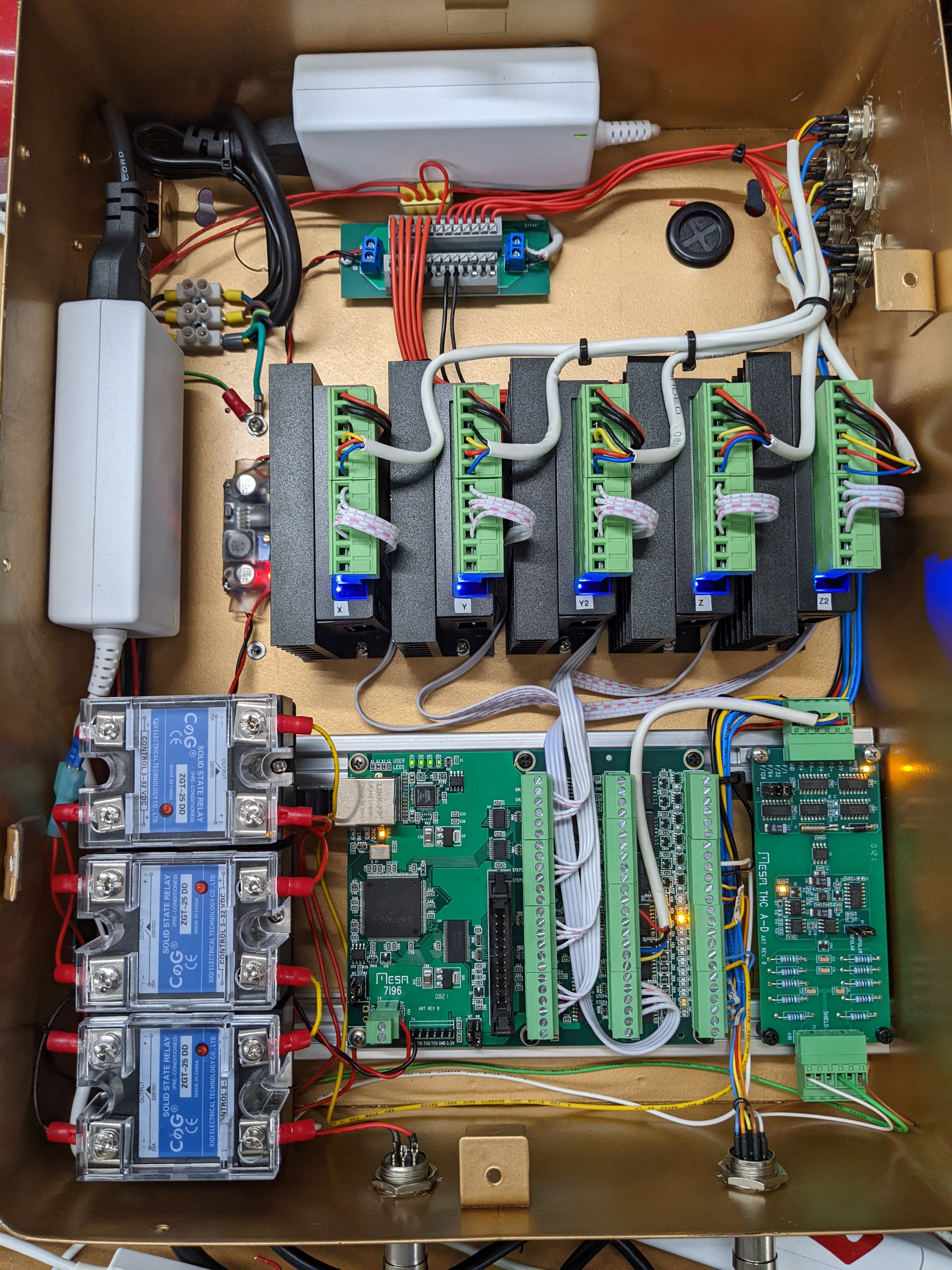

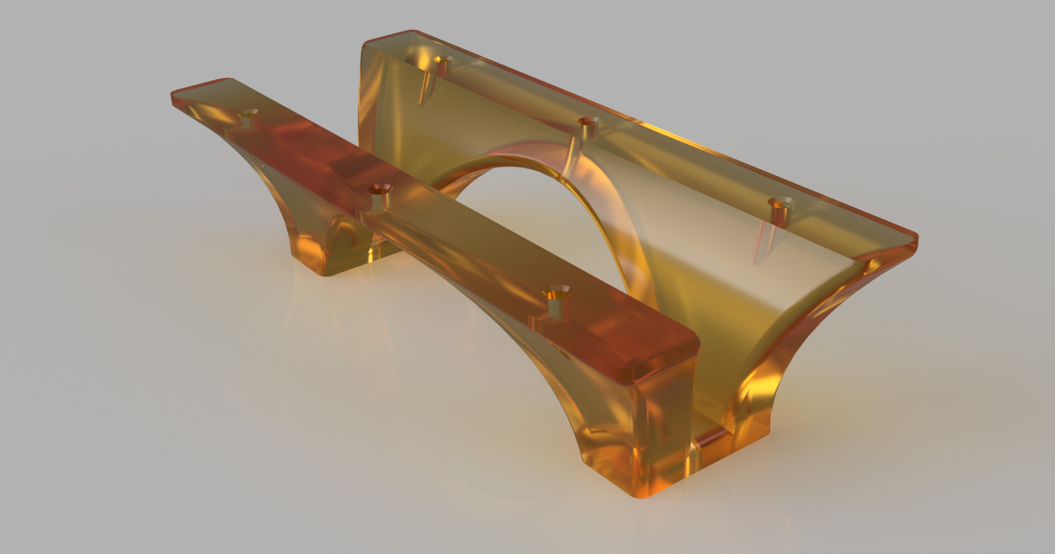

I had not planned on the three SSR’s for the touch probing. Instead of moving everything around I made a bit of a cheat. This was supposed to just be to make sure they would fit then make it a little nicer. Well, I added all the chamfers, and then decided it needed to get a render even though no one else will ever need this exact part. I think I needed some seat time.
All wired up. Everything seems to work, ohmic seems ready. So just solder a couple more external plugs and swap out my LR brains. I never seem to get too much time with it, this pace is killing me.

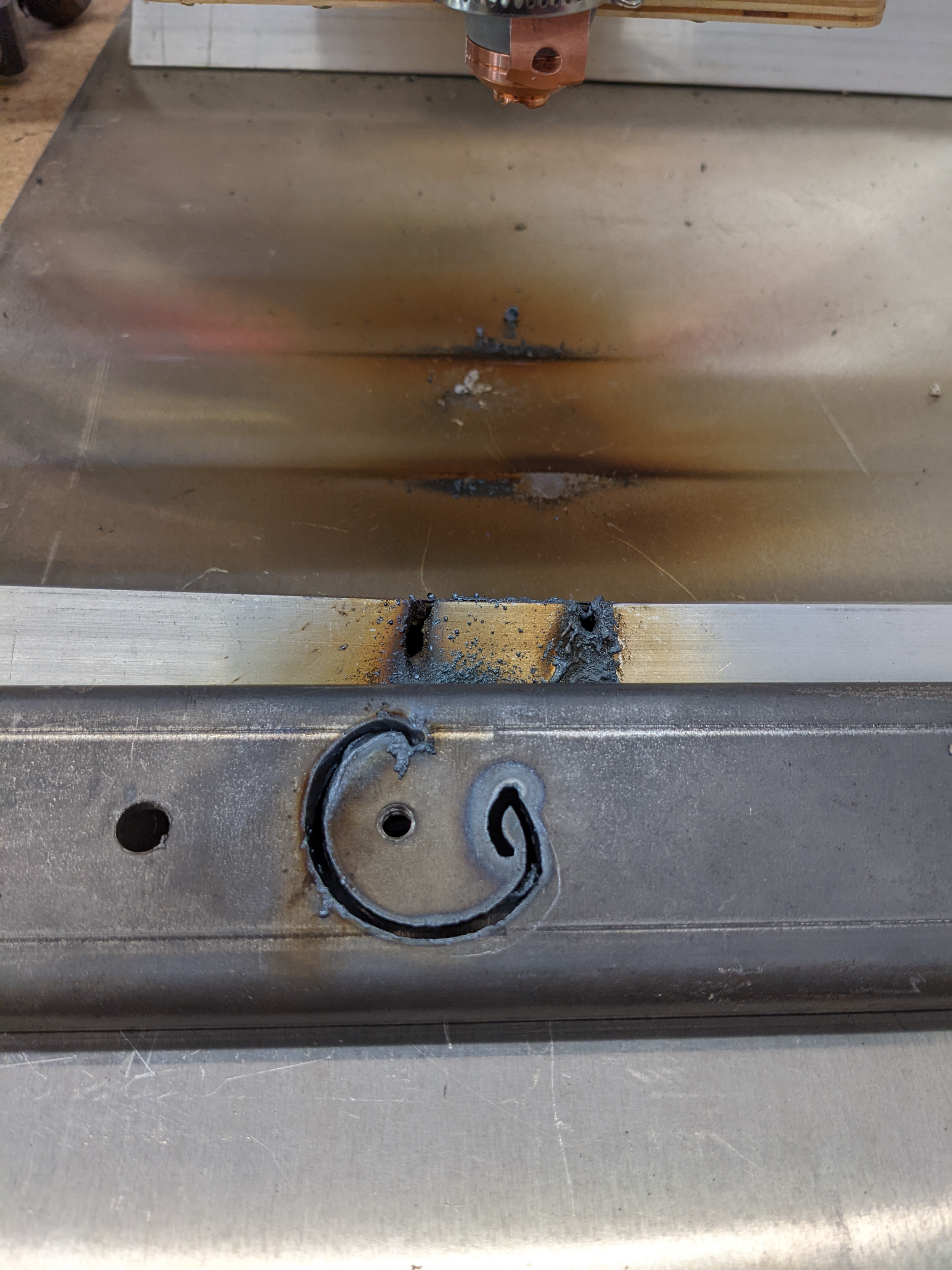

My little aluminum protection sheet is bending faster than the THC…or the thc isn’t working right. So many things to watch…maybe I need to change some settings, since I didn’t change anything other than voltage offset.
